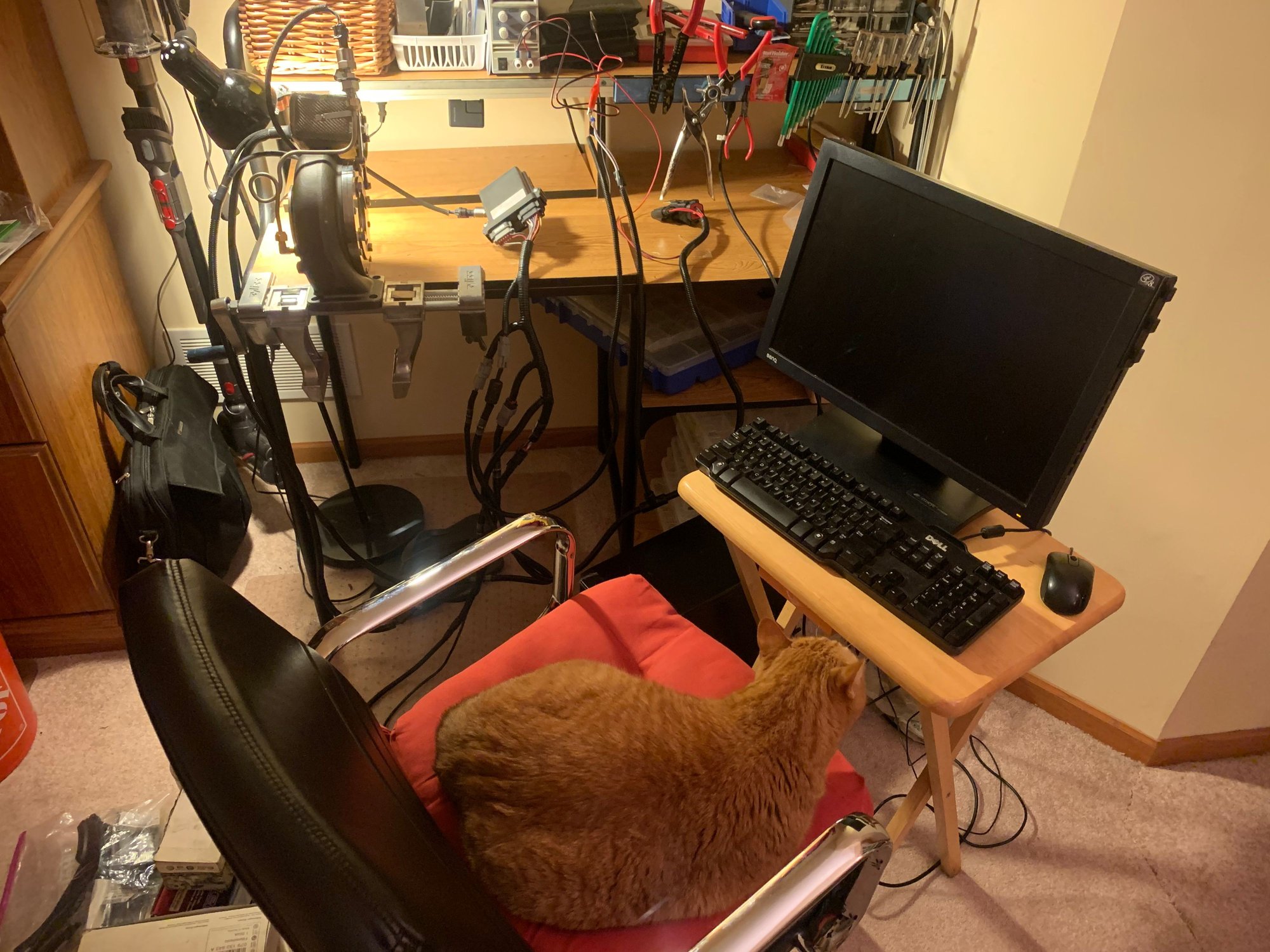

Thanks for the encouraging words guys. The Turbonator is back on the bench and displaying the same aberrant behavior as it was on the truck. It is not connecting to two different computers now so I'm pretty sure the fault lies in the controller or wiring. Now I will have to painstakingly inspect each connector for bent pins.
You can see my lab assistant in the foreground.

Discouraging to say the least... Sorry for your troubles Leonard. Keep us updated if you find something.
Also, please let your assistant know that they are doing a great job at monitoring the monitor!

Wilco. The lab assistant has received treats for his diligence, blank screen notwithstanding.
Looks like your lab assistant has eaten quite a few treats in their life.... That is one big cat. (maybe its the camera adds a few lbs.)...
Oh yah. He's a B-52 i.e. BUFF (Big Ugly Fat Fella).

We have similar assistants!

Yours looks like he's the guy in charge, not the assistant.

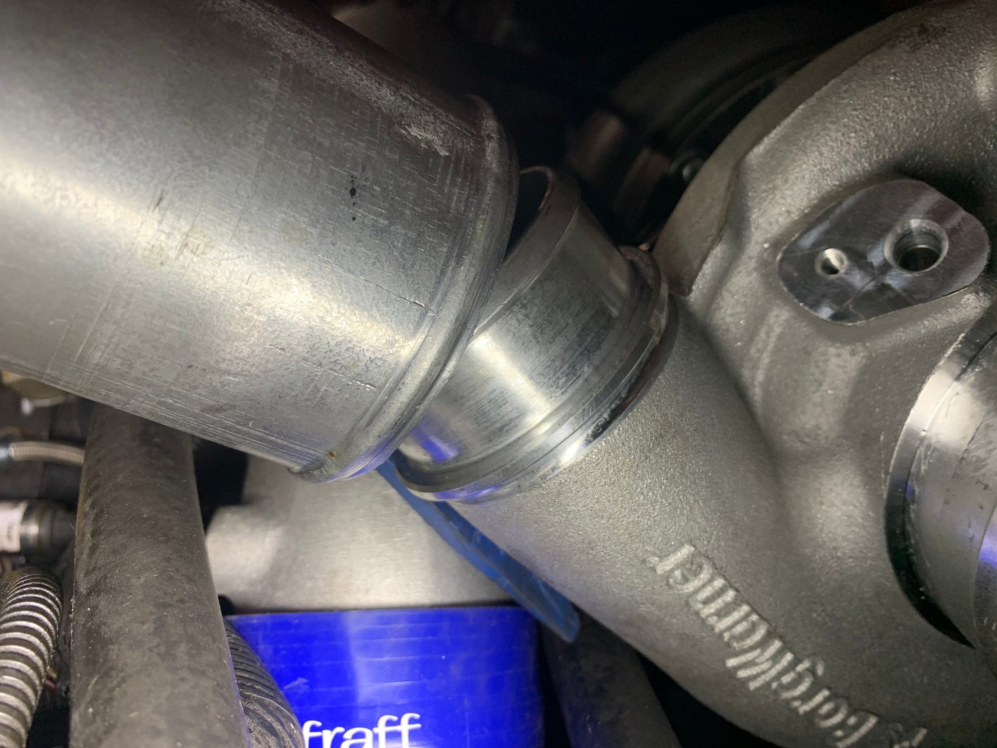

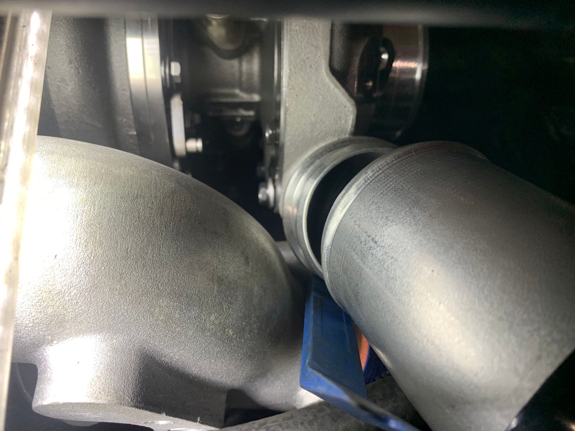

Got the clocking of the center cartridge and compressor scroll done today. The misalignment of the CAC tube to the turbo is quite severe. I will be welding a spacer and reclocking the bend in the tube in an attempt to get things to line up better.

My IC pipe was off by a bit, but not nearly that much. I was able to overcome the difference in angles with a slightly longer boot than what CSD sent to join the tube and turbo. Maybe his tube bender was drunk when he made that one Leonard. At least you have the skills and tools to change something like that to make it perfect.

Mine was off quite a bit too. I think the main issue was the Y. It wouldn’t let the turbo outlet clock low enough to line up with the CAC tube. I was able to adjust and wiggle to get it to work ok with the longer boot Sous recommends. I believe one thing that really helped mine was pulling the CAC out from the IC so it was a spaced fit using the boot. This let me adjust the angle a little better by twisting the tube.
But I bet yours will fit better.
