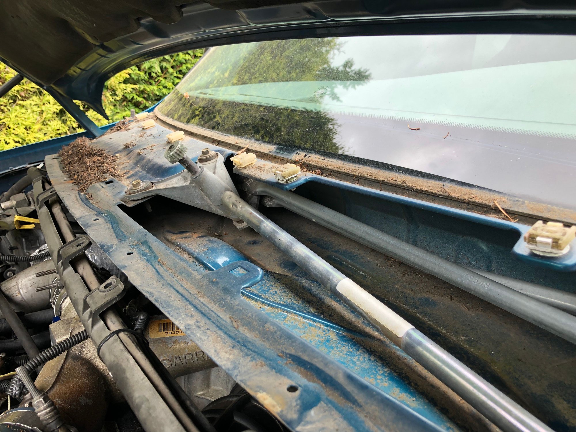

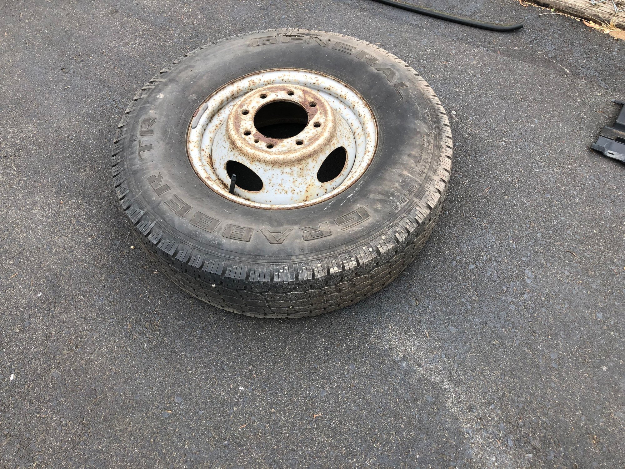

Based on kick in nads thread figured it’s time to drop the spare, grease up the winch and check inflation.

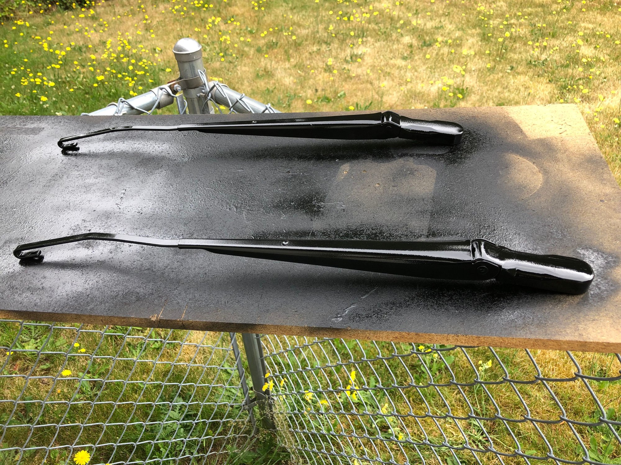

Found the trailer plug bracket was slightly loose so I pulled it off. Tweaked it a bit cause it was slightly bent. Splashed a coat of rust paint on it.
Figured might as well do the wiper arms if I already have the rattle can out.

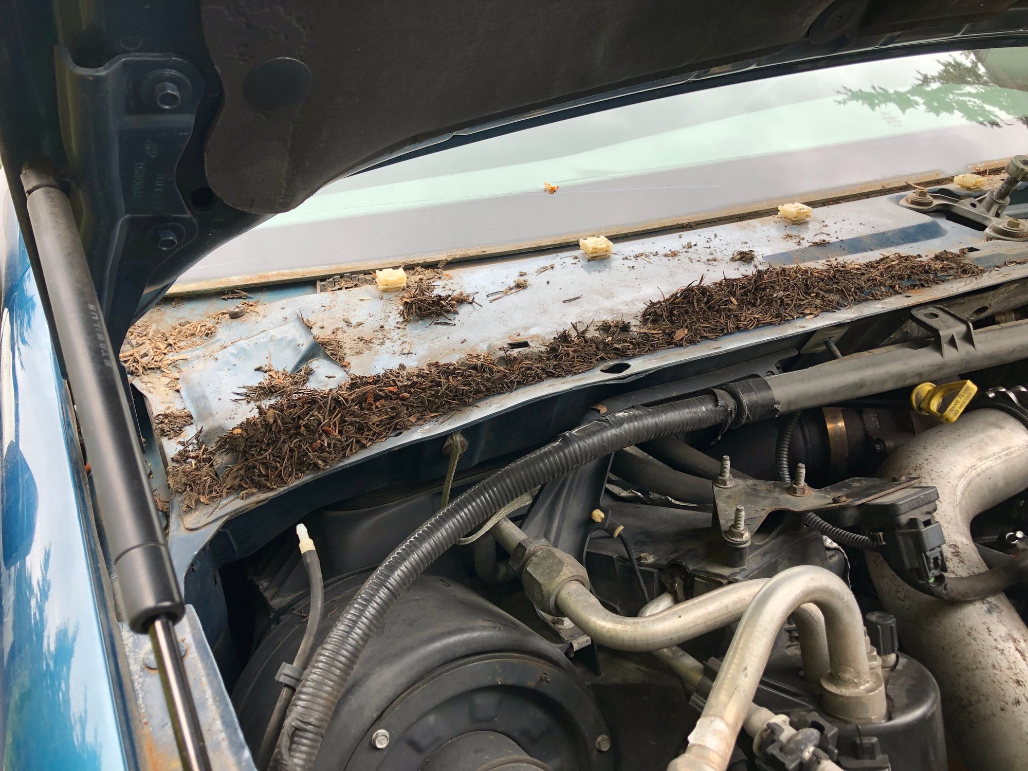

If that’s not enough for one day maybe pull the valance and clean up under it.
Seriously shocked me how much crud was under there.

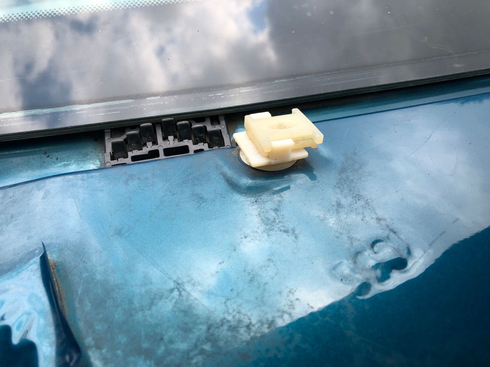

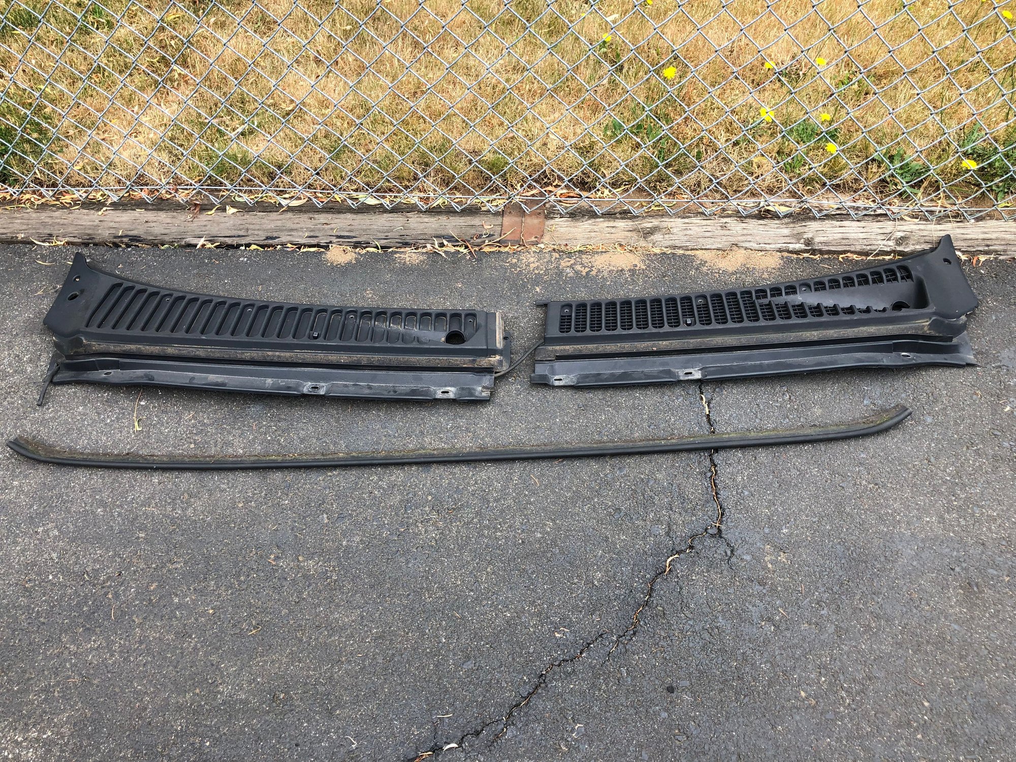

Anybody know what this part # is, and is it available through Dorman or…
Old Jul 1, 2021 | 08:37 PM
  #425
F350towing's Avatar
F350towing
Joined: May 2020
Posts: 2,936
Likes: 2,198
From: Langley B.C. Canada

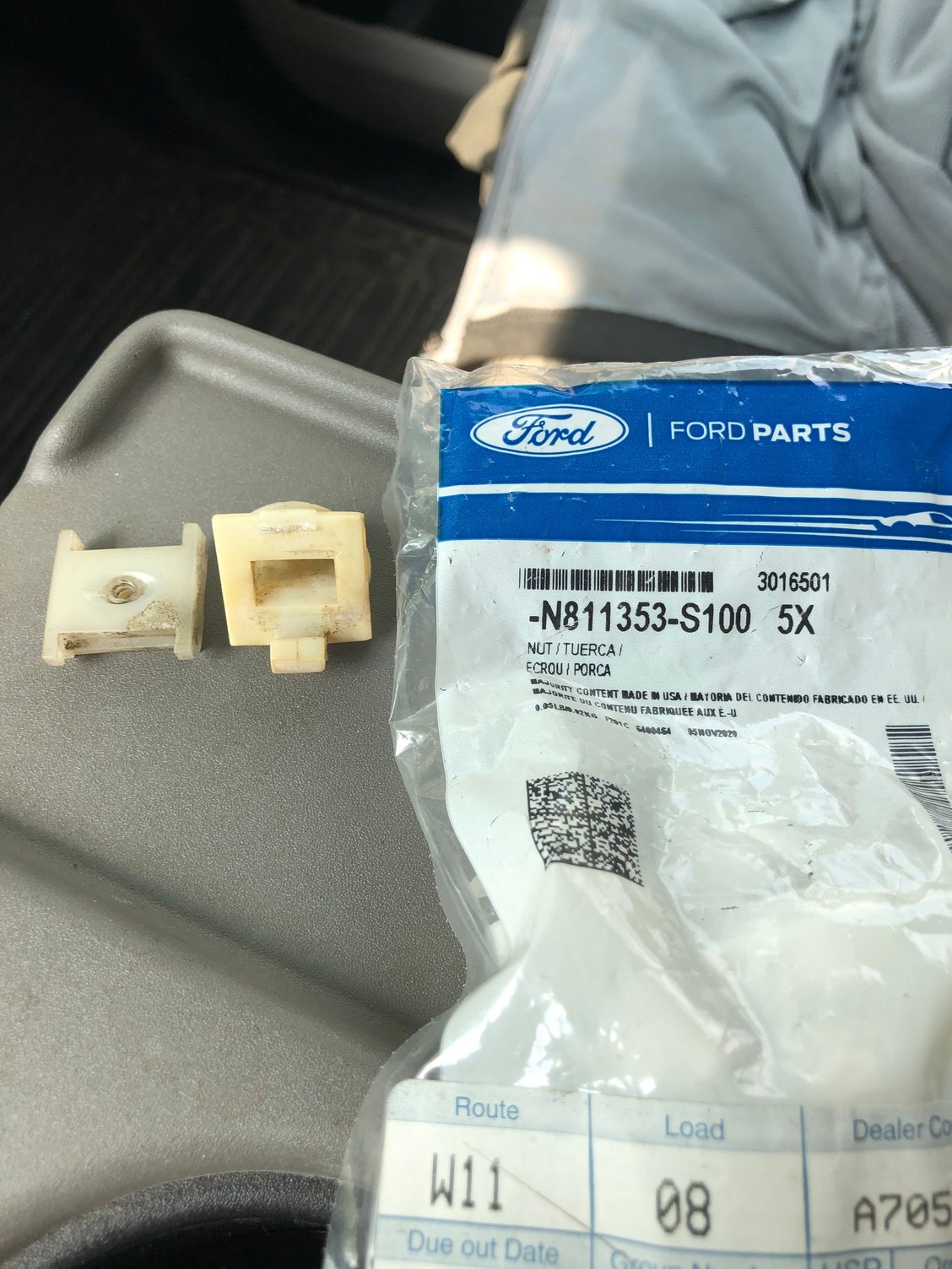

I did manage to source them. I’m going to call Ford tomorrow and see if their available as singles since Lordco only sells them in a package of 10.
Worst case I take the 10 and can have them by noon tomorrow.

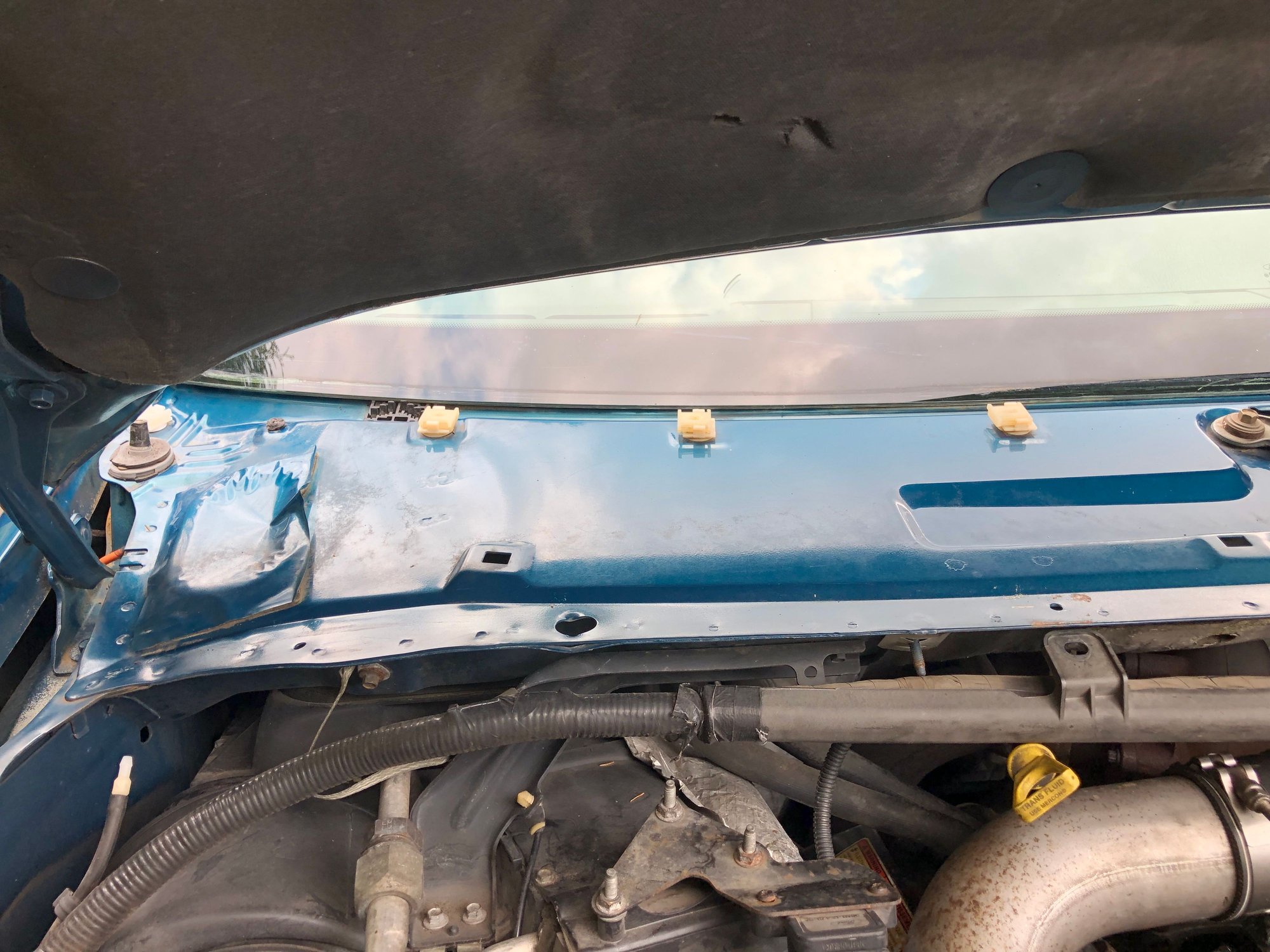

I was going to ask how many of those clips survived, things like that get crispy.
Are there any bolts retaining the cowl, or just clips?

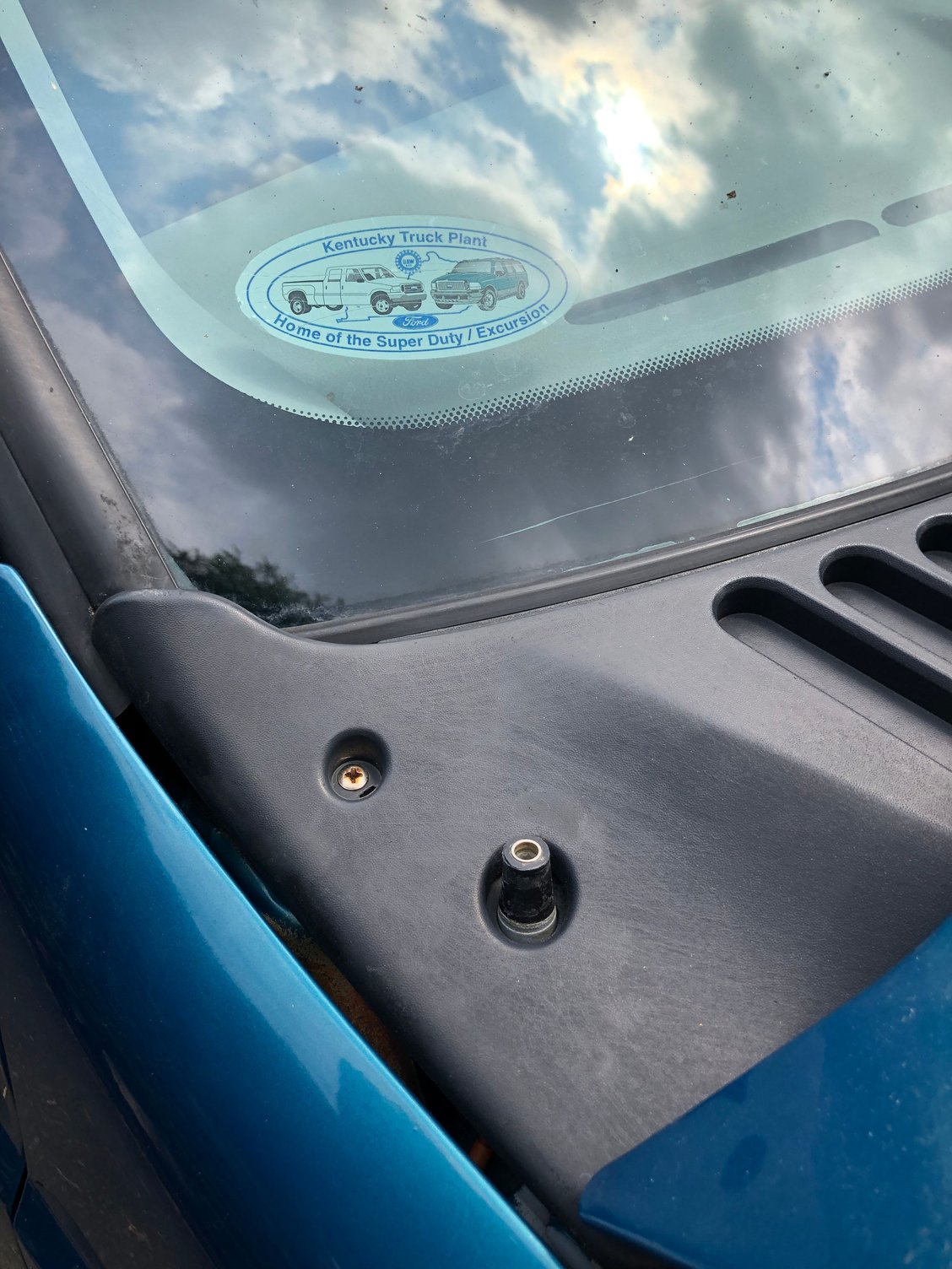

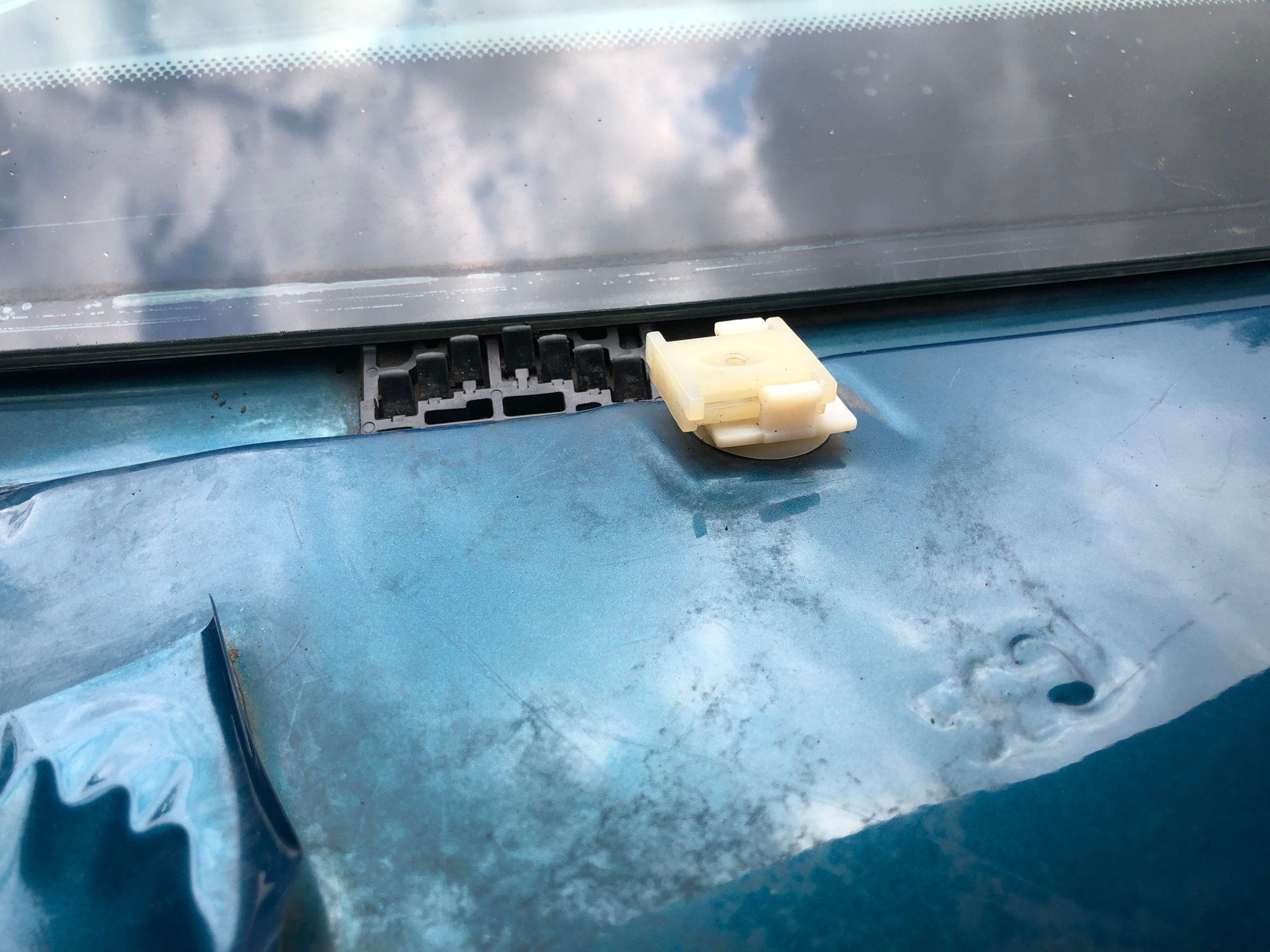

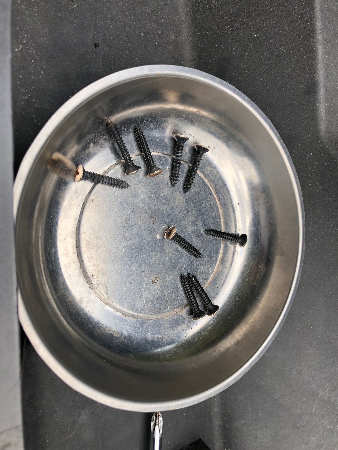

They are screws. 9 in total that go into a slip joint type of plastic insert. I’m assuming that this is a 2 piece to accommodate for thermal cycling.
$18.09 for a 5 pack from Ford after taxes.

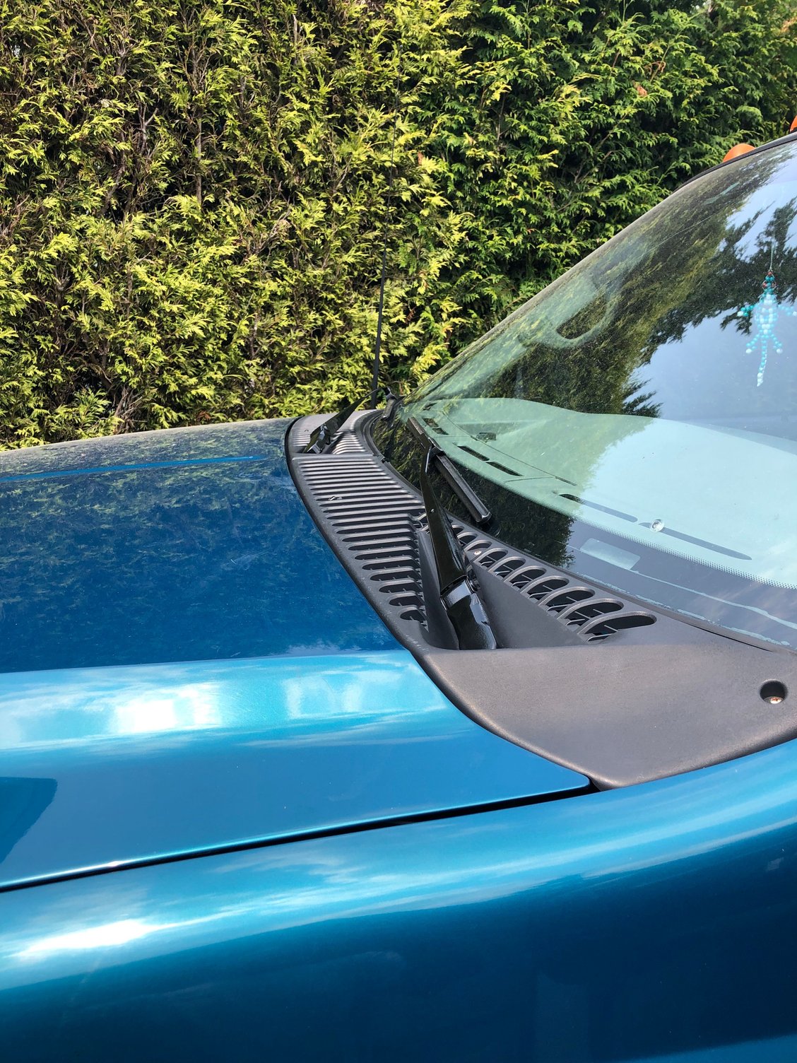

Got it all buttoned up.
Nice and clean now.
Slide right
Left
Screws for cowl vent
All done.
This should be added to the fastener size chart.

Looking good sir!
How much was the 10 pack from your other source? Just curious.
Aren’t they gonna have to take that back off to replace your windshield?
Lordco was just shy of $30.00 for the 10pack.
The “cowl vent” / valance / nut and bolt holder thingie will need to be removed for the windshield but the grommets don’t. I didn’t replace ( just reused ) the black plugs on the under hood side for that reason.

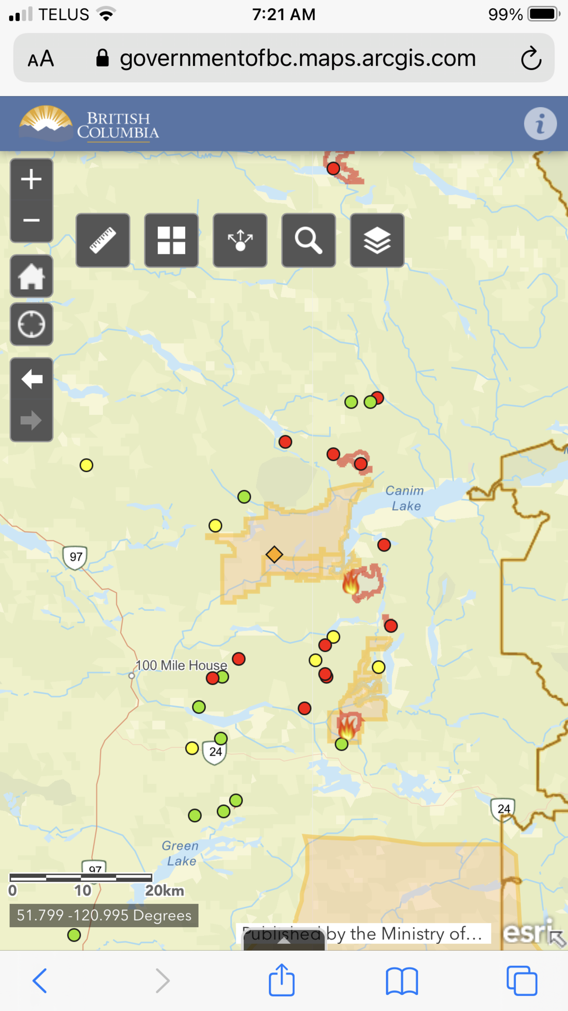

We chose to stay home instead of headed to the property for this week due to massive amounts of forest fires directly following our record breaking heat wave.
We are slightly NE of 100 Mile House
Snapshot of our Province. We keep having dry lightning storm’s sparking new fires.

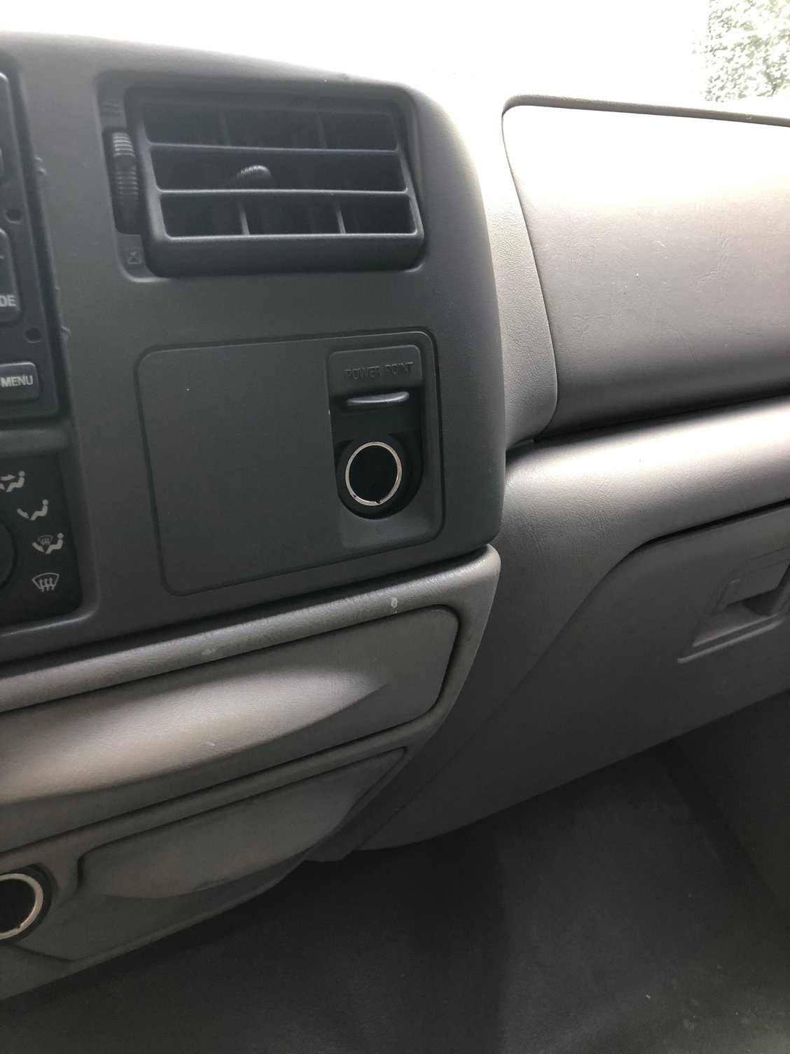

I bought this figuring the hard wire installation may be cleaner when put into the accessory charging port instead of plugging in a USB/ voltage meter.
This way I can slide the cover closed, out of sight, out of mind, nice and clean.
Now I’m starting to question my logic since it is an always live circuit and what the parasitic draw may be from the LED voltage gauge.
Am I overthinking this… should I run it to an ignition source… install an in-line switch… or go NIKE, just do it???
