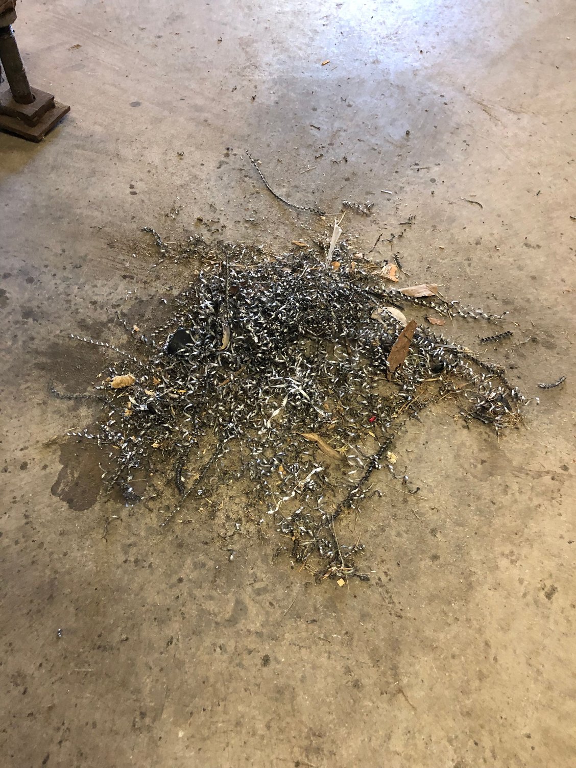

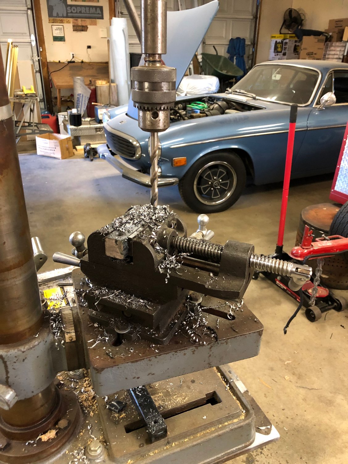

Shredding metal. One spacer done and ready for cleanup.
Hopefully get this part finished tomorrow.
Roll plates still haven’t come in.

Got the last of the spacers drilled today and cleaned up for painting. Still have to prep the lower brackets for paint.
Saw a carpenter on a job site the other day wearing a t-shirt that said “ SAWDUST IS MAN GLITTER”. I chuckled to myself.
Today I looked down at the pile of metal shavings from drilling the holes.
At least my glitter is shiny.

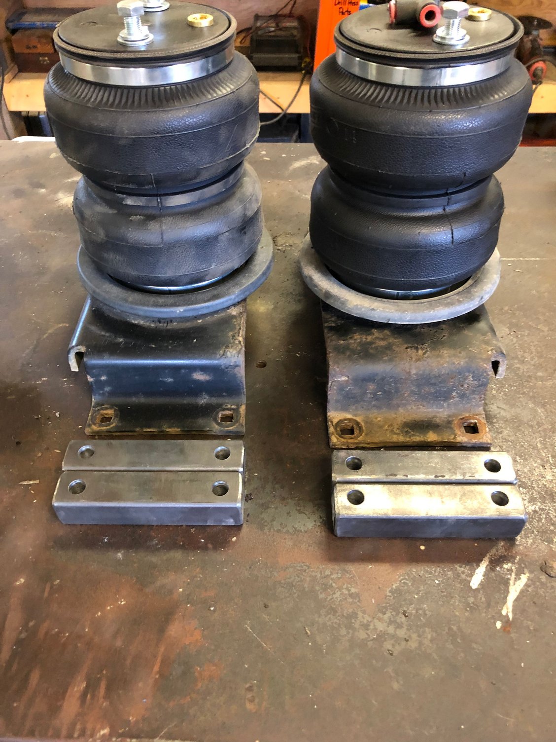

Those are some beefy looking airbags. I'm assuming you made the spacers so they're not stretched when the suspension is at full droop?
Your glitter might be shiny but it might also give you tetanus after you sprinkle it over yourself.

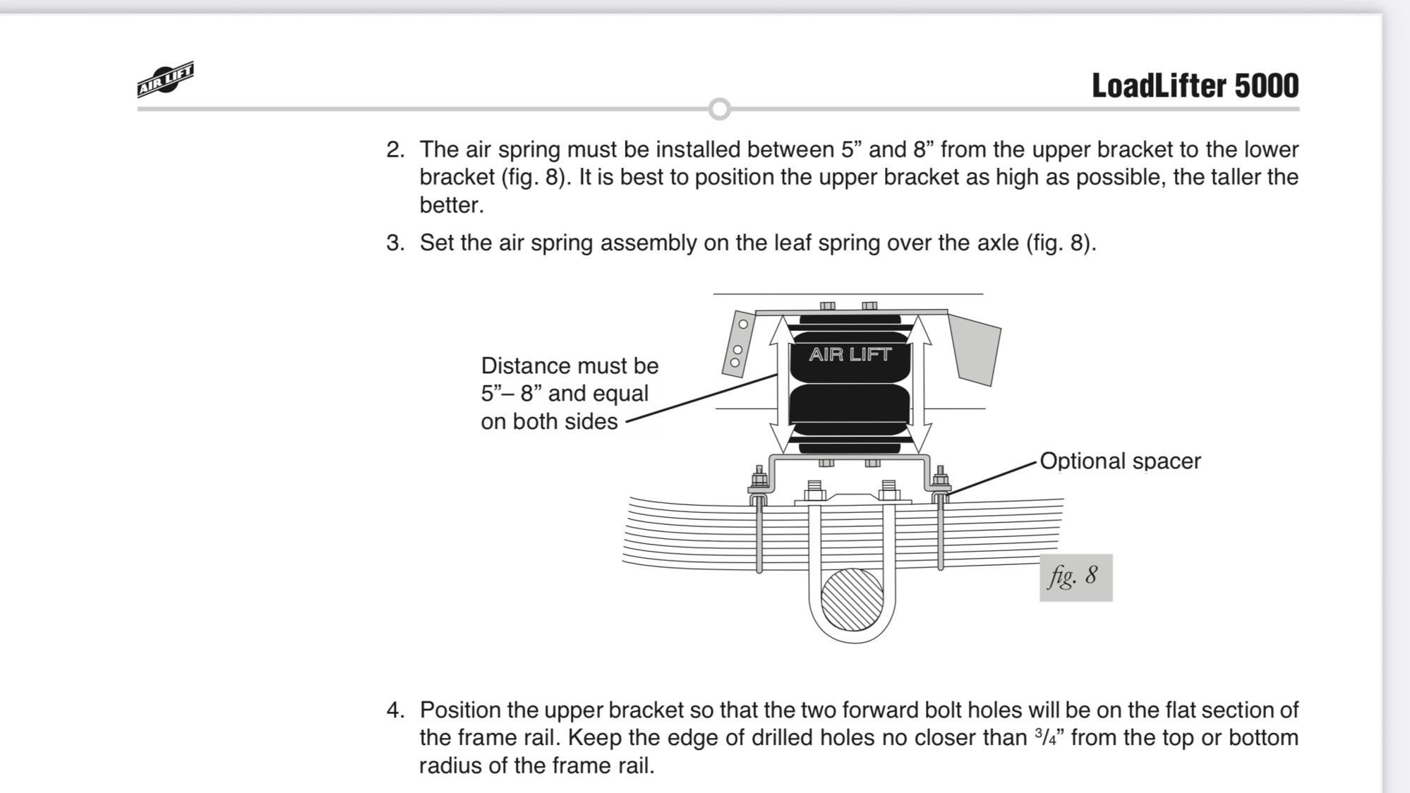

From the research I’ve done as per Air-Lift
Non jounce bumper bellowed bags have a maximum distance of 8” between brackets with a minimum of 5” at normal ride height.
Jounce bumper bellowed bags max is 7” with a minimum of 5”.
Whoever installed mine originally clearly didn’t see this and at normal ride height was just under 9”.
The replacement bags I chose are the 50201 non jounce so the 1” blocks get me within the 8”.
I wasn’t planning on spreading the glitter around so the chance of outer membrane puncture leading to tetanus is slim to none. In fact I took great care to pile it for photo op then deposited into disposal receptacle.

Good job. I must admit I myself did not do as much due diligence as you have when I installed my air bags. All I did was follow Firestone’s instructions on where to mount the brackets for a given amount of suspension lift. It has all worked out as luck would have it. The first time supporting the truck by the frame and allowing the axle to droop all the way was nerve-wracking.

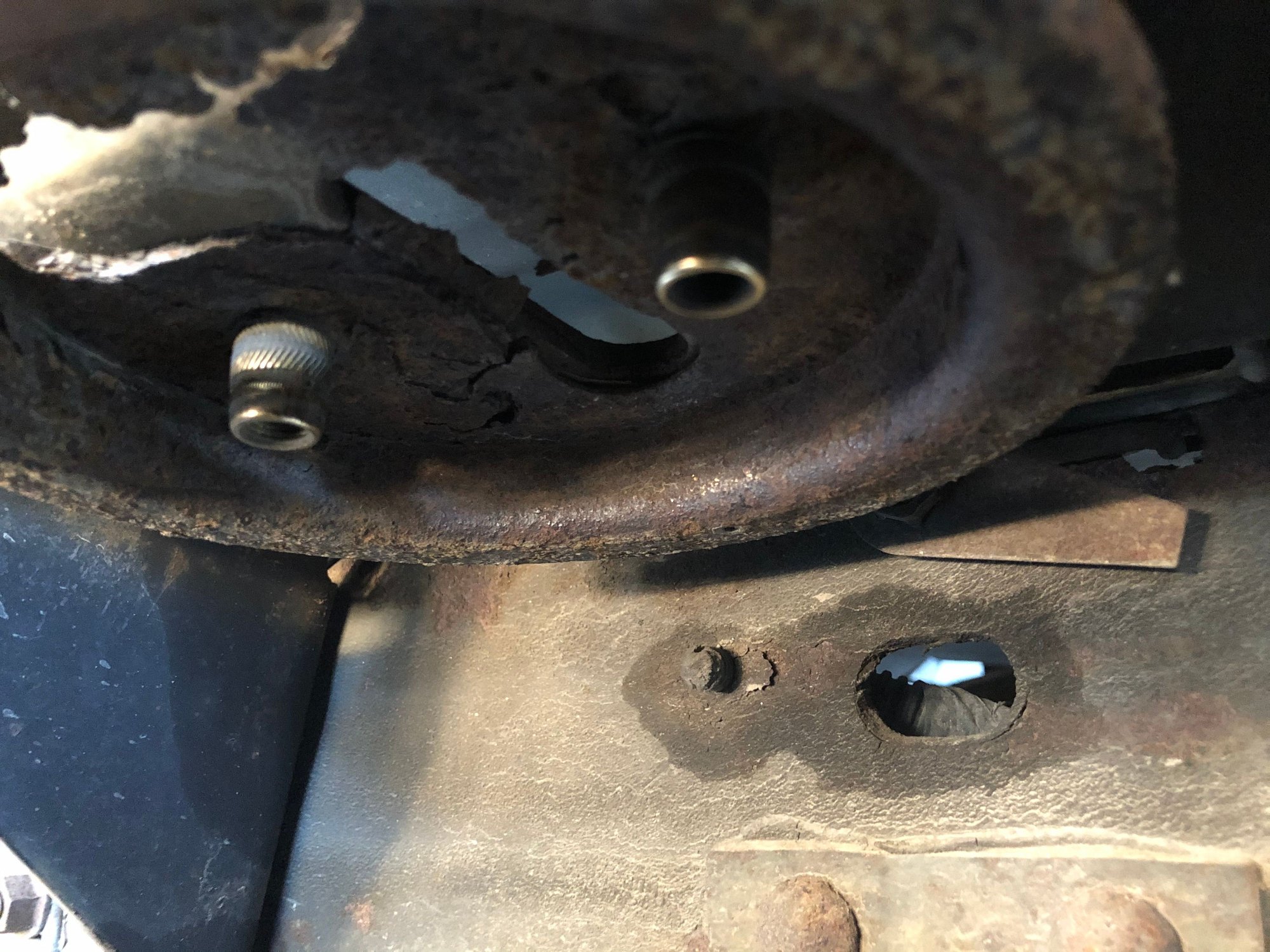

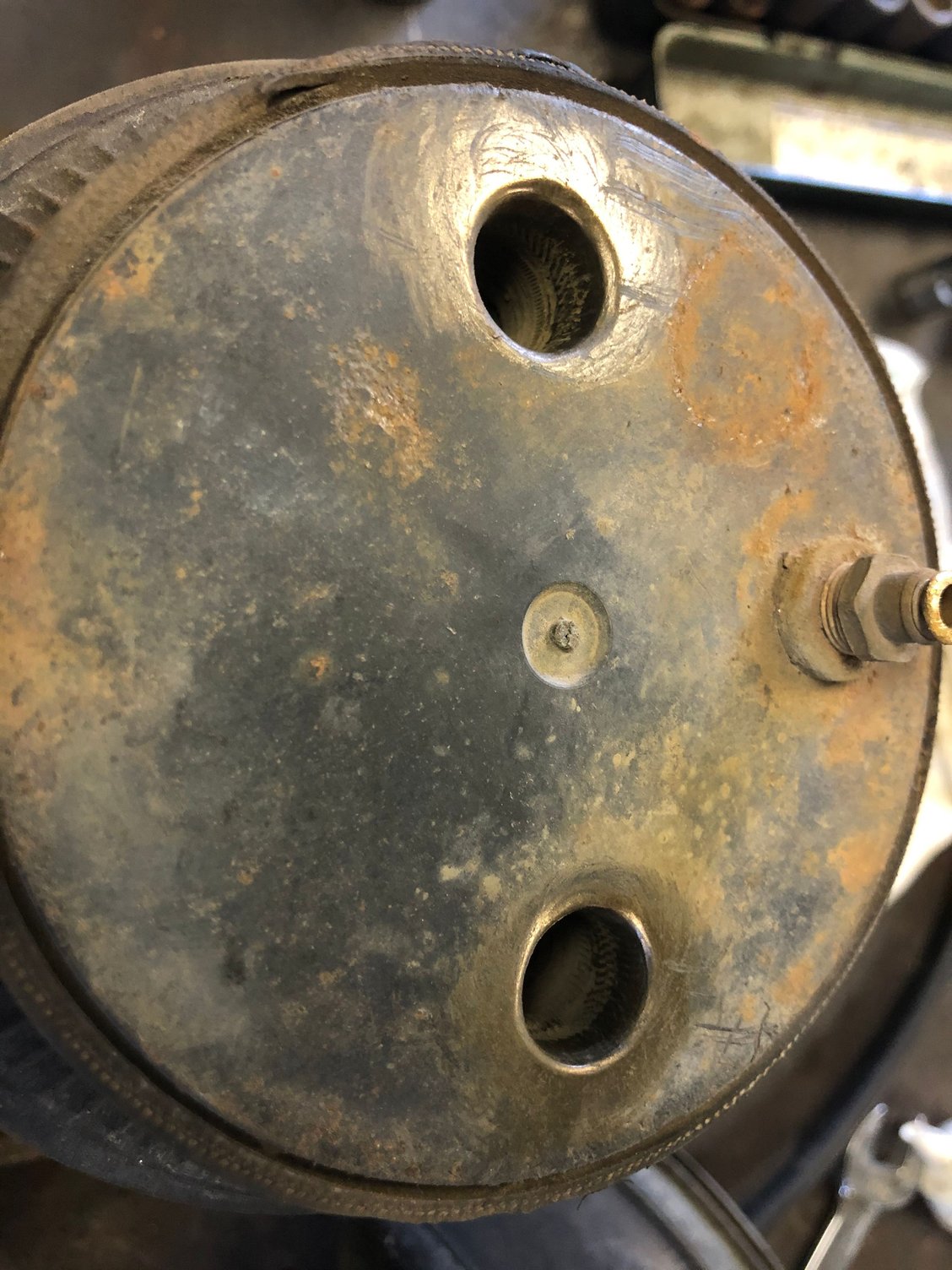

Once I discovered the failure mode of the previously installed bags I did some homework.
I figure the issue was twofold.
Primary cause being zero pressure for far too long. My bad.
Second being the mounting plates were too far apart and stressed the pressure fit brass inserts until they pulled out of the top of the bags.
Wow. That bag really got stretched. The Firestone bags have integral studs on bag end plates instead of press fit bushings.

I don’t think that them being stretched is the issue at all.
The closest to being off road while I’ve owned the truck since 2004 is a gravel driveway.
Im spitballing here but my best guess is constant jarring from segmented concrete freeways from my trips down into Washington State compounded by under inflation and 9” instead of 8”.

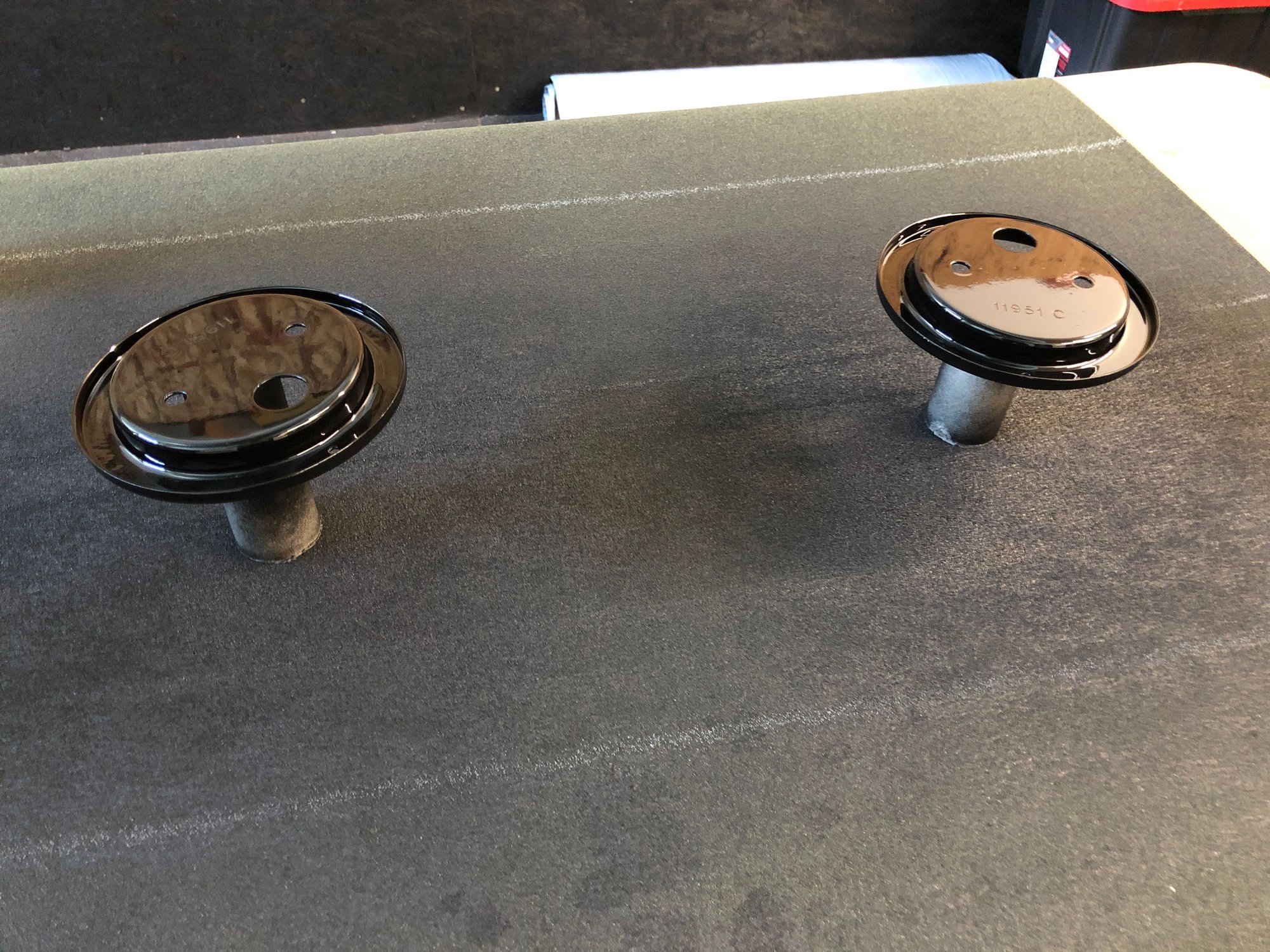

Got a call today. The local supplier found the roll plates and come get them.
Coffee break at work this afternoon was spent applying paint.

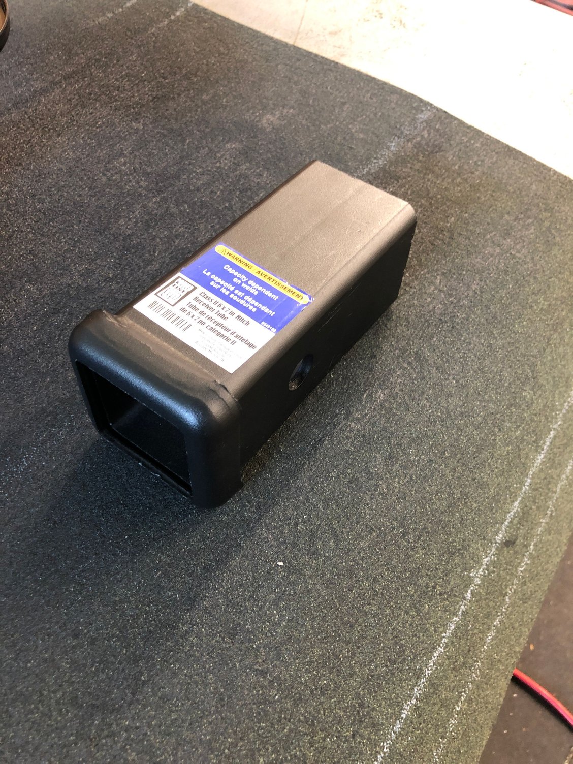

I also picked up the 2” receiver stub that I believe was mountainmanrob who showed as a weld on to the outer hitch tube for storage of an unused hitch. I will get that welded on Saturday before all the kids show up for a BBQ.

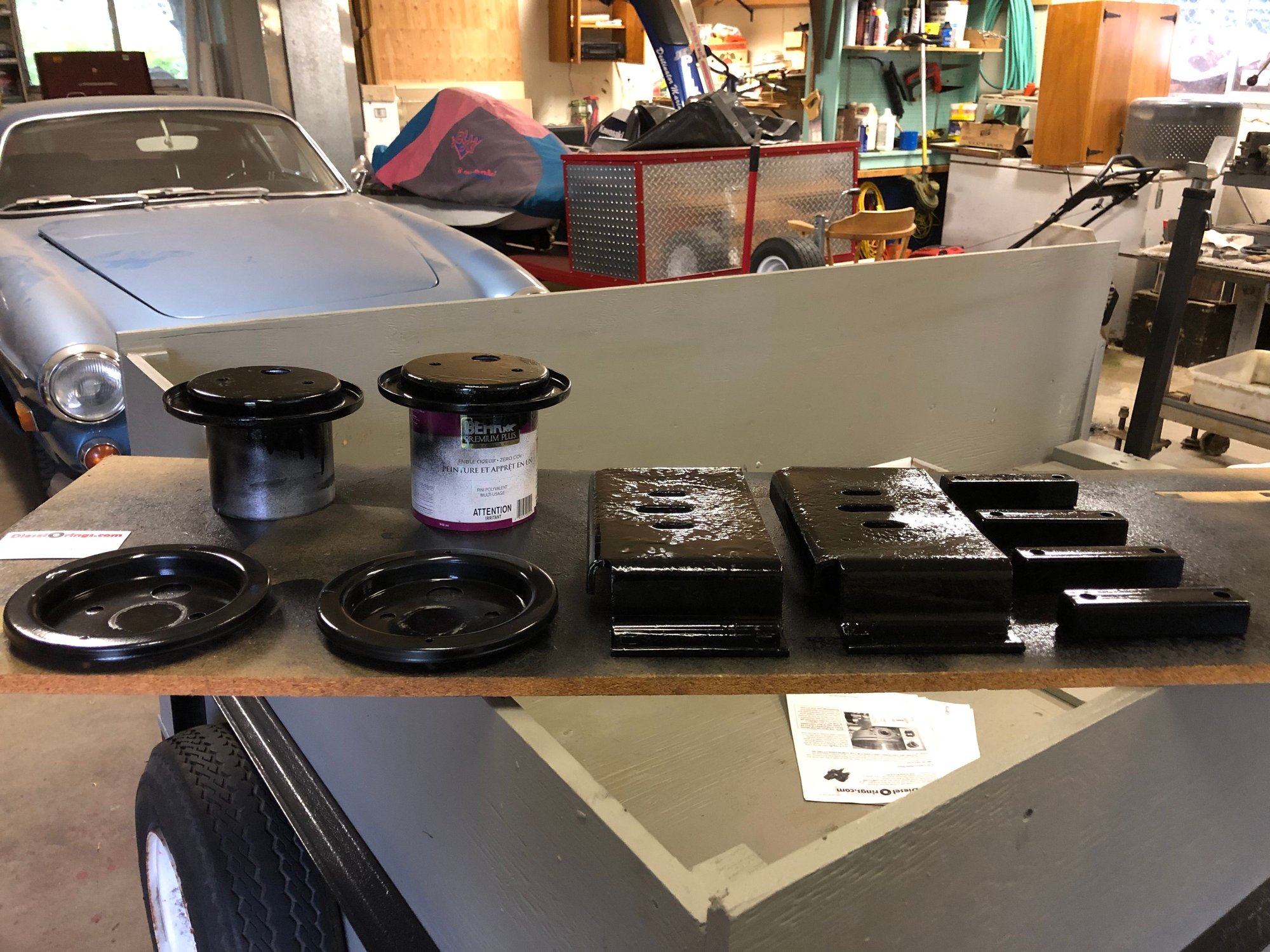

Everything is painted and now waiting on it to dry for the install.

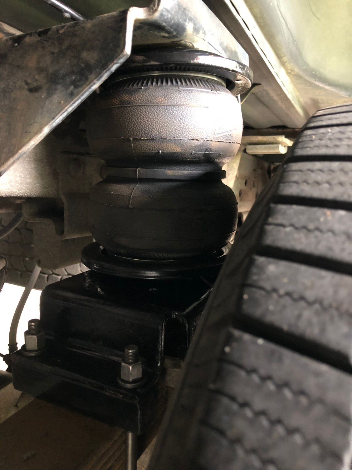

All done with the airbags and test drive completed.
What a difference in the ride quality, so much smoother. Aired them up to 20psi for now.
Serviced the rear slide pins as well when I had the tires off.
Didn’t have my phone on me while I was doing the work so here is the completed installation picture.

Looks great. I hope to accomplish something similar when we return home.
Thanks for documenting your work with manufacturers measurements and your own work.
