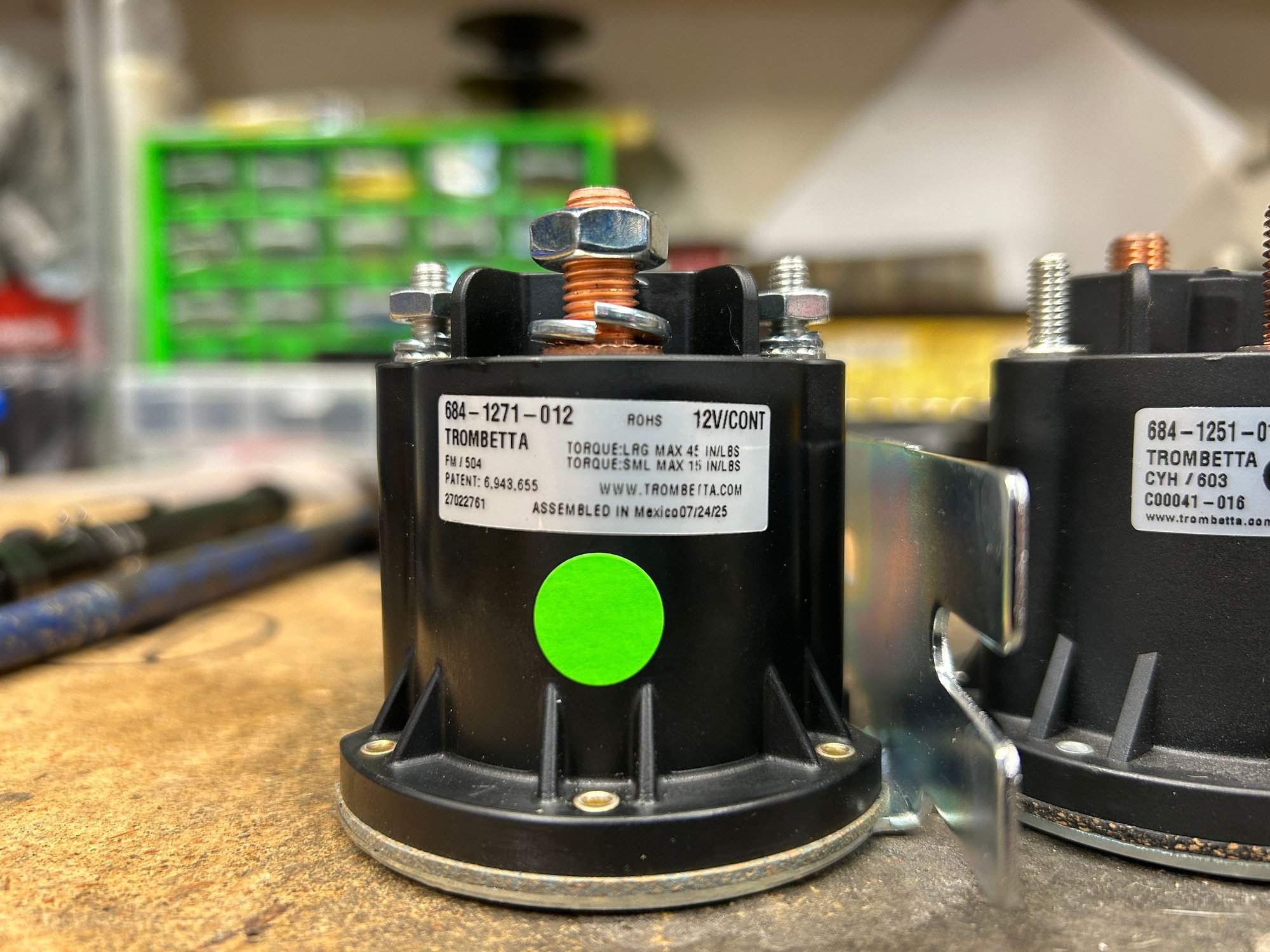

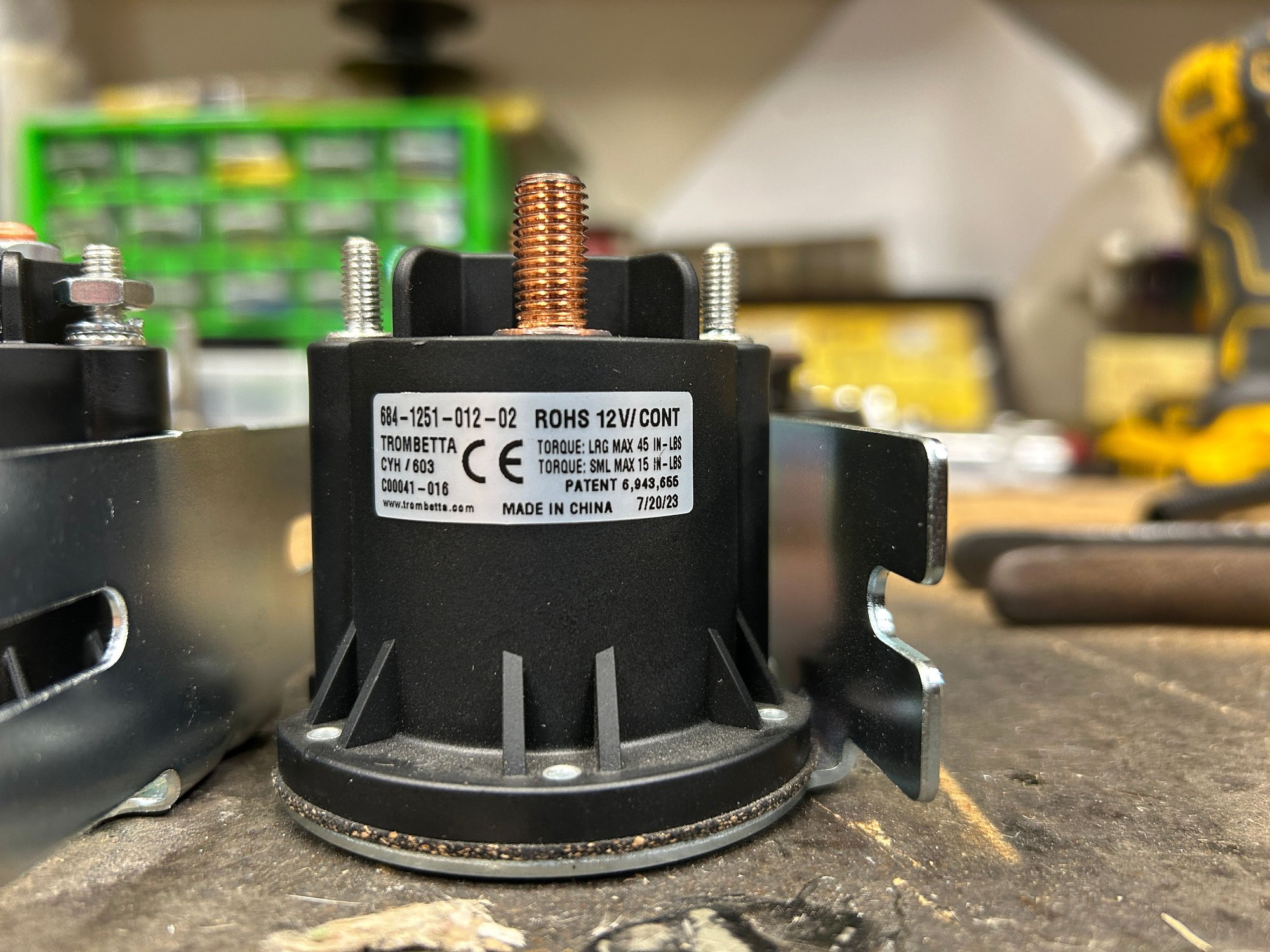

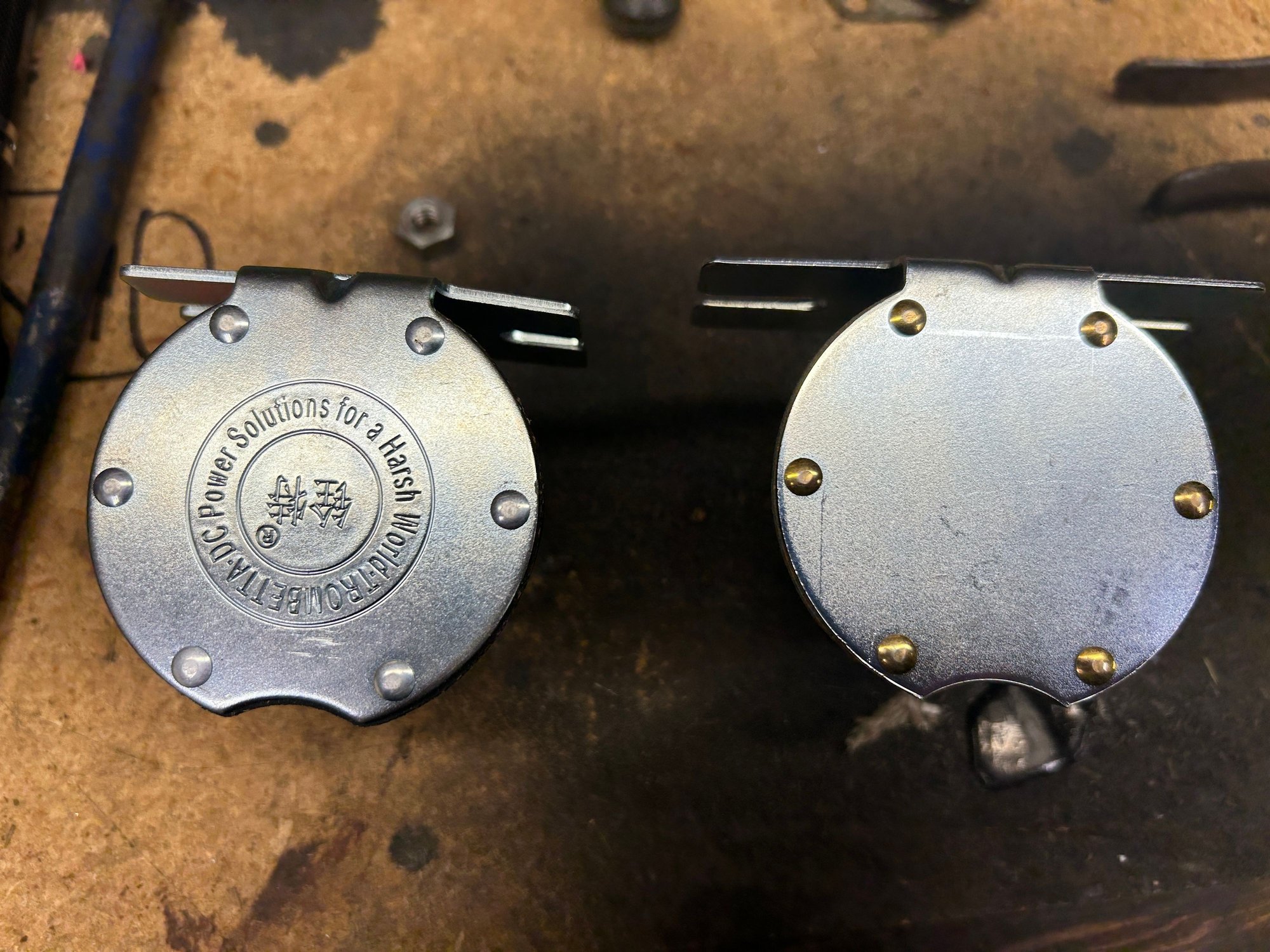

Comparing the two trombetta relays side by side.
One made in Mexico the other made in China.
Anybody who has installed one of these do you remember if yours was stamped on the bottom?
The China is stamped, Mexico is not. China has a thicker steel for bottom and mounting plate than the Mexico.
Mexico sold by MurCal.
China sold by Amazon.
Old Jan 23, 2026 | 10:54 AM
  #1213
FordTruckNoob's Avatar
FordTruckNoob
Joined: Jan 2005
Posts: 13,127
Likes: 4,727
From: Henderson, NV
Only one way to find out which is better: destructive testing.
Run 24VDC 50A through it switching at 5Hz then see which one dies first.
