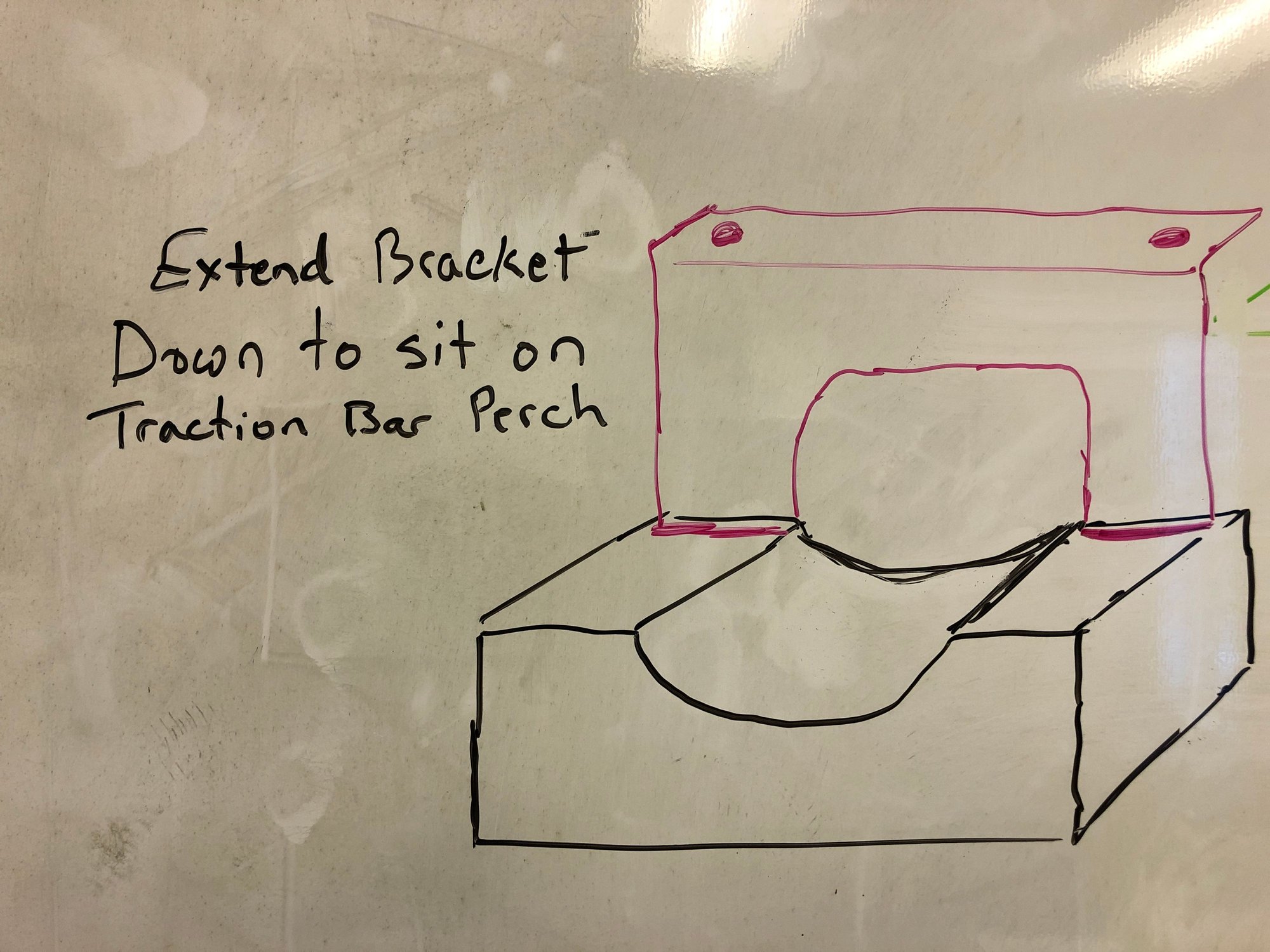

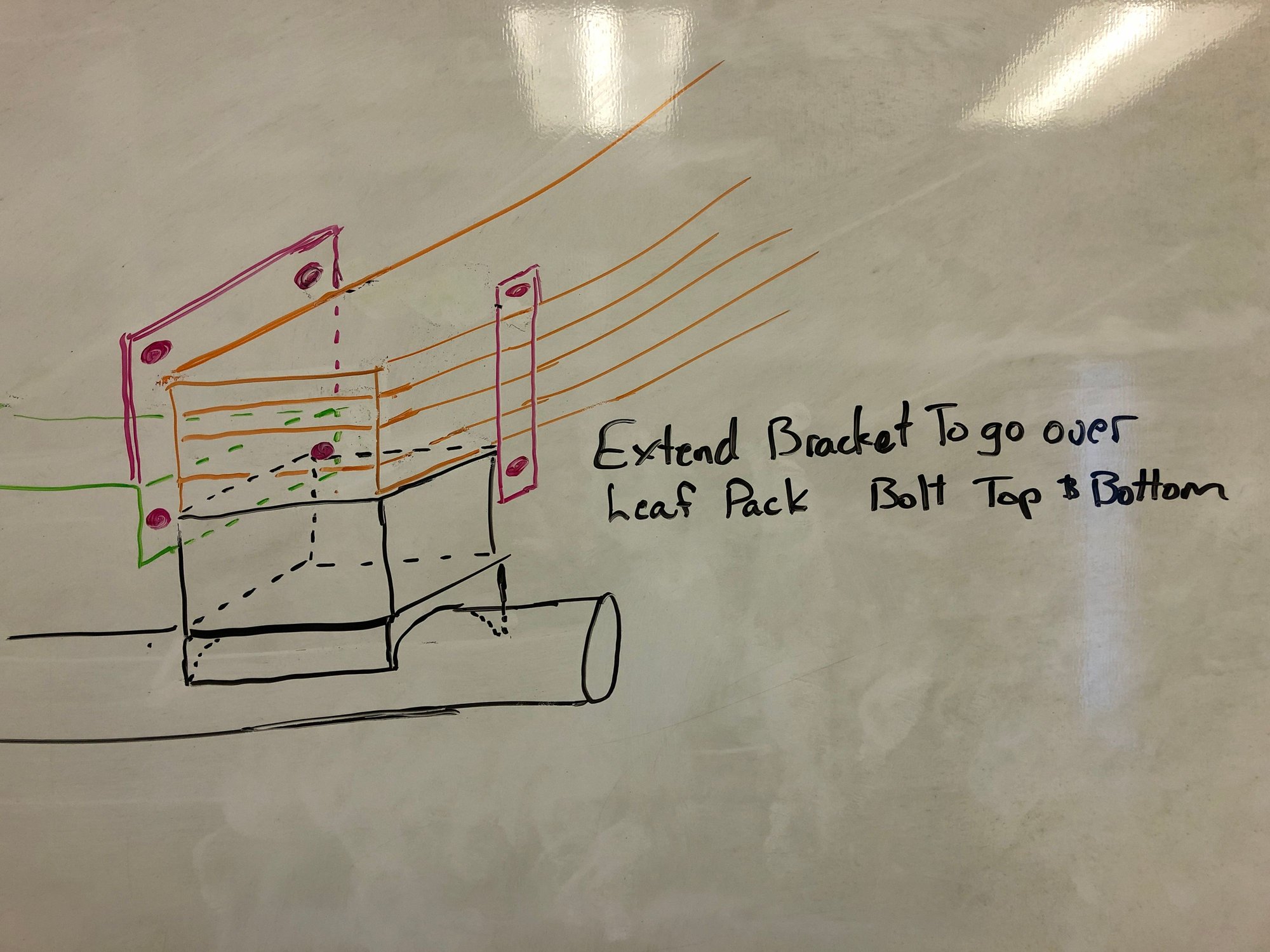

Sitting at my desk thinking instead of working.
So from what I understand the key issue with yours and Sous’s setup is the possibility of the over axle tube bracket rotation. Which recently Sous has experience. Granted that moving the bags farther out on the axle will add better anti-body roll stability but here is a spitball low cost solution.
It wouldn’t need to be too skookum Mad Ape strong since it’s only to prevent rotation.
Crude drawing but gets the point across.

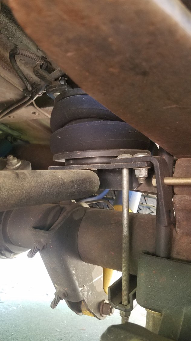

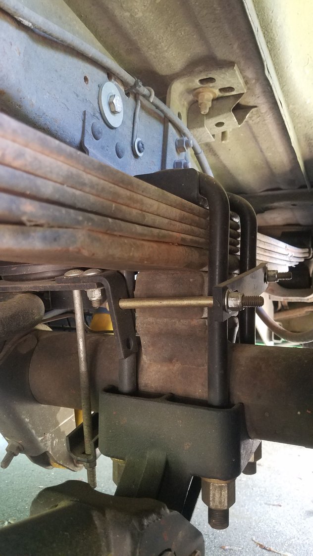

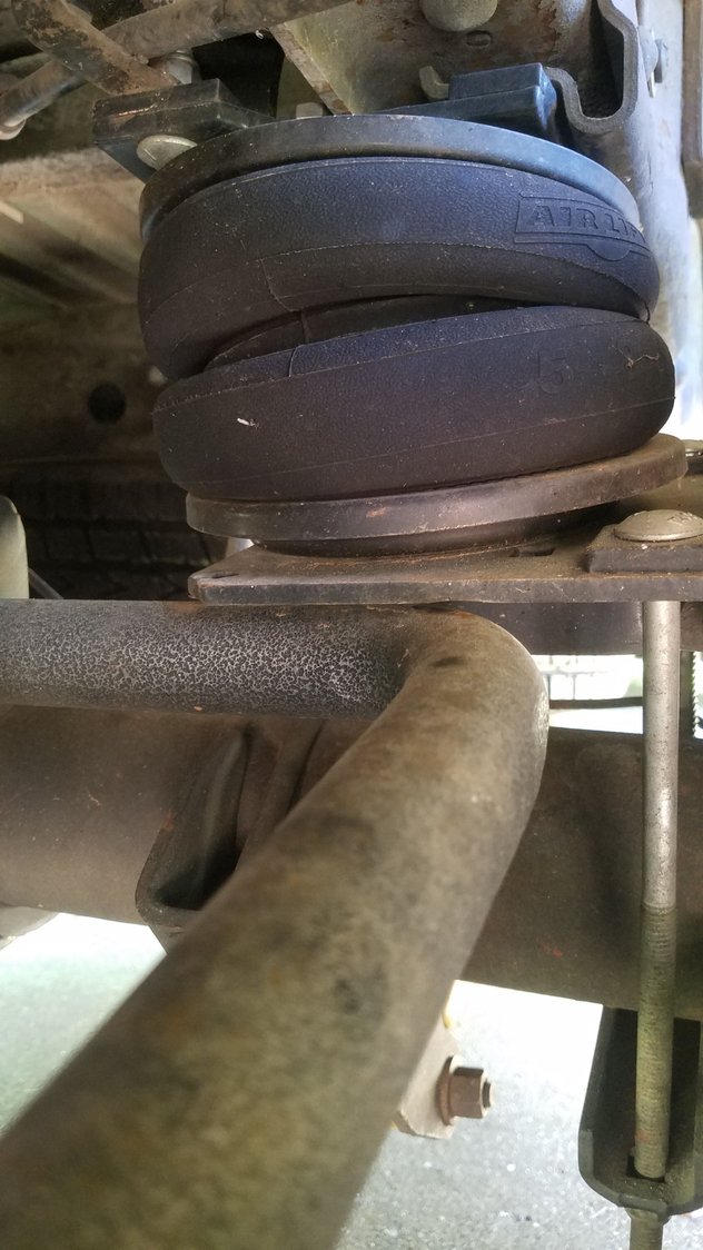

The problem with the AirLift over the axle mounts is that there is no good anchor point to keep them from rotating forward. The two horizontal brackets in front of and behind the block don't do a good job of keeping the vertical brackets and bottom bag plate level.
These are the pictures I snapped in IL when we stopped for a couple of days. You can see the sway bar is contacting the bracket and how the horizontal supports are just a poor design, on my opinion.
The passenger side is not this bad, but not good either.
I have never liked this design and will me installing outside the frame, over leaf brackets. Despite the poor design, the air bags work quite well.
During my brief search out of frustration with the AirLift mounts, I saw some adjustable blocks by Firestone that could work well for over the axle. But, each time I find myself coming back to over the leaf due to the simple and well functioning design.
@Sous
Certainly is hard to pull a diamond out of a pile of manure.
Sorry for the rudeness but oh my gosh, now that I’ve seen it installed. No wonder you want to change it.
Not only is there no ability to stop rotation, but that is a ton of cantilevered stress on that bracket and IMO should have an additional support leg down onto the axle tube.

Your not being rude, you are calling it as you see it. On the contrary, I appreciate your candor and allowing us to steer your thread a bit off the rails.
Your renewal of your air bag brackets could not have come at a better time for me.
I think the **** poor design has turned me off on over the axle brackets. Again, I never liked the design and now I am ready to go a different route.
Lesson learned and it won't be the last one, I am sure. I prefer to give products and people at least a second chance, but this design has had several chances and I will through them in my burn pile and post pictures of the melted remains if I can find them among the ash.
I had thoughts on making or having a local fabrication shop make a more robust and properly sized bracket similar to what you drew. I am done with them though and see only benefits to going with the leaf support brackets.
Other than cost and a bit of time, there are no downsides that I currently see.
Sir, thank you again for allowing us to discuss this failure point here. I plan to create a new thread when I get home and figure out a course of action.

Also, those bags, springs and suspension are fully compressed with the full pin weight if the 5th wheel at the campground in IL.
They are internal jounce 5000 bags.
