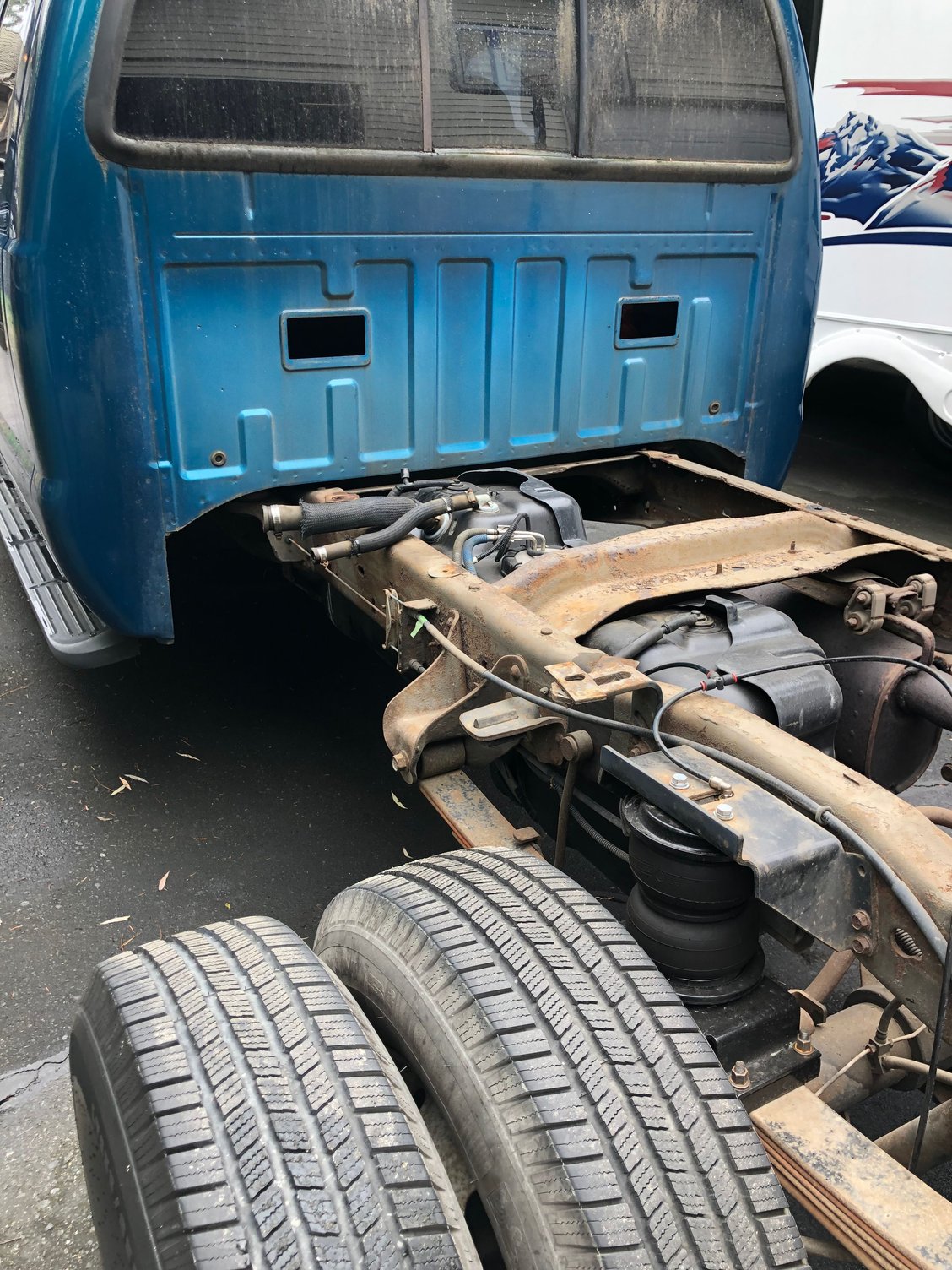

It’s a piece of cake to pull the cab vents with some tenacity.
Had I known 3 months ago I would be standing here staring at this I would have waited to do the hutch and harpoon.

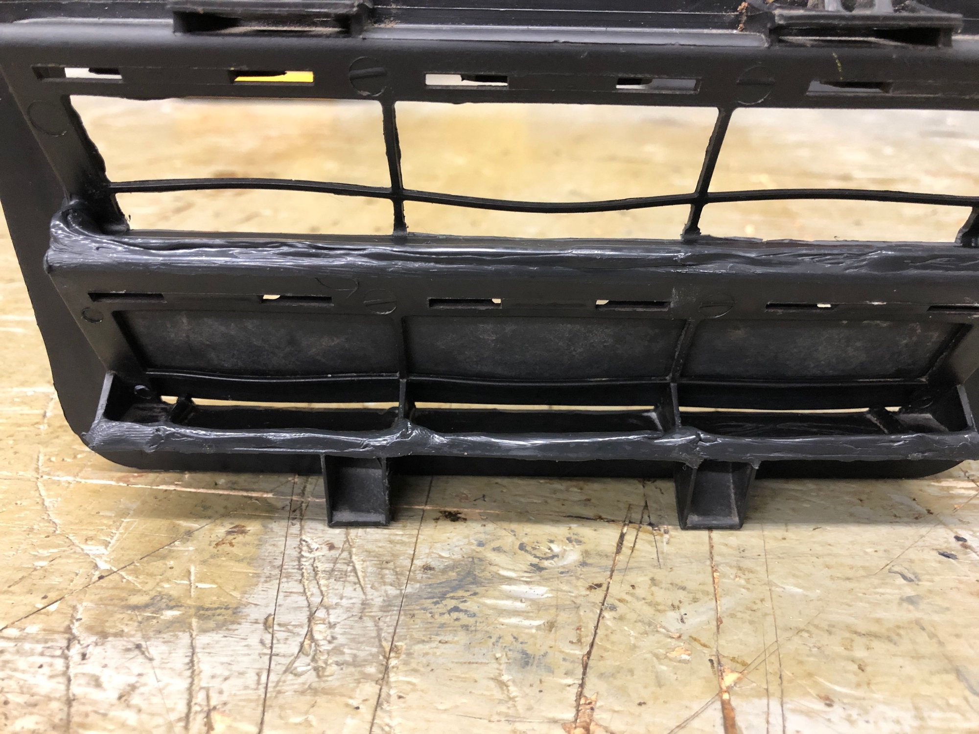

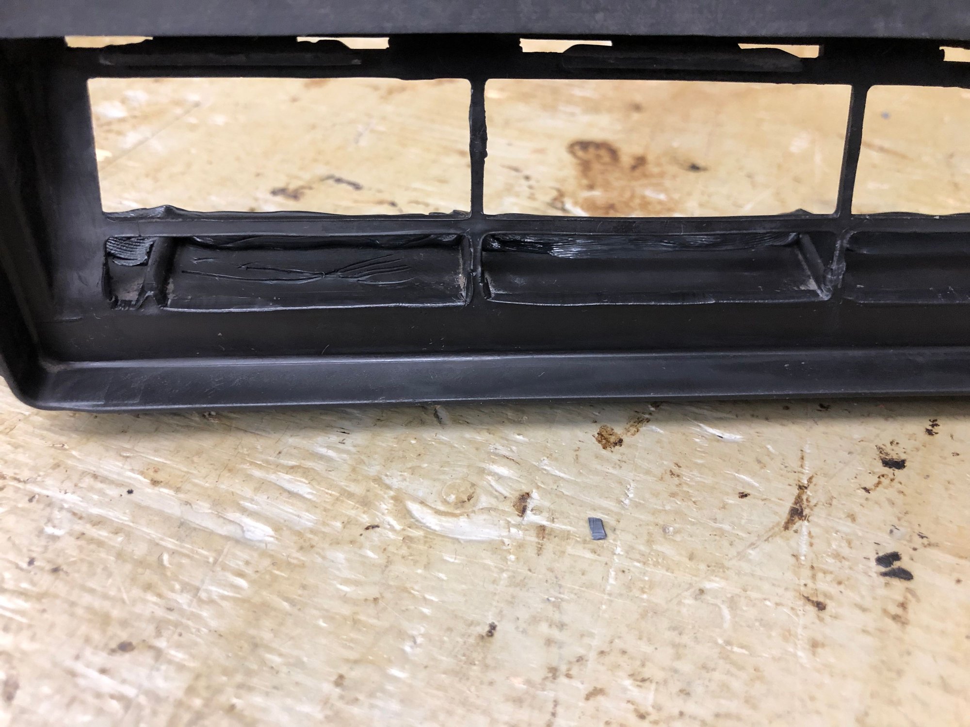

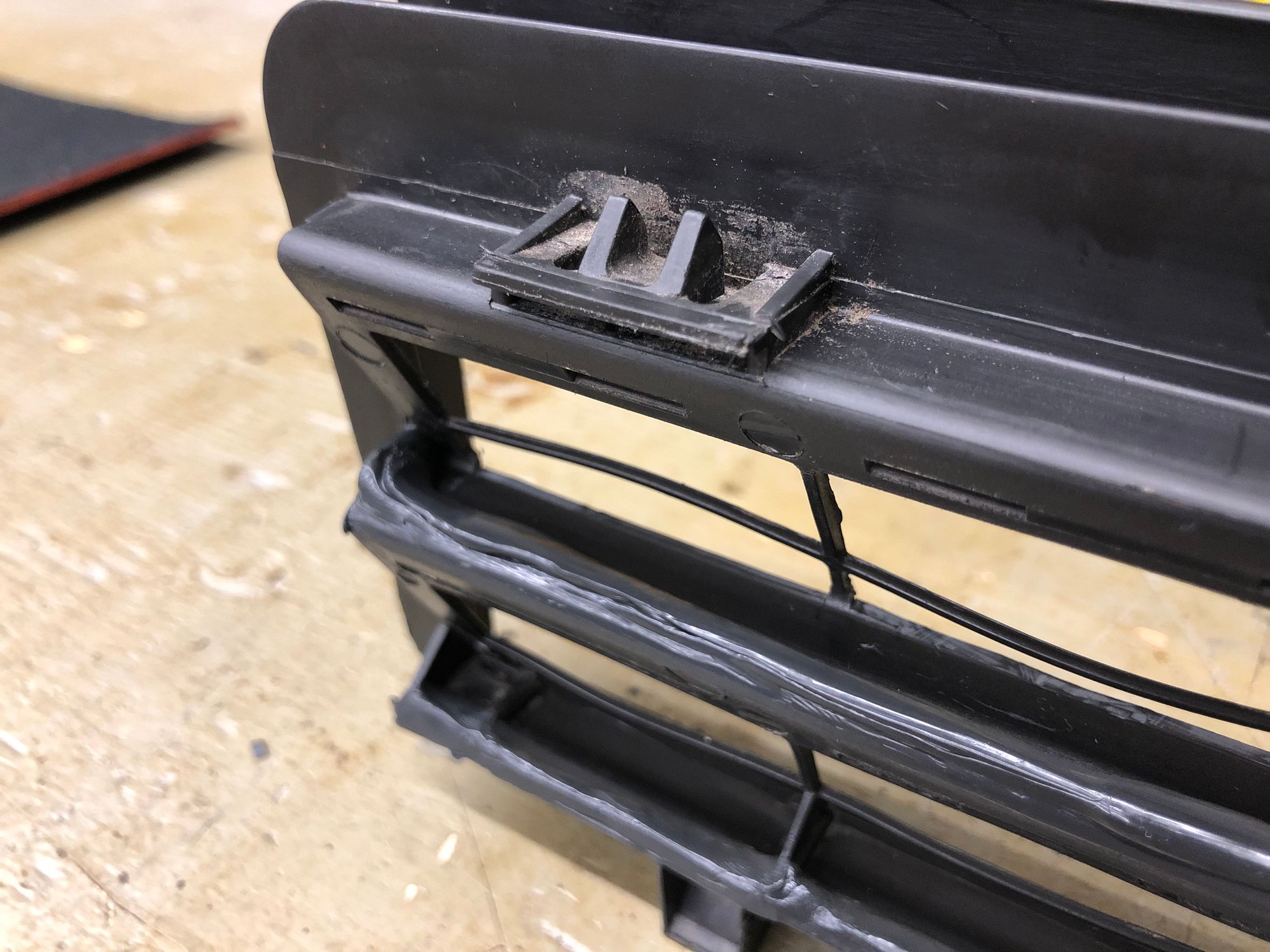

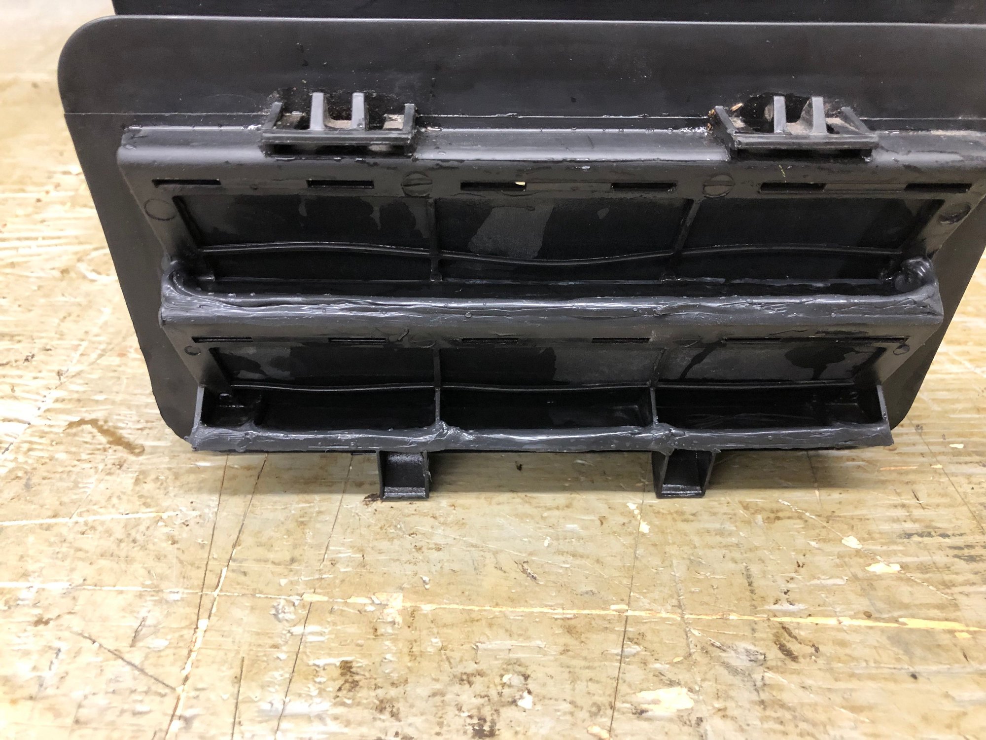

As for the cab vents. I see a couple of major design flaws. For one if you look closely at them the bottom vent opening has a side dam to prevent any water that does get in from running over the edge and down the side. The top does not have this side dam.
Second issue is that when, not if, water gets in, there is a small lip at the lower slopes side which will help the vent to retain water and prevent it from draining out properly.
I am currently testing some caulkings for adhesion to the plastic and will build up the sides to create a side dam on the uppers, and will trim down the lip on the lower sides to promote better drainage.
Lower side dam. Note the slight lip at the drain side which will be trimmed down to flush.
Upper without the side dam, and lip is present on the upper as well.
I will also place a bead of caulking along the back leading edge to create a better back-dam.

Today I managed to get time to trim out the water retention lips.
Got the caulking done for the sides and back edges. That was a tough little spot to get a small bead in there then smooth it out to make it look good.
Im going to use a butyl tape to seal them back to the cab similar to what is used in the RV industry for sealing the corner beads.

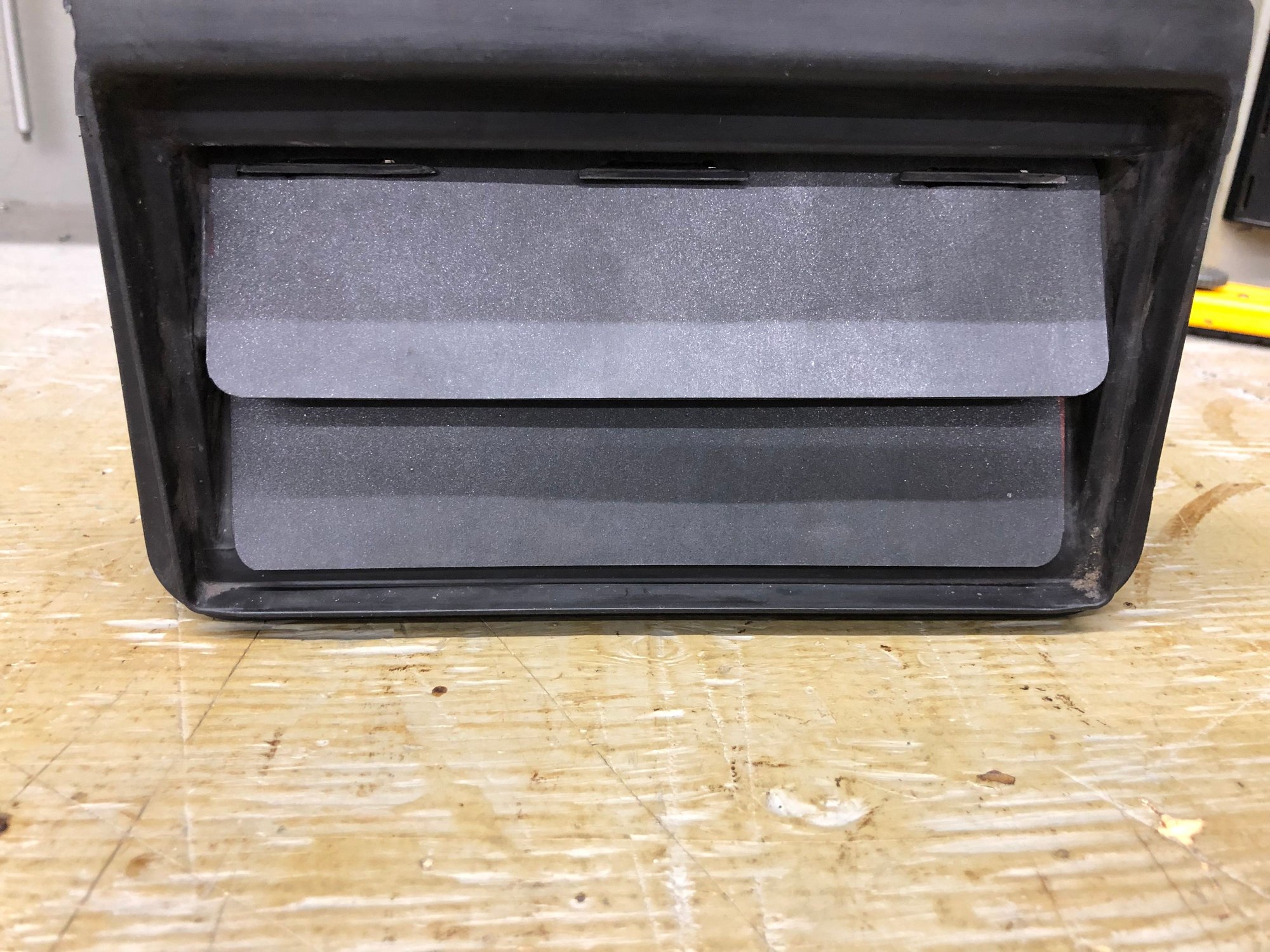

One thing to note from trimming the lip down is that the rubber flap no longer fully seals against the plastic housing.
I’m assuming that this is an EPDM flap but is much thinner than anything I’ve ever used in the roofing industry. I have lots of products available to me that I could make longer flaps out of however it needs to be a stretchy product to be able to fit over the hooks that hold it. The search is on. Worst case scenario is I use use a much thicker .045 EPDM since the air pressure when closing the doors will still move it.

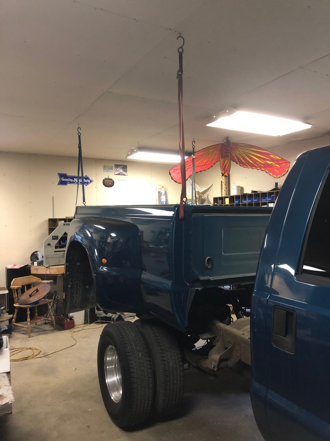

Man what I would give to have the lift your box is sitting on in the background.
Mine is currently hanging from 4 cargo straps that are attached to hooks into the trusses in my shop.

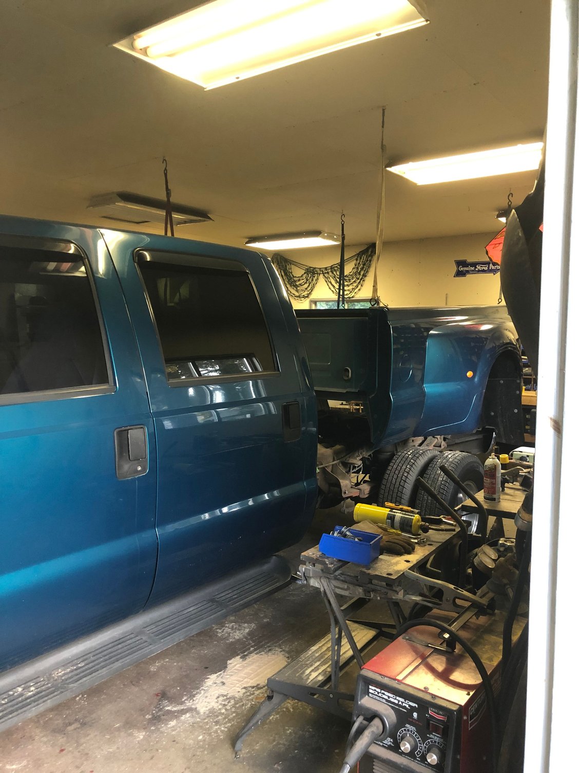

Here’s a couple pictures of how the box is currently hanging.
My shop is plugged full with the truck inside while I get the vents done.

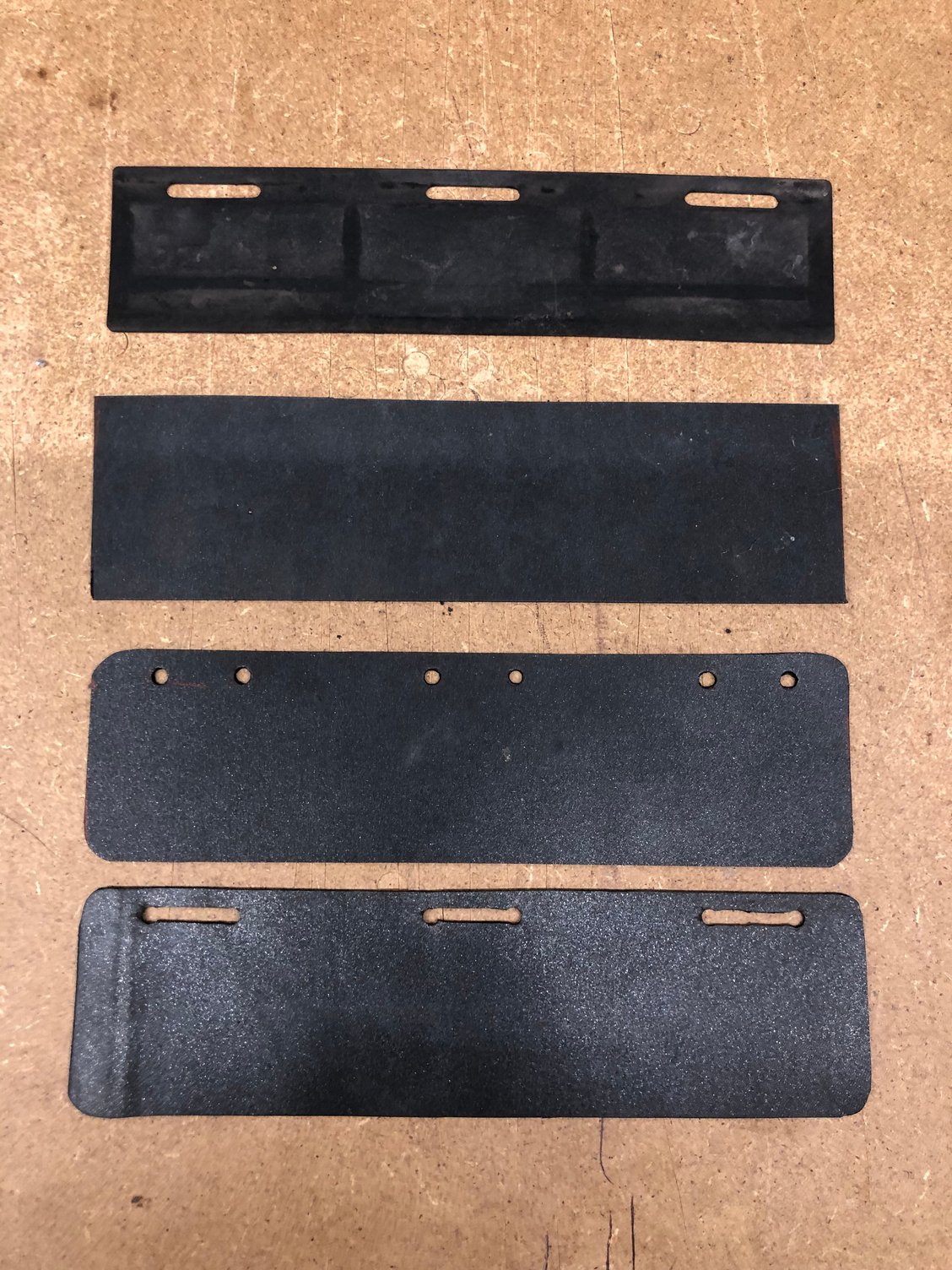

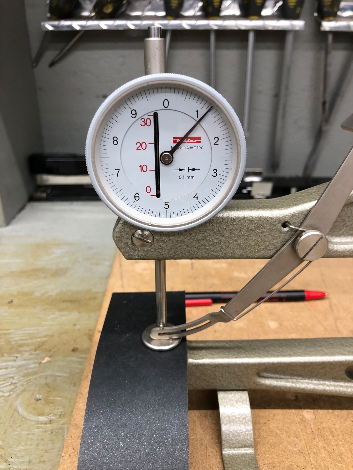

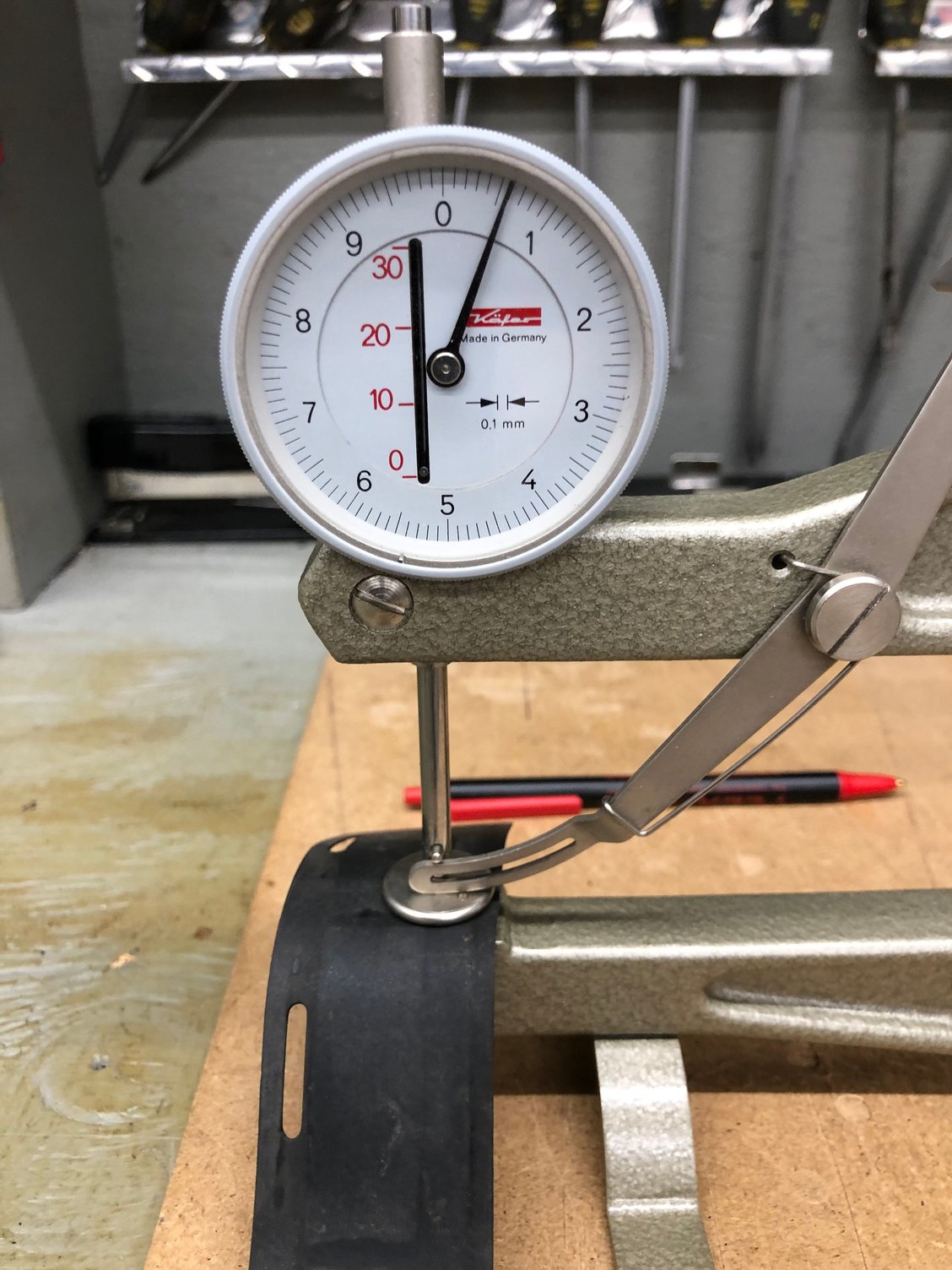

Picked up some .045 EPDM from a contractor this morning. It’s double the thickness of the old flaps.
Old flap
New material.
Cut them to size first. Then hole punched prior to cutting out the keyholes to hang them on the hooks. EPDM will easily tear if the ends are not radiused.
Seemed quite heavy when hanging so I did a water test and they drained perfectly.
Finished product ready to be installed tomorrow.

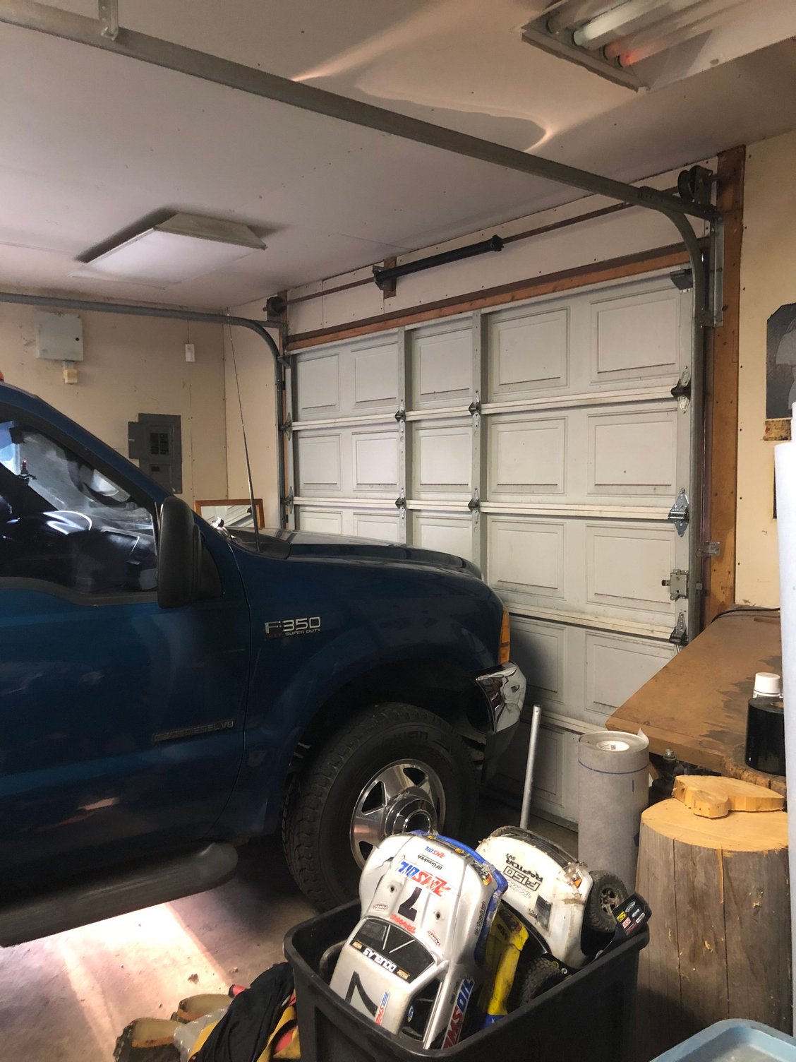

What is that grey gookempucky on your vents? Looks like Proseal. I have a love/hate relationship with that stuff.
Is that a tote full of traxxas slash's? Short course trucks are super fun.
My last house had a garage large enough to fit my CCLB truck in the garage. Even after I added 24" gorilla racks in the back. I could close the door, with my hitch installed.... but I had to climb through the bed to get to the other side.
The Superduty lived outside unless I needed to drive it to work and the temp was super cold. Fortunately I had another rig as a DD.
Shop is 32 x 32 but put in the workbench along the back wall and it’s 29 deep, at least I still have room to walk around the back.

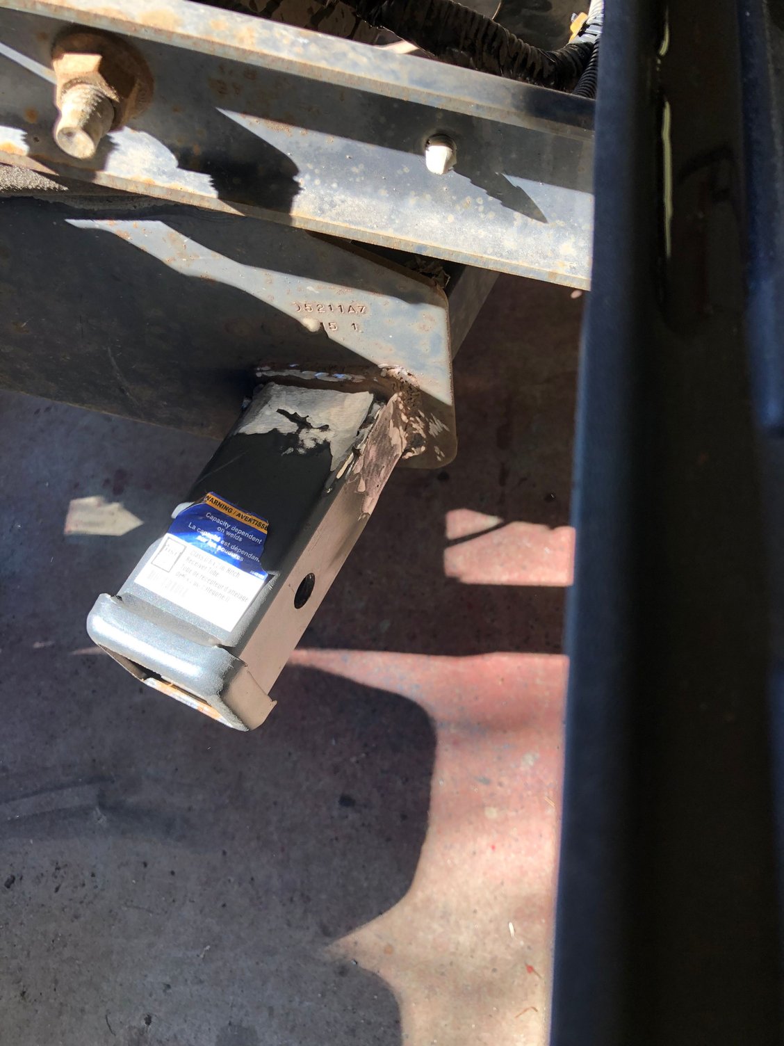

Decided that now was the time to weld the 2” receiver stub onto the end of of the cross tube for a spare hitch holder. Much easier with the box off than laying on the ground.
