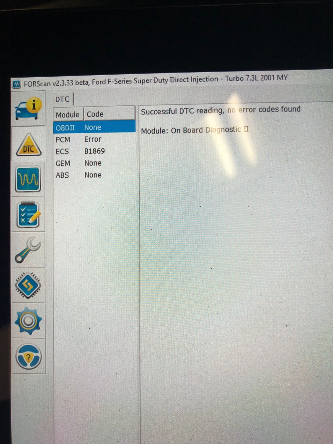

Wondering if the smoking gun is attached to the b1869. Burnt Bulb or “open ground” .
Most of the threads I’ve read where it’s been related to the 5vr still had starter motor operational.

Best I can tell the B1869 is an airbag circuit DTC and should not cause the PCM to lose power.

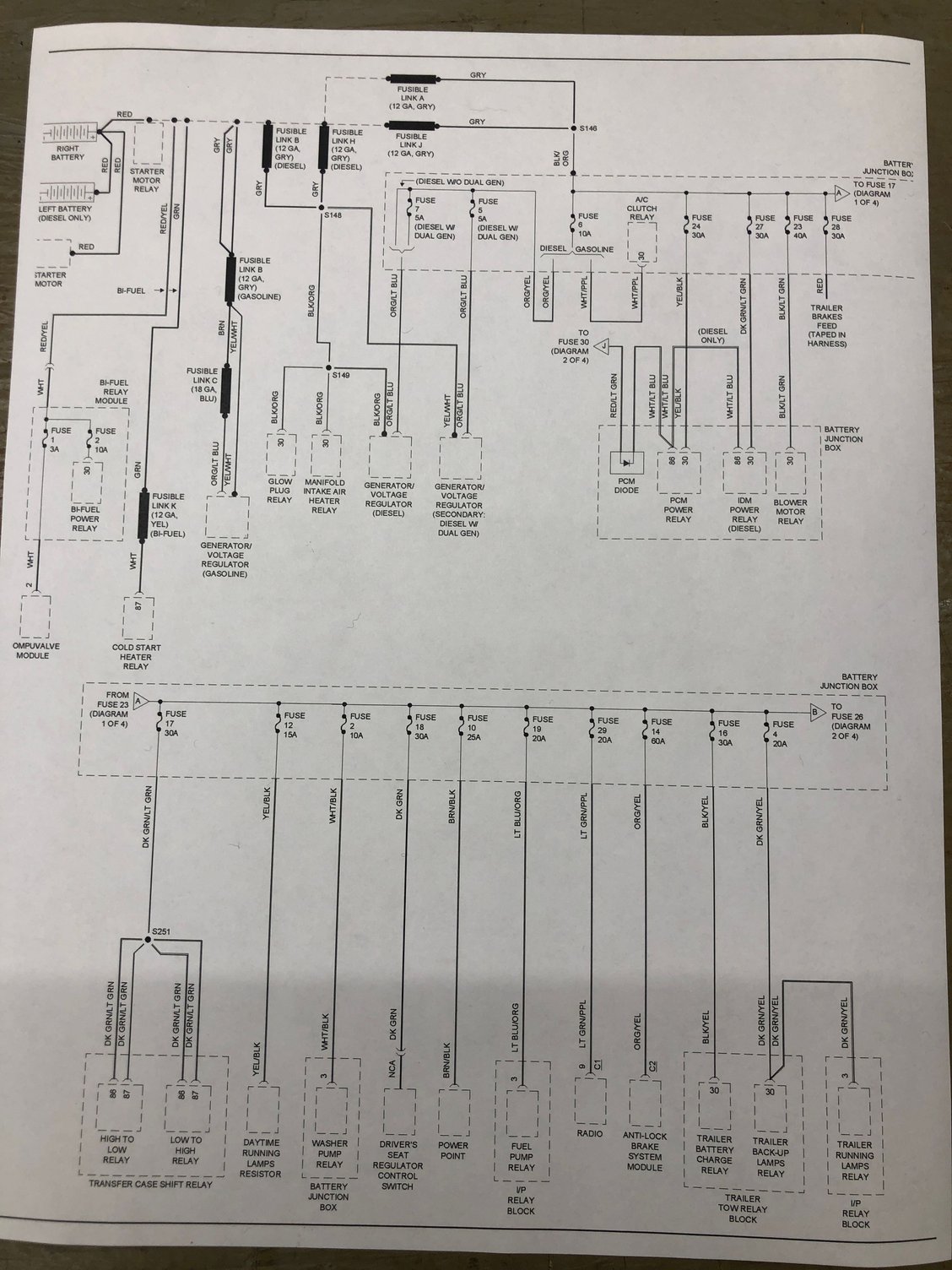

Printed a diagram this morning so have something to do some testing to confirm power through circuits.
Will start first with #30 under the dash for power.

Thats where Id start, grab diagram #2 also.

The only reason I’m looking at the B1869 is because this is the first it’s ever come up. Maybe a common ground causing the open circuit.

Printed all 4 for reference.
Gonna start with the power feed to the PCM at 30 then work from there. Either forward or backwards.

The B1869 DTC may be related, or just coincidence.

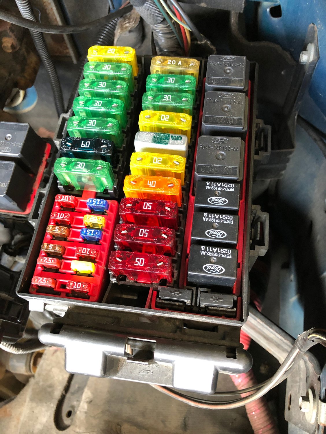

No power at fuse 30.
Im going on a guess here but are the relays and the diode I want to back probe here in this under hood fuse panel.
