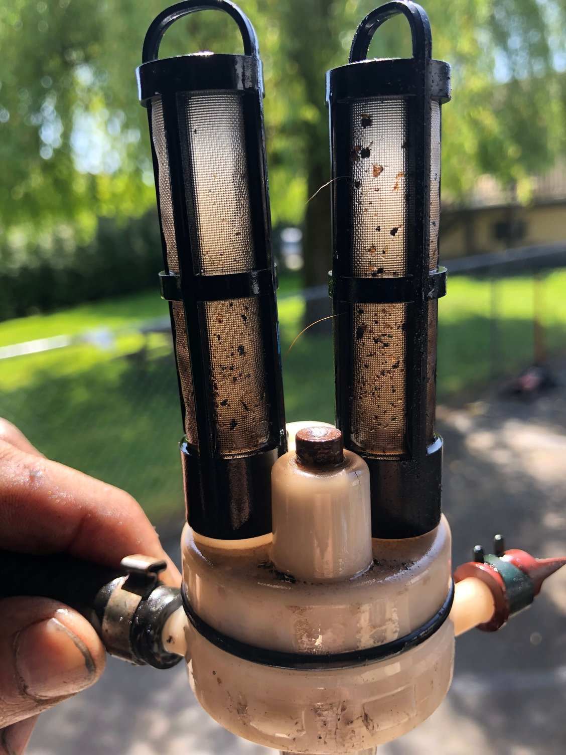

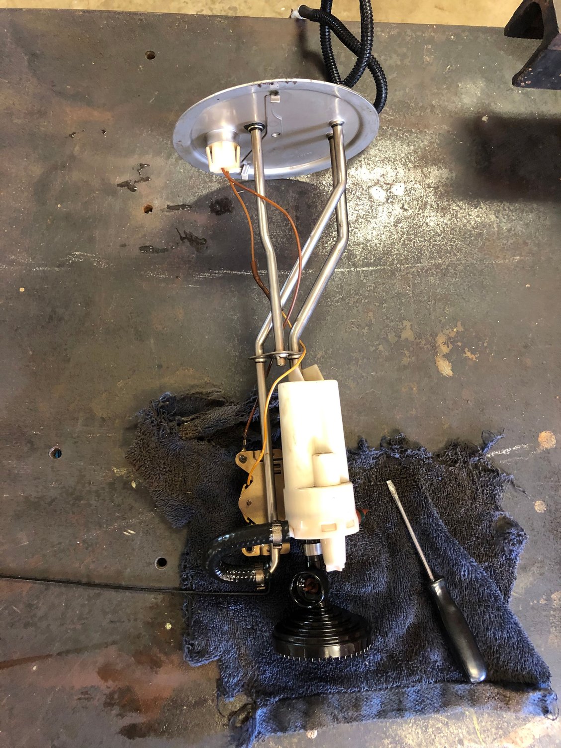

I’m elbow deep into the H&H mod now.
tank is out, pulled the filters and umbrella.
All is intact, filters are clean.
I was hoping to find something, but then again I wasn’t having problems so really no surprise there.
Tank vent hoses are crispy. Anything special I should use there for the type of hose to replace.

Wow those are really clean!
Sorry, I have no idea about the vent hose.
Those screens look very good.
My vent hoses were destroyed too and I simply used 30R9 hose that I had left over from the H/H.
See pictures here: https://www.ford-trucks.com/forums/1...l#post15197301

I just used 1/2" fuel line or whatever size it was for the vents. One of them broke rather than pulling it off so I had no choice.
I think you'll really enjoy putting the pump frame filter in. I know I loved the feeling of diesel fuel in my armpit.
If I were to give any advice, have some sort of a plug ready, and tackle the rear side first. Its harder to get off and takes longer. It was a real pita with the pump side disconnected and dripping diesel everywhere while I struggled taking that shrink fit line off.
edit: It is disappointing to open the tank and see everything in great shape inside, isn't it. Kind of feels like a wasted effort. BUT, I no longer have that worry at the back of my mind.

Too late on the filter to pump cause yup... took it off the pump side first.
I smell like I took a diesel shower.
Just got back from NAPA with the 1/2” line. Had some 3/8 here so that was easy.
Now to lift the tank back into place.

If you do the tank side first, you shouldn’t siphon any fuel out when unhooking the suction line from pump. But, a quick shot of compressed air should break the siphon and slllowvyou to work drip free.
Every once in awhile I see clean tank and screens. But I rarely see the umbrella intact. That is a good enough reason to do the mods. We definitely want to suck fuel off the BOTTOM of the tank to avoid growing an ecosystem down there!

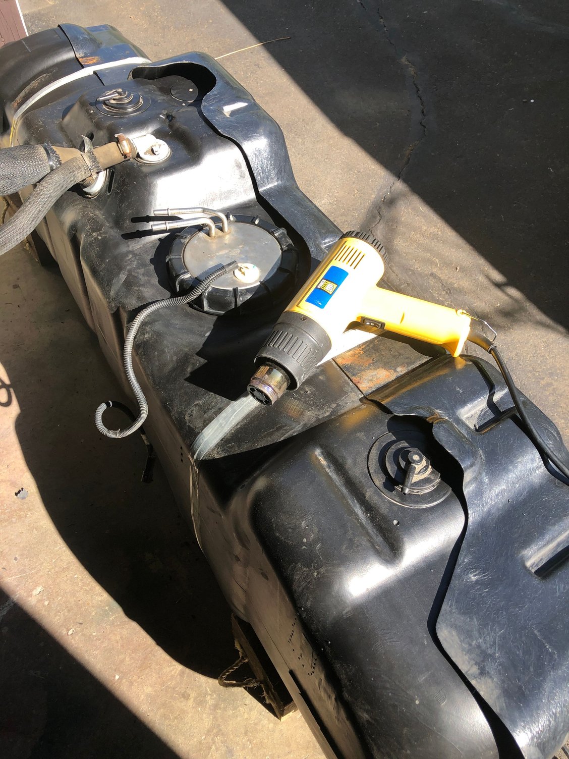

Getting the collar back on the tank was a chore.
Hot air gun to warm it up LOTS and on it went.

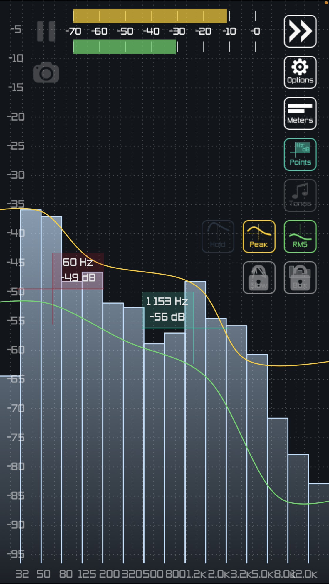

Did it make a difference as far as sound / injector noise.
Before
After
Both cold starts. There is definitely a measurable difference.

I (and my wife) could hear a difference at when up to speed ~55mph. She had no idea what I had done to the truck. As we’re driving I asked if she thought anything was different. She says in kind of a surprised voice “yeah, it sounds quieter.” Thought maybe I was just wishful thinking until she verified my thoughts.
