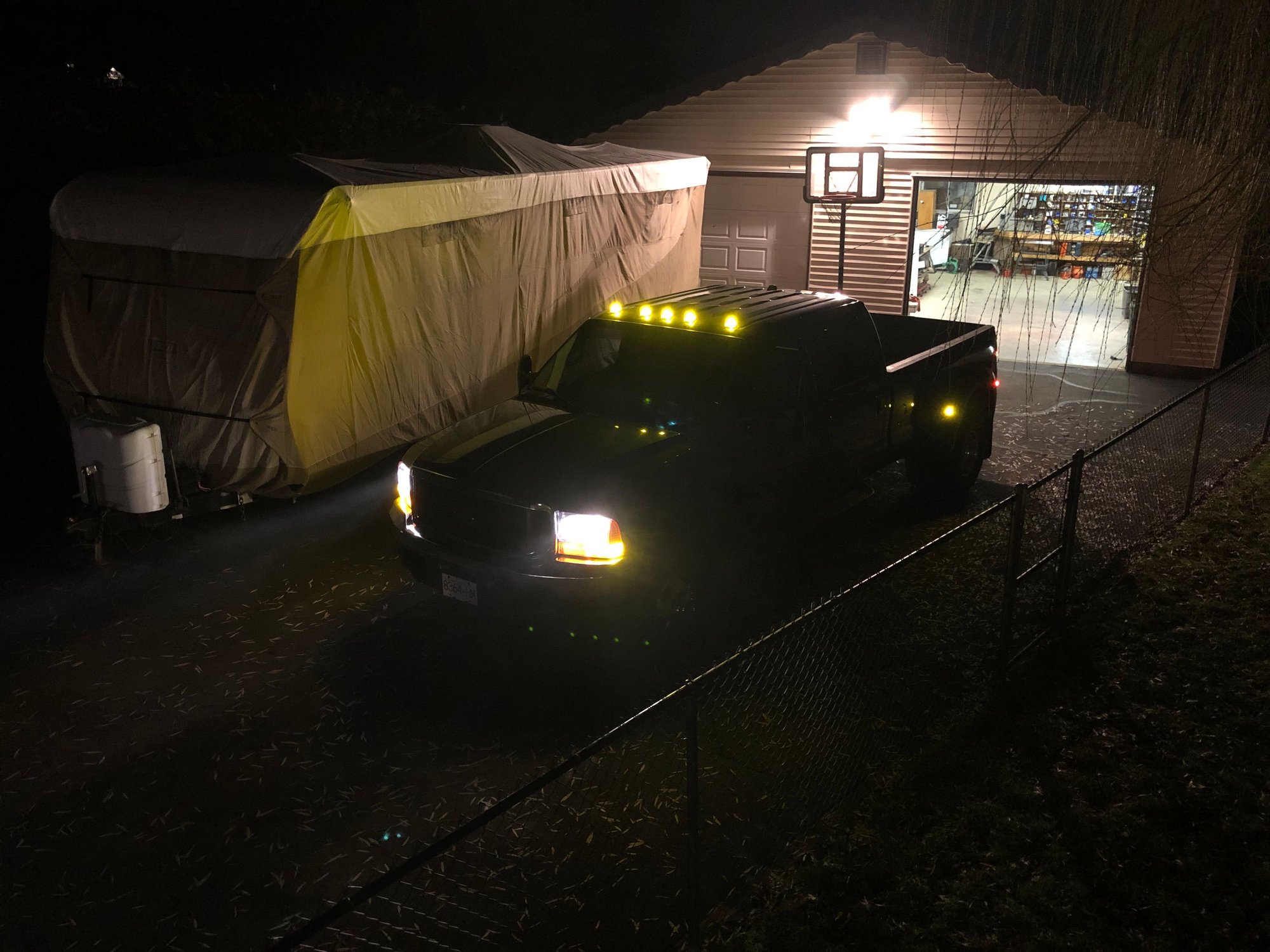

Headlights are OMG WOW!!!!!
I could easily outdrive the old housings and bulbs on a winding dark road.
The ‘03’ housings smartened that up.
The 80/100’s with the relay harness… let’s just say I won’t be having driver fatigue from straining to see.
The LED 194’s all the way around sure are bright as well as you can see on the cab and dually fenders.
I had to take this picture from about 35’ away any closer and it was just a bunch of big glowing things with no definition.

Really glad you are happy with that headlight set-up. I’ve been installing and recommending that since ‘drop in HID’s’ were popular. Back then, we did a couple Headlight Shootouts at GTG’s and the ‘02-04 lenses, relay harness and 100/80 bulbs won over everything, every time. Specifically better than the later model housings everyone touted as ‘better optics’ than the 2-piece lenses/corners. Not unlike the current generation of drop-in LED bulbs, the HID’s put a lot of light right in front of the truck, but failed to get that light far down the road as well as the halogen bulbs.

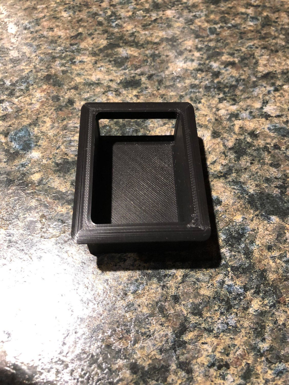

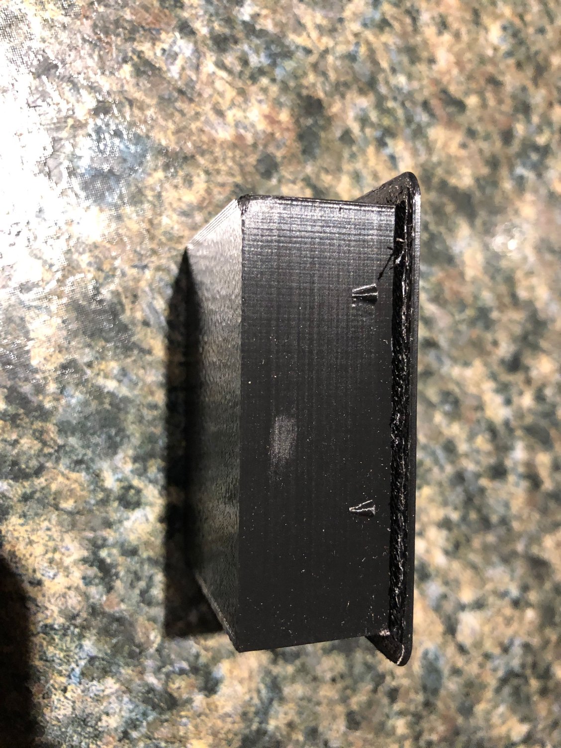

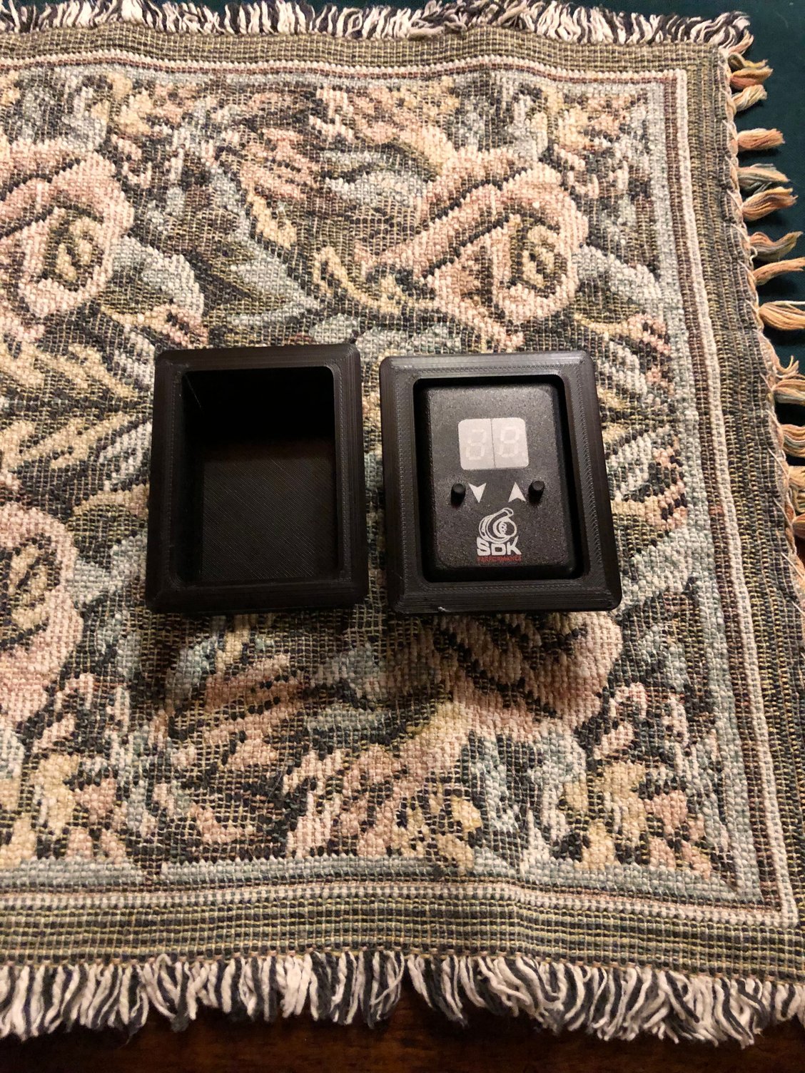

I have a buddy that has a 3D printer.
On a whim I showed him the Riff Raff CNC Hydra mount and asked him if he could print on for me.
3 days later he dropped off 2. This weekend I hope to get enough time to install it. Way better than than Velcro.
I only need one. First person to PM me gets the spare.

Allegedly, they settled on the billet aluminum because he could not find a plastic that would work as well.
Let us know how it works for you!!!

That looks nice. I have a fuel control module for my Titan auxiliary tank. Do you think if I provided him pictures and dimensions he could make one for it? I'd pay him of course. Be a cleaner install into my dash panel.
