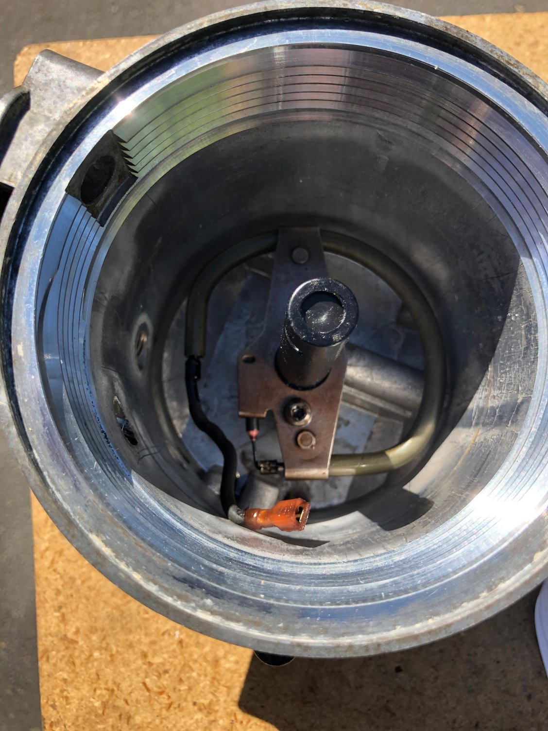

Can I just clip the lead inside the fuel bowl for the heater so the Water in fuel still works.
Why are we recommending to snip the wire on this version of the fuel bowl heater? This is the good heater, right? I thought the thin wire one was the one prone to shorting.
Agreed that this is the new style FBH. So will it not short out, or is it just less likely to short out.
I really don’t want to take the chance on blowing that fuse on an 8% climb with 8500lbs in tow. Anywhere for that matter.

It doesn’t blow the fuse like that. There aren’t that many conditions that call for fuel bowl heater and pulling a grade towing isn’t likely to be one of them.

No, it will leave you stranded. The PCM decides to turn the heater on about 3 blocks from home. Usually downhill and obviously the worst weather conditions.
I support unplugging the heater. Either inside or outside the filter.

It will be unplugged inside the fuel bowl.

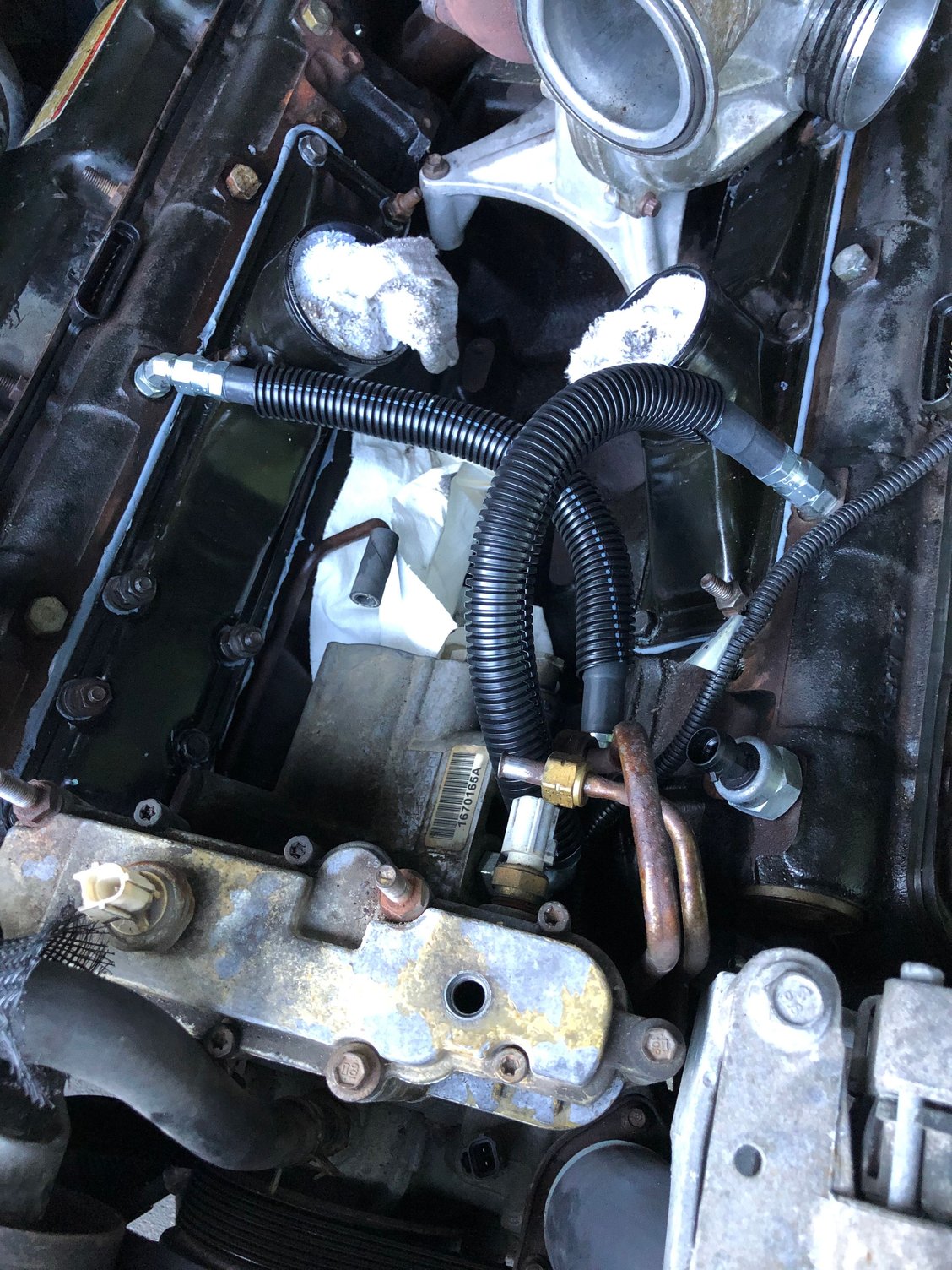

Fuel fitting are in the heads, and HPOP lines are now installed.
This weekend she lives again. Should’ve been done by now but Husband and Dad duties take priority.

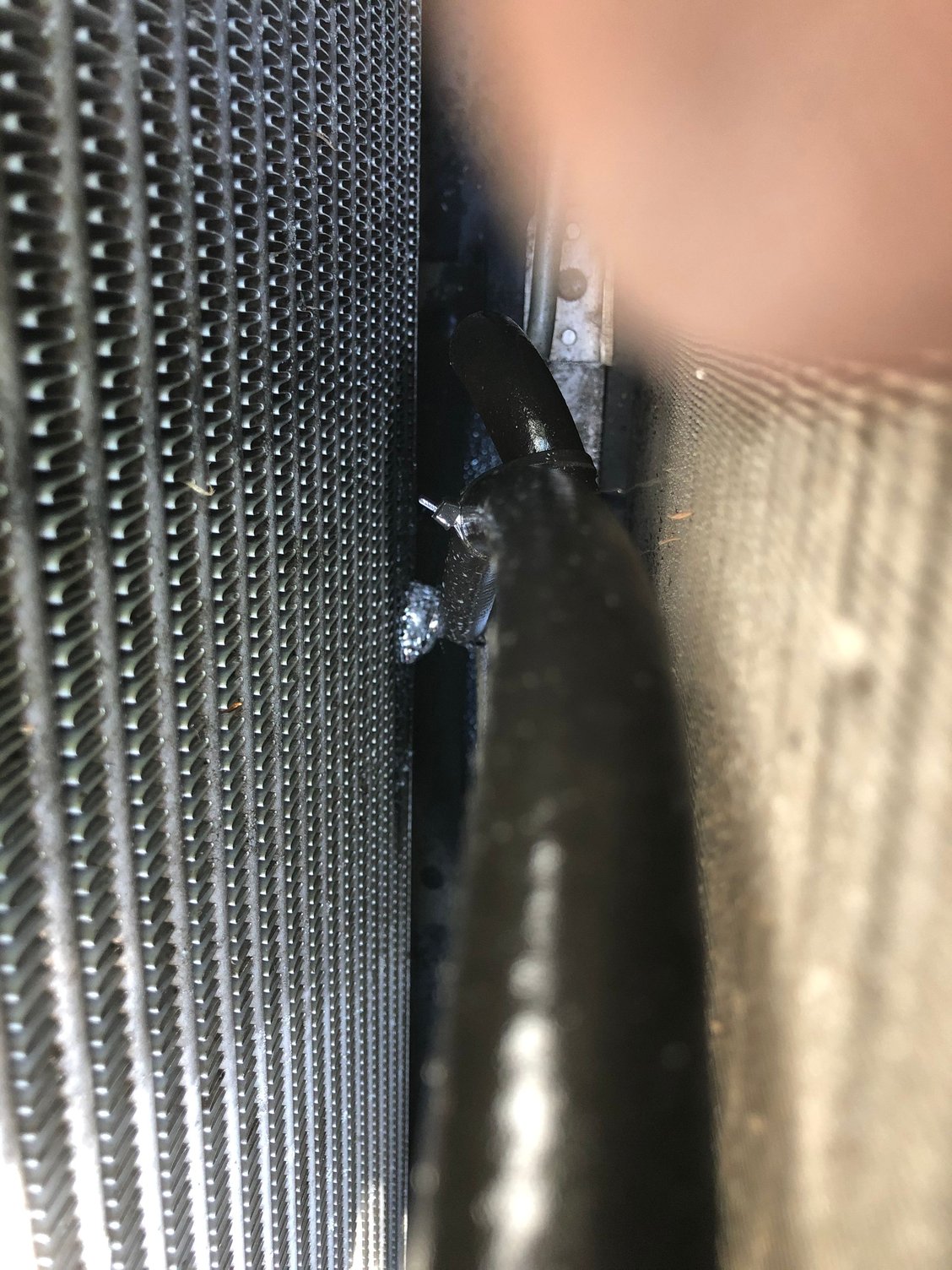

PO had a transmission cooler installed and a hose clamp was rubbing against the intercooler. It was showing oil. Wasn’t sure if it was from CCV or Trans.
Bubbles tell the story. Intercooler is leaking.

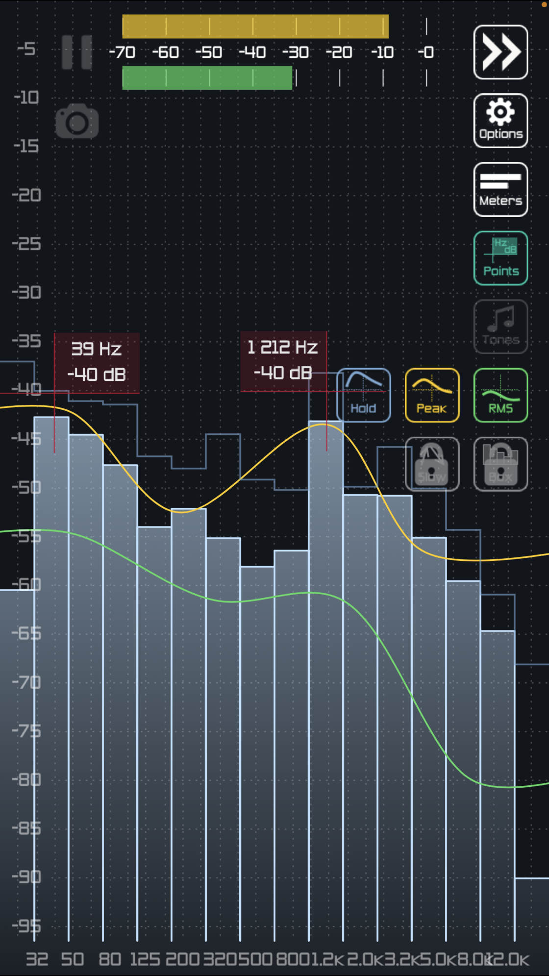

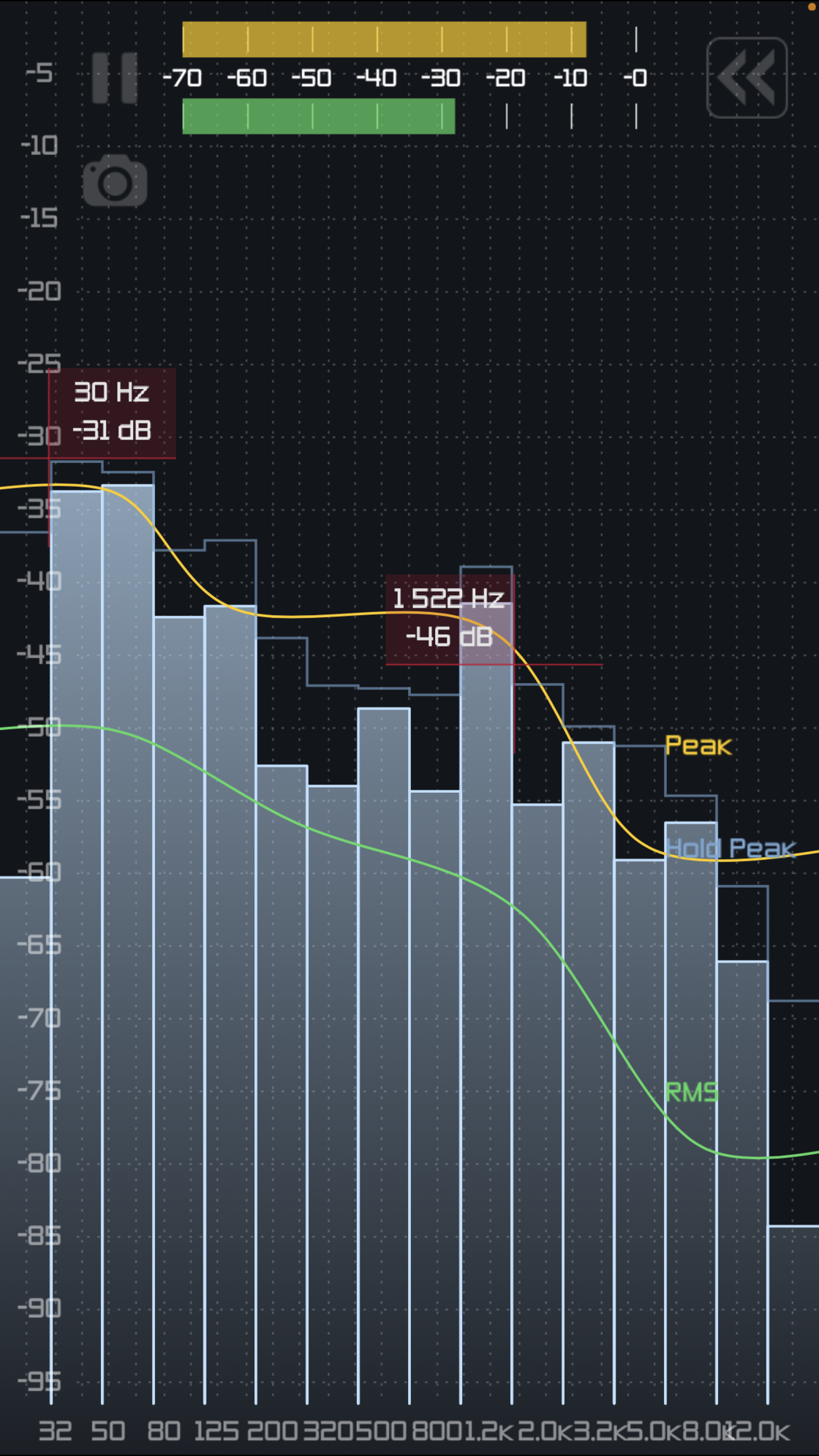

Ran another db test on the cold start.
Before anything done.
H&H completed
FRx , fuel lines, and HPOP. Some of the db has come up in the upper frequencies, but there is also a drop in lower. I’m sure there is some air in the oil rail that still has to work its way out.

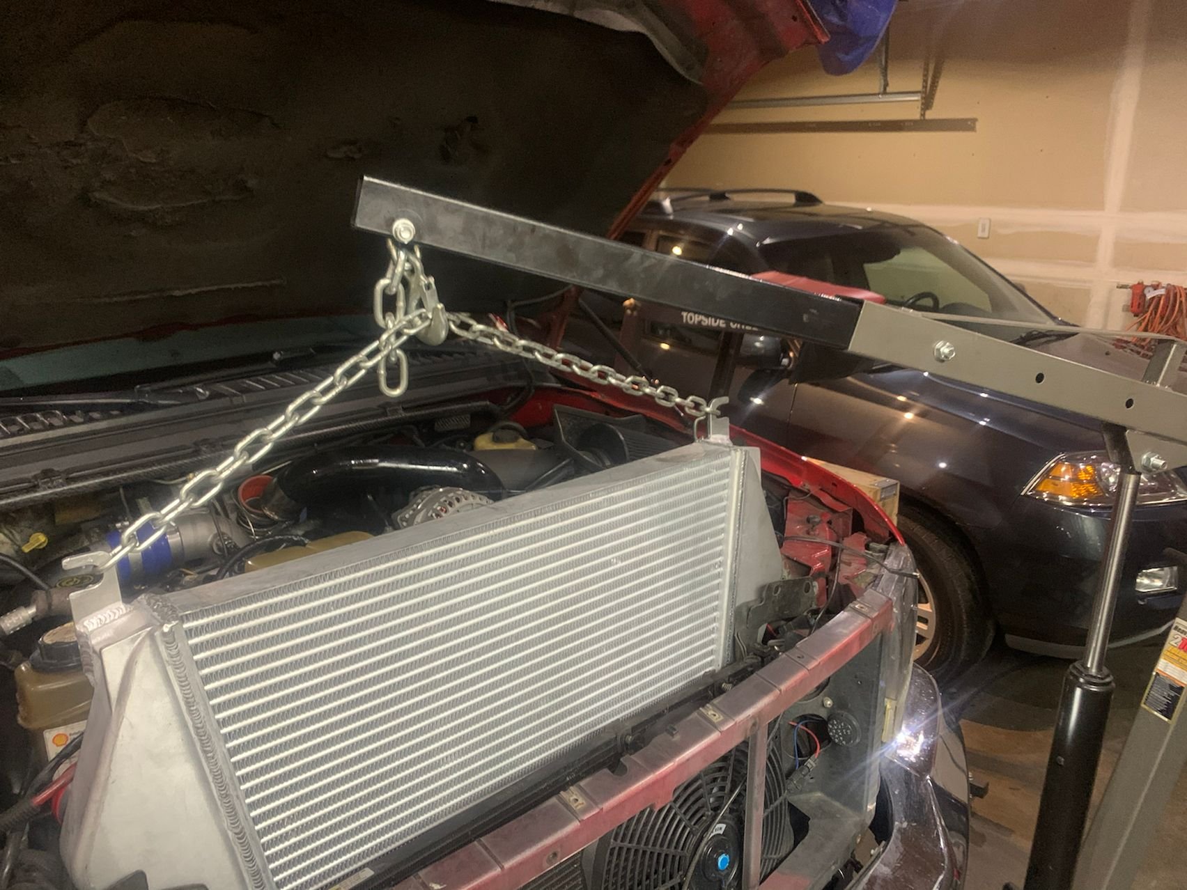

To fix the leak on the intercooler I will have to pull it out. I can’t weld aluminum so thinking it will be done with JB Weld. Once I get it out and all cleaned up I will assess.
