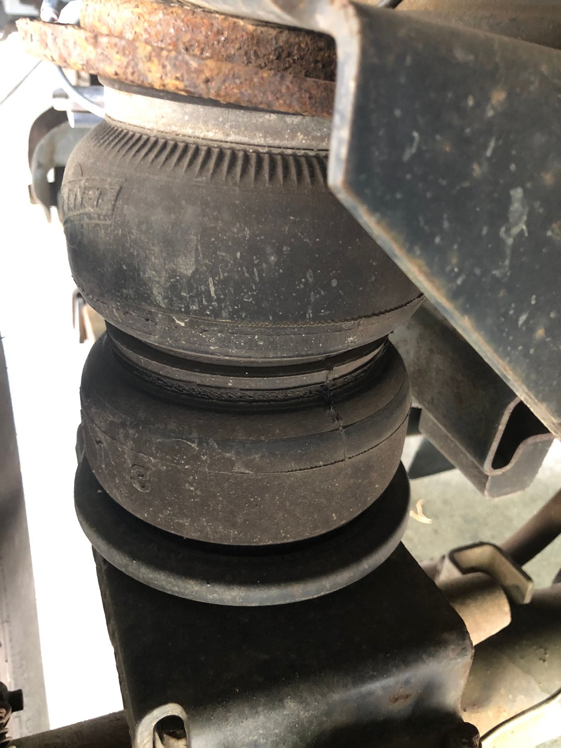

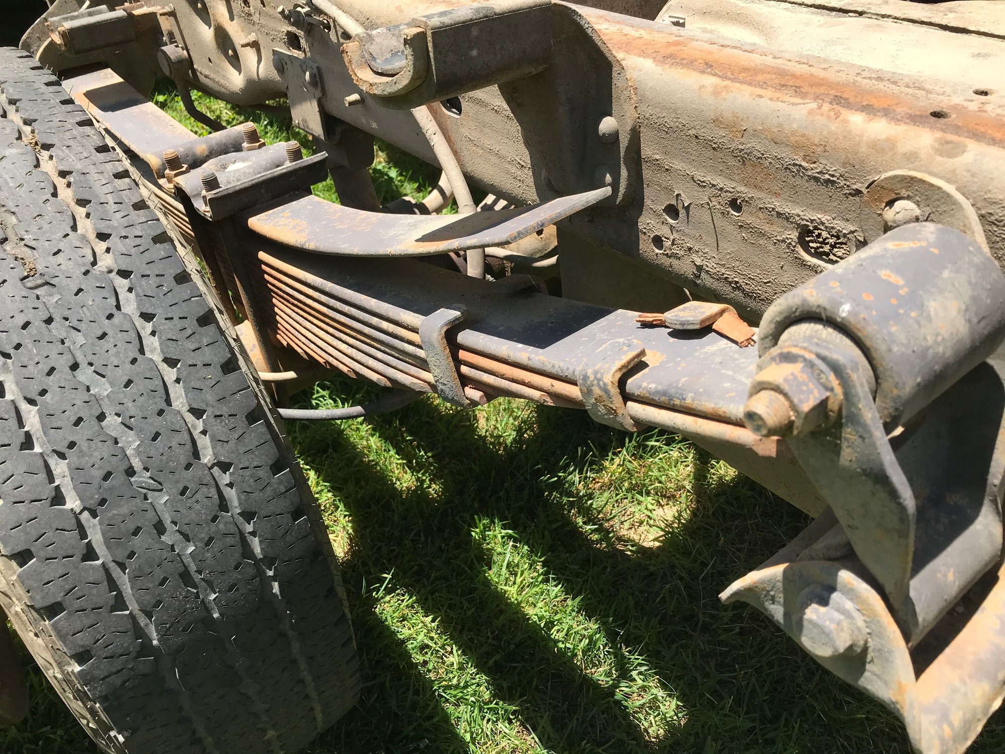

I’m looking for an image of the rear stock leaf spring pack. 2001 drw cc lb.
Were there multiple options. If so how do I determine what came on my truck?
My truck has air bags, and recently discovered that the lines feeding them are broken at the fittings. Bags have deflated and about 1” clearance between top of bag and upper bracket. Finally found out what the clunking sound is over bumps. Bag hitting top bracket.
Roll plates are rusted out and found some powder coated replacements as well as the fitting, but not sure if I really need to do them or just remove the bags since I’m a bumper pull with tongue weight of 750# on a WDH and PO towed a 5er.
Not sure who’s bags they are that are in there and if it may have been necessary to remove any leafs for the bags, of 5er hitch.

I’ve got a stock F350 DRW here I can take a pic of later.

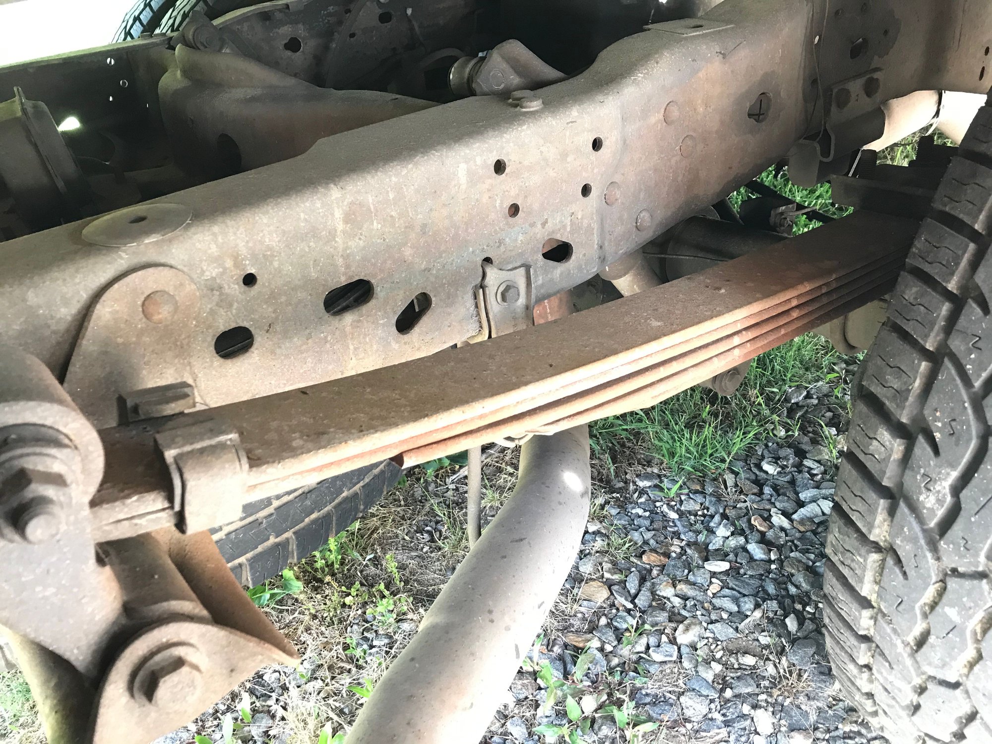

F350 DRW
F350 cab chassis

Thanks for that image.
If I recall correctly that is what I have. A stack of 5.
I’ll check when I get home from work.
Hmmm... now to decide if I keep them and get them back up to functional, or remove them.
PO took the pump out before he sold it so it just had an open line under the dash where it used to hook to the gauge. I put the PTC schrader in there and pressurized to 10psi and forgot about it.
I guess they don’t like to run being empty. Plastic 90° PTC fittings broke off flush in the top of the bags.
Im going to try to unbolt the bags from the bottom mounts. If that goes well then the fittings from the bags. If not then my decision is made for me.

F350 DRW
Looks the same.
Upon closer inspection they are Air-ride. Currently the u-bolts are soaking with PB Blaster.

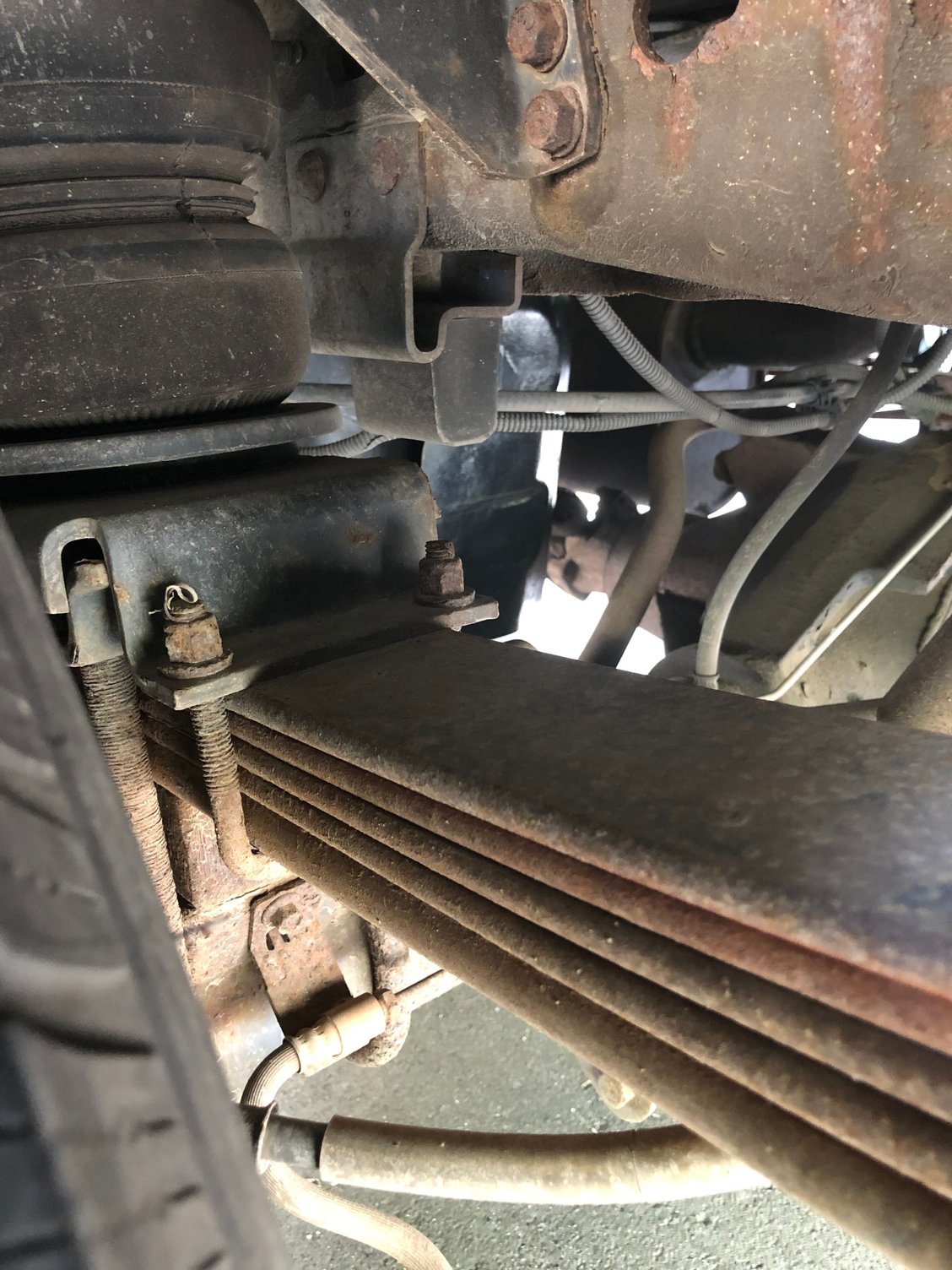

Bags are out. Only one nut came off. 7 snapped on the u-bolts.
Frame has perches for overloads.
Not sure if I’m gonna be able to save the bags. Next I’m going after the top brackets. Probably give up on wrenches and ratchets, just hit them with a zip blade on a grinder.
