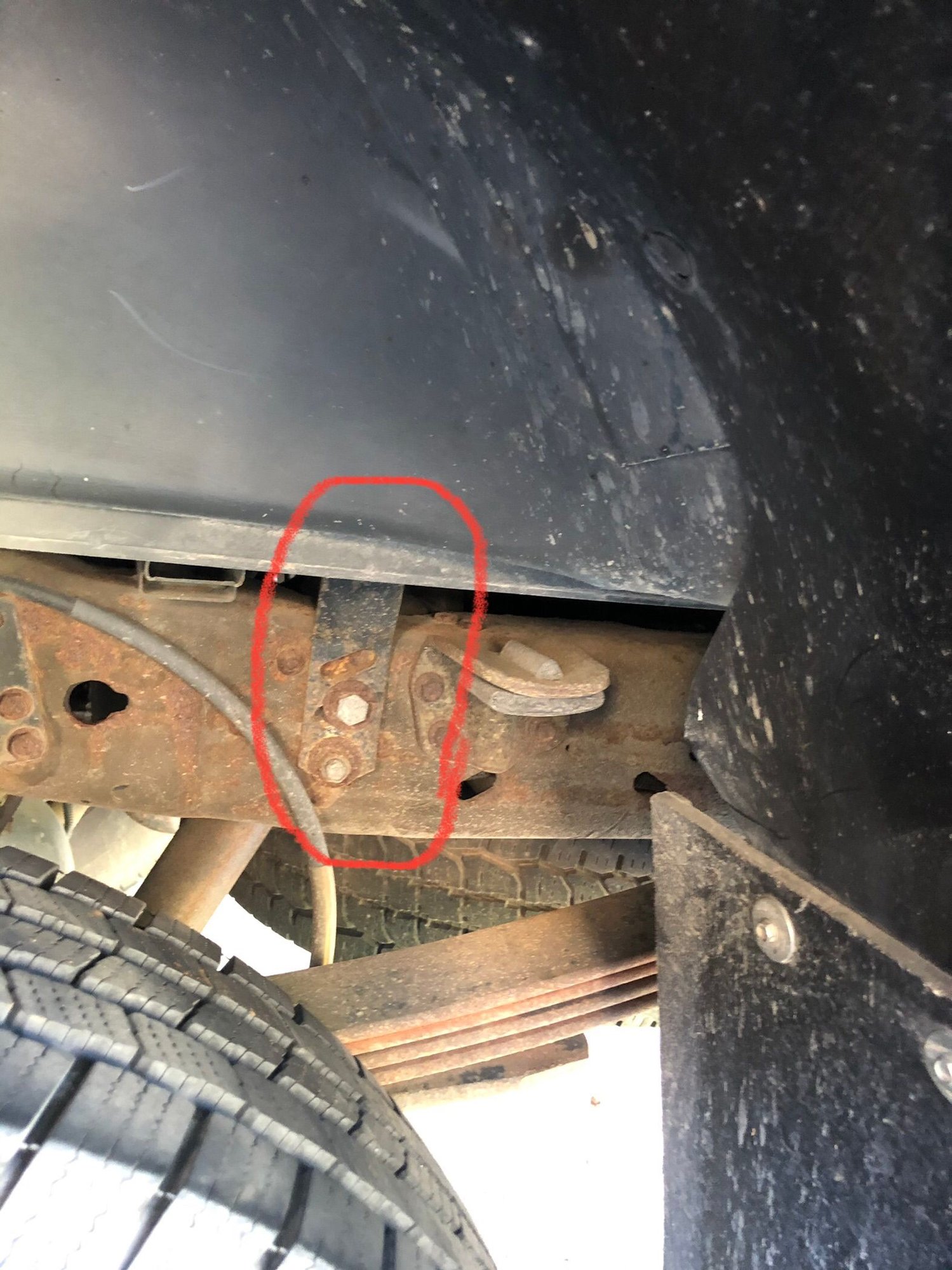

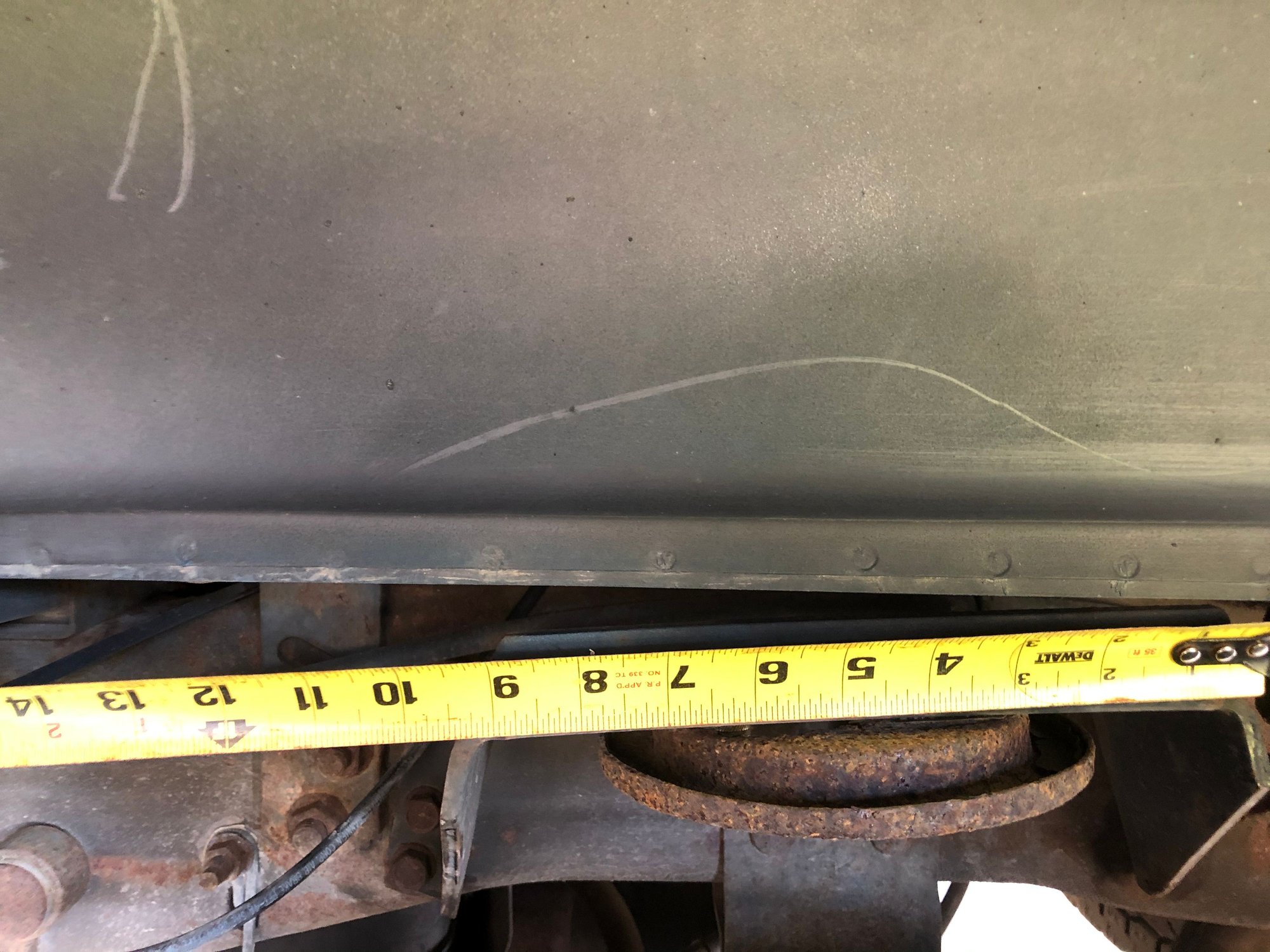

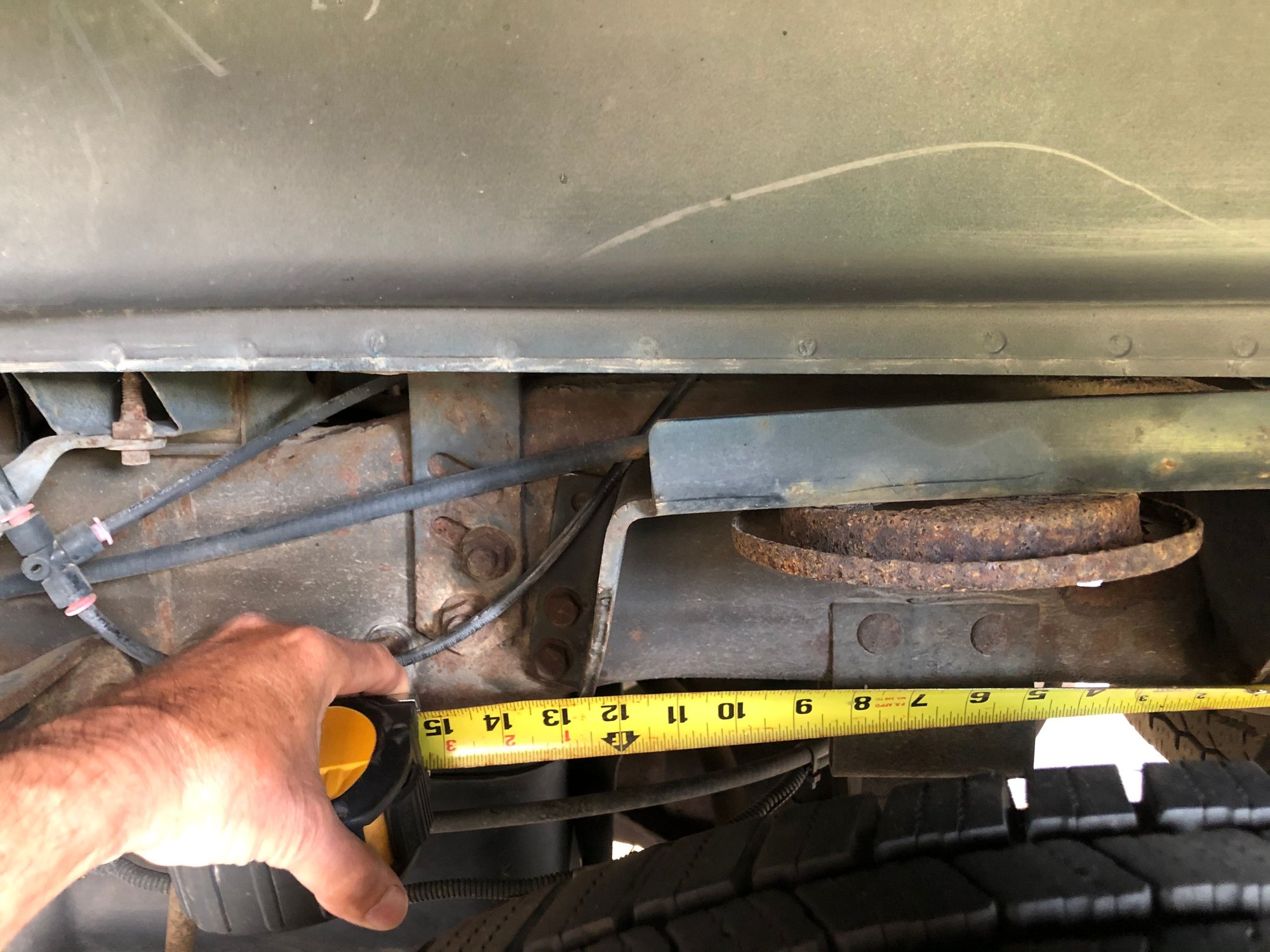

Follow up for anybody interested in the upper mounting bracket. I’m not sure on the model # used since I got nothing for documentation when I bought the truck.
Overview of airbag upper mount and hitch rail brackets.
Lower overall width
Depth to frame.
Upper overall

Looking through the Air-Lift installation manual and they have a maximum distance of 8” between the upper and lower bracket. Minimum is 5-1/2”.
Put a tape measure onto mine and just a smidge under 9”. This might explain why the threaded inserts were ripped out the top of mine and when deflated they were about an inch away from the top bracket. I’m sure having 0 air pressure didn’t help my cause either.
Yesterday I stopped by the local metal shop and picked up 2 ‘ of 1”x 1” metal rod to use as a spacer between the leafs and lower bracket. Then over to the spring shop to pick up some new square u-bolt’s.
