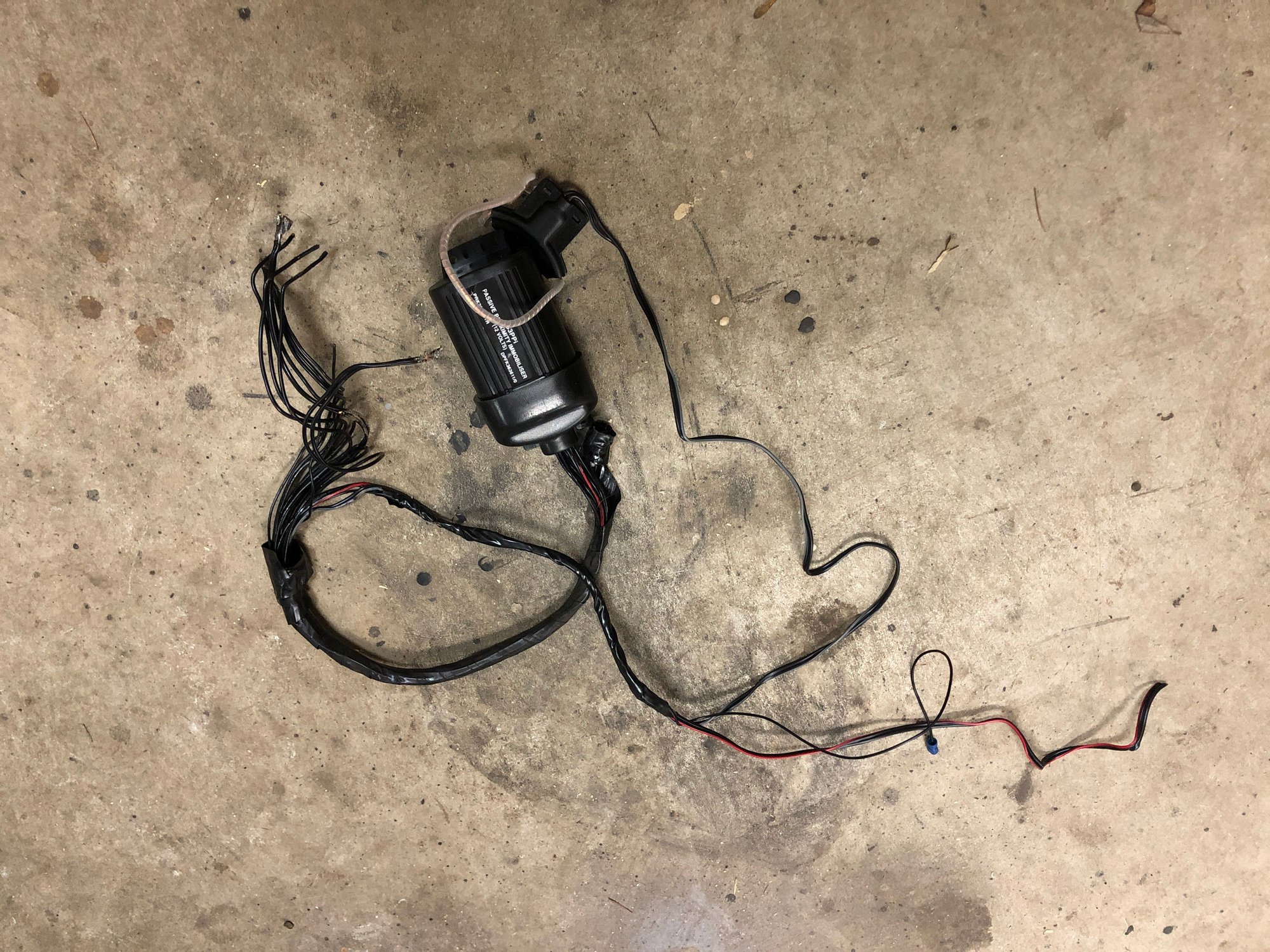

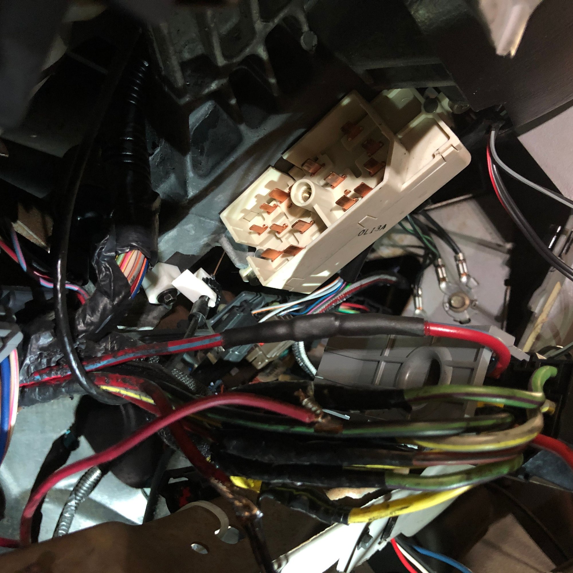

Not at all.
It was installed by our provincial insurance corporation due to the prolific thefts of the 7.3’s.

Originally Posted by F350towing
Not at all.
Looks like it works. Even the owner couldn’t take it.
Sorry, had to…
Seriously though it’s kinda cool
an insurance company would install something like that to prevent a claim. Win-win.

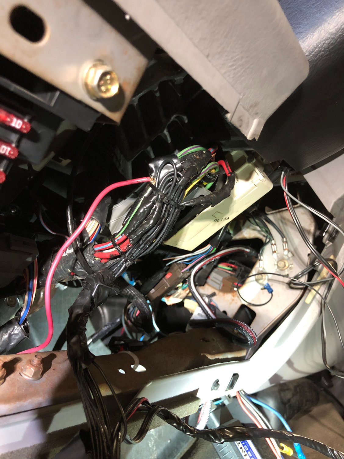

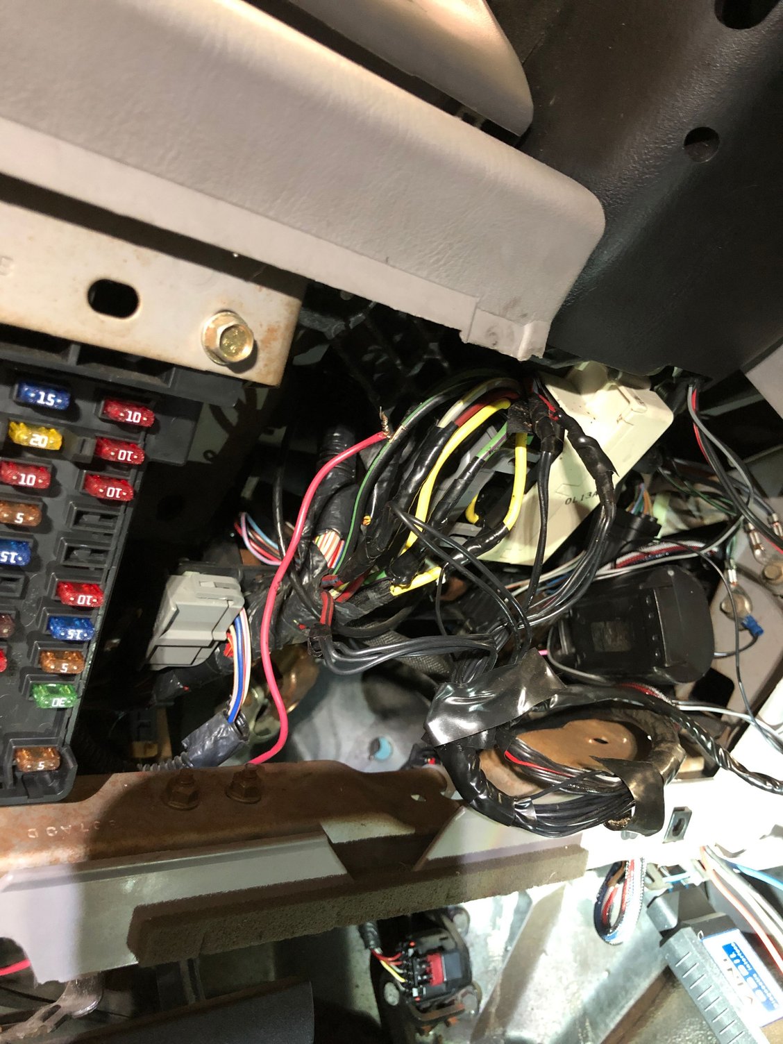

Well heck then they can fix it!
In 2006 by some independent dude that no longer in business.
Wow.
Someone had a great time cutting and splicing wires.

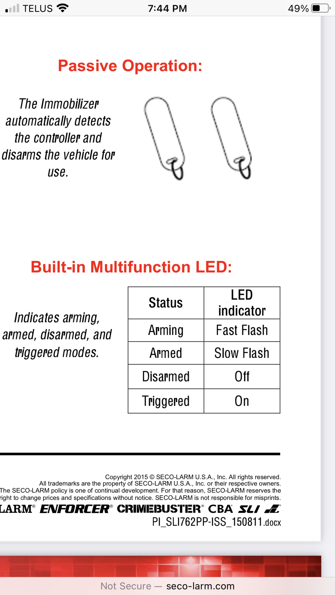

I think I found my smoking gun.
Key off flashing LED. KOEO solid red. Just headed out to the shop to remove the immobilizer.

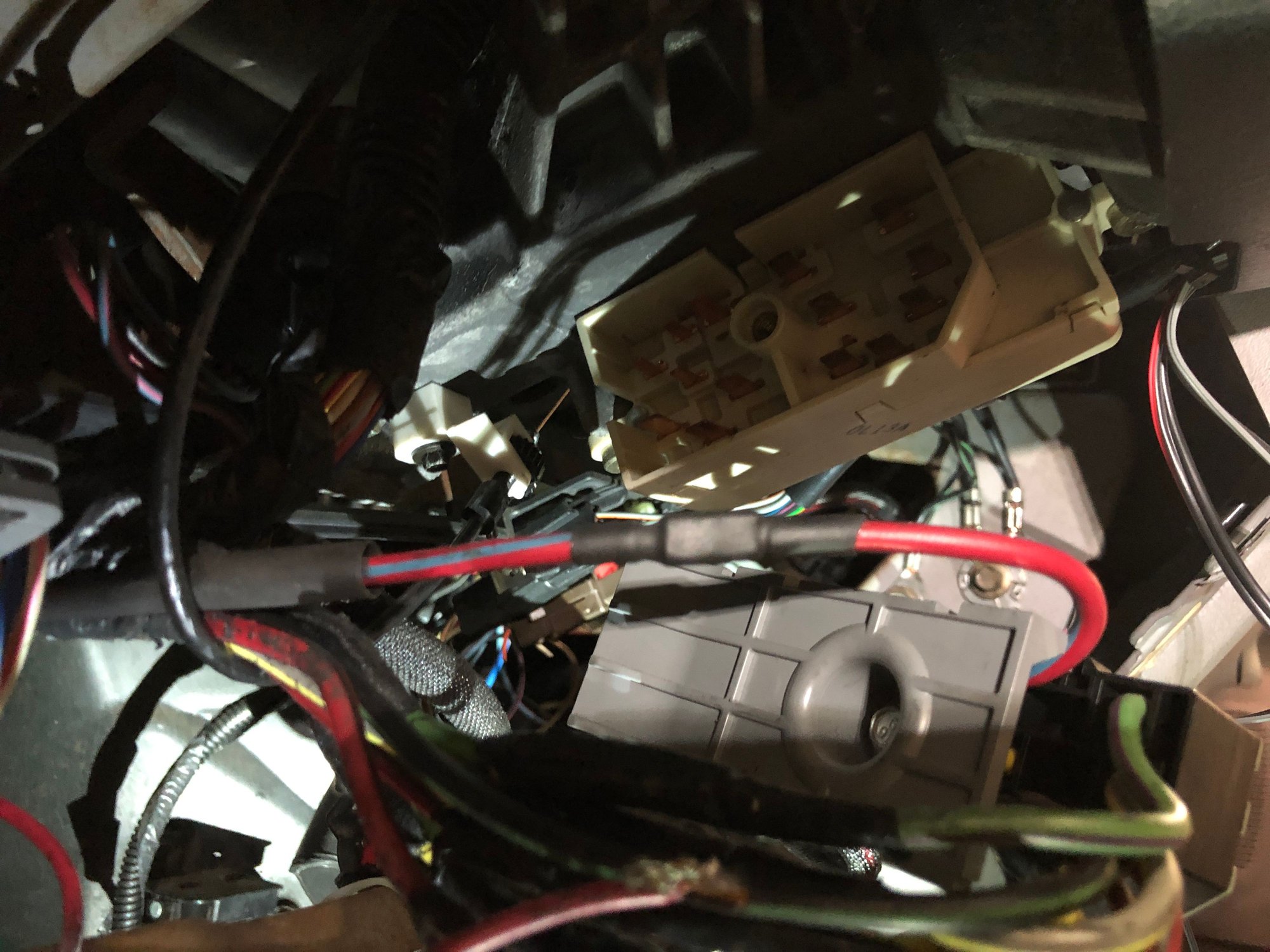

It is Alive.
Pretty happy when I saw the bulb check. After the WTS she flashed right up.
Immobilizer is dead.
Should beat it with a stick like the serpent deserves.
Still have some wiring to clean up. Everything was soldered but I really don’t like the falling off black tape.
I used uninsulated butt connectors then did a double heat shrink with double walled adhesive.
First shrink.
Second shrink.

Oh that looks like a mess. Glad you found it quickly.
Have fun reconnecting all those wires someone else got paid to disconnect, and then cause your problem....

ah, beat me to it!
I use uninsulated splices with heat shrink all the time, my favorite way to splice!
So far I have only addressed the wires that were required to check if it was in fact the immobilizer causing the no start.
