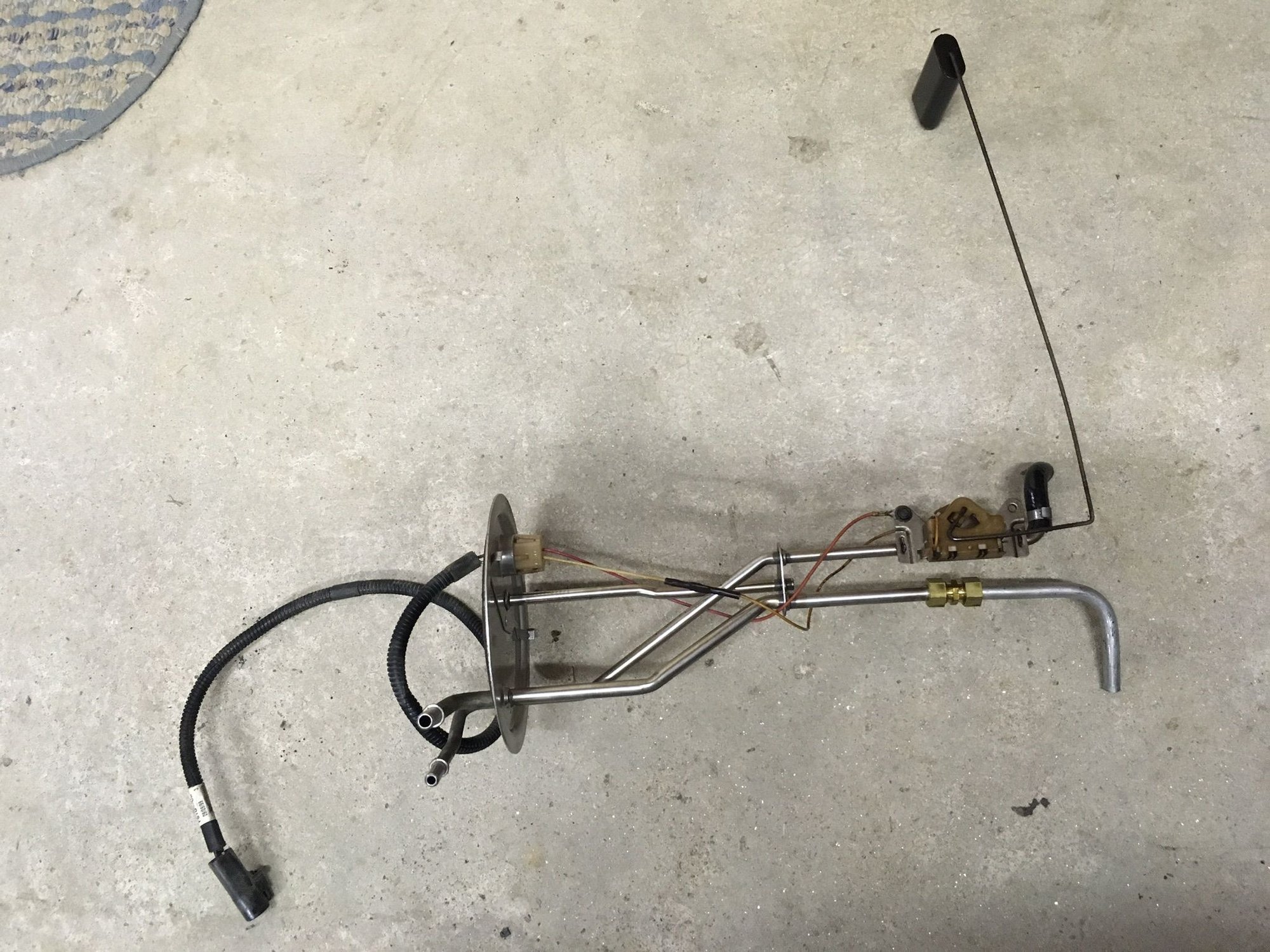

Just wondering if I can use a portion of the hard fuel feed lines that I take off for the H & H in tank pickup or is it a different size? I have some copper, but know that isn't good. Aluminum would be easier to bend, but if I have the steel lines and they will work why not use a piece of that.

Don’t remove any hard lines for the in-tank and pre-pump mods. I do not recommend eliminating the quick connect fitting at the tank.
You can use steel, coated steel or other ‘brake line’ tubing you can source locally inside the tank. Copper is probably fine if you never use biodiesel blends.

I meant the under hood hard fuel line from fuel bowl to head. Is that the same diameter as the in tank pickup? Probably save myself $3.00.
Oh, lol. My problem is often that I’ve spent $1’s to save $0.10’s....
No, those are 1/4” diameter. You need 3/8” OD for the suction line in the tank.

Napa doesn’t have 30r9 fuel line.
OK to use 30r14 for H&H

I can’t answer your question but I also had trouble finding the 30R9 spec hose when I did my truck. Advance Auto ended up having it. At that time the part number was AC503P but that number is no longer valid.
Recently I did Dad’s truck and again found the hose at Advance Auto. I had to watch them closely though as they at first cut me the wrong material.
I think Carquest is the same store in some other areas.
Did a ton of google searching. 30r14 is rated for max of 50psi and can not be submerged. Snip below from the sleuthing.
“The r14 stuff is supposedly rated for ethanol and methanol... Its 15x less permeable to alcohol (and therefore degradation)...
Rated for 50 psi nominal, 250psi burst pressure.
Found the 30r9 after some more searching at New Line Hose and Fittings.
