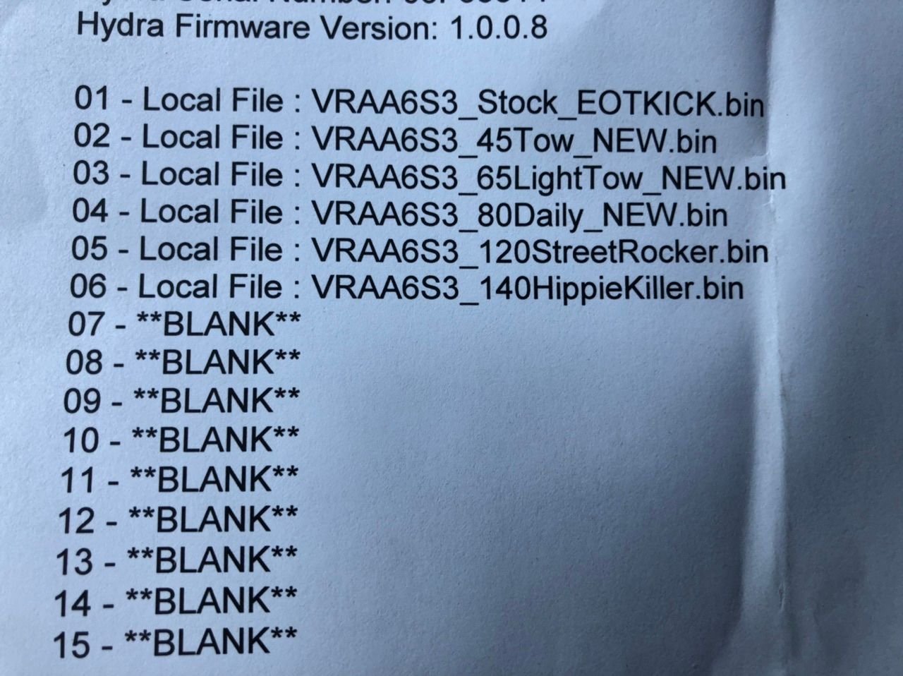

Update on the tuning.
I’ve only had about 2 hours behind the wheel until yesterday. 80 daily is crisp but not twitchy on the throttle. Clean with no smoke that I can see rolling into it or stab the pedal. Street Rocker, and Hippie Killer both smoke on initial drop but do clean up fairly quickly. TC locks and shifts are early but smooth in these tunes. it’s a freaking monster compared to stock.
Yesterday we towed the trailer up to the property. 5 1/2 hours. Shifting with a load is much smoother in the tow tunes vs being empty. Ran the 65 for most of the trip and WOW!!! The throttle response up in the 2200+ was amazing. It’s a hill killer. Nowhere along the drive did I feel like I was ‘Pushing’ the truck. It was way more relaxed cause I knew I had the power for that next hill, not get a run at that one cause it will eat me up.

Got some empty slots there so I will download some PHP files and see what I think of them.

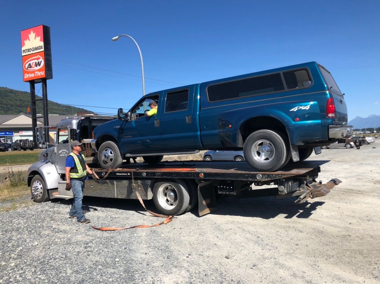

This is how the truck got home today. Tomorrow I will get the front end up in the air and find out where the awful grinding sound is coming from. Hub, spindle, brakes, stub shaft???

Tell me about it.
We we’re almost home too. 30 km and I would have been in the driveway. Thank god for AAA RV plus or BCAA as we call it, since here in Canada it is provincial. Within 45 minutes the truck was on the flatdeck and another wrecker was hooked up to the trailer. Cost me nothing other than my yearly membership.
It got progressively worse as we drove once I heard it and would smarten up when I touched the brakes leading me to believe it is either brakes or wheel bearings.
I will have it up in the air tonight after work and figure it out.

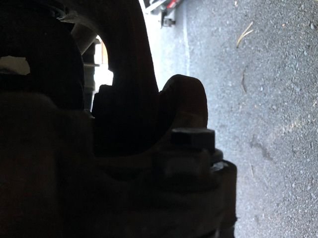

As much as I don’t want to... I will share my moment of embarrassment for all to see.
I now know what went wrong. During the install on the drivers side brakes it was dinner time. I had only hand tightened the caliper bracket bolts. Lost the upper and the lower was backed out about 3 turns.
Note to self, and others. If not torquing are this time leave them out, or at the least visibly loose so it doesn’t get overlooked.
Scoring on rim.
Lower bolt
Upper is gone.

Unfortunately this stuff happens to all of us at times. Thanks for being tough enough to come on and share the story. Someone may benefit from it tomorrow while doing some work of their own.
Glad you have it figured out and hope the repair goes smoothly.
