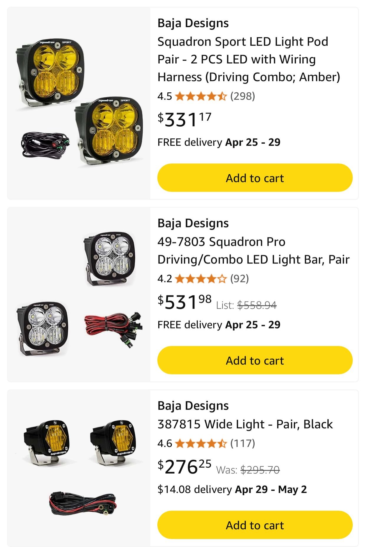

My move to Las Vegas has brought me into contact with people who are pretty serious about their lighting for offroad conditions deep in the desert. They tell me Baja Designs is the way to go for auxiliary vehicle lighting.
I’m going for proof of concept before, if ever, going buku bucks.
Just looked into them. OMG. Them are BUKU BUCKS. Just a quick glance at Amazon and wow.
I get buy once cry once but I can replace the cheapos 10 times before I’d break even on the cheapest Baha’s.

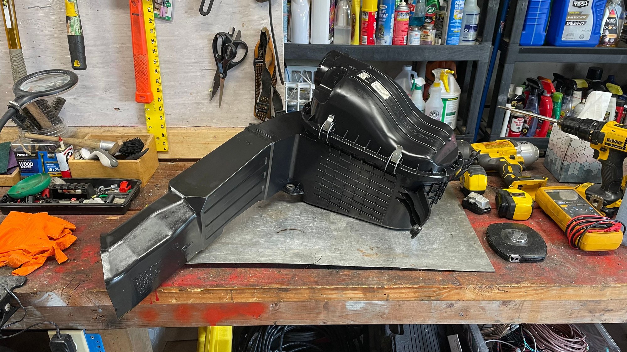

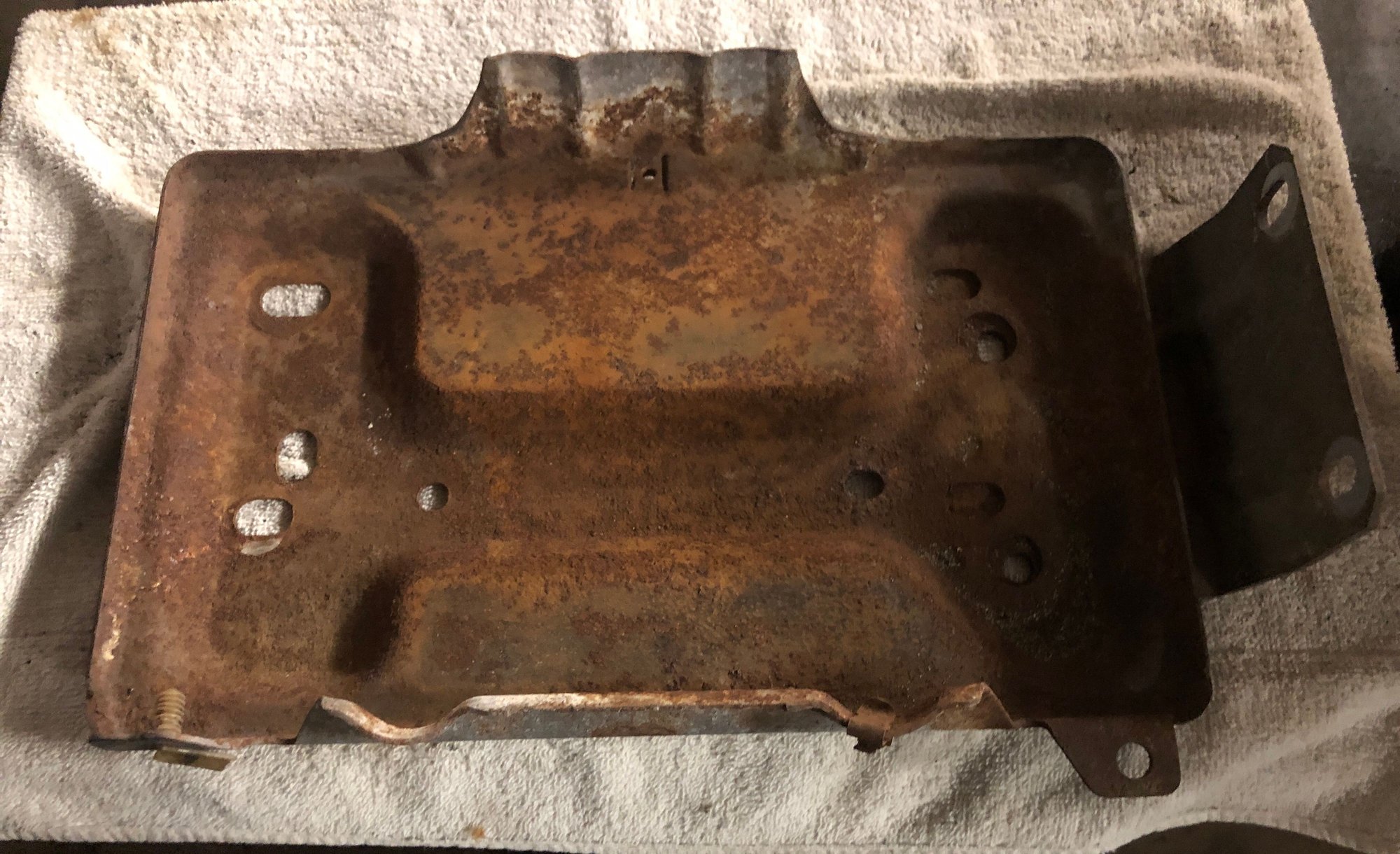

Picked up a passenger side battery tray for modification to be a drivers side mount to accommodate the AIS.
Credit goes to BWGuardian for the idea and proof of concept. I’m just following in his footsteps.
https://www.ford-trucks.com/forums/1...tml?styleid=24
As purchased. Looks bad but all just surface rust with a little bit of pitting.

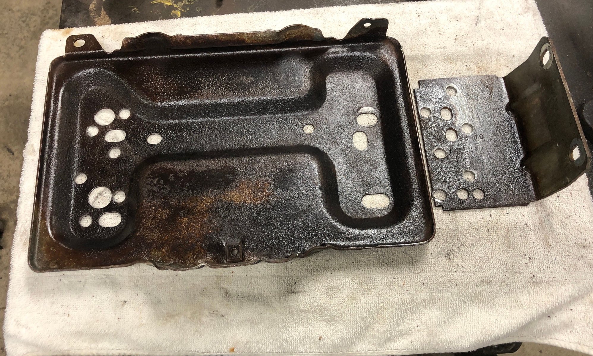

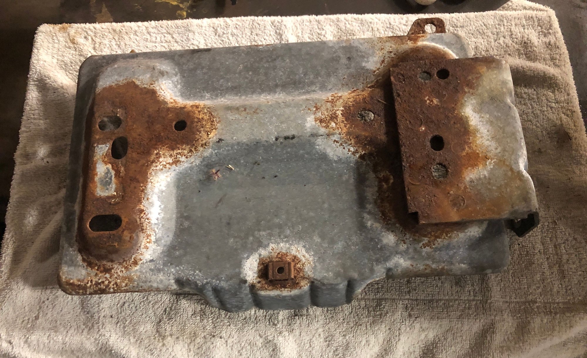

Underside.
Underside.

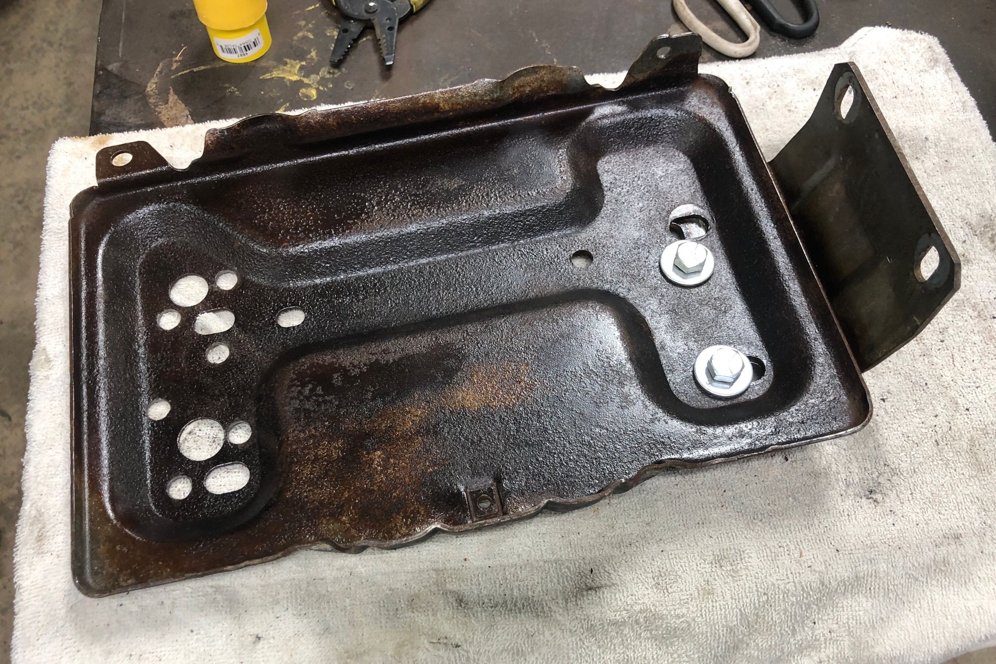

A degree of separation. Wire wheeled off the rust and hit it with a rust converter primer.
I went with 3/8 x 3/4 for the tray to mount bolts with a nylock nut on the bottom. Still needs a coat of paint.
Sneak peek of what is being delivered tomorrow.

Any thoughts on sleeving the AIS?
Oh yeah. But gonna take it to the next level.
If you recall the post from BWST where he used a ridgid foam packing material as the medium between the fender opening and the filter housing.
https://www.ford-trucks.com/forums/1...l#post21337768
I have acquired some of that and have a plan that will hopefully be able to utilize the entire fender hole and taper to whatever opening I put into the AIS housing. The goal is to have it pressure fit between the fender and airbox.
That modification is on the back burner for now.
Tomorrow the goal is to get it fitted with the battery tray and the secret zoodad.
Grill is off, battery tray and 6637 are on the shop floor.
Yeah I can understand the hesitation with BD's prices. I guess it is worth it to the off-roaders I talk to since they smack the everloving daylight out of their equipment.

Baja Designs are some of the best if not the best. They are usually used on the pro level but are gaining popularity to the avg consumer. My brother uses them on his Can Am side by side as well as his Ford Raptor.
He used to have Rigid I believe which also make great expensive off road lights.
These lights are extremely durable and can take some serious impacts among other things
