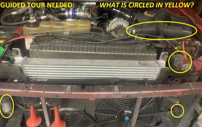

Work smarter not harder is a strong ethos with you sir.
How did the IC fit with the A/C lines and other OTA heat exchanger brackets?
Old Jan 23, 2021 | 12:49 PM
  #591
Y2KW57's Avatar
Y2KW57
Top Answer: 5
Top Answer: 10
Joined: Dec 2011
Posts: 13,339
Likes: 6,120
Old Jan 23, 2021 | 01:55 PM
  #592
FordTruckNoob's Avatar
FordTruckNoob
Joined: Jan 2005
Posts: 13,129
Likes: 4,730
From: Henderson, NV
Very well as it turned out. The concerns I had expressed to you over text were unfounded.
Originally Posted by Y2KW57
Clockwise from top right:
  1. Duct for auxiliary alternator cooling. It is retracted here for the intercooler install. It normally snakes its way up to the front header panel and conmects to a fan in one of the Zoodad holes.
  2. Quickstart’s external rectifier that they’ve branded the Quicktifier. This will be removed along with the Quickstart alternator shortly.
  3. Thermostat for the electric AC condensoer fans.
  4. Air pump for el cheapo electric airhorns I won in a raffle.

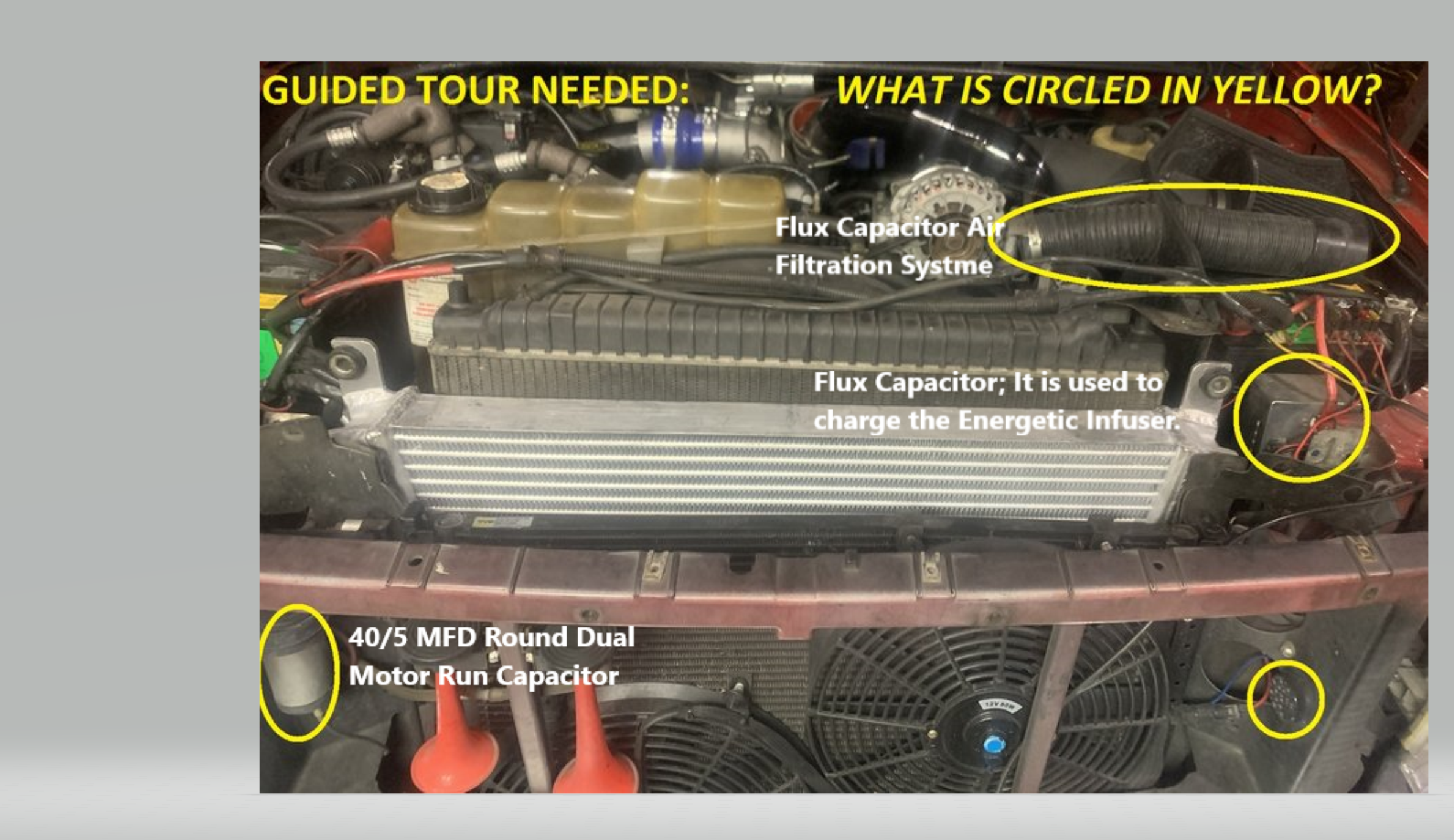

This is straight up TIME TRAVEL my friends. I won't give out to much info, but just so you know, I designed the Flux Capacitor Filtration system.
Old Jan 23, 2021 | 08:39 PM
  #594
FordTruckNoob
Joined: Jan 2005
Posts: 13,129
Likes: 4,730
From: Henderson, NV
Lol. Good explanation Carlos. The FCFS is right up there with blinker fluid. Incidentally, the 40/5 capacitor is exactly what my old household AC unit used to use. I revived it at least 4 times by replacing that capacitor before the compressor itself died.
