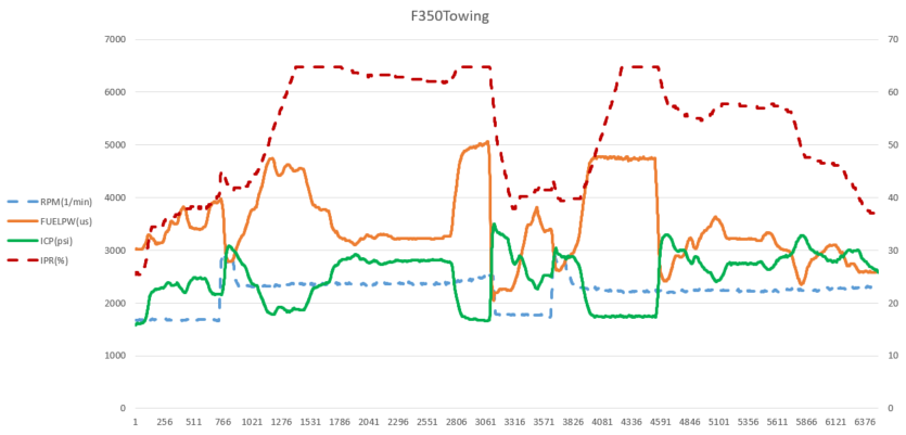

[img]blob:https://www.ford-trucks.com/1265cc57-2cac-4d4b-9069-e9f7d2f98e2a[/img]
In case anyone was interested in what the Hypertech was doing on an uphill pull with 8500lbs on the bumper.
Credit to BWST for the chart.
Thanks Jeff.

Here it is. You can see where the hypertech tuner is asking for 4-5ms of fuel PW, and the PCM tries to support it with climbing IPR % DC, but the HPOP can't keep up and the ICP falls. ICP keeps up pretty well (2800 psi or so) when PW is 3.2ms or less.
Reminded me of a similar chart I made with the last truck, climbing Steven's Pass at 19K gross with the DP tow tune. That tune was also asking for more ICP due to long fuel PW:
Tugly added the notations for his AE class.
