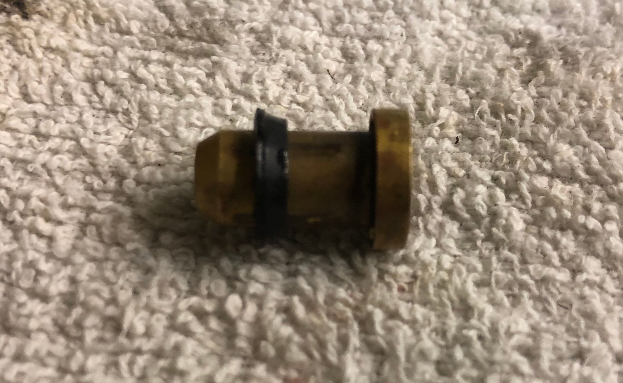

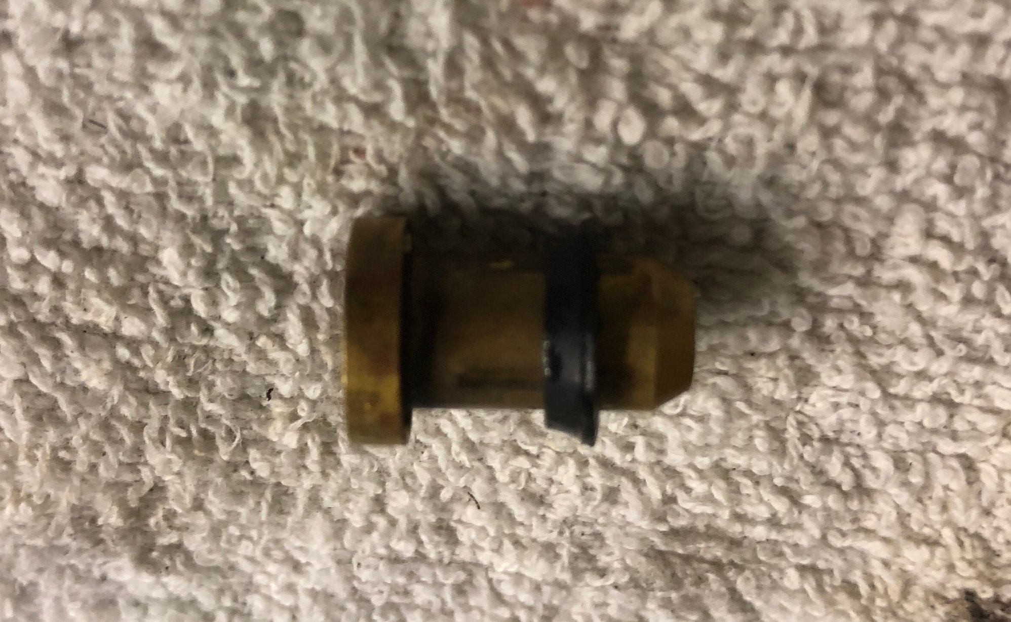

As well, here is a picture I took just yesterday of the original that I removed where I pulled the seal back from the seat of the poppet.
Oh… I got it… maybe this will work.
Looks more like the Dieselorings image now. I had the poppet oriented the wrong way.

Umm… I don’t think the poppet is supposed to go through the seat.

Well shucks! With all the trouble you’ve been going through I was hoping to maybe have stumbled upon something. I knew a long shot but didn’t want to notice the possibility and not share the thought.
Your photo fix was funny. Glad your humor is still there after all of this!
