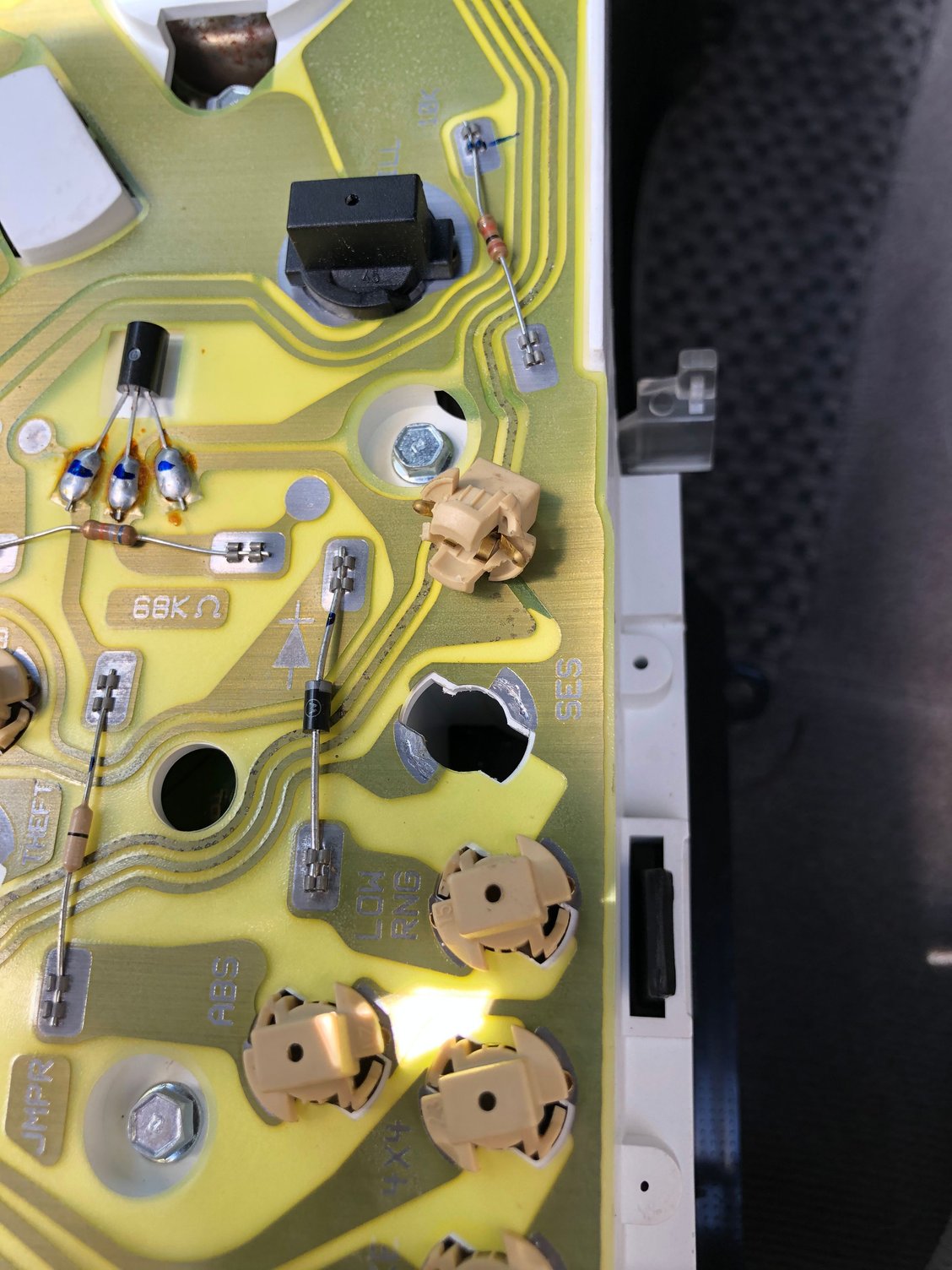

Got one from NAPA. Now it’s time to put the dash back together and do a test run and see if it’s defuelling.
Got the authorization that if the CEL starts flashing I can take it somewhere and have it fixed.
SDK for a Hydra should fix that problem.

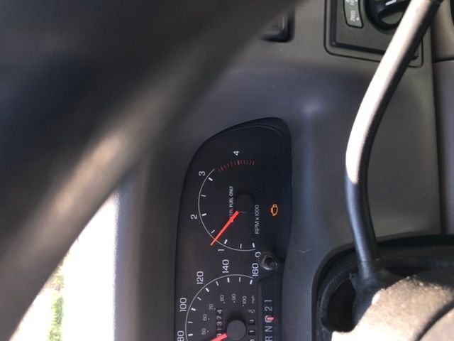

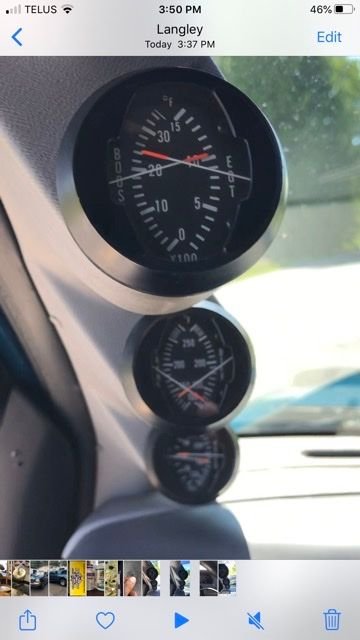

Think I got the 22lbs and hit the wall figured. It’s the wastegate opening up.
Im going to do 2 more full turns on the Wastegate and leave it hooked up for now, until I can justify tunes next year.
Interesting the correlation of higher boost = lower egt.
Wastegate redline connected.
Redline disconnected.
CEL confirms defuelling.

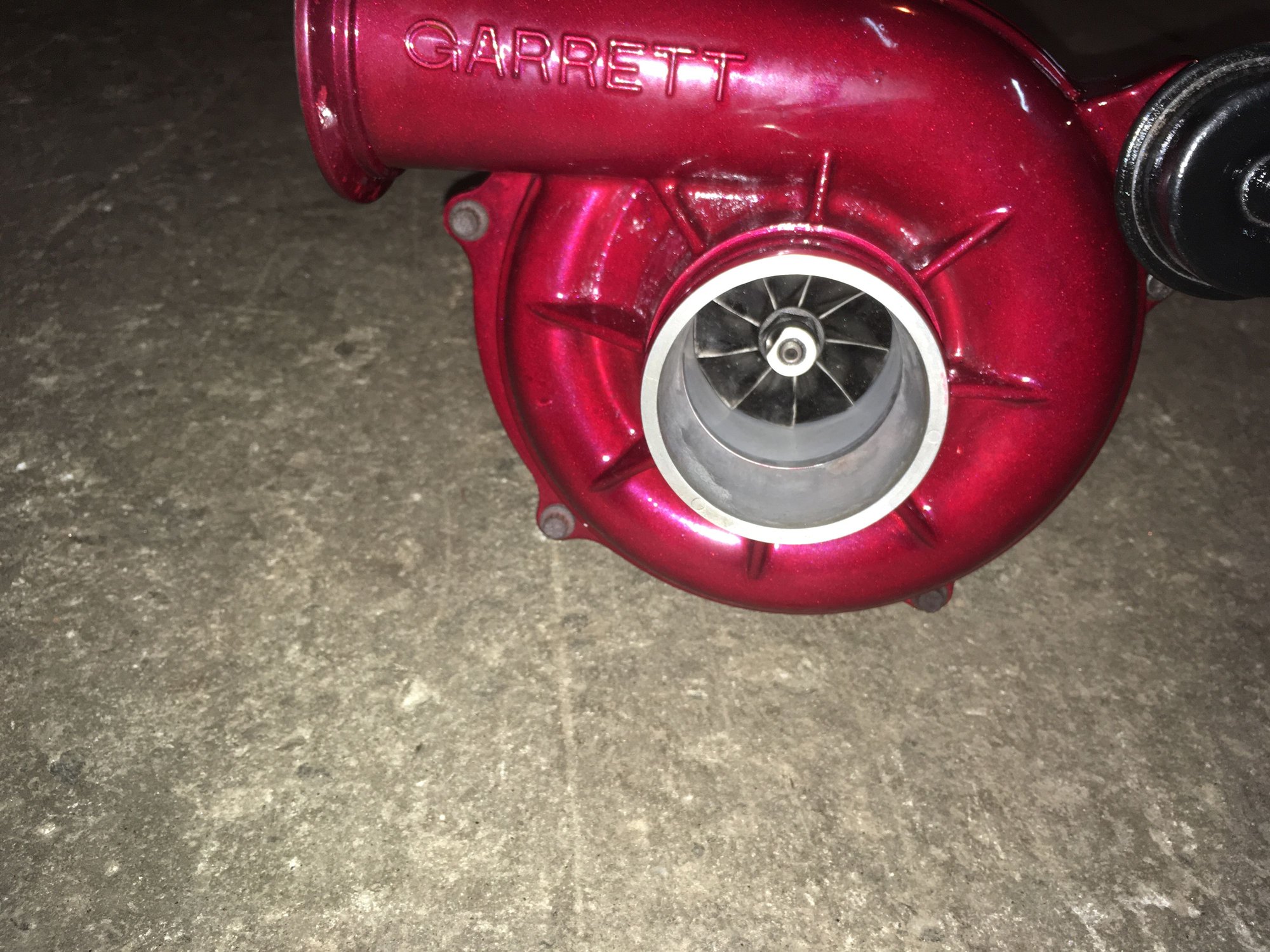

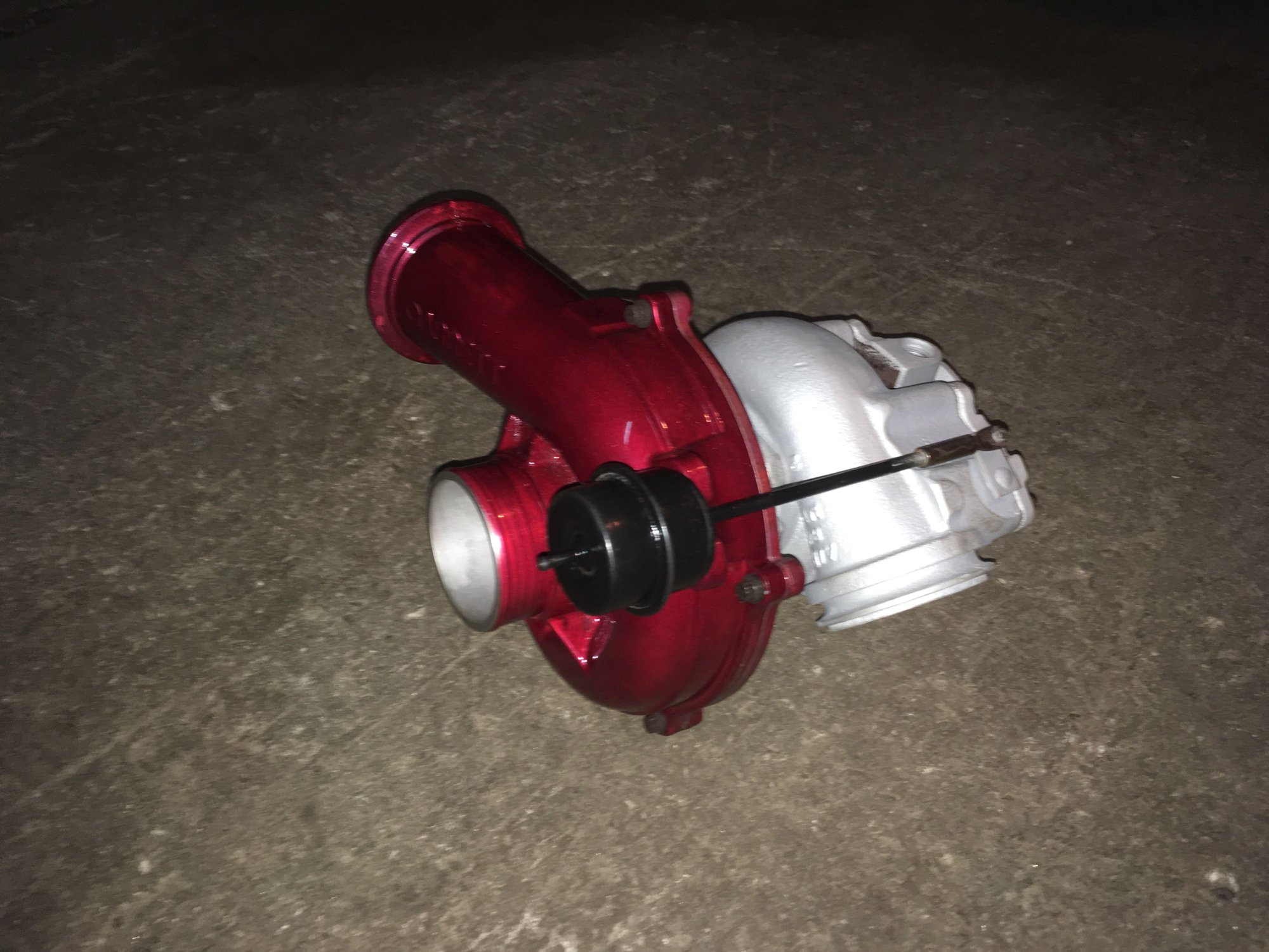

Don’t need a WG. Delete the red and green hoses and crank the WG adjuster ALL THE WAY. I use compressed air to blow it open to make hooking it up easier.
Properly adjusted (SSJ proper ), the WG basically cannot open and reduce the power and efficiency of the engine.
Ive rebuilt LOTS of these turbos. Several dozen. I crank the WG adjuster all the way on every-single-one. Most of the ones I rebuilt, I installed with new up-pipes and other often-neglected maintenance. Most people are simply blown away by increased power and MPG and reduced EGT.
I ran a ‘special’ on these for about 1.5yrs, lol. Rebuilt with 360* thrust washer, powder coated intake and ceramic coated hot parts. 4+4 compressor wheel if you want to buy one.

That’s real purrrdy.
Does shiny parts make it go fasterLol. Kinda like all the go fast stickers.
Honestly though that looks great. I’m currently less than a year on turbo rebuild with the ww2 so gotta take a pass.

Defueling isn’t hurting anything. Should not happen until 24psi. You can watch MAP and see it happen like clockwork.
Need to make sure that is what code is setting SES light. It’s common for ****ty programmer tunes to throw P1280, etc because of dumb ICP tables. Some tuners avoid Defueling but haven’t learned how to stop SES light...
