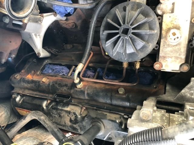

That was just about as much fun as having my wisdom teeth pulled. One side off, one to go.

I don’t know that you’ll be able to snake those plenums back in all that mess without messing up the sealant.
Definitely remove the HPO lines from the heads and I recommend removing the fuel filter assembly as well. This should greatly reduce frustration levels!!
Good work, keep us posted!!
I agree with SSJ but have a word of caution since you have to order parts with lots of shipping costs and probably want to order everything in one shot.
When I worked with a set of the HPO lines, at least 1 of the fittings broke and required a rebuild. Not a big deal but just something to keep in mind when ordering parts. If I had it to do over again I would have replaced using the lines without the quick connects.

Good call. You can just unscrew the HPO lines. Replace the ORB o-rings with viton.
Good point! I couldn’t though since I was changing Dad’s busted HPO line. Man that makes an oily mess.
Those quick connects are a pain. I will never replace with that style again. Turned a rather easy job along the road into week long project.
I’m wondering why F350towing is planning to remove and reseal the driver’s side too if it’s not leaking. Am I crazy here?

Drivers side came off way easier but the last bolt on the bottom was a PITA to get cracked loose. Somewhere down in the backside of the motor, up pipe, or trans, is a 1/2 wrench. I’ll get that back tomorrow.
Found out the hard way what that yellow thingie on the back of the fuel filter is. Heard this fluid splashing on the ground sound. Climb out from under the hood and find diesel leaking onto my asphalt driveway. Thankfully the pressure washer was still hooked up and got it hosed off right away.
HPOP lines... Quick Connect you say??? Special tool required to disconnect? Easy to put back on?
Remove the fuel filter housing... eek... not sure I want to crack those fittings, maybe I will look into local availability of replacement lines first.
So far I’ve found a shop rag, an old mouse nest, and an unusable 3/8 drive socket cause it been down in the valley for so long.
Sure glad this isn’t my daily driver so I have time to put it back together. Still waiting on my parts from RR, but I only ordered on Tuesday so not really expecting them until late next week.
Tomorrow is another day and hopefully by the end of it I will have resealed plenums and most of the harness back in place.
