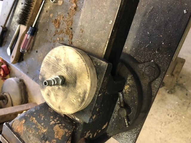

Check out my home made boost leak tester.
Cost me nothing but a few minutes of time with the jigsaw.

Be sure to clamp it well. They go boom and scare you a bit if they blow off. Not that I would know anything about that.

Used it already when I found all my boost leaks that got me started down this path.

I love that boost leak detector.
I might make them like that from now on. I’ve got hole saws that big and scrap lumber is easy to come by.
