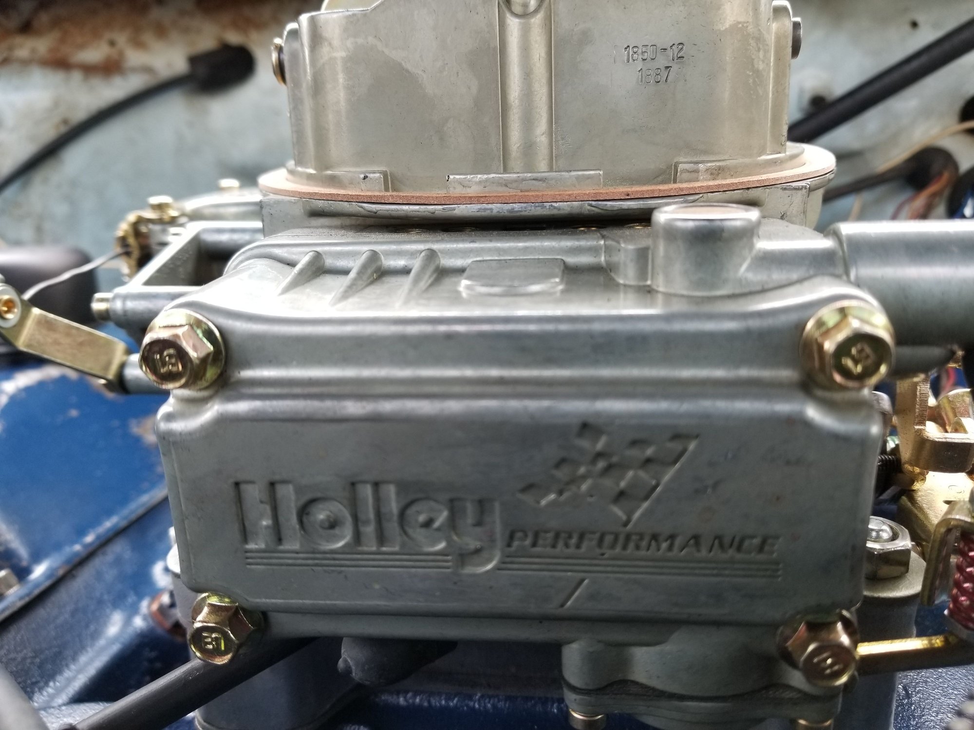

Yes. The Right bank is the passenger's side. Which Holley is it? On the front of the air horn they stamped a "List" number. Post that so I can see which one you have. That will tell me what jets etc are in it.
Old Mar 16, 2018 | 03:16 PM
  #719
F2501972's Avatar
F2501972
Joined: May 2014
Posts: 617
Old Mar 16, 2018 | 03:20 PM
  #720
F2501972's Avatar
F2501972
Joined: May 2014
Posts: 617
https://www.holley.com/products/fuel.../parts/0-1850C
