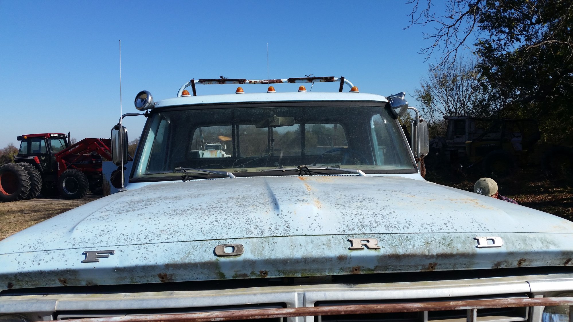

The day I picked it up... so this is the b4 pic
This is from today... my hands a vibrating from using the buffer for hours on the hood today. Wow, it looks great. Photo does cover up a lot of the bad spots and areas I was not able to buff out but it looks a lot better! Will put the hood back on soon.
That's the original paint???? Holy ****! Well done.
