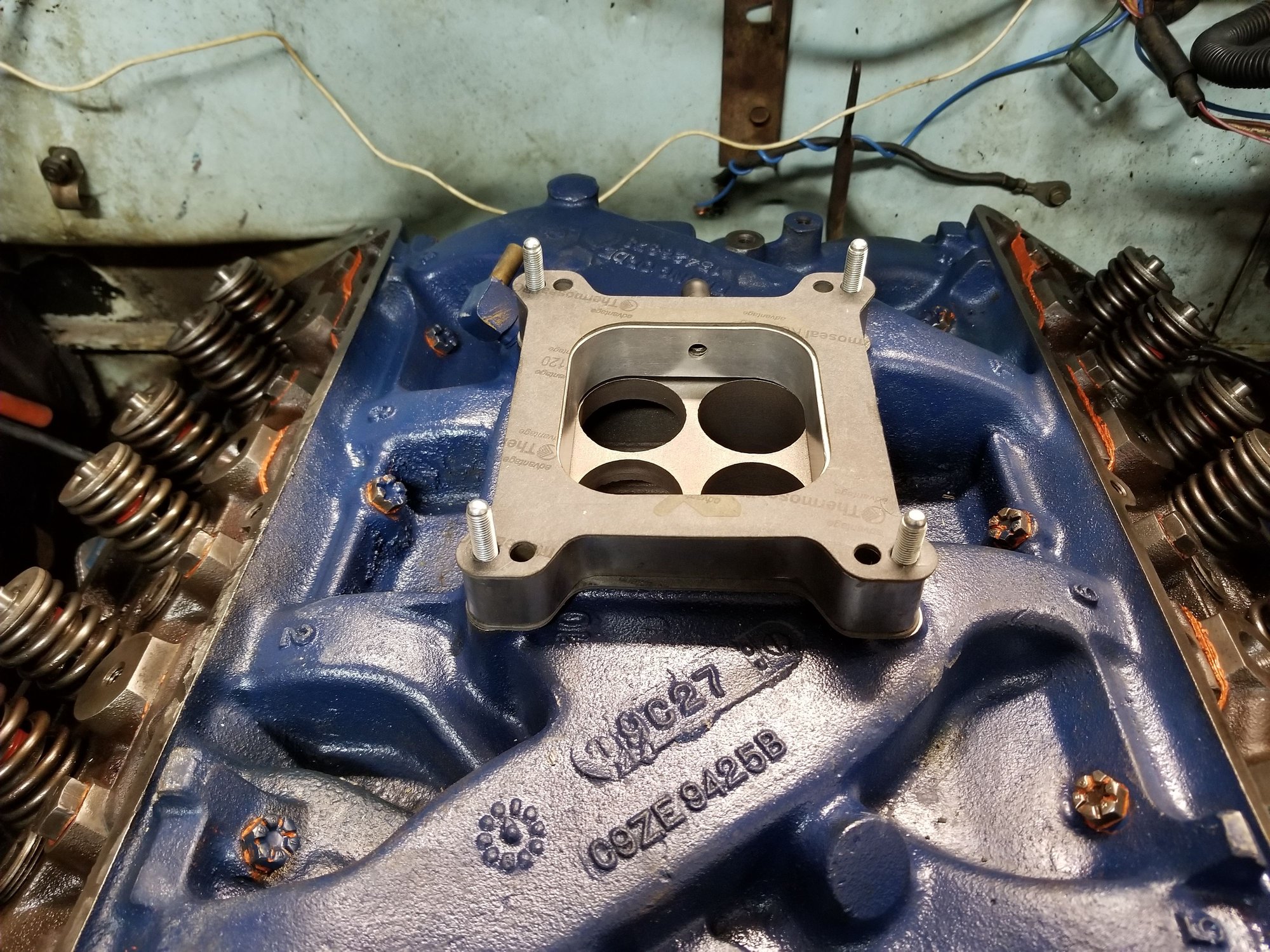

One step closer.

Amm looks like the intake manifold water thermostat by pass hose nipple needs a fixing.
I've seen a brass nipple was threaded in it's place.
Edelbrock should sell them.
I also have seen them for sale on ebay.
Orich

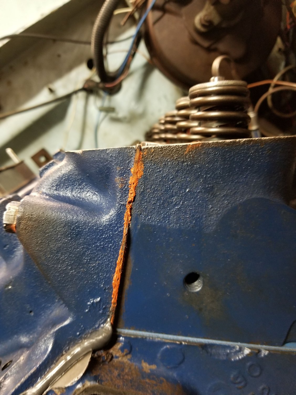

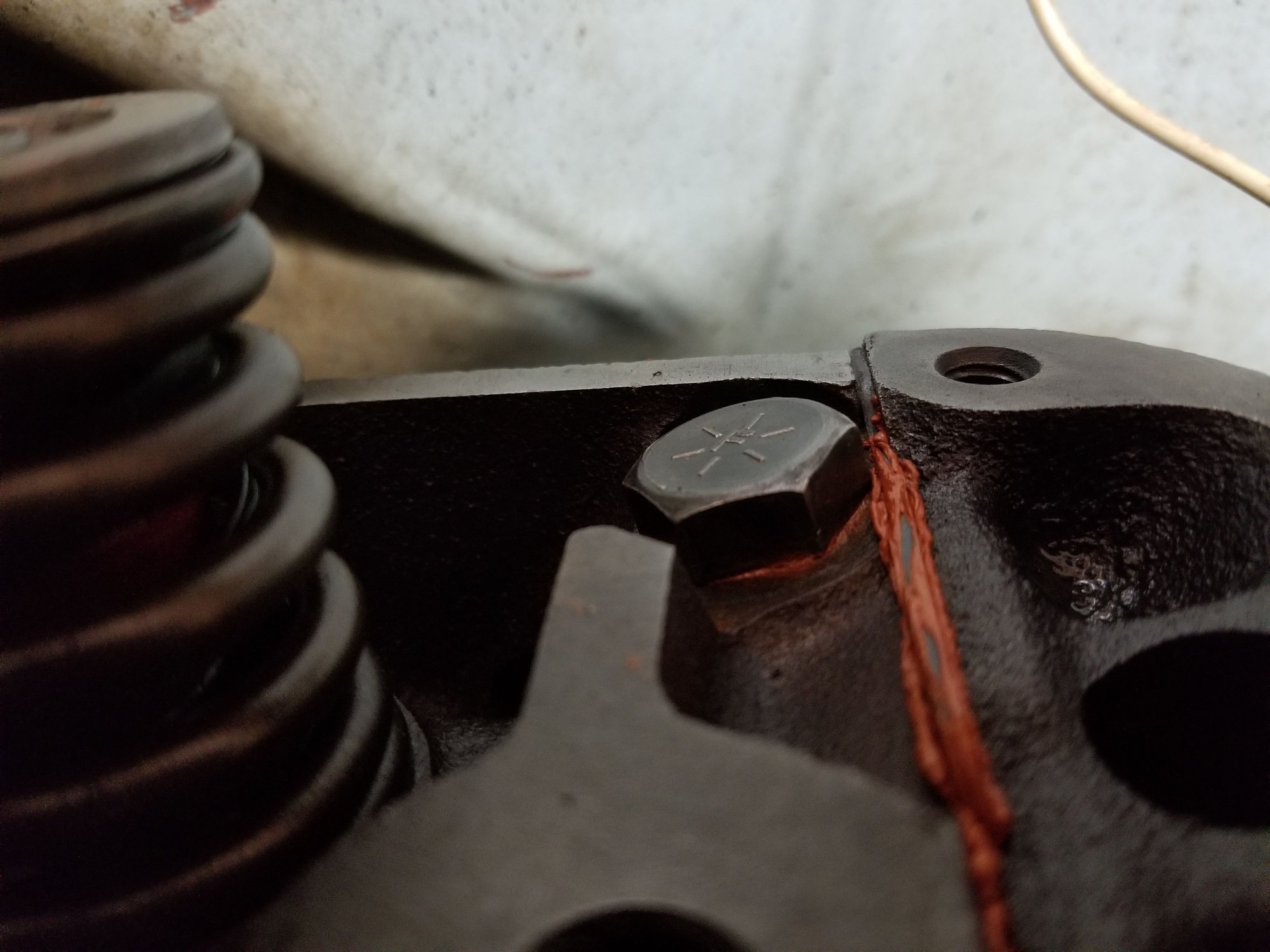

Hey guys. Look at the pics I will post shortly. On the intake, the passenger side is higher than the other 3 sides. The other 3 sides seem fine but that back side by the fire wall on the passenger side is just a fraction higher. Did I do something wrong or is that within tolerance specs?
Thanks for looking at the pics and chime in. - Shawn

This is the side that is slighly higher.
Diff view same side
This is the drivers side to show where I will trim that little edge off. But there is no edge on the bacck side passenger side.
This is the drivers side as well. To show that edge I will trim tomorroe. So all 3 other sides need just a slight trim and all good.
Orich
Rich, good to hear from you! On that nipple - you mean the 90 degree on top of intake right behind where the them goes? I just need to clean it I think. Some of the RTV is on the nipple and I think that is what you are seeing. I think?
Also, please take a look at the other pics and let me know what you think. - Thxs my Ford enthusiast friend!

I think that "ORICH" was talking about the shorted nipple that is just to the right of the themostat opening. It's too short! You will not be able to attach the short piece of hose that comes from the back of the water pump. As far as the head height difference, I'm sorry, I don't know for certain. If I had to guess, I would think it would be OK, but lets hear from some of the guys that have actually rebuilt an FE engine! By-Pass Tube: NAPA # 660-1580. This is the thermostat bypass tube that press fits into the front of the intake manifold. The Ford number was C5AZ8555A. Replaced by C5AZ8555B then discontinued. Was universal 5/8" diameter. And "cut to fit".

No not the heater hose 90* nipple.
Well looking from my old tired eyes the by pass hose which is the short 3'' long that goes from intake manifold to water pump.
Maybe it's blue paint inside that makes it look rusted tend tip..
Orich
Orich
Yes, it's the blue paint but thank you very much for pointing that out. It should be fine, but every other time you have pointed something out it has been spot on. Those eyes have been good helping me! I have said it before but you guys have become a huge part of the story of this truck. I'm very grateful for the people here that have chimed in to help me with finding parts, get thru mechanical questions, pointing me to related threads, encouraging me to keep up the work, and the list goes on.... This thread has become part of the new history of my Grandfathers truck.

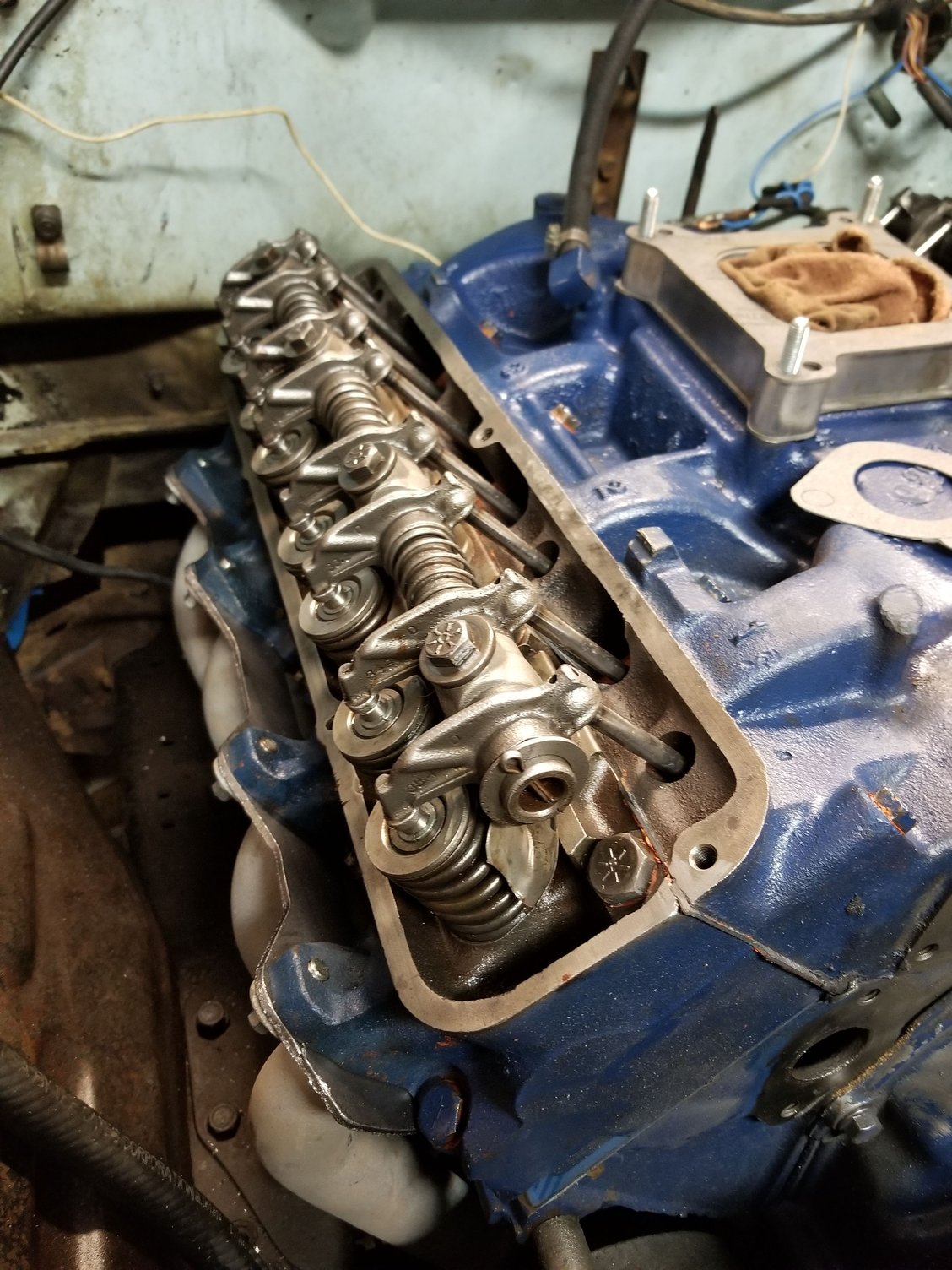

Rocker rails on...
