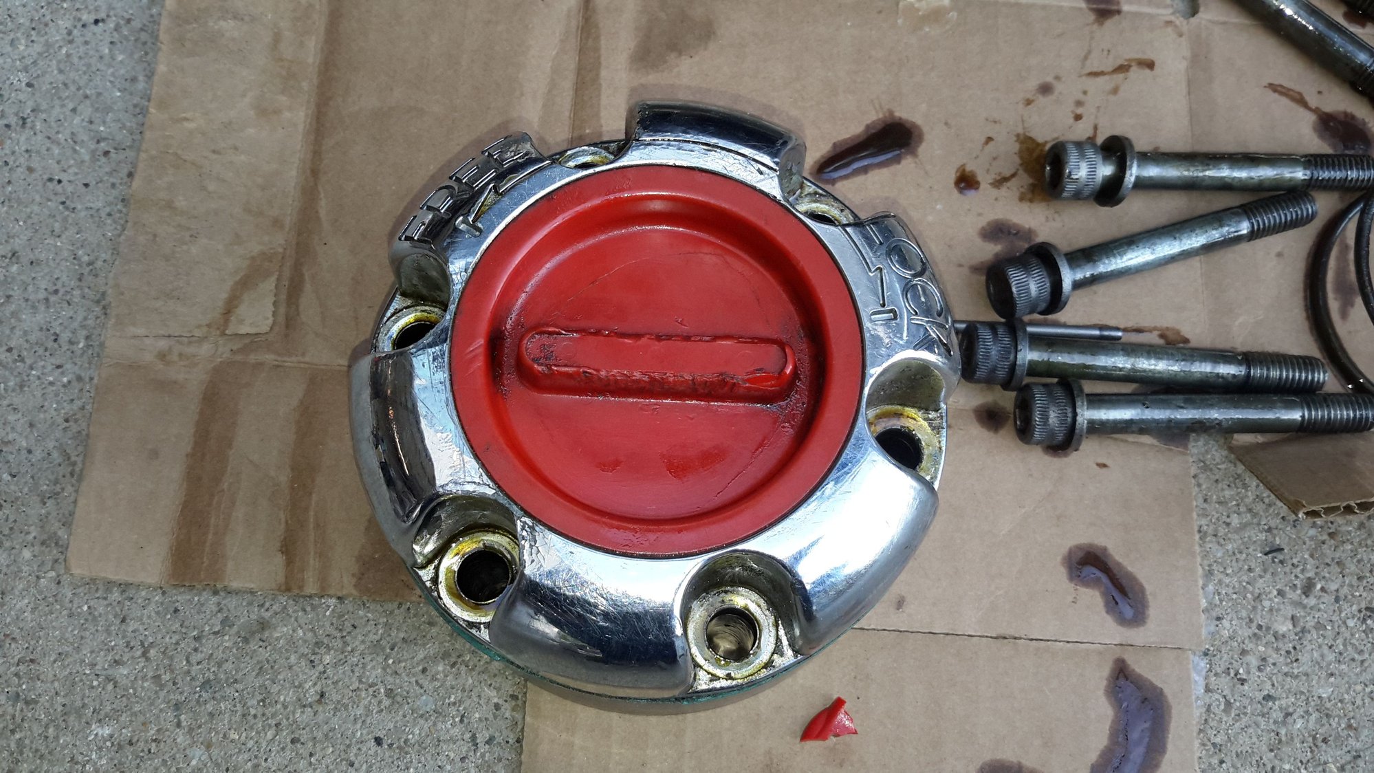

Need some help finding a part. The red plastic Ford Dana 44HD hub dial. It broke... look close at the pic and you will see. It's toast. Would like to find OEM if possible because the other side is fine. If I can not find OEM what are my best options?
Thanks guys!

This side is fine but posted to show the OEM
Drivers side... not sure how it broke but it's toast.
Thanks guys!

Hey amigo, I have the same hubs on my 68, and just rebuilt them after lots of miles. I found new all aluminum hub centers (way stronger than the old plastic), and just as pretty. I got them from either Montana 4x4, or off on Evilbay, I cannot remember which. Also, I use marine grease in them, which is also waterproof, like the pricy greases, and seems to work just fine. I use 50W in my NP 435 trans, which is recommended by New Process, who made the trans... and I use 85/90 W hypoid gear oil in the frond differential, rear differential, and the transfer case, all of which were made by Spicer Dana, (not Ford), and that is the S/D recommendation for years for the Dana 44HD, the Spicer Dana #24 TC, and the S/D 60 rear differential... I have had my old truck since Dec. 1969, and it now has 711,000 miles, so who am I to argue with history? Run what you want, listen the the experts (who usually disagree), but consider experience..
Good luck with yours..
