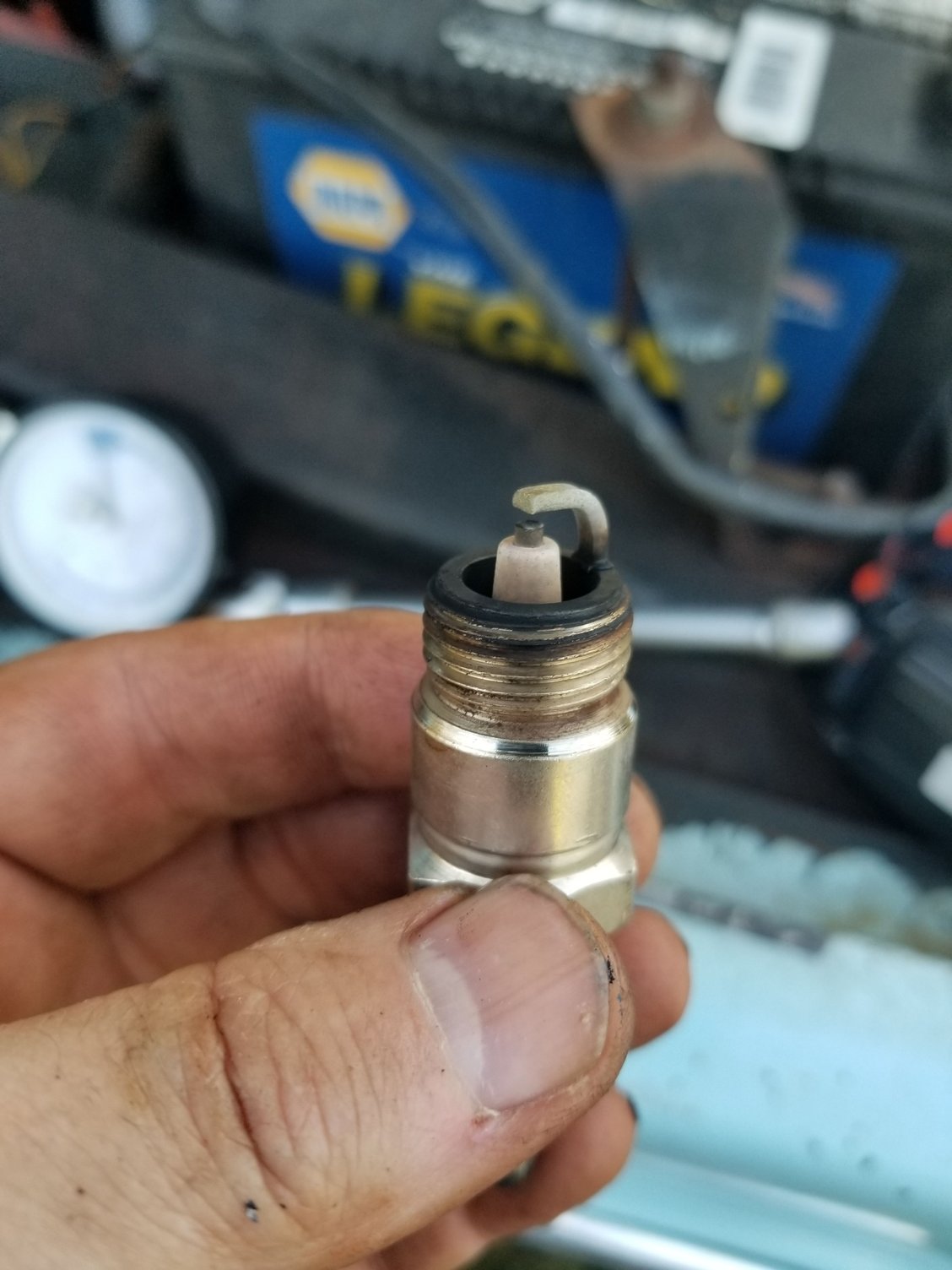

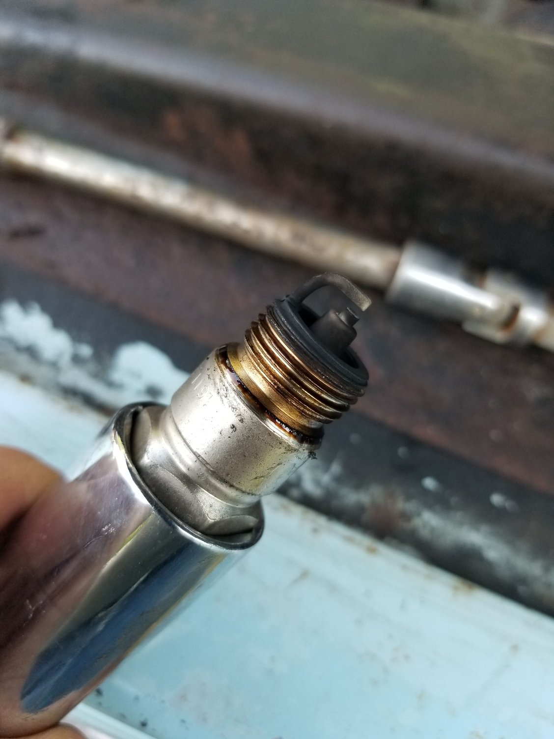

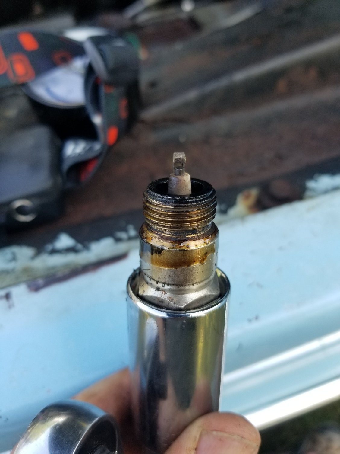

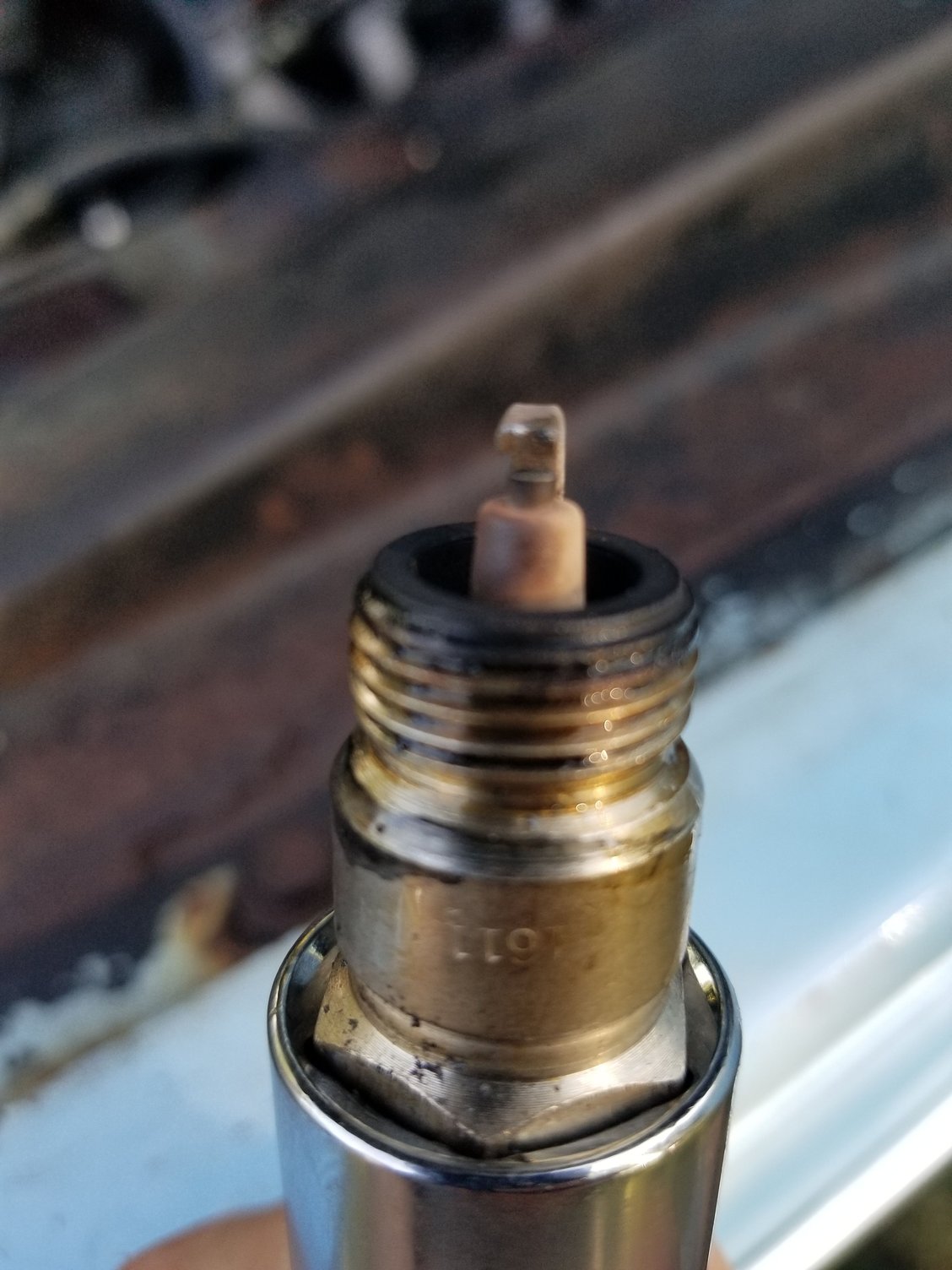

This is the right bank and cylinders 1,2,3, and 4 all look just like this one. Also on this side compression test was 140 on each.
Cylinder 5
cylinder 6
Cylinder 7
cylinder 8

When you remove the intake, the intake ports match up to the ports in the head. The head ports will have oil in them if the intake is leaking.
As for the #1,2,3,4, they don't look TOO bad - but #5 is awful. And #6 is not too far behind it. Hard to say. But again, that high RPM, let off, let it go down to 1500RPM and then when you hit it, you get a blue poof, well, that's almost 100% sure it's an intake leak. Could be something else, but unless the intake valve guide is so warn that the valve is slopping around, you're not sucking that much oil from anywhere else.

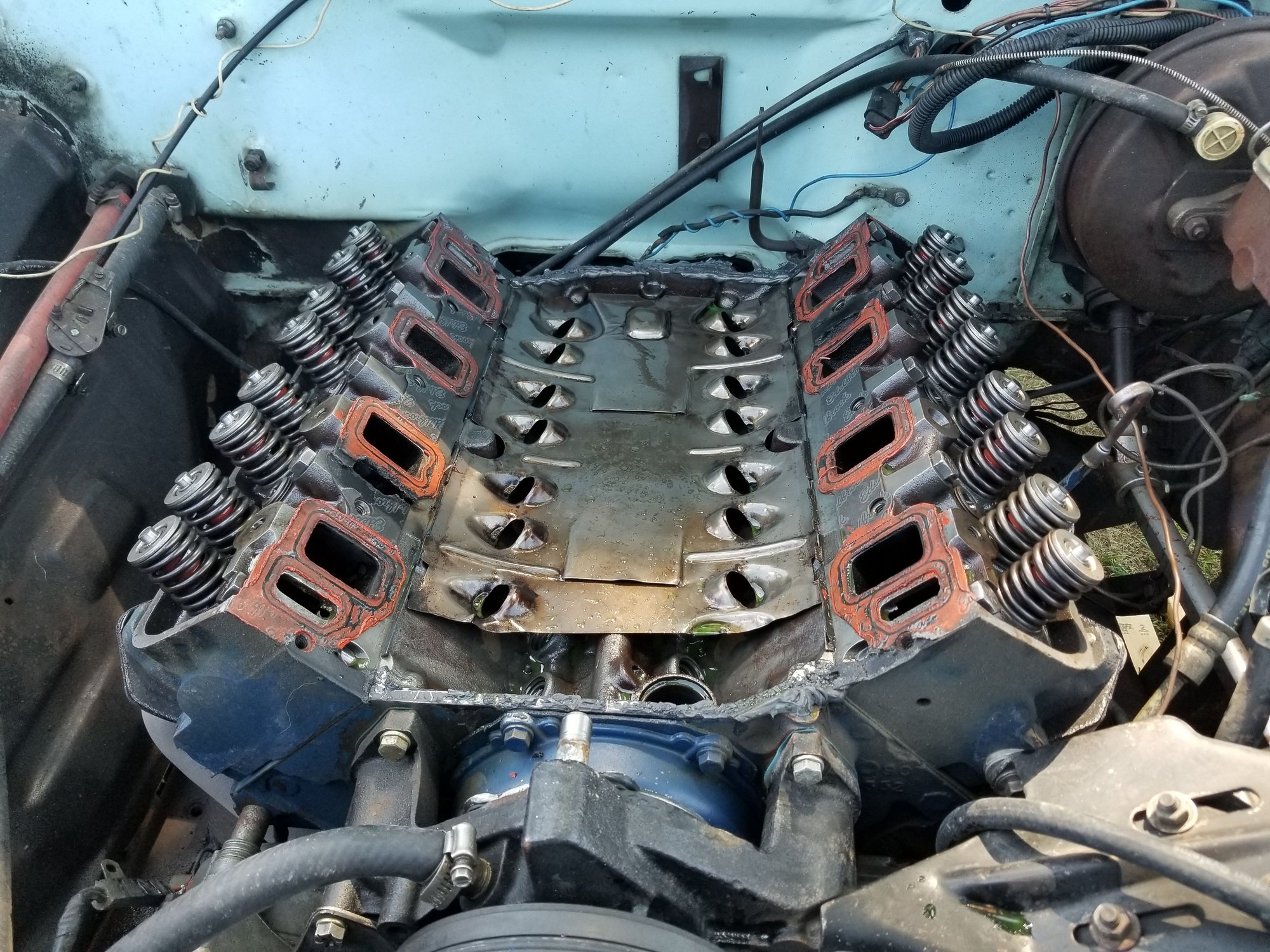

Hear it is... pics are from today

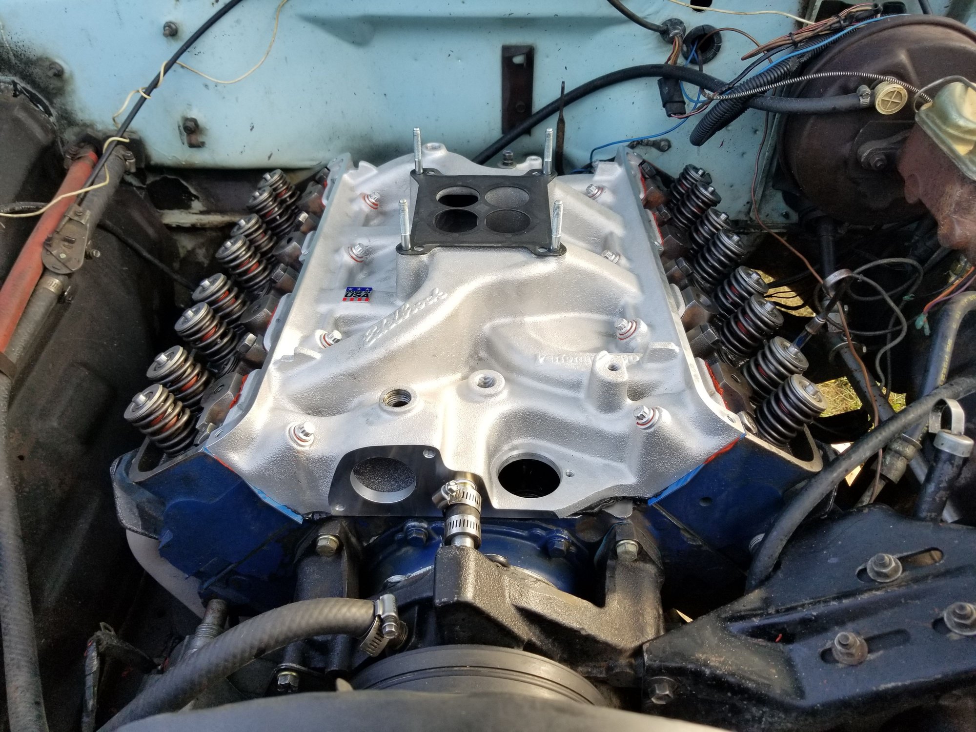

Any tips on putting the new intake on? RPM Edlebrock. Should I use a light amount of heat RTV around all the ports?

The only place you need to use RTV is around the coolant ports (and only a VERY light coating).
Looking at those pics, and how thick the RTV was on the ports, I gotta say, there was almost no "crush" on the gasket. Recheck bolt lengths, and everything else before you put the intake back on. It really wasn't tightened down whatsoever.

Instructions said to torque to 25 ft lbs on this intake and the gasket rtv said let it cure for 24 hours. Will have an update tomorrow night ot Thursday AM.
