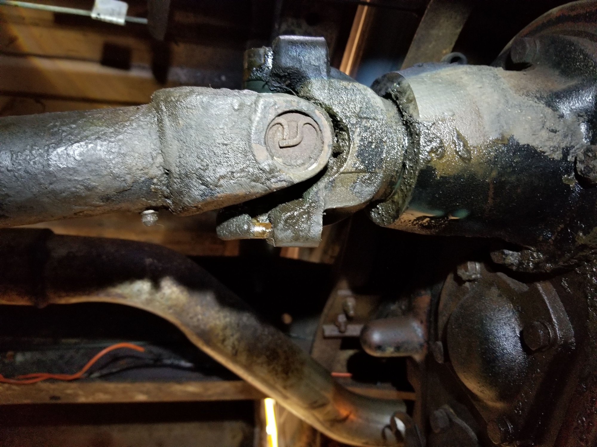

The yoke seal in this pic is the one that drips a little. Which plates can I remove to inspect the inside of transfer case? What would you guys do with it off?

Posts: 617
I found a Miller seal puller tool that looks helpful. I'm going to replace that seal for sure so any tips are appreciated.

  #750
orich's Avatar
orich
Joined: Aug 2003
Posts: 7,592
Likes: 10
From: **** hole San Jose ca.
I mostly remove seals with just a little slide hammer.
Make a 1/8" hole screw in the hammer an slam it out..
But clean all dirt off first, the yoke may have spine seals if non put rtv under the large washer.
Before replace seal figure our a way to reinstalling it.
I use a 2"+- size of pvc pipe that fits the seal good then drive it in.
Orich
