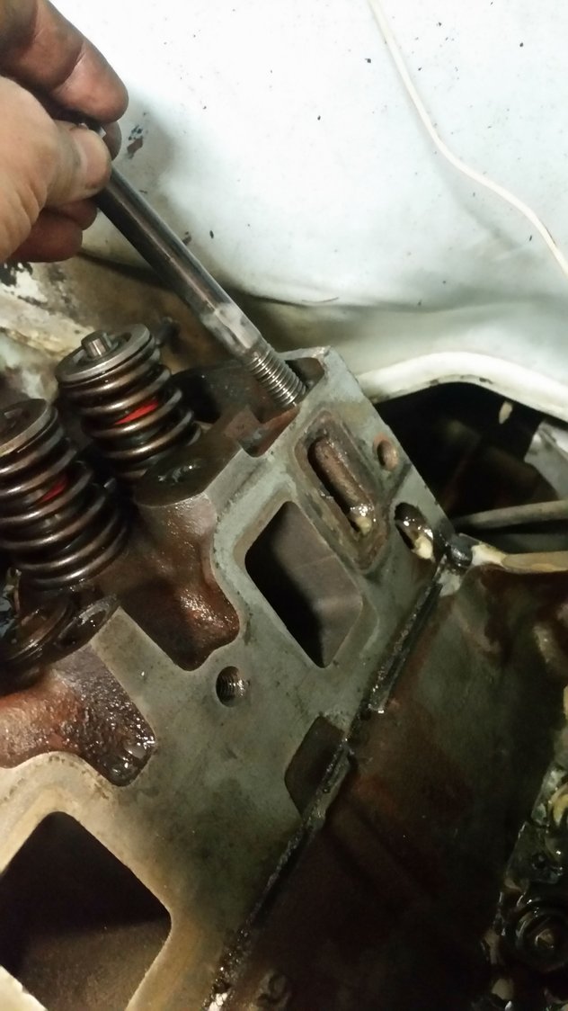

You definitely need to clean the head and manifold in the water jacket area. And use a high quality RTV in that area when you put it back together. I suggest you get the book "How to Rebuild Big-Block Ford Engines: FE & FT Models" Item #HP708.

This is the only bolt that had junk on it. Rest looked fine.

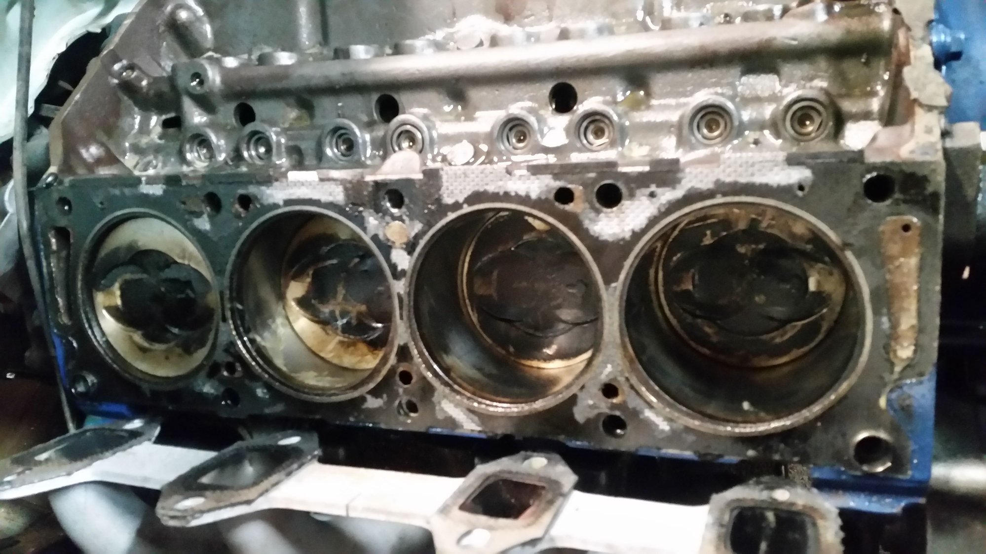

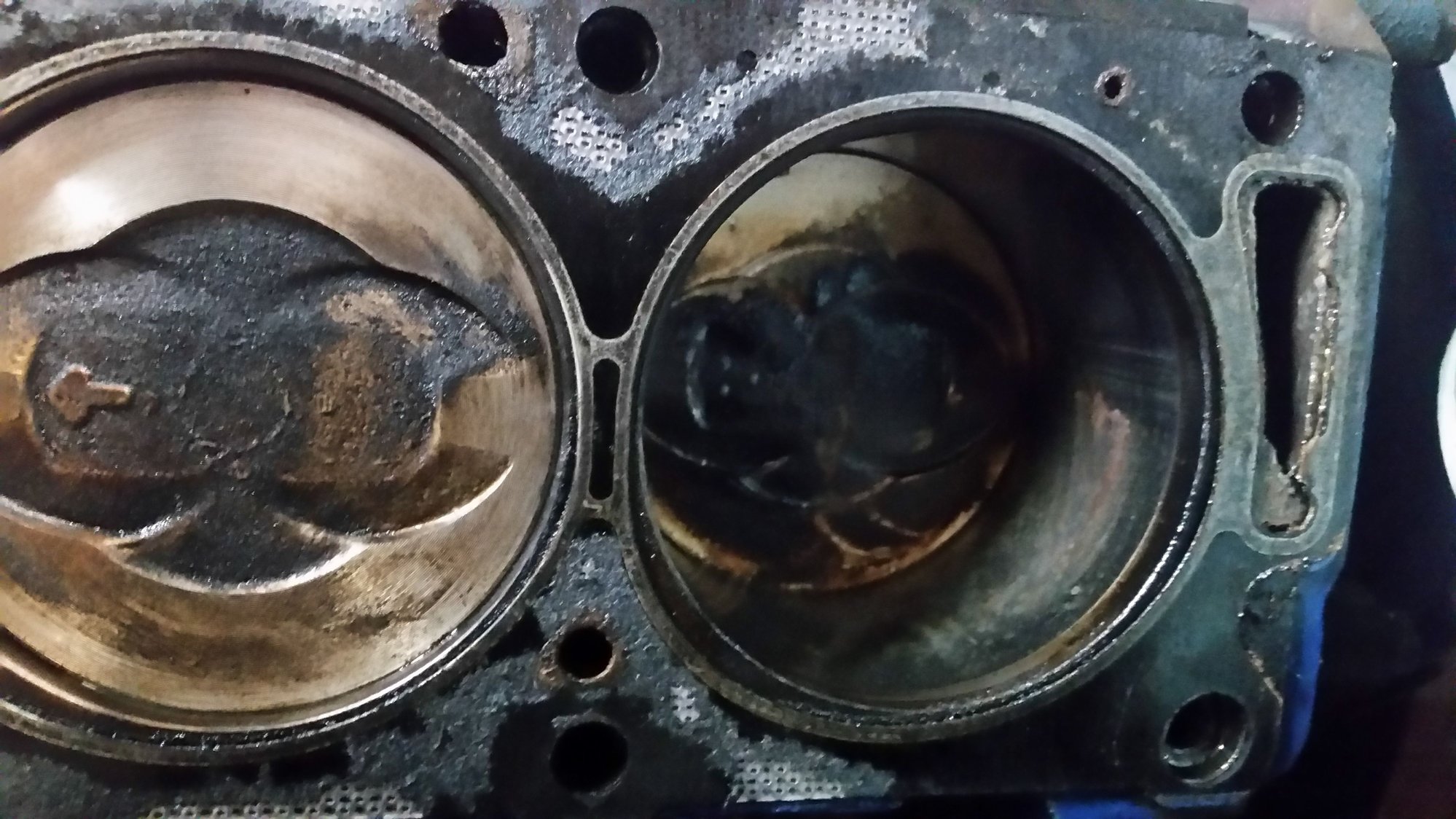

# 3 and 4 cylinders top of piston heads looked cleaner than the rest. I wiped off cylinder 7 that's why it looks cleaner.

Did the head bolts feel like they were torqued tight? Could be the R/S head gasket was leaking. Burning coolant in #3 and #4 cylinders. After the engine was shut off the pressure in the cooling system leaking coolant in those cylinders still. Then coolant seeped past the rings in to the oil pan.
Torque seemed fine. What you said sounds correct.

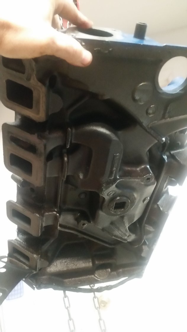

On the manifold... The guy who rebuilt the engine removed the pan that attaches to the bottom of the intake manifold. Is that ok? Or should I try to find one and put it back on?

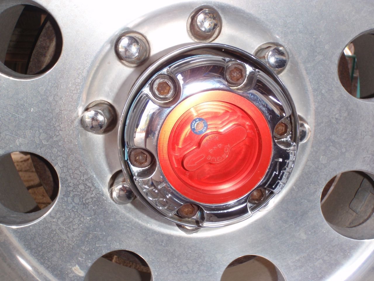

I am loving it, and the history you have with the truck. Ford did not make many of the F250's with the big hubs, and the 12 bolt knuckles for the 3500lb front end. Are your hub centers the original Ford and plastic? If you ever have issues with them, Montana 4x4 has a duplicate in aluminum, in both red and blue. They do not say Ford on them, but I was unable to find any originals.... fact is, the aluminum ones are much tougher..

Yes Baja, those are the original hubs and the red plastic. One of the red ***** has the "Ford" tore off but the plastic is good. I can remember when he would trun the hubs to Lock and he would use pliers on the one side. When I rebuilt the hubs this past summer I found an area on that hub where he must have hit a rock just right on the chrome hub and it was binding the plastic **** just a hair. I used a dremel tool and fixed it. I think you or Orich had suggested the dremel tool and it worked great. I just took my time and checked the rotation everytime I took off some material. Now they both work as good as new!
One hub was frozen solid but I was able to free it up and clean it and now they both work good as new. Both had to be cleaned and rebuilt. I bought new springs from Roy up at Montana 4x4. I think you may have pointed me to them back when I first started working on the drivetrain. Fantastic Tip!
