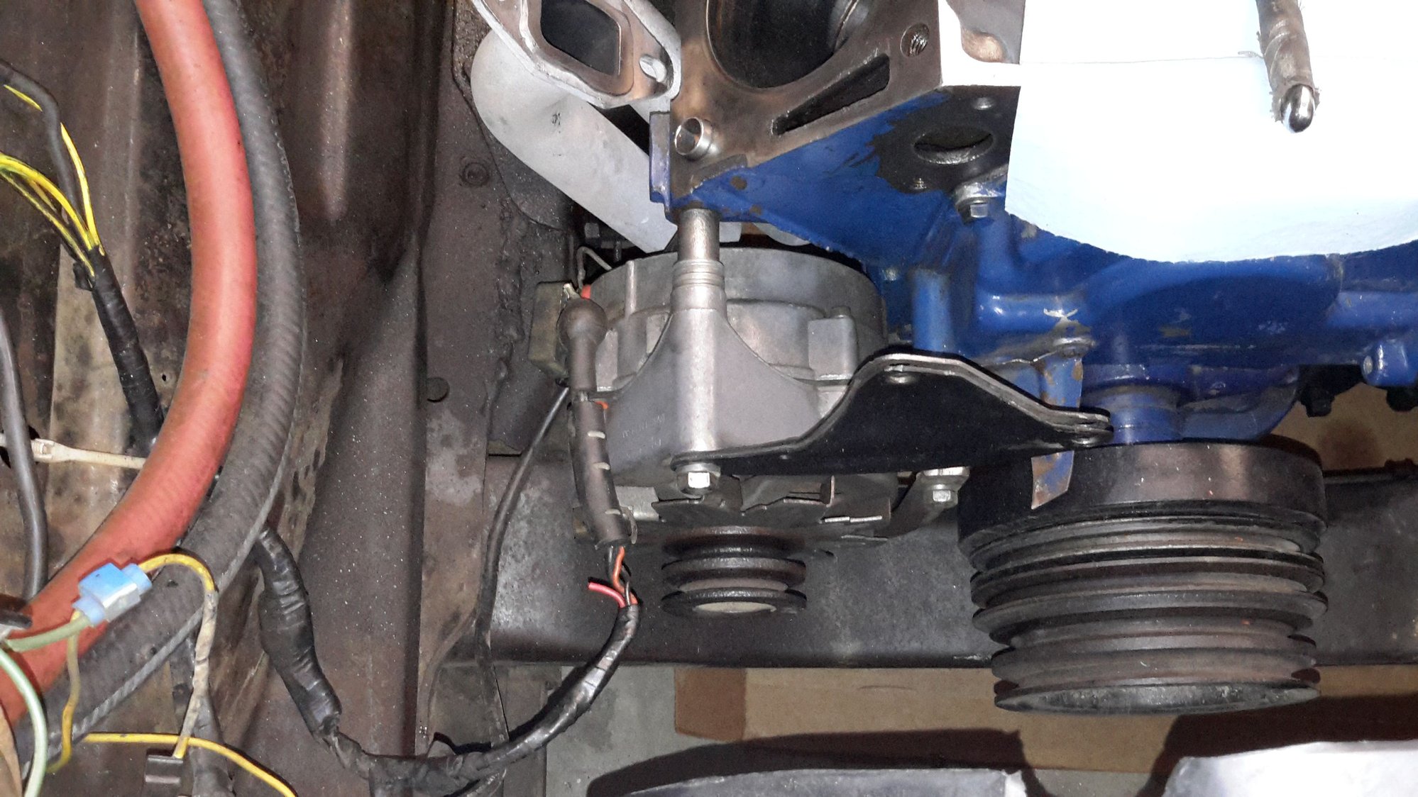

Take a look at the pics I just posted. I broke the Alternator lead. Look close and you can see. Does anyone know where I can buy that wire?
Thanks everyone!

I'm guessing that is one of those GM one wire alternators. Bare the end of the wire and crimp/solder an eyelet on the end if that wire.
