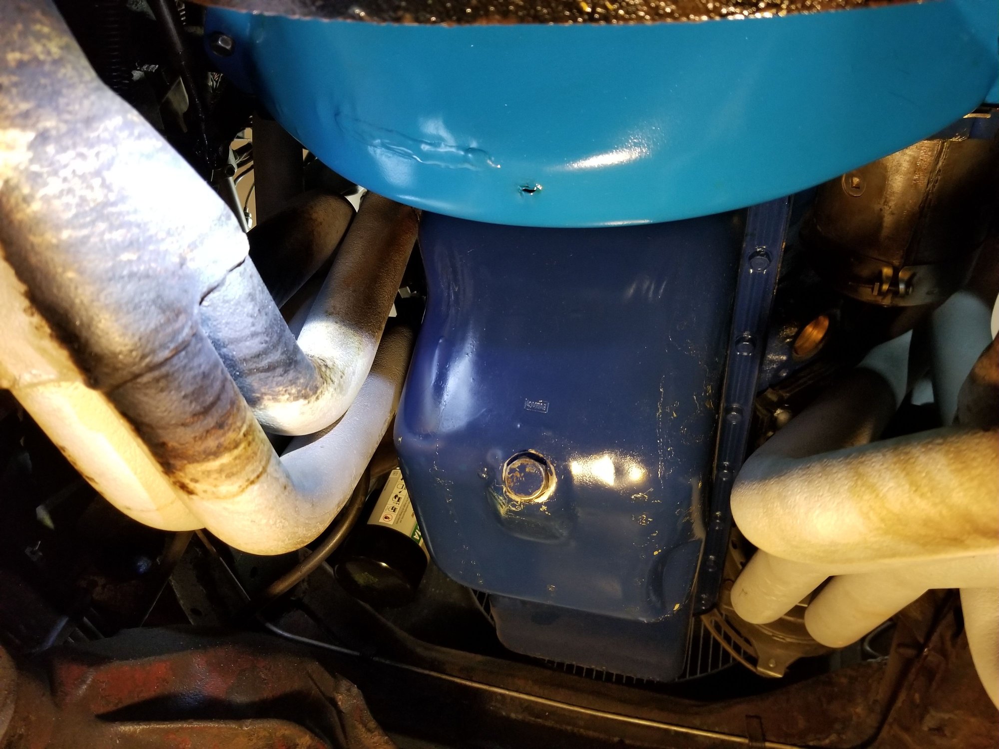

With the headers so close to the oil pan, should I wrap the headers to reduce the heat on the oil?

I would, just to help the oil temp.... and its a good idea in warm climates... mine is a Six, with split headers, and so far I am having no problems in Baja, even in the summer heat, where daily temps can be mid to high 90's, with maybe 10 to 12 days in the 100's... no cooling issues so far...

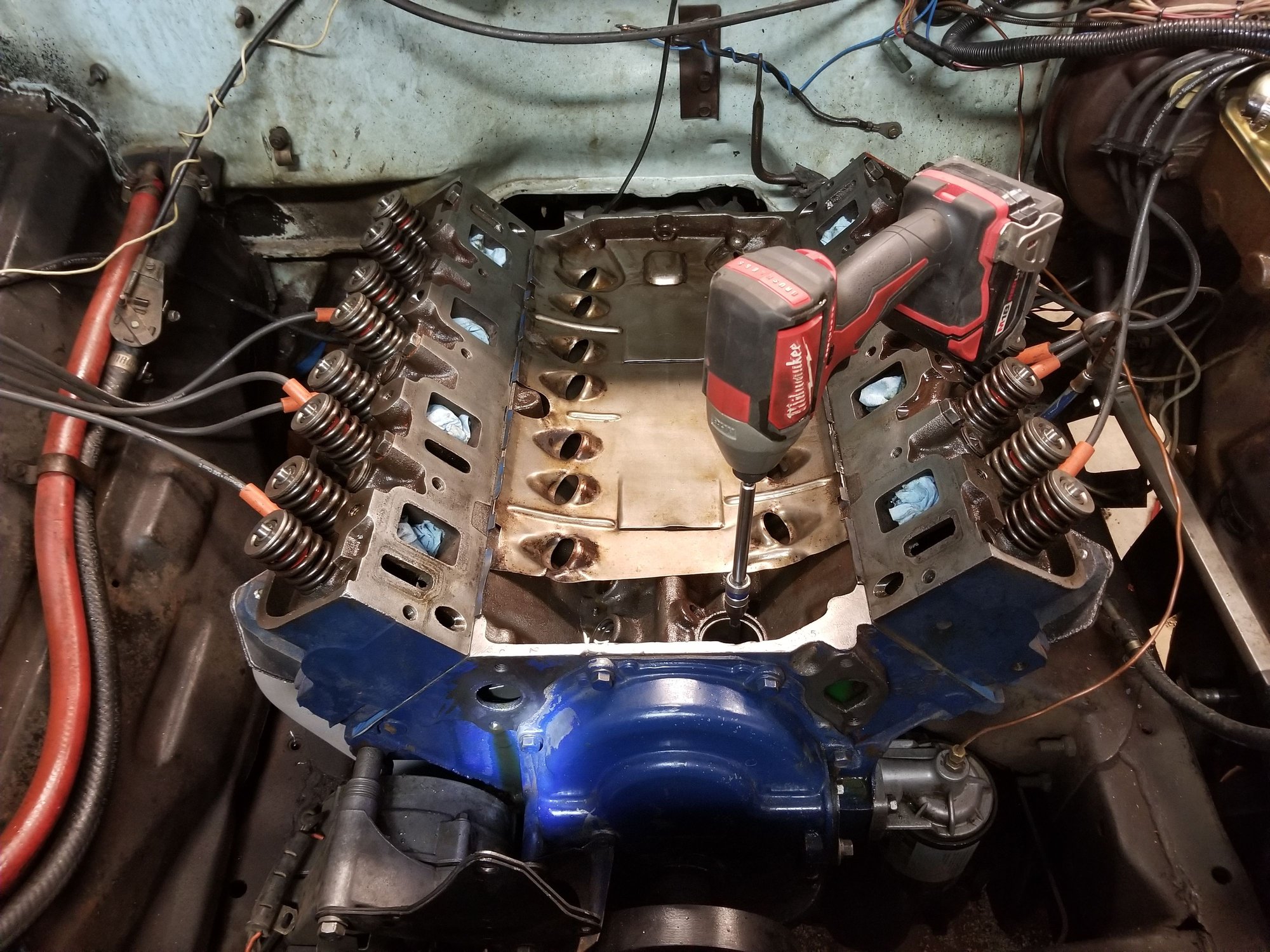

Ok, I'm tired but here goes... I'm getting ready to land the intake (tomorrow) and thought I would check to make sure both sides are oiling well. The left bank (drivers side) is oiling great about 3x that of the right bank. Then I noticed oil coming out of the waterpump port (see left side of pic where I have light on it. You can see the oil running down the engine). So what is going on?

Oh shxt that's a sad sight. But good that you ran the pump an caught it now. Time for some close inspection of head & block...
Hope it's a head problem an not the block good luck.
Orich

That definitely sucks. Hopefully and most likely a head gasket is leaking between the coolant and oil supply passages. I'd start with the right head since that is where the oil is first appearing.

Without the rockers and shafts on there, there's really no oil "pressure" - so I doubt it's a head gasket unless the head was just laying on the block and sitting ****-eyed, and not torqued down.
I'm thinking a cracked oil galley (or rotted through). Not good. Take off the head, and put your finger over the oil feed hole in the block and spin that oil pump again. If more oil comes out, it's definitely the oil galley.

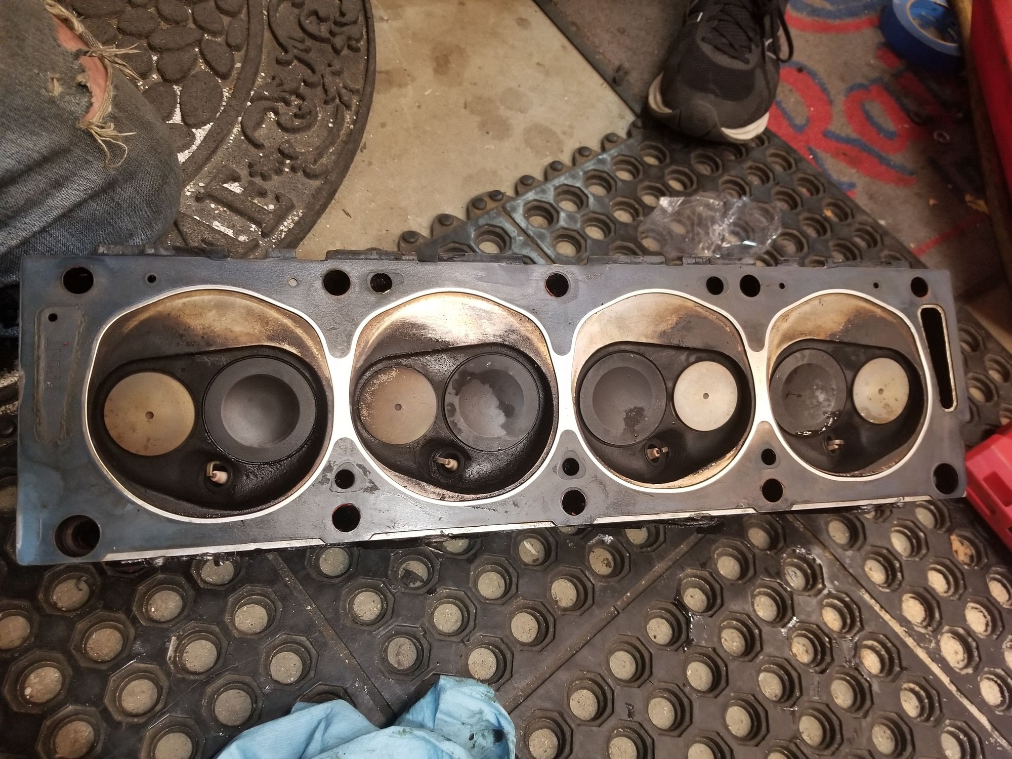

Yes, there is a root to the issue and I'm OCD just enough to not let good enough be good enough. I'll have the head off tonight and post pics of what I find. Thanks everyone for the tips. Keep them up as I can use the help.

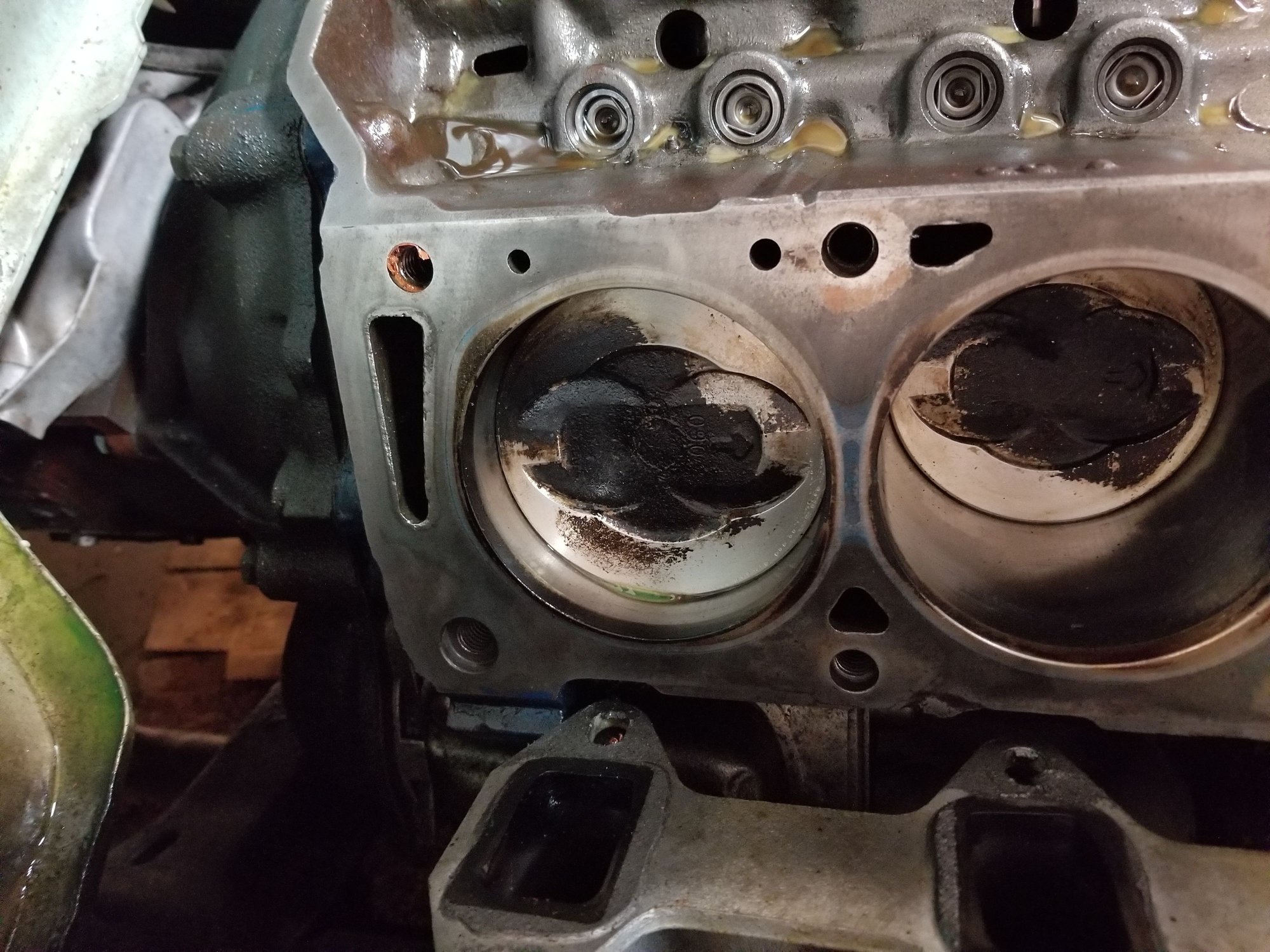

Head looks fine and gasket looks fine. I found 2 things that I will post with the block with pics tomorrow.
Plugs look fine. I will inspect better tomorrow.

Here's what I found: The oil was leaking thru those top 2 bolt holes in the back of block - At the bottom (side) of those threads rotted out or never there. They look clean down in the holes. I can not see rust or rot. When I put my finger over the oil hole in block it does Not leak oil in the water passages. It just needs thread sealer and correct torque. On the torque, I found specs that say 80-90, 100, 125, 140 ft-lb. Have new gaskets and thread sealer on way. Thanks for tips.
