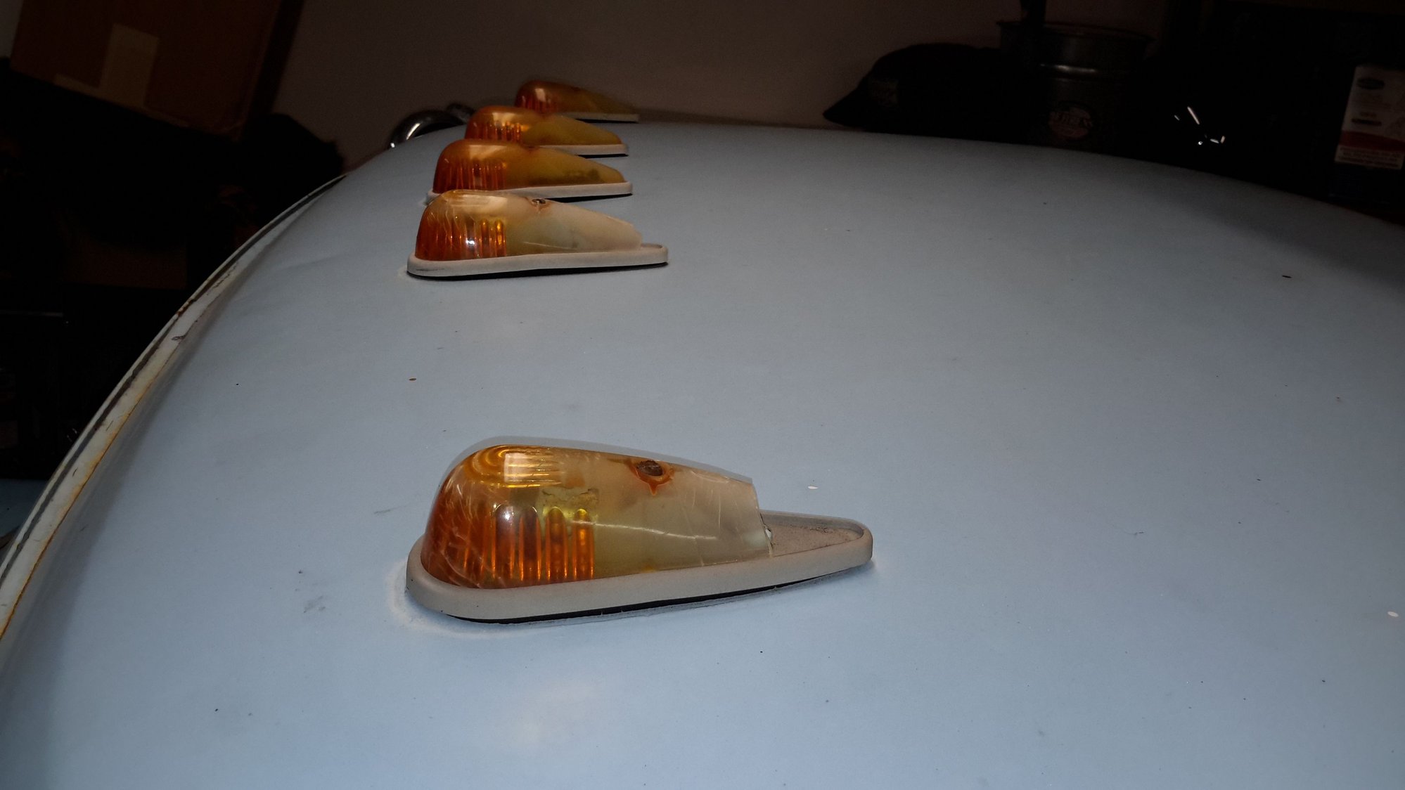

Does anyone know where to buy the cab running lights? I need a full set.
Thxs

LMC Truck?
Superbrightleds.com offers a wide variety. You may be able to find a more modern version that suits your needs.

Lots of truck stops have the same or similar lights for reasonable prices...

Part number is D0TZ15442A. This Dealer shows 6 of them.
Bayer Ford-Mercury, Inc.
200 East Central
Comanche, TX 76442
Contact:Breighton Clemons
Phone(325) 356-2777
Dennis Carpenter Ford shows 28 of them.
800-476-9653

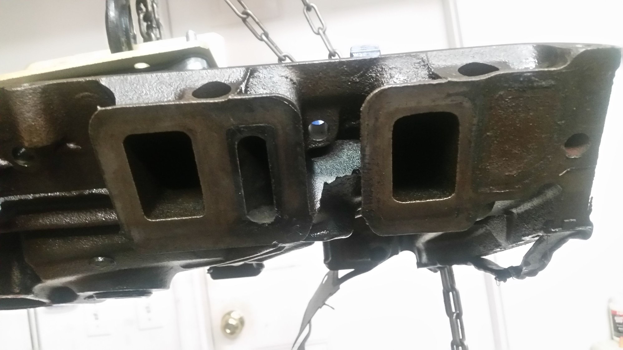

I'll post pics of what I found tonight. I can not see where the coolant is leaking but would like some people to look at the pics and chime in.
Should I go ahead and pull the heads and put new head gaskets as well?
How do the pics look?
Thxs!

My guess is right there is where your leak was. How did the old intake gasket look? Any signs of coolant seeping under it? When installing the intake put a little RTV around the gasket's water passage to help it seal right there. Just don't go overboard.
I do think you ought to yank the heads. You are right there. And apparently the guy who rebuilt it had his head somewhere else. 1st off you can make sure the heads are torqued back down correctly. And 2nd, you can make sure the head gaskets are mounted correctly. Sometimes one of the two head gaskets gets mounted backwards. Which causes the engine to run hot. I don't remember which one. If no one chimes in with this answer I know Orich knows which one it is.

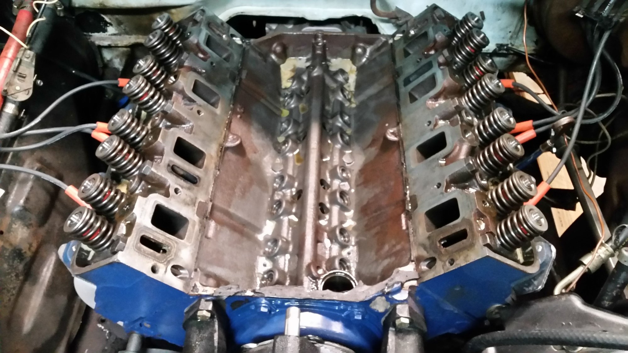

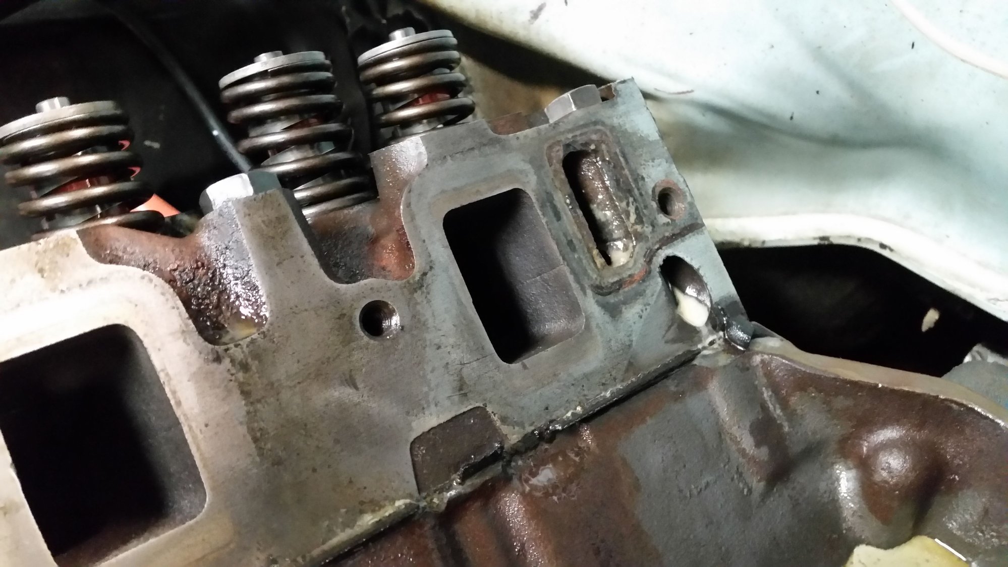

The old intake manifold gaskets did not show signs of a leak. I will take heads off tonight. ordered the Edelbrock 7368 set. Will also put those washers on the water pump that you pointed out.
https://www.summitracing.com/parts/e...rd?prefilter=1
Once I have the heads off I'll post some pics. The guy who built it understood that RTV needed to be used on those FE engines but no sign of RTV on any bolts or the water jackets. I paid good money for the engine to be done right and he did not deliver on his word. Disappointing but I will fix it right with a little help from the Holy Spirit and my friends on this forum (big smile).
It's great that I'm making progress. Just a little slower that I hoped.
What do you think about having the heads pressure tested? Is there a way to tell or would it require a machine shop.

When you spoke of paying good money you reminded me. Did this guy give you any warranty?
With the valvetrain off all the valves are all the way in their seats. If you have the means of pressurizing the cylinders with compressed shop air you can see if the valves and seats are tight.
