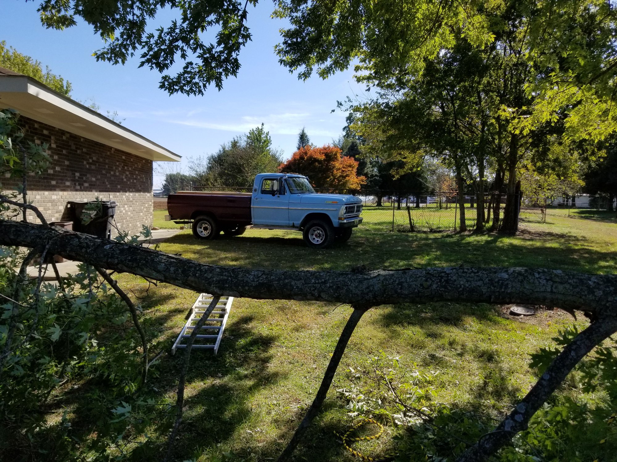

Great to hear you have been able to drive it around some. It is a good looking truck.

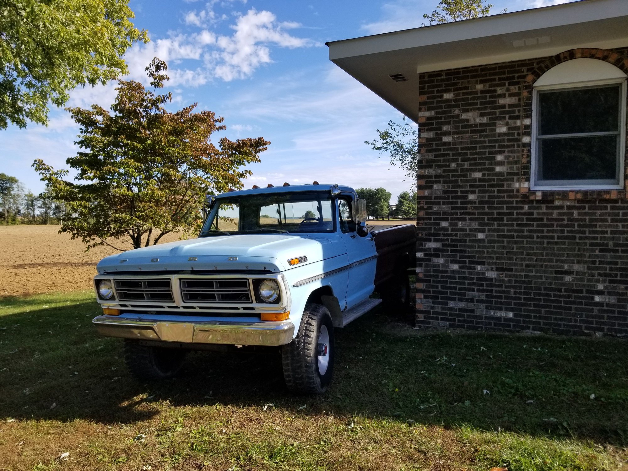

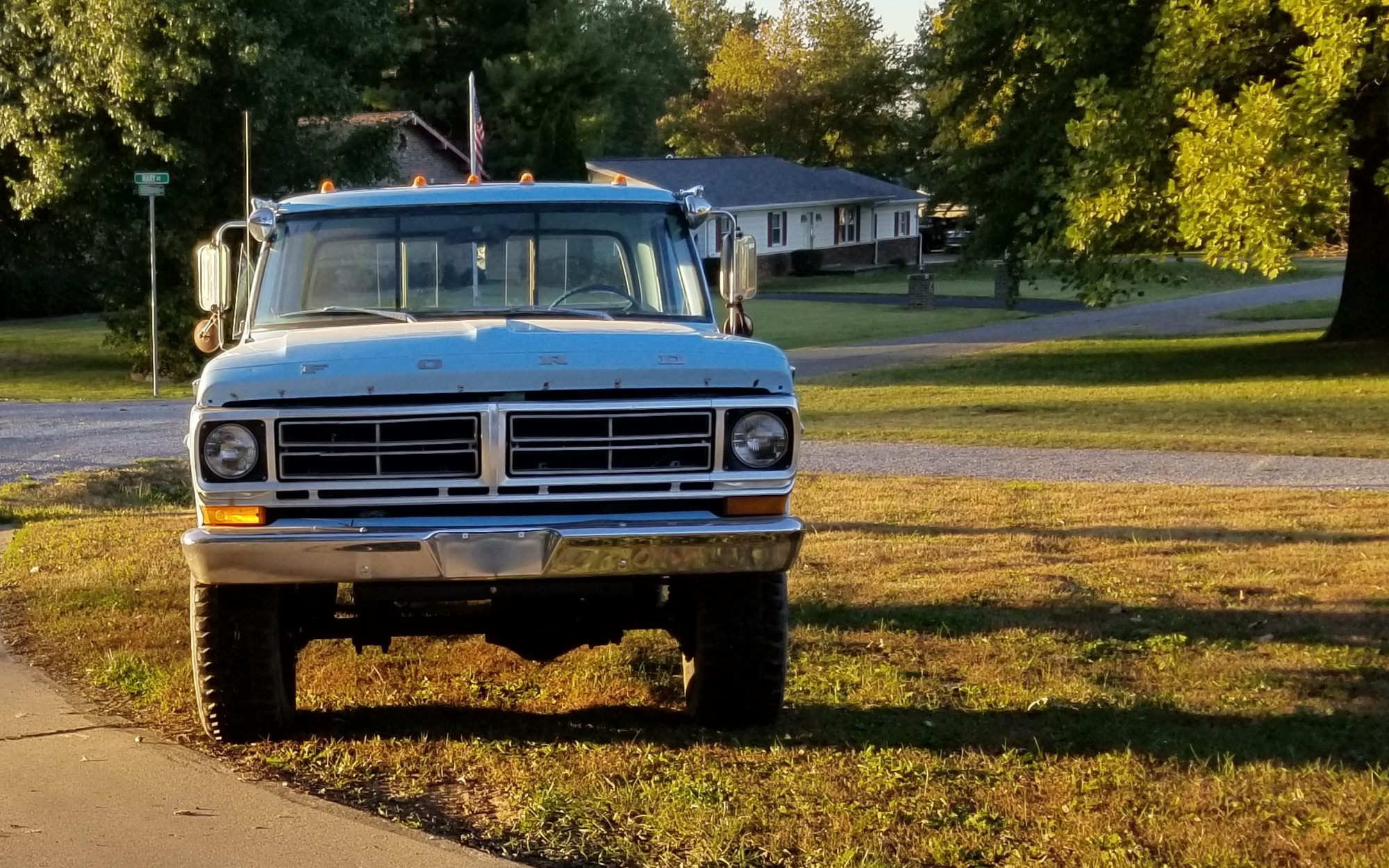

Driving the truck some. The FE 390 is running well. The electronic fuel pump is a bit loud. Is it true I can drop a 460 engine in that will bolt up and drop in without issues? Has anyone done a 460 transplant? Does that engine offer way more than the 390?
