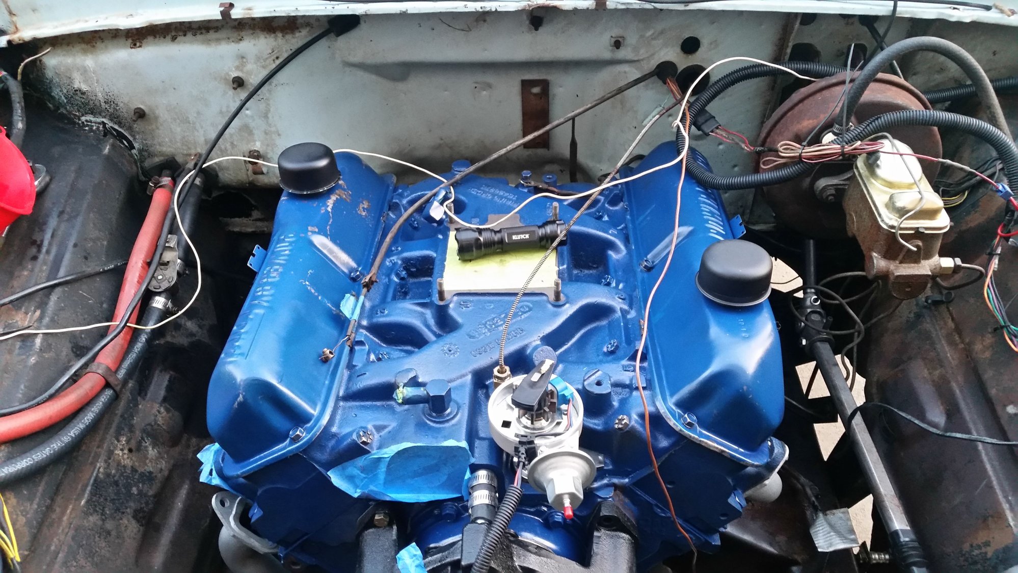

So, did you guys pick up on the fact that I put the engine in but still had to put headers on? Well yesterday the light came on in my head. I had to pull the engine out to drop the passerger side header in and for that matter the drivers side. So today I removed what was installed, pulled the engine and dropped it back it. Bolted the bell housing back on. And as you can see the left side is on. Starter is back on as well.

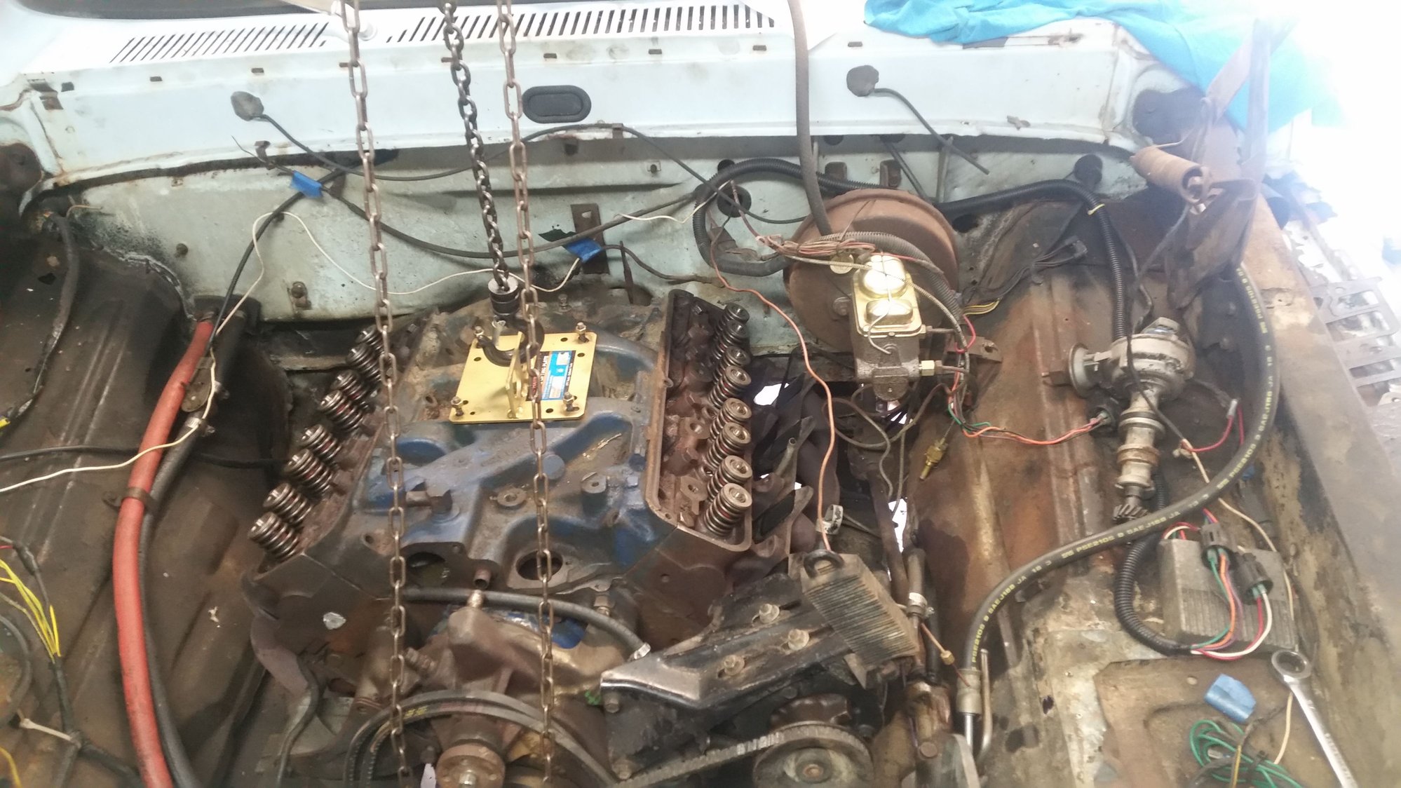

B4 pic as a ref for the above.

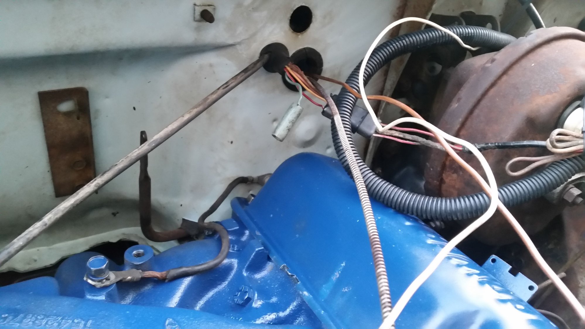

See the wire in the close up pic above... where the one wire is hanging. What is that and where should it go? I'm back on the truck. And wanting to double check my wires as I approach 1st fire up and break-in.
Thxs!
Looks like it was painted at some point in time. If the wire under that paint is Blue then it would go to a carb throttle solenoid. IF the truck was equipped with one.

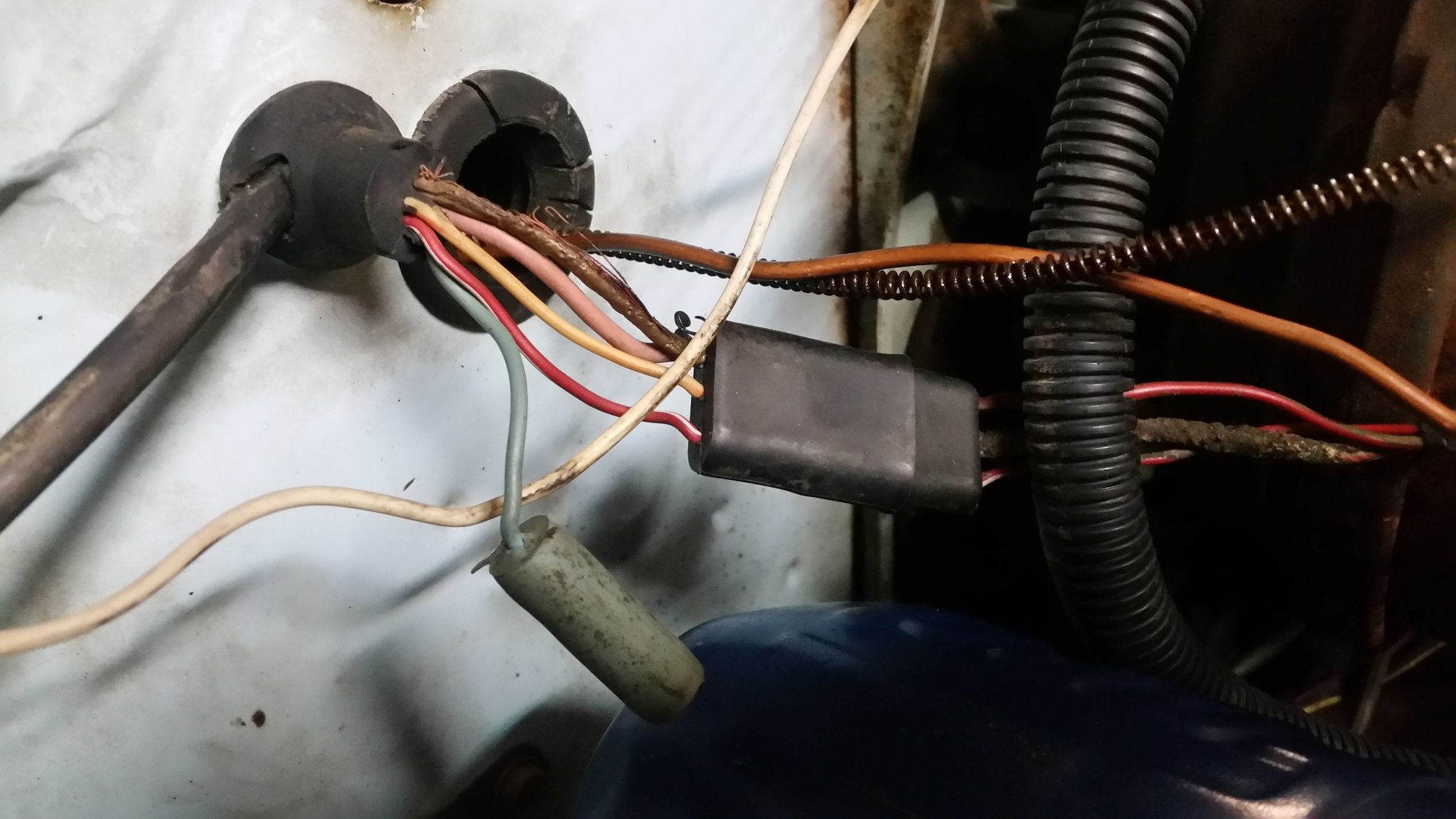

I'm trying to trace the wires and make sure everything is correct. See that top wire in the set? It must have been hot or something b/c the wire is bare. I will go thru the manual tomorrow to see what I can find but does anyone have an idea? Thxs

Looks like it's the brown wire coming from the "I" terminal on the starter solenoid.
