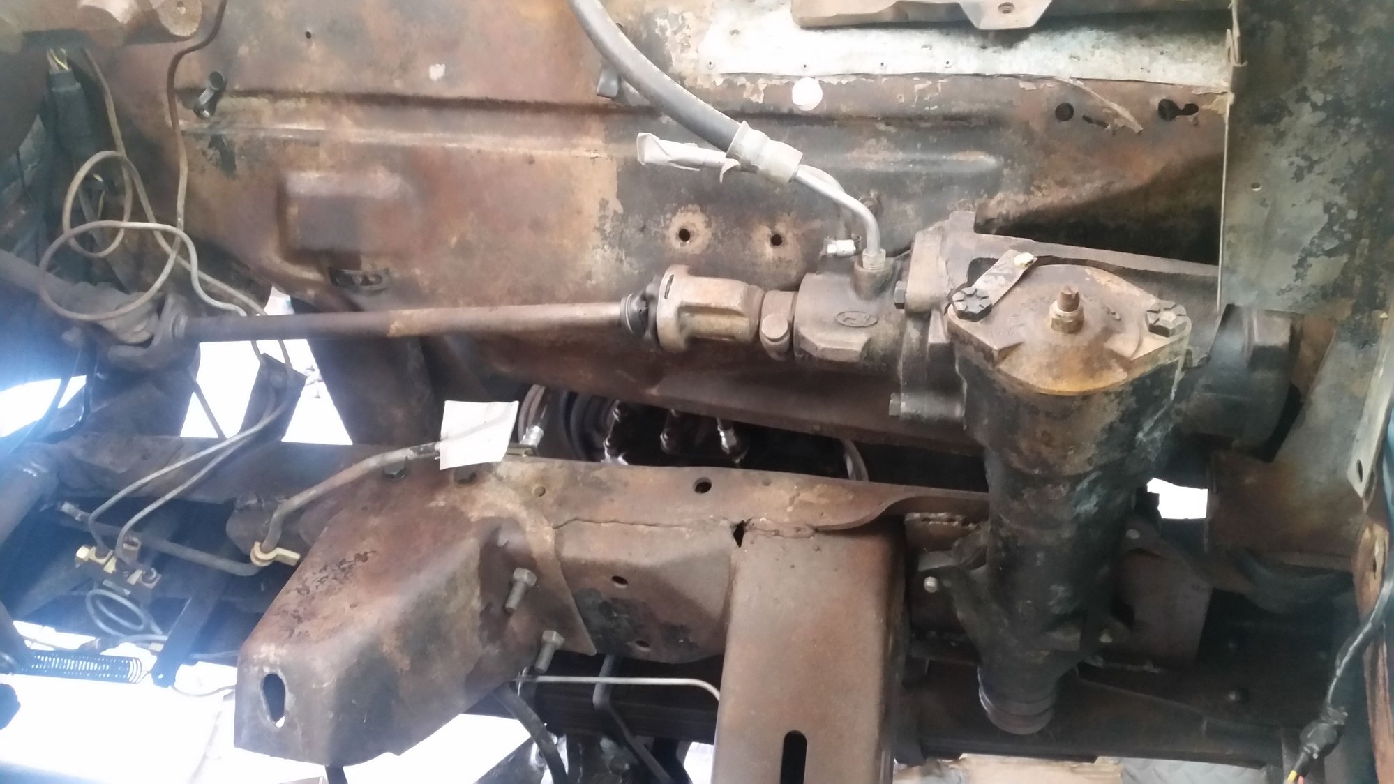

That's the ticket for the steering shaft...
Originally Posted by fe390pc
Technically that is not a rag joint. If it is worn out the best thing to replace it with will be a Borgeson Shaft.
https://www.amazon.com/dp/B001C5U9AS...=1XTEJJO6O4ZNR
The 1978/9 F250 steering box is this,
1979 Ford F Series Trucks Power Steering Gear Box F200-350 [3/4. 1 ton] 4WD Model - With Power Steering 82-00295 AN
FE390, Thanks!!!!!!
I looked at the shaft better today and it was so close to coming apart I order a new shaft. So thanks a bunch for the tip. Shaft measures just over 20 inches so I ordered the one below which is a shorter shaft. But it will be a huge upgrade. The other shaft could have failed under some real 4x4 moves. I'm doing a couple of items in prep for the engine next week.
Amazon Amazon
https://www.summitracing.com/parts/brg-000975 (Summit tech support helped me out today so I bought it from them and it will be here Friday)
I do have a question about the steering column but will take a pic and post that in a bit.

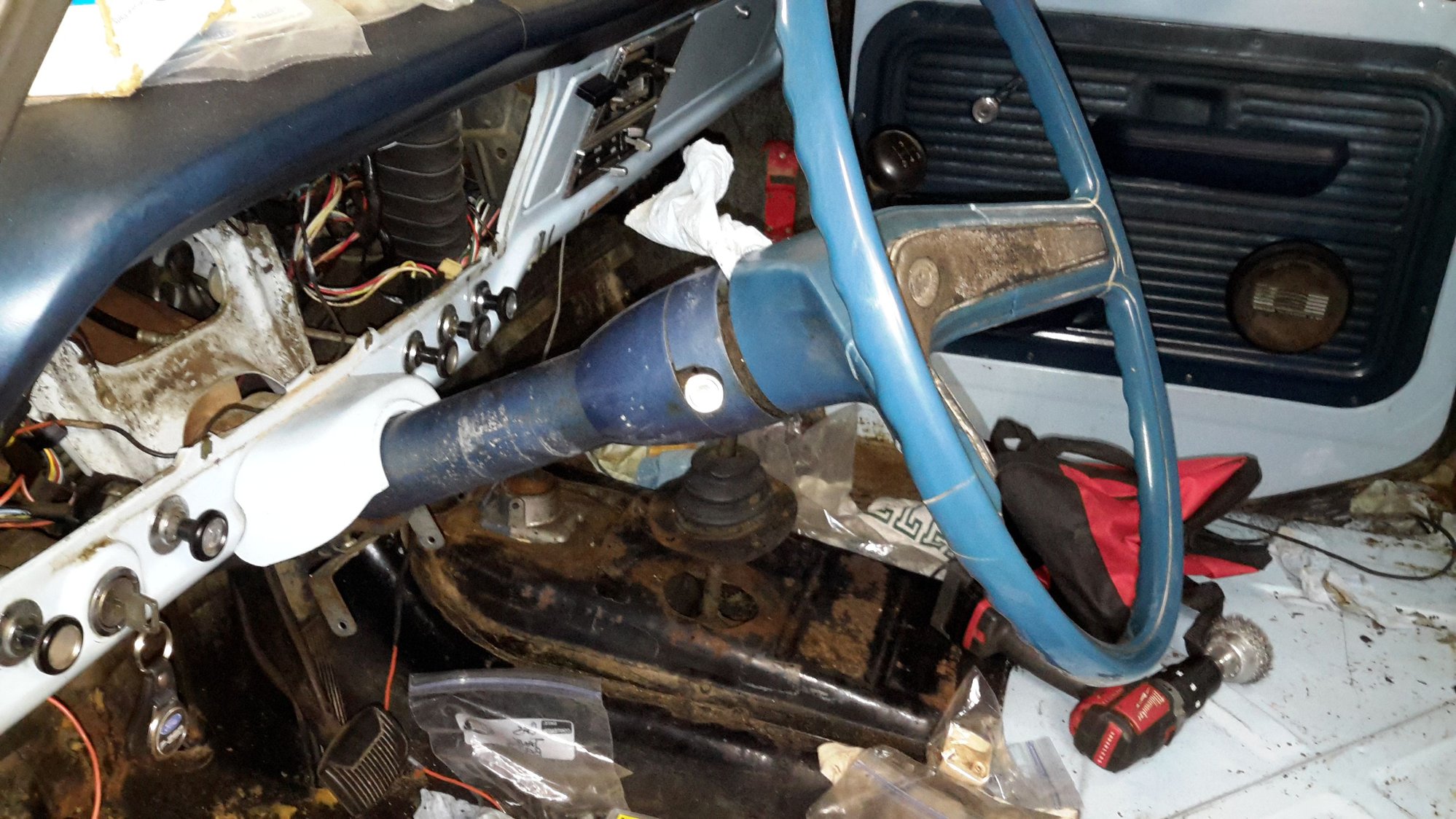

See where I stuck the napkin between the wheel and the column... The shaft is removed while I wait for the new one. I the mean time, see the gap between the column and the wheel? I can push down and the wheel moves in to the column. Should it do that? or what should the reveal be? I tried to look up the specs in the manual on the steering column but no luck. Thanks for any thoughts... One step closer...

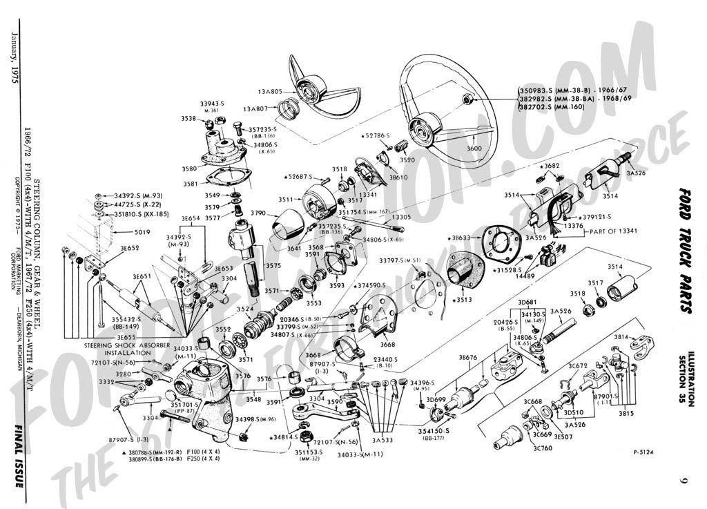

See where the steering column is coming out of the cab/? Should there be a boot?
Thxs!
Old Jul 6, 2017 | 08:53 AM
  #515
fe390pc's Avatar
fe390pc
Joined: Mar 2009
Posts: 4,835
Likes: 595
From: Minnesota
There should be a bearing at the bottom of the column. Here is a link to an exploded diagram of your column.
http://fordification.com/tech/images...ing-column.jpg
Number dummy and Jefffafa can point you to places you can by the bearing. Green Sales have been good to me and others.
Hope this helps.

What all parts are you missing? And I don't remember. Which column are you using? Did PO swap it out? Since there is a gap between it and the steering wheel I'm asking. Makes a difference on the bearing stuff bottom of column.

The steering column is original from 1972. The truck did Not have power steering. PO had a Ford power steering unit 73-79 installed in the late 90's. I think all the parts are there, my thought was while the engine is out and have good access I might want to see if it needs anything.
It looks like I can drive that small bearing at the bottom of the column up about a 1/4 inch which will reduce the gap.

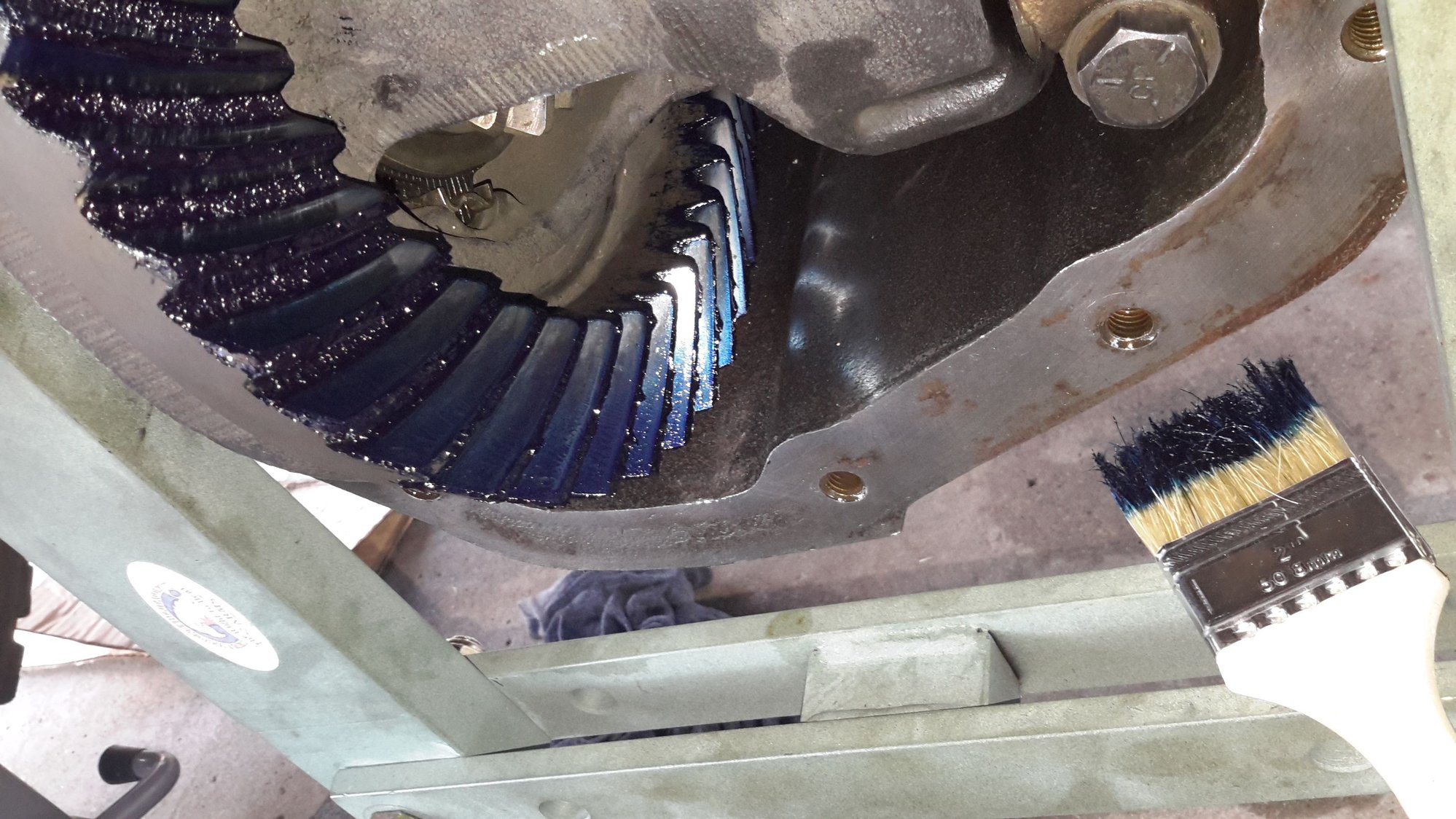

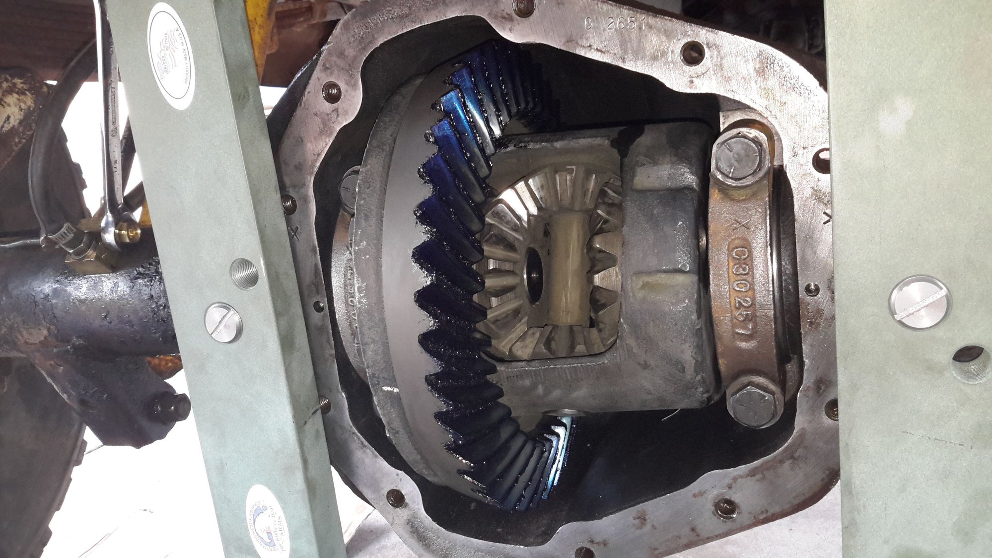

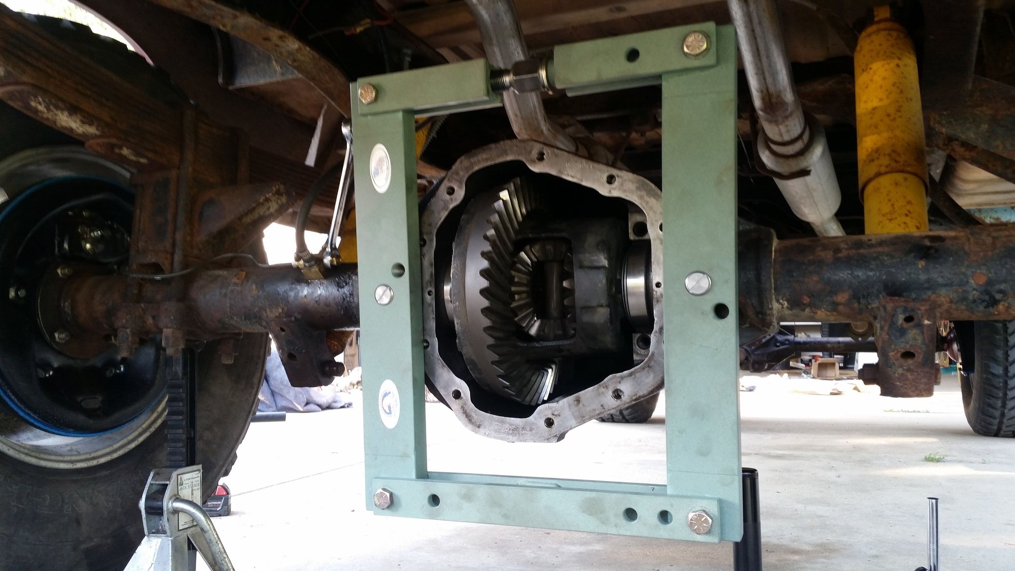

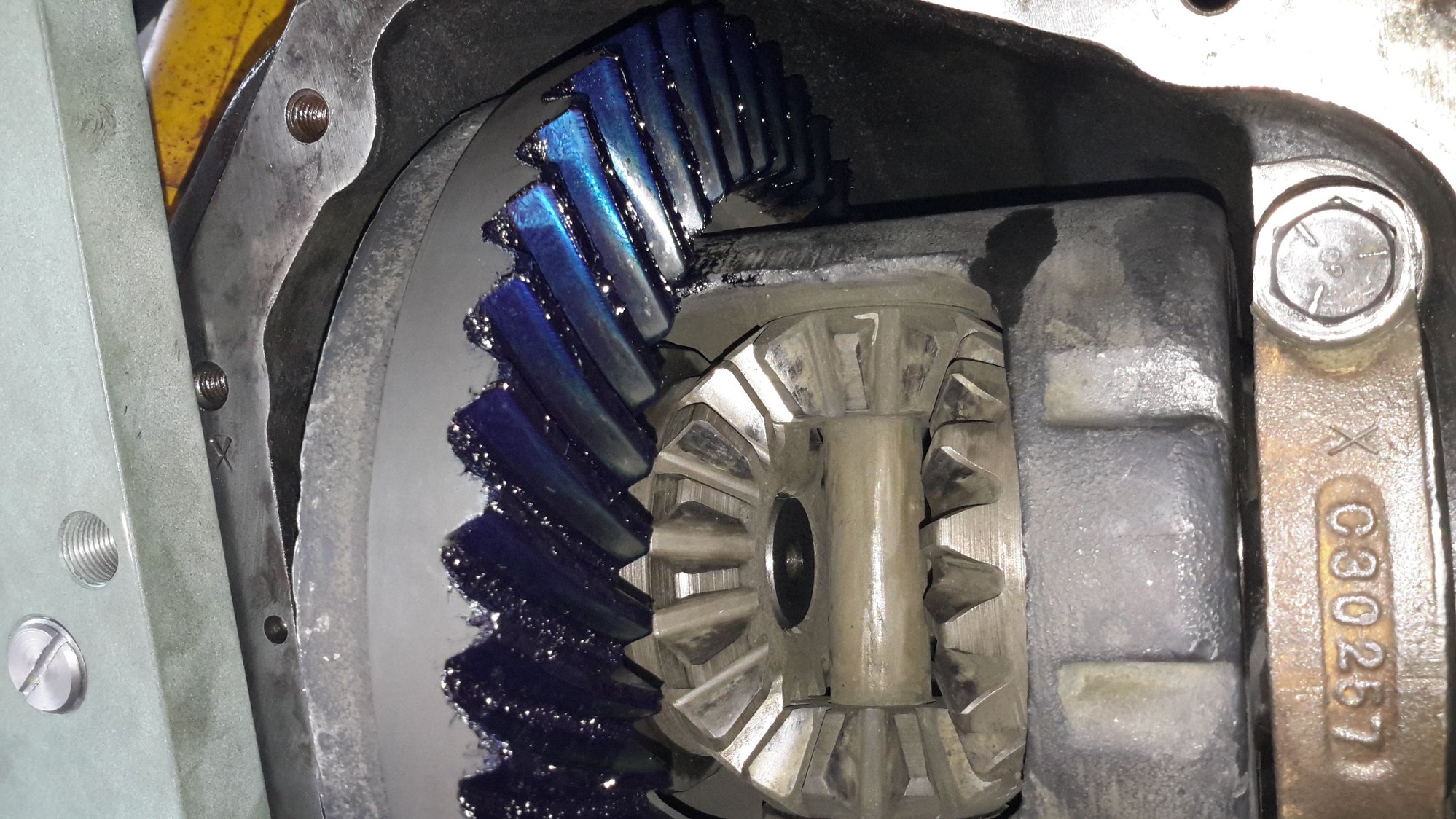

My backlash is reading 0.002 in some areas and up to 0.008 in other areas. If I'm reading the dial indicator correctly. After work tomorrow I'm back on it. According to the King4x4 guys the reading should be between 0.004 and 0.009 and the readings should not vary more than 0.002. So yes I will make a small adjustment to the shims tomorrow but why are my readings so far off? Or is the backlash vary of 0.006 not that big of a deal? Thanks again guys!

Old Jul 7, 2017 | 10:15 PM
  #520
F2501972's Avatar
F2501972
Joined: May 2014
Posts: 617
Why are some of the markings from the paint in the center "just right" and then it drifts into the toe? Going to do a search and see what I can find.
My backlash is better. low reading of .007 and high of .011 ... so I have a vary of .004 ... The info I have states it should be a low of .004 with a high of .009, but it states if you have more than .002 between the readings something is wrong. ???

FYI... Great stuff. The penetrant is realy good and it will free up rusted parts big time! I had to hit some parts a couple of times just to soak in.
My dog helping me set the differential.
