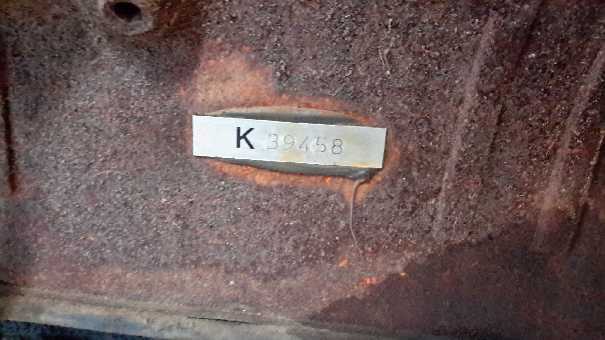

RSB - Replacement Service Block?
Originally Posted by fe390pc
Well I would say you are in good shape. I noticed the ribs on the outside of the block and read that indicates a replacement service block. They are usually of a better quality. The 2U would indicate that you have a 390 crank.
A couple of things to remember here. The oil pump pick-up is unique to F250 4x4s as ell as the oil pan. Rear sump is hard to come by so keep a close eye on those pieces.
All in all you are making very good progress. If you have a machine shop rebuild your heads, do the hardened exhaust seat upgrade so they will live a long life with todays unleaded fuel.
fe390, thxs again! Hook me up with info on the Replacement Service Block... I would like to read up on it. I posted some pics from today and you can see the block ribs even better. Brad the guy who bought the truck from my grandfather put F350 badges on the truck. Then the truck was sold to a farm then to another farm which is the guy I bought it from. So when the short block was dropped in they may have thought it was a F350 resulting in a stronger block...??? PO said it was a Napa short block.
Woundering about it and very interested in learning more... adds to the story to hand down.

This is the Rebuilder's serial number tag for identification. If there were any warranty issues they could tell it was their rebuild. And their files would tell them info on the build.

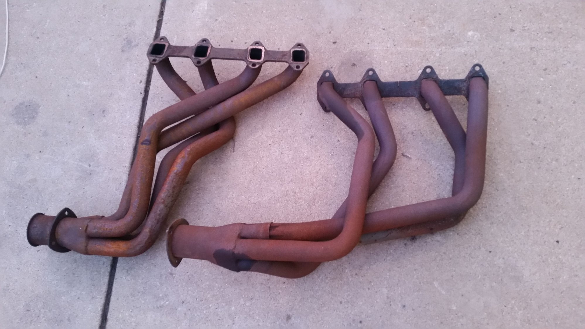

Going to have the headers sandblasted then put some fresh high-temp paint on...
Cleaning the engine bay this weekend. Powerwasher etc. Por15 on the frame???
Tips? Do you guys think I should powerwash and leave it alone or use a product on the frame?

Due to my area's conditions, ie close to the beach, and salt air all the time, I pressure washed the entire frame, (with the cab off), with 3400 psi, then, used phosphoric acid, brushed & sprayed over the entire thing, then coated it with linear epoxy marine bilge paint/primer, then undercoated it with spray on bed liner, with some areas brushed... and have no rust so far, in the first 5 years.. Make no mistake, whatever you do, rust is difficult, if not impossible, to prevent, in one try. It will not be denied for ever.
Do what is appropriate for your area, and keep after it.

I would pressure wash and paint everything you can.

You live in the rust belt. I would clean and coat it.
