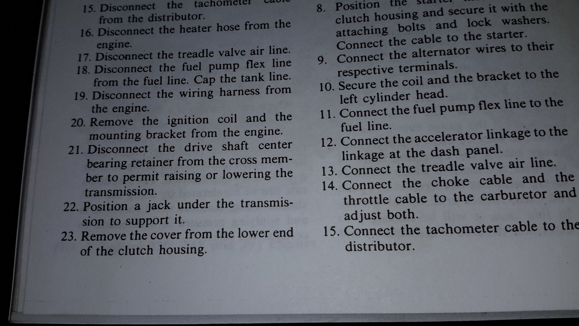

I do not understand step 21 and 22.
I have the engine ready to pull and having a problem getting it to come the rest of way out. The trans does not want to let go. Which is why maybe step 21 is the answer. Need help to pull engine,,, SSOOOO CLOSE... What am I doing wrong? Thxs

Everything on the engine is ready to pull and when I tried it will not slip free from the trans. If step 21 is the problem then I need help becuse I do not understand what they are talking about... I did lift the engine about an inch and it has about 3/8 gap from bell housing showing. I only removed 2 nuts from the engine mounts. 1 on each side. So I do have to lift the engine about 2 inches before i can try to move it forward. So maybe I just need to try harder. However I want to make sure I have correctly completed step 21 and 22 before I go all military commando on the shaking it free.

Engine is out. I'm still not sure what step 21 was about. I must have completed that step...

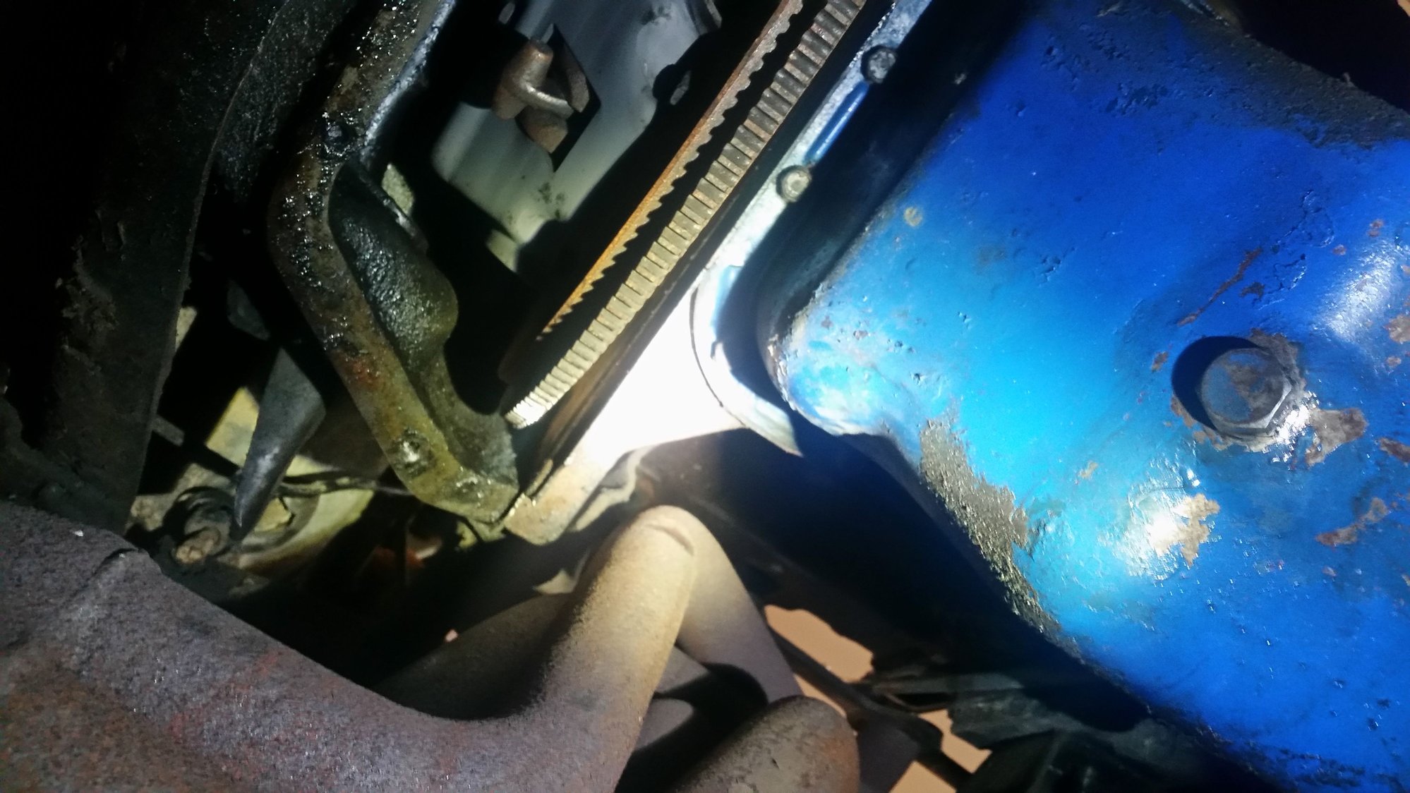

Look at the pics I'm getting ready to post and chime in... Tell me if the first pic means it has the 390 crankshaft.

Jim says that means it has a 390 crankshaft. Is that correct?

That rod journal looks mighty clean amigo, and so do the piston tops. I will leave the ID for 'El Rey' to look up, or Number Dummy, both of whom are the experts on everything Ford. I am more of a 300 IL 6 man, but have worked on several V-8's in my time.. Back in the day, I rebuilt an old 292 in a '56 pickup, and my first car, a '49 Olds, had a 303 V-8, and was one of GM's first OHV engines.
You already probably know, that V-8's are higher rpm, and hp. and develop their torque at higher RPM's than the 6's. Your 390 will be a strong motor when you are done... what's next? the machine shop, for some accurate micrometer work, a good boil out (ugh to the sludge), and some head work... good luck on all that.. I will say a prayer for no cracked heads...

Well I would say you are in good shape. I noticed the ribs on the outside of the block and read that indicates a replacement service block. They are usually of a better quality. The 2U would indicate that you have a 390 crank.
A couple of things to remember here. The oil pump pick-up is unique to F250 4x4s as ell as the oil pan. Rear sump is hard to come by so keep a close eye on those pieces.
All in all you are making very good progress. If you have a machine shop rebuild your heads, do the hardened exhaust seat upgrade so they will live a long life with todays unleaded fuel.
