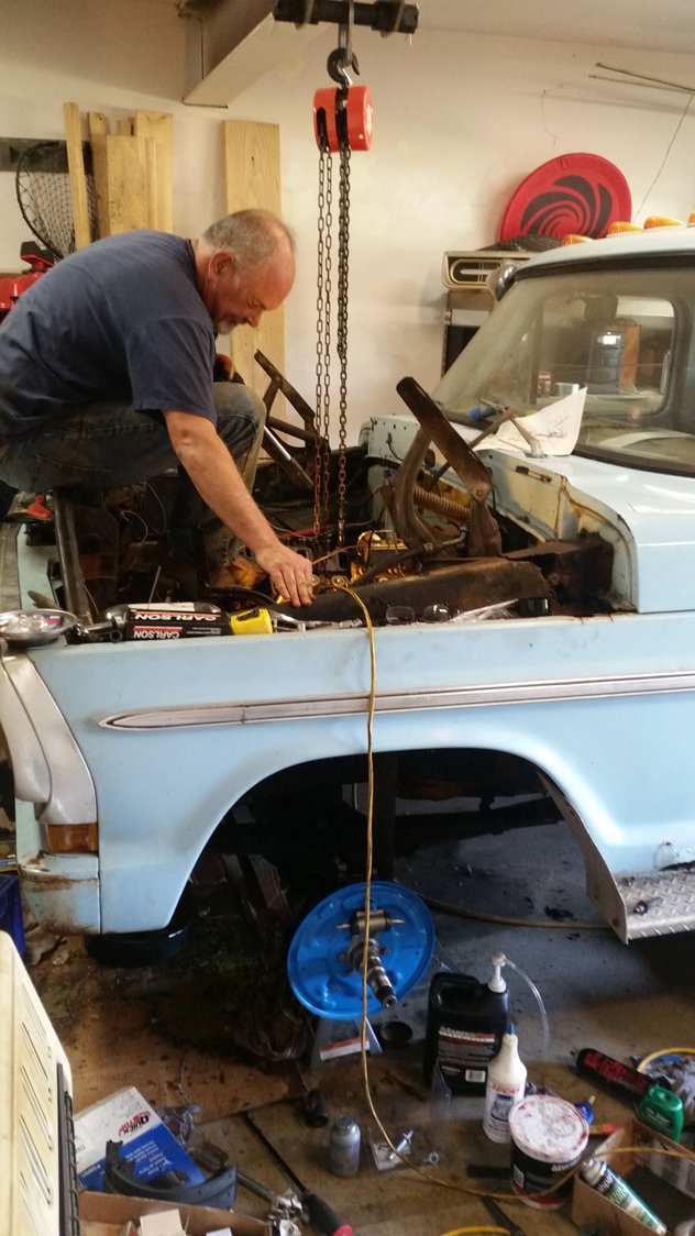

Prep to pull the engine.

Thinking about putting the intake back on and using the LIFT PLATE to pull the engine. I have read where guys have used the lift plate to pull FE eninges but what do you guys think? <br/><br/>Is the LIFT PLATE fine to use? Are those 4 carb bolts strong enough? <br/><br/>Whats the best way to pull the engine for anchore points or is the lift plate fine?

I believe those carb bolts are 5/16 studs, with sufficient threads into the manifold, to hold easily the engine's weight. Not having a lifting plate, I have always used a 3/8" manifold bolt, with a large washer, and a 3/8" chain or at least a 5/16" chain. I have never had either the manifold bolt or the chain fail. I just looked up the load strength of a 5/16" chain, and it appears to be 4700 lbs.... now, that being said, that is new load rated chain with a load class of 70... You can feel safe with any proof rated 5/16" chain..

My turn. I resemble That remark. I too have always used manifold bolts and big strong washers. Not real thin ones. Especially if pulling engine and trans together. I know there would be 4 - 5/16" studs to share the weight rather than 2 - 3/8" to do it. But what grade are the carb studs? They are only meant to hold a light carb with a light torque rating. Where as I know the manifold bolts are hardened.

Good thinking El Rey, and perhaps, that is the reason that I have always pulled both, big V-8's and IL 6's with a chain, thick washers and manifold bolts, not carb bolts... Very true, that manifold bolts are hardened, resist bending, or stretching much, and provide a safety factor, not found in carb bolts.. Suspended loads are always treated with 10X safety factor by the prudent, as gravity never sleeps.
