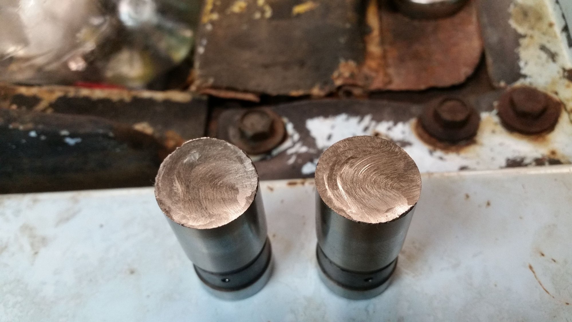

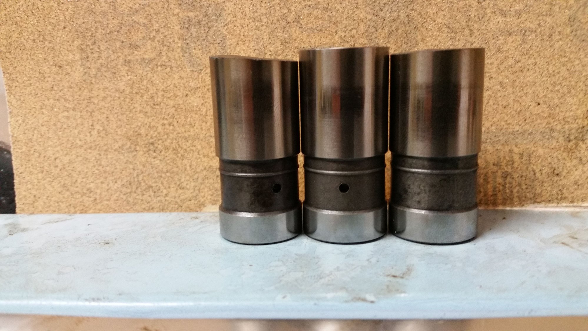

Lifters are out. 2 are very bad and others are not so good. I can see the cam and it has bad spots as well. So I have to decide if I can just replace the cam and lifters or if I need to pull the engine and do a rebuild.
Here's where some help would be appreciated.
Because of cam and lifters looking like they do, does that mean the crank could be bad?
Yes & No question the oil pump will pick up the filing an get trapped in the filter.
The crank maybe get by with polishing up some to get by. But you'll have to do a visual inspection first. But since this truck will be with for many yrs to come, I'll pull the motor and rebuilt it. May be you can get by with just freshening everything up. Polish the crank, hone the cyl.for new rings,
New oil, new cam & timing chain. Valve job should just about cover it if all good.
Orich
Ps that engine should of had some noisy rockers clicking.

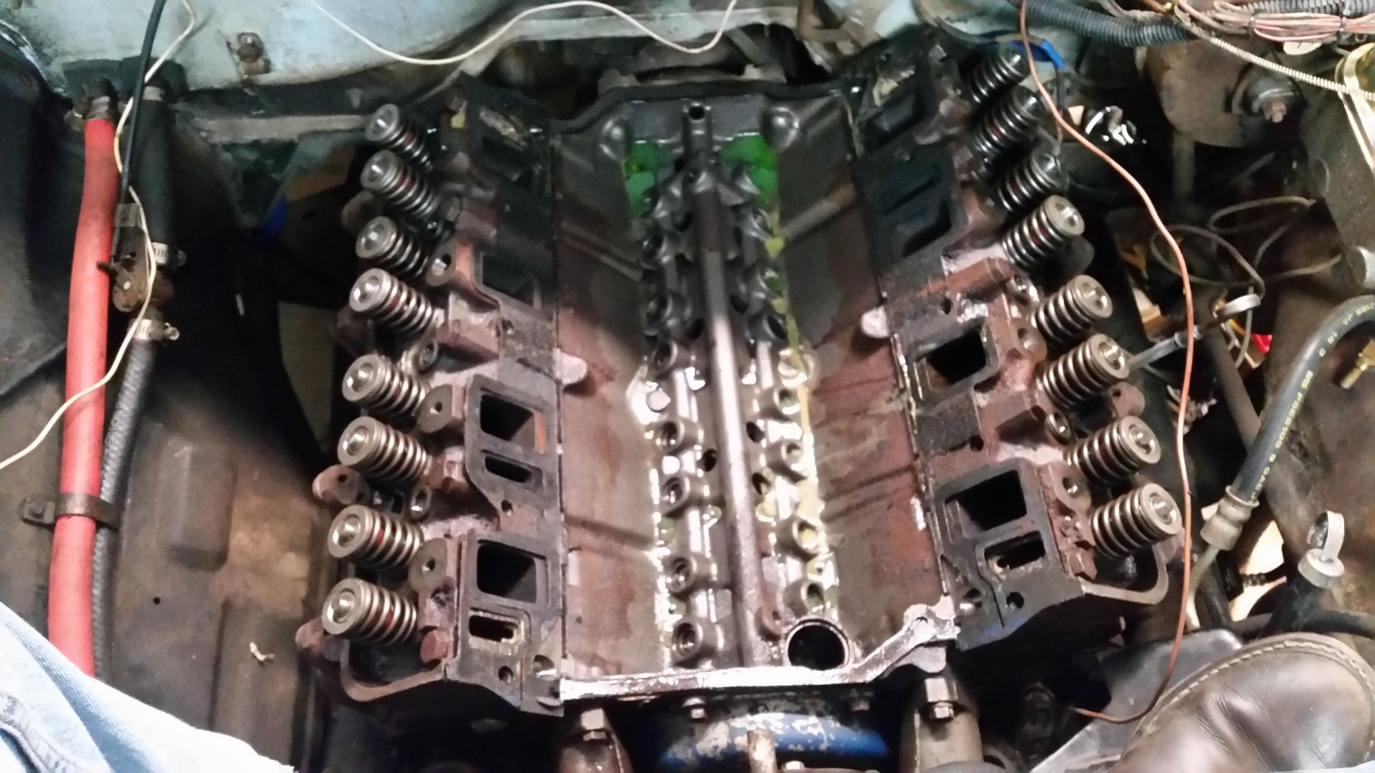

When I took the intake manifold off... the baffle plate (piece of metal that goes between the intake manifold and lifters is missing)
Old Mar 8, 2017 | 10:09 PM
  #372
orich's Avatar
orich
Joined: Aug 2003
Posts: 7,592
Likes: 10
From: **** hole San Jose ca.
Aw someone's been in their before and forgot that sheet metal shield Ha I did the same thing once. I pulled the engine down to do the harden seats 30k later no build up on the under side of intake. So no big deal if your intake bottom is clean of carbon build up.
