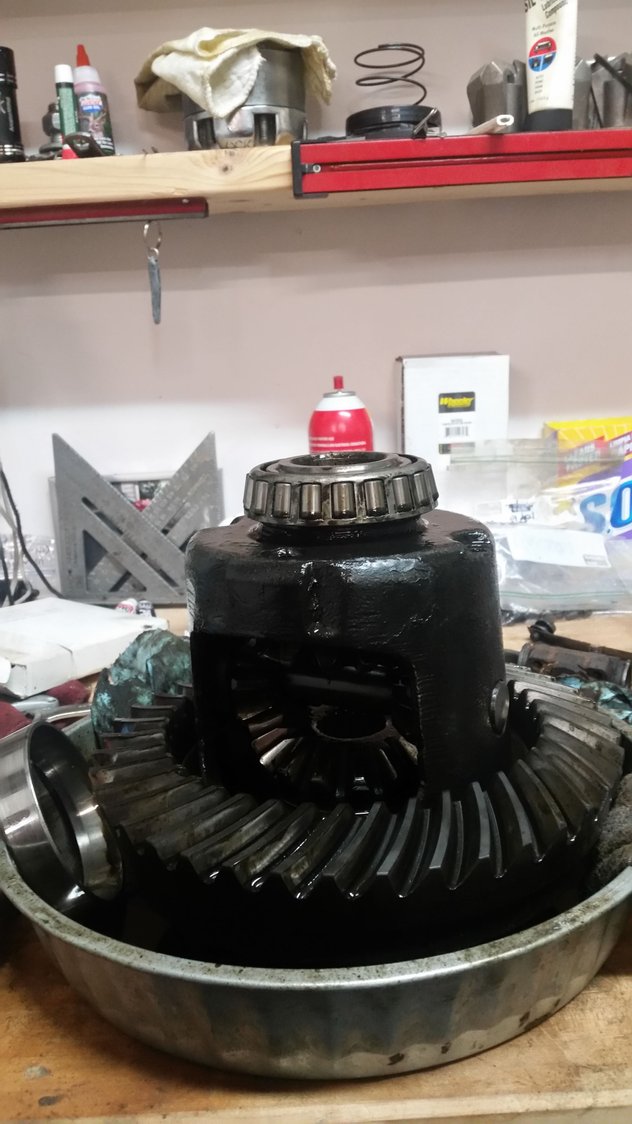

Does anyone have instructions on the teardown and rebuild of the Dana 60 rear Trac-Lok?
The book does not have those instructions or I'm looking in wrong place. Thxs
