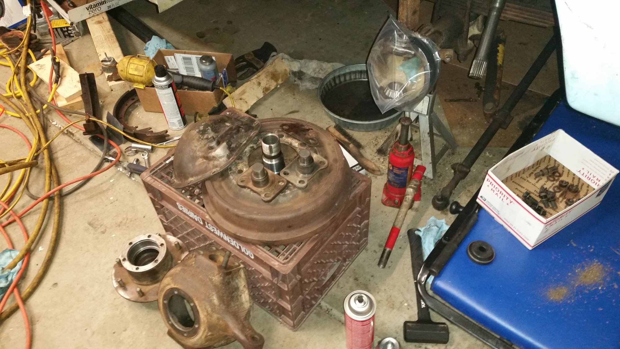

Parts I have been cleaning / prep for putting front axle (right side) back together.

I used some short pieces thin wall of 1/2" hose slipped over the hub studs threads when painting to keep the paint off to keep them clean.
works for.
Orich

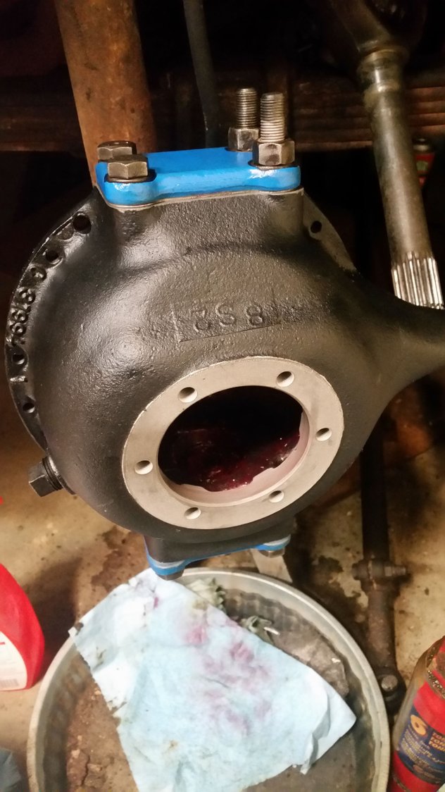

Thanks orich!!! Now that's clean... I did pack the bearings after a good deal or research.
Watching the game now but will take out one more shim and should have perfect preload specs. Once I have it down will post a details with steps.

Were you able to get the inner seals in yet//
Orich

I have not done the inner seals yet. Do those have to be done at the same time? Or can one side at a time? Garage is small so I can only work on one side at a time, but I do have heat in the garage so that is huge. I almost forgot about them so thinking about skipping the inner seals but I do have parts.
Thoughts?

Well both axles have to be pulled to remove the ring & pinon or at least the ring gear carrier has too be removed. One thing you could do is wait unlit spring or warmer weather where you can do it out side where you have room on both sides of the vehicle.
If you have not found any gear lube in the axle tube housing then you could wait.
Even if you have drained the differential or not you don't need you refill it as your not going to be driving it in 4wd right.
You could even leave the one axle out as long as you keep the opening closed off to keep any dust out. As the wheel only needs the spindle on to attach the hub onto so you could just move the truck around in your yard so you can work on the other side of the truck.
The whole ring & pinon will need to be removed to service the inner seals.
The seals may look good but the point is now how old they are an how long will they last after using the 4wd.
So like, I had said it could be left for another time but it's a nice to finish the front axle off now instead of having to pull it apart later, but it will be easier next time as you won't have to remove the ball ends just the spindles an pull axles out along with the ring & pinon all having to be removed.
The yoke an pinon should be marked so it can all be tighten back up to the same TQ-Lbs. position on the yoke nut.
Also a good time to replace yoke pinon seal an any internal bearings if pitted from moisture getting to them like it did mind.
Orich
