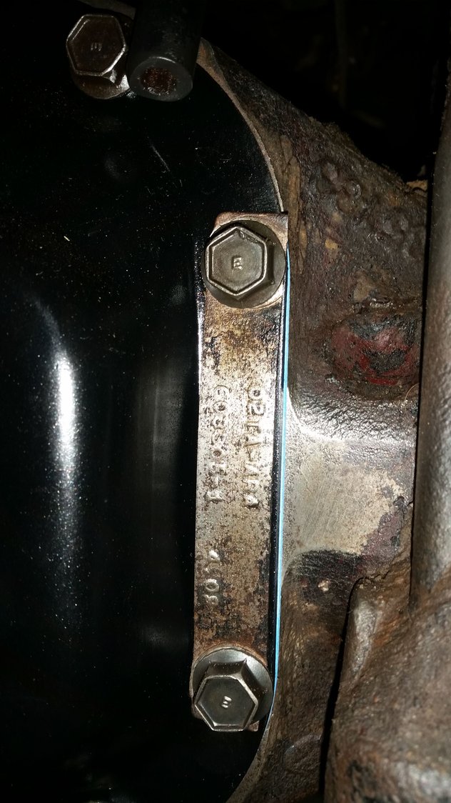

Front Axle
O2TA -ARA or Jeff, should that be D2TA-ARA?
603305-1 4.09
Yep. D2TA-ARA. It is a Dana 44.6 HD. 3500#. axle. The Spindle was part number C7TZ3105E. None on any of my locators. You might have a machine shop weld that trail up and machine it back smooth.

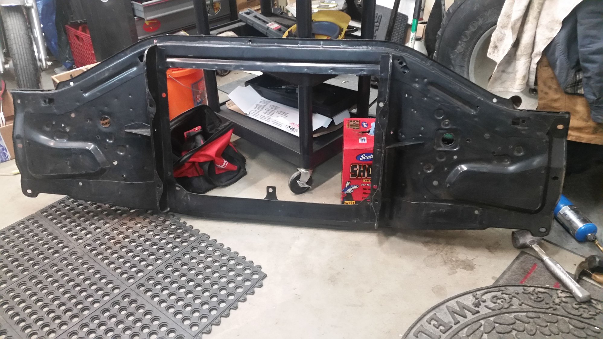

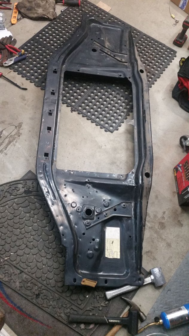

Rad Support I picked up today
Originally Posted by JEFFFAFA
C7TZ16138B
67/72 F100/250 4X4-F350.
67/72 F100/250-4X2-w/super cooling.
This is the only place that shows up on my locaters.
Fred Grande Ford
5867493141
Jeff, I bought the above core support / rad support today. Pretty excited until back home, I only had a few minutes to check out the rad support. 10 hour round trip drive. Anyway, I need some help because the part number does match but it looks like there are some holes missing. I will post some pics of the rad support. I could not find a stamp in the metal, just a ford sticker.

It will be tomorrow night or saturday b4 I can look closer at the core/rad support. But what do you all think?

Looks ok to me has the rails for the rear mount radiator so should be go to go.
Wow NOS Good score!

Rad Support is Not correct. It is close! So need to solve this challenge. I read somewhere the rad supports from 73-79 Dent side would work on the 67-72 Bump side with drilling some holes. I think what I have is a 73 -79 Dent core support. So I either sell the one I just bought (as they said I could not return it b/c it was sheet metal) or I fab it to work on my 72. I'm going to look closer tomorrow but I'm not sure the rad support I have will work at all. I hope I'm wrong.
Yes, I'm getting way ahead of myself as I'm not even close to actually installing it. I'm trying to find correct parts so when I'm ready to tear the front end down I will have it ready to rebuild.
I paid a high price for the rad support so really appreciate thoughts on how to proceed.

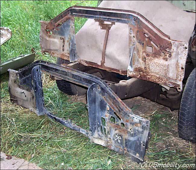

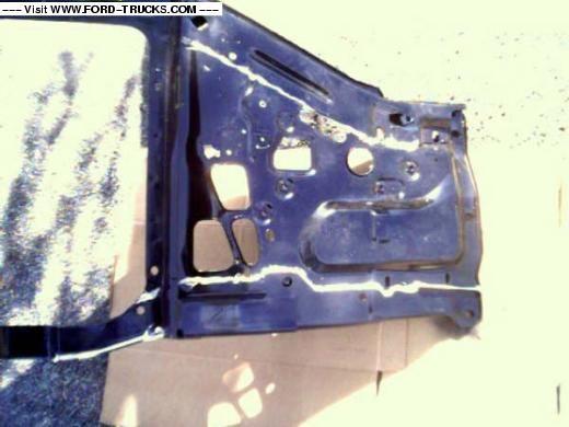

Here the two in the rear is a 67-72 front one is 73-up 79
Look at the vent holes in the 73 & up and the the 67-72 don't have.
It looks like the lower lip part is thicker but still may fit work
Orich
Here my 75 support

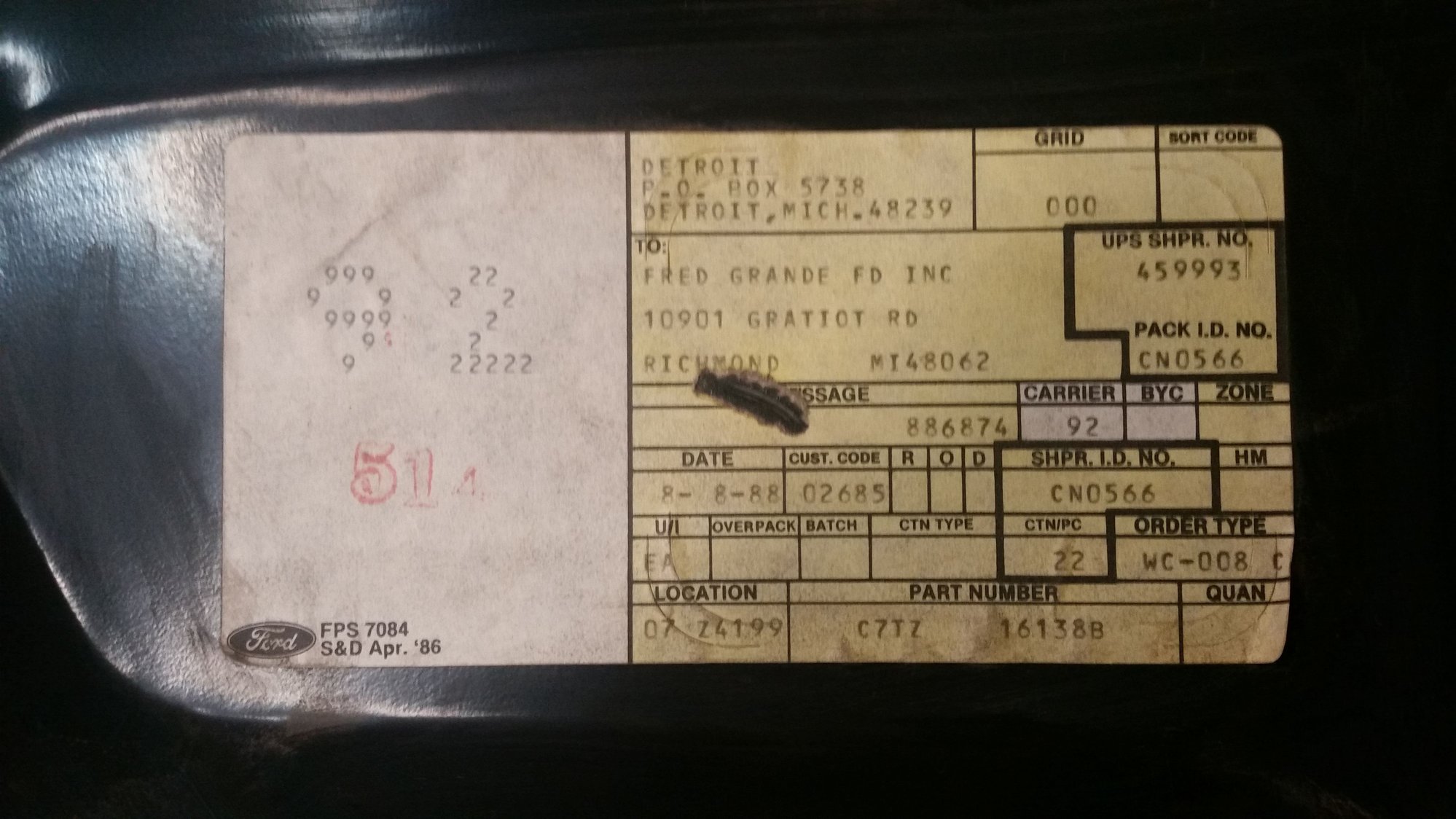

I may have found something... The core support I just bought (I think) is for 67-72 F500 F750 Big Ford truck. The number on the part is the same except the last part which should be "C" not "B".
C7TZ-16138-B 67-72 F250 4x4 Core Support (what i thought i was buying)
C7TZ-16138-C 67-72 F500 and F750 Core Support (what is sitting in my garage)
On the part number, it seems someone made a mistake when they put the sticker on the part.
I'll make a call Monday to see if they will take the part back... but they already said no returns so we will see.
It being a C7TZ16138C does make sense. Yes, Ford's warehouse help did put the correct stickers on the incorrect part every once in a while back in the day. And notice what day is on that sticker. 8/8/88. In my January 1989 OSI (part number replacement and interchange) slide it shows C7TZ16138C being replaced by D1TZ16138A. In theory that part was pulled and mis-labeled before the part number change.
