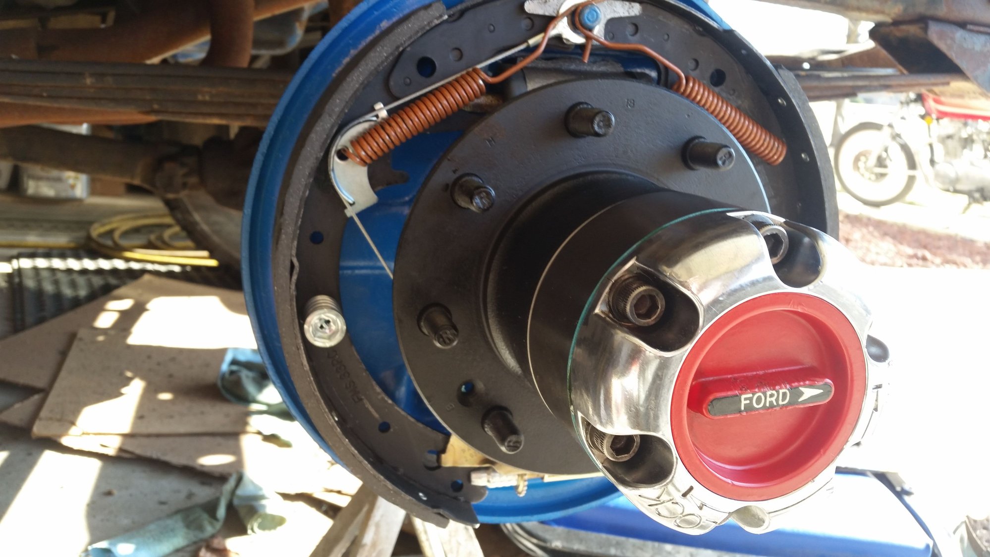

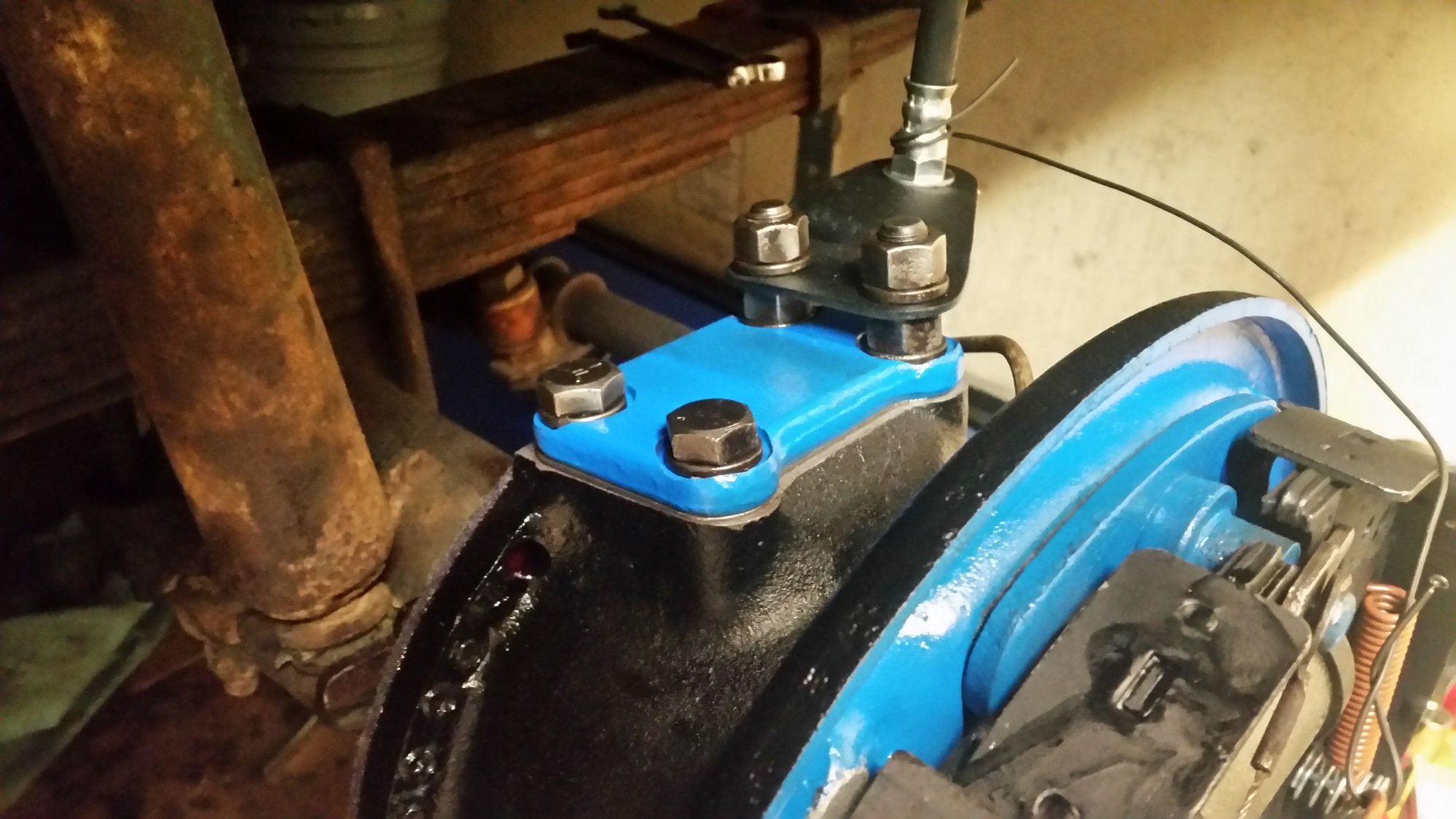

Weekend update...
I like the color contrast
Is the brake drum kit for the 2x4 F250 the same as the 4x4? I need to order the kit that has the cable going from the brake adjuster screw up to the top 12 o'clock position. Looking to buy best avalible kit.

Great color job on the backing plates. Sorry I don't know about the differences between 2X4 and 4X4 brake parts. Look them up on autozone.com or Rockauto.com and see if they have different part numbers.

The parts you are looking for are the same between 4X2 and 4X4. The cable separate was part number C8TZ2A178C. Long ago Ford had replaced that part number by C7TZ2A176C. Which was a kit including a cable, a guide, and a lever for both sides. This way one kit would fit either side.
All of the below companies show at least 2 of these kits.

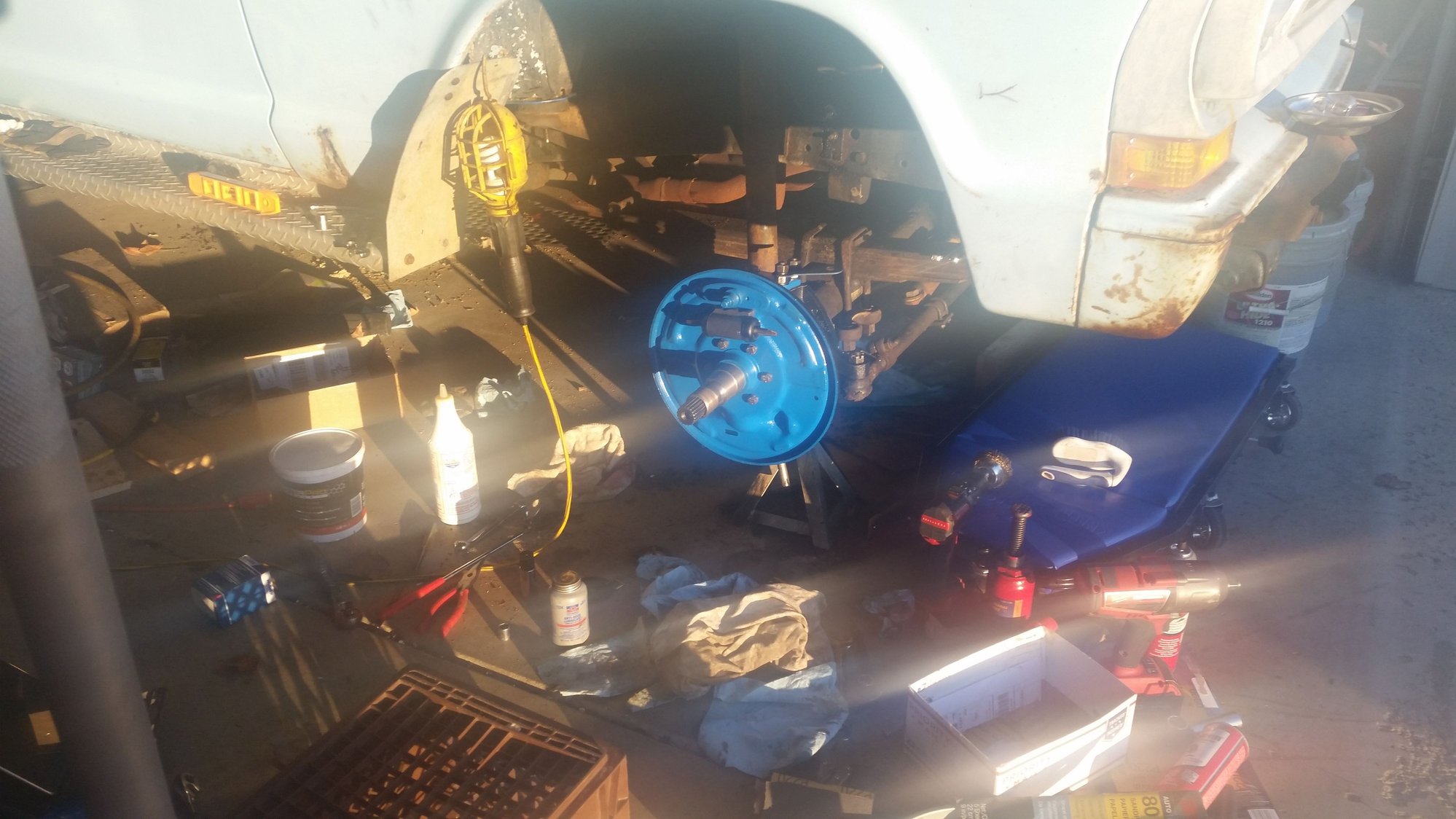

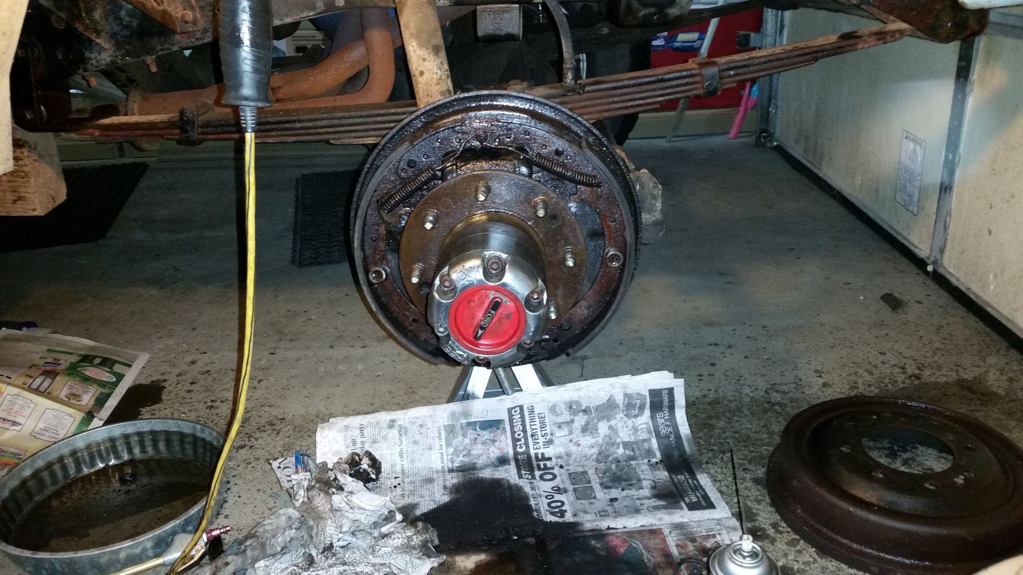

B4 pics. Baja, I here you... good idea. These are of the front right side i did in Jan/Feb.
Again b4.

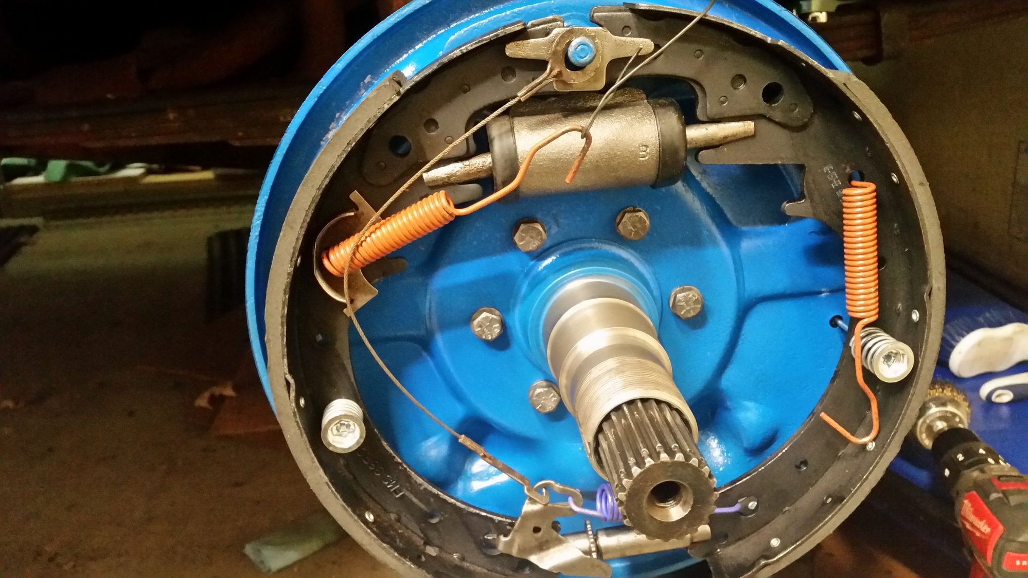

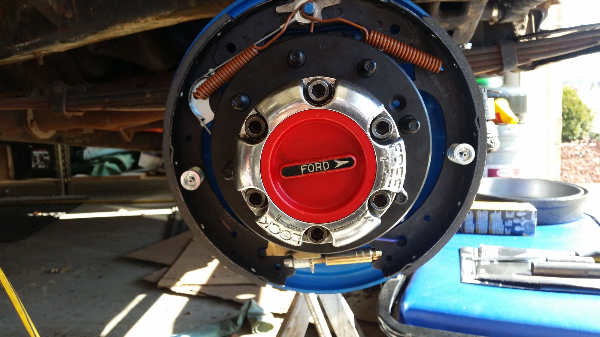

After
I used different products to clean parts etc. If anyone would like list of how I was able to go from what it was to this pic just ask.

This is the rear axle I took apart yesterday. The spring on the bottom was broken and there is a part at the 4 oclock position that is just hanging. So I will take it apart today clean up and order parts. See my posting above about what parts I need help finding and see the next pic as well. Thxs
The lock washer in this pic is what I need. I could make this one work but would like to find some OEM / NOS... Baja?

Looks like the last person to take it apart didn't have the proper socket (axle socket) and used a chisle. That's what my PO did too. I bought the socket at O'Reillys for about $8. The piece hanging down is the cable for the adjuster. Your front brakes were well lubed-LOL. Are you going to flush out the rear end now too?
