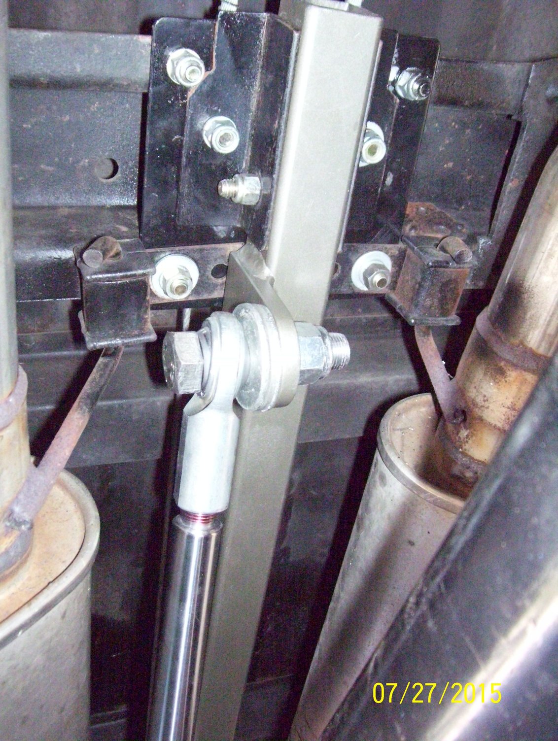

The above pic is the transfer case... I would like to repace the rubber. 4 bolts and 8 parts of rubber. When I grab the transfer case I can move it - front to back - maybe an inch. Is that normal? I'm in deep with the drivetrain but it will be as good as new or better when I'm done. So wondering if the play is normal or do I need to change the rubber to fix properly?
Thxs -

Well some what normal but new rubber cushions would help reduce the swaying of it.
I went with ploy cushions that still let it sway some so built a made up a brace to stop it from any movement.
Orich
