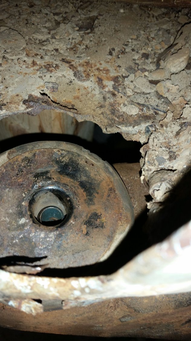

This is looking from the garage floor up at the bottom of the absorber. Does that look stock or factory correct?
This is looking from inside the front cab mount down at the absorber. Does that look right and how do I remove the upper from the lower?

Yup that's how they number them. I've got the same ones 3 that say rear
Orich

Those were designed to lock into each other and then rust together.
This why most all need to be cut in half to get the off.
Orich
