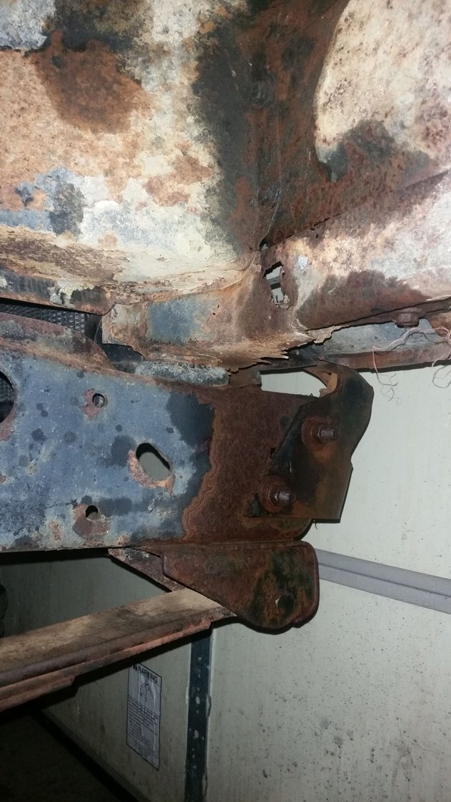

The guy who had the truck put a new radiator in and did Not put a shroud back in.
The opening measures 27.5 wide. Does that help?
How can I tell if it is a "super cooling"?
Thxs
So I found a few salvage yards and when calling found one that has a 1972 F100 4x4 core support. If I buy from a salvage yard where they ship (yes cost goes up) How can I ensure the support is correct? 27.5 inch wide?

I'm running the supper cool rad an it fit in the a stock oem 71 4wd which had a 300 I-6.
It came with a wide radiator support from the factory I guess as far as I know.
I had to replace the rad supper about 12-15 yrs about an just got one from a 75 pickup don't remember if it was a f100 or f250. then only thing I noticed some mount the radiator from the front & some mount it on the rear that all had the same radiator wide opening. I've only seen the small opening with the small rad support with a 240 I-6 or with which had a 302
engine.
If, I had one with the small opening, I'd just cut the extra sheet metal that's not cut out for the wider radiator.
Take a picture of your and how your rad mounts and send a picture to a seller an ask if it it's the same. .
Every 67-72 vehicle, I came across when, I was looking for a rad support all had a rusted area so went with a non rusted 75 was in much better shape with about 5 new holes to drill. cutting one 1" square hole for a J nut on the hood latch.
No big deal to do that just drill a 1/8" hole in a one inch square corner an use a dremel cut out wheel to cut the square out an done.

Jeff, I'm going to order the absorbers for the cab (see pg 2)
absorber upper...C4TZ8100154C. Replaced by C4TZ8100154D.
absorber lower...C4TZ8100155C. Replaced by C4TZ8100155D.
So I need 4 uppers and 4 lowers for the cab front and rear (I think that is it for fresh rubber supporting the cab)
For staging for the cab rubber and the front end rebuild... Jeff, what part number(s) do I order for the radiator support - mounts - ? On those 2 rubber support mounts, it looks like I will need hardware as well.
The only other thing I need to order (that I can think of) would be the bolts (fenders and rad support) and the Radiator (core) support.
My radiator / core support has the 27.5 inch opening (4x4 f250) and like orich said that is an item that would be better to order new. RockAuto had one when I looked last month but when I checked last night it said "no part ava"
Going to call DC and ask them if they have one. So DC has a rad support kit C4TZ-8125-S Guy at DC said it comes in a kit and his info says it's the same kit 2wd and 4x4. That was the good news. Bad news DC does not cary specific 4x4 parts at this time. But glad thye have the kit.

If your radiator mounts at the front the core support then most likely it won't have the side sheet metal side rails for mounting the radiator that mounts at the rear.
This is important when ordering a core support!
How does your Radiator mount ??
Edit or it will have the side rails with a front mounting rad like my truck had.

orich, the rad support mounts in 2 places on the frame - then the inner fenders bolt to the rad support - then the fenders bolt to the rad support. <br/><br/>I'm not understanding your above question... ?
