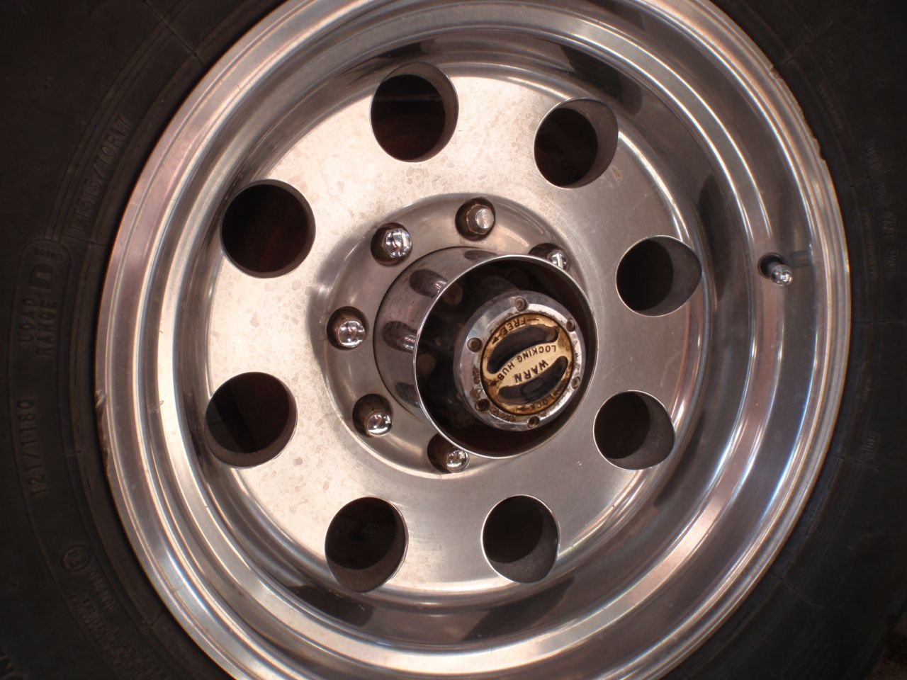

That's the way I felt, when I exhausted my search abilities, for the big hub Ford ones. The ones I have on my '68 have worked fine for the past 3 years now, with no problems. I like the bronze centers too. No plastic.. is a good thing.

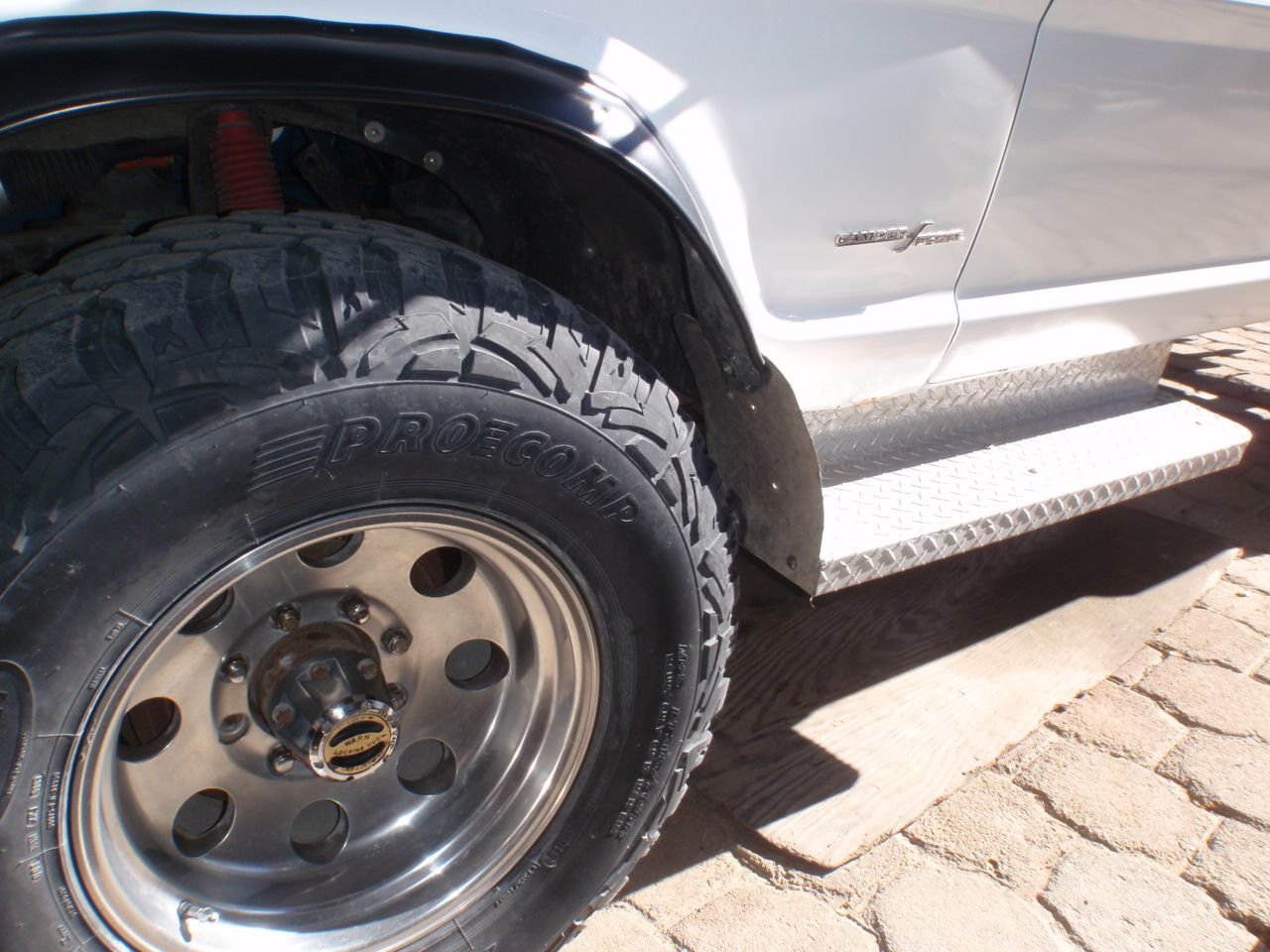

Yep, I know I am missing one lug nut.. prolly lucky to have 7..
this hub has the chrome hub shield installed..
This shows the running boards and aluminum backing for the mud flap, as well as the fender flairs.

brother Russ,
When, I change over to disc brakes axle, I had to replacement my outer hubs with new replacements. The neat thing was they were o-ringed an no funky hub leaky hub gaskets.
Was Wondering if you also got the upgraded o-ring hubs ??
F2501972 Look for the o-ringed hubs much better.
Orich

Baja,
Thanks for posting the wheel hub pics. Is your truck Wind Blue as well or is it white? I couldn't tell but either way it looks to be very clean and your fender to door lines are great.

Originally Posted by bajafishnut
[IMG]https://cimg0.ibsrv.net/gimg/www.ford-
p1060004_332b8307cc89dc79fab41f747e84bf2ac27779fa. jpg[/IMG]
Russ I know this don't sound so good, But you need some new nuts.
Orich

No, he just needs some of those 7 lug rims!
