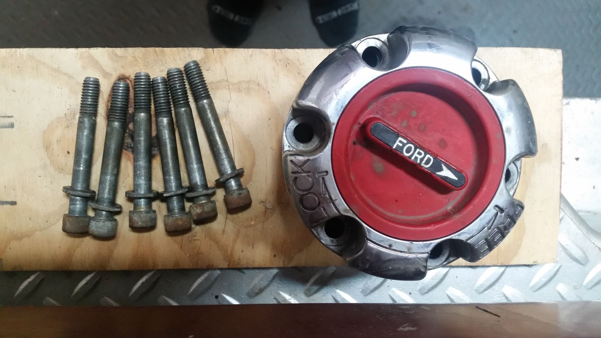

These are the bolts from the Wheel Cylinder. I'm cleaning and doing prep for the patient LOL. Way cool to see the Navy Decal anchor on the bolts as he was a Navy Gunner in WWll. Any idea why the bolts have those markings?
Old Jan 5, 2017 | 02:26 AM
  #175
GaryKip's Avatar
GaryKip
Joined: Aug 2015
Posts: 4,093
Likes: 14
From: Lind, WA- Eastern WA
They might have been Navel stainless steel. The Military would have a marking on some things to show it was Govt property. But I don't think they were factory original.

Where can I find Lock-out hub? aka Actuating ****? Both of the **** function (I think) but the other one is very stiff and the Ford part is tore off. I remember that side always being hard and he would use pliers. When I take the other side down I will see if I can find out why and fix it. In the mean time does anyone know where I can find one or a set of these OEM *****? Thxs:
Old Jan 5, 2017 | 11:45 PM
  #179
orich's Avatar
orich
Joined: Aug 2003
Posts: 7,592
Likes: 10
From: **** hole San Jose ca.
Activator ***** I think ford called those. May be Bill Or Jeff can get a P/n's
It's a 3,500lb. axle external hubs
Also See TK40256Torque King® Heavy-Duty Anodized Aluminum Replacement Hub
Orich

I could not find any of the Ford original hubs or parts when rebuilding mine, so bought direct from Warn Hubs, and ordered the HD replacement. It has the brass center, which won't break like the Ford ones. I still have my Ford ones, and do not intend to ever use them, so if you cannot find the parts in the USA, I will bring the centers North with me in late Jan, and ship them to you if you wish.?? The price is FREE, you just pay the shipping from Texas...
Baja
