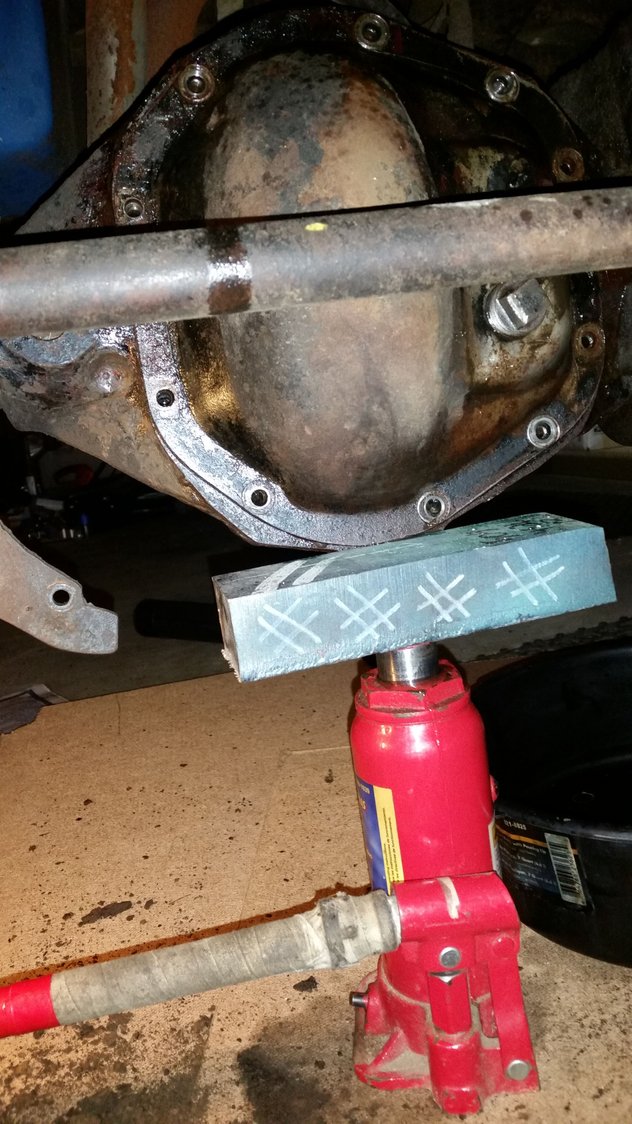

Everything looks good. Oil is very low but no water in it. But I can move the axle left to right and up ans down maybe 1/2 inch. So in this pic... where the short shaft is seen... I can move that, so what is behind the U-Joint looking at this pic? Is the play normal? The U-Joint is in very good shape. So, I'm thinking I might not take the steering knuckle apart becasue it is so good. Remember 42k of the 65k miles are long hunting trips to Canada and Colorado.

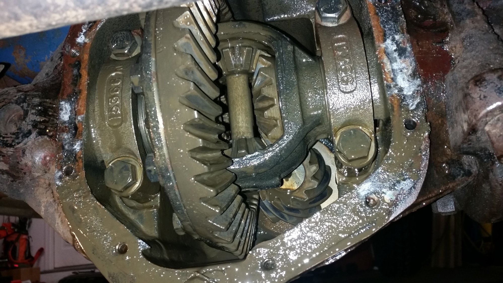

I had to be a little creative in order to free the differential cover. Glad I did, because the oil had water in it. Maybe 8 to 12 oz. Everything inside looks great. I will clean the gears with and put fresh oil after I do the other side.
So the oil looks nasty but the gears look good. Also the oil level was right at the fill line. I checked before dropping the cover. What is the best way to clean up those gears? I'm thinking break cleaner.
