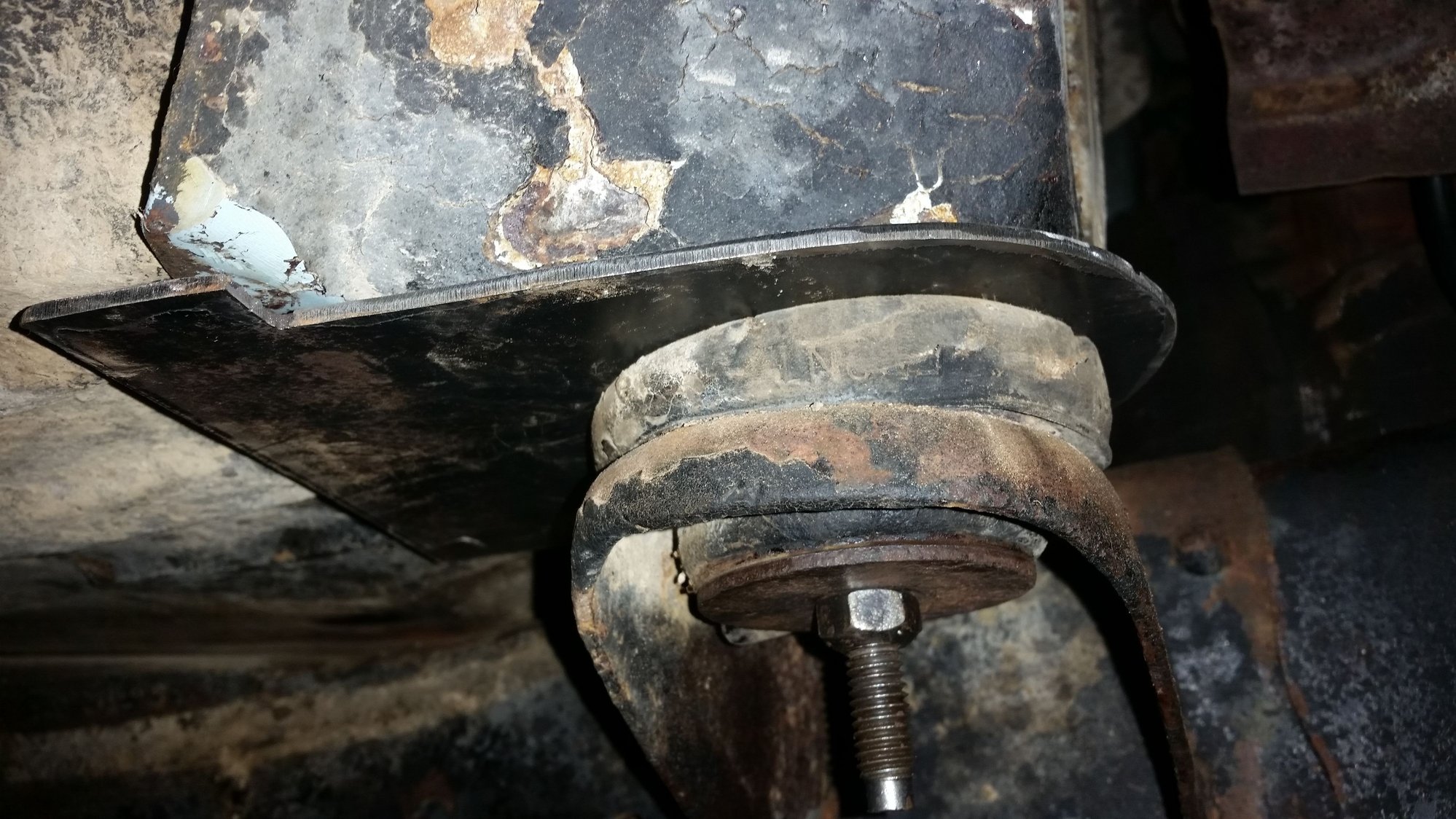

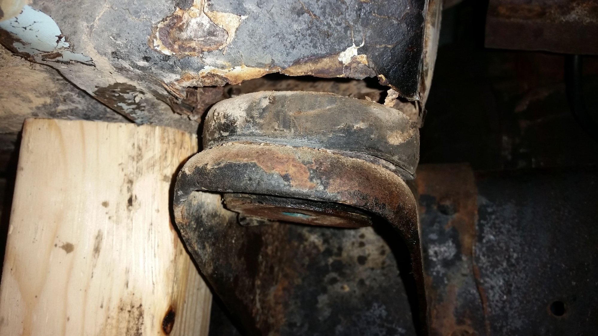

I'm a little discouraged about the floor pans and front steel cab mounts. The guy who bought the truck from my grandfather put carpet in which looked nice but held moisture. So the floor pans are rough enough that they will both need to be replaced down the road. As I have said, the right front cab mount is gone on the bottom only but not all of it. I'm going to try to have a body shop do the cab mounts and floor pans. So I will be making some calls. In the mean time I will fix the cab mount with a flat steel plate cut to match the bottom of cab mount. I'm thinking that will work for now until I can do the cab mounts and floor pans.

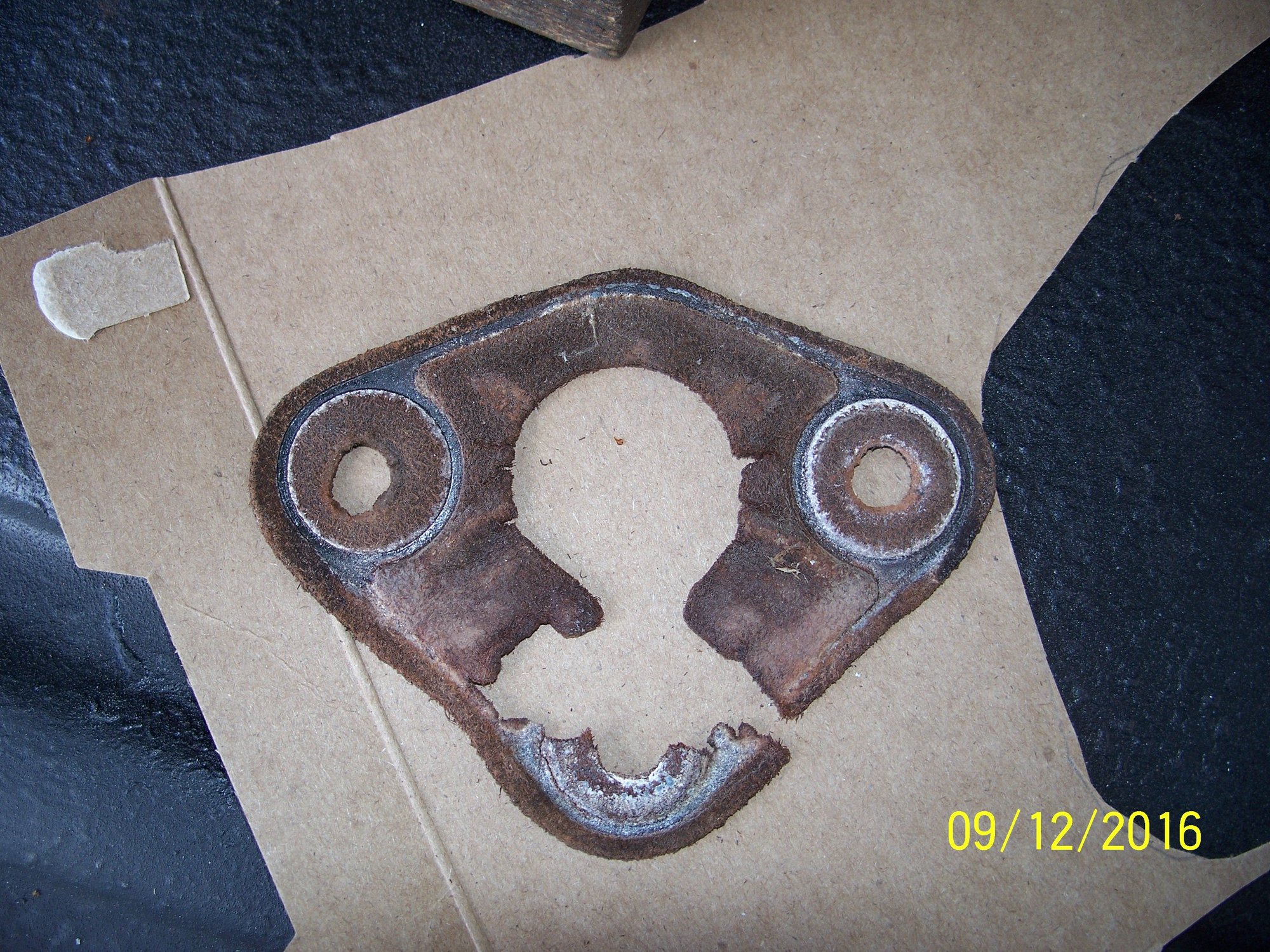

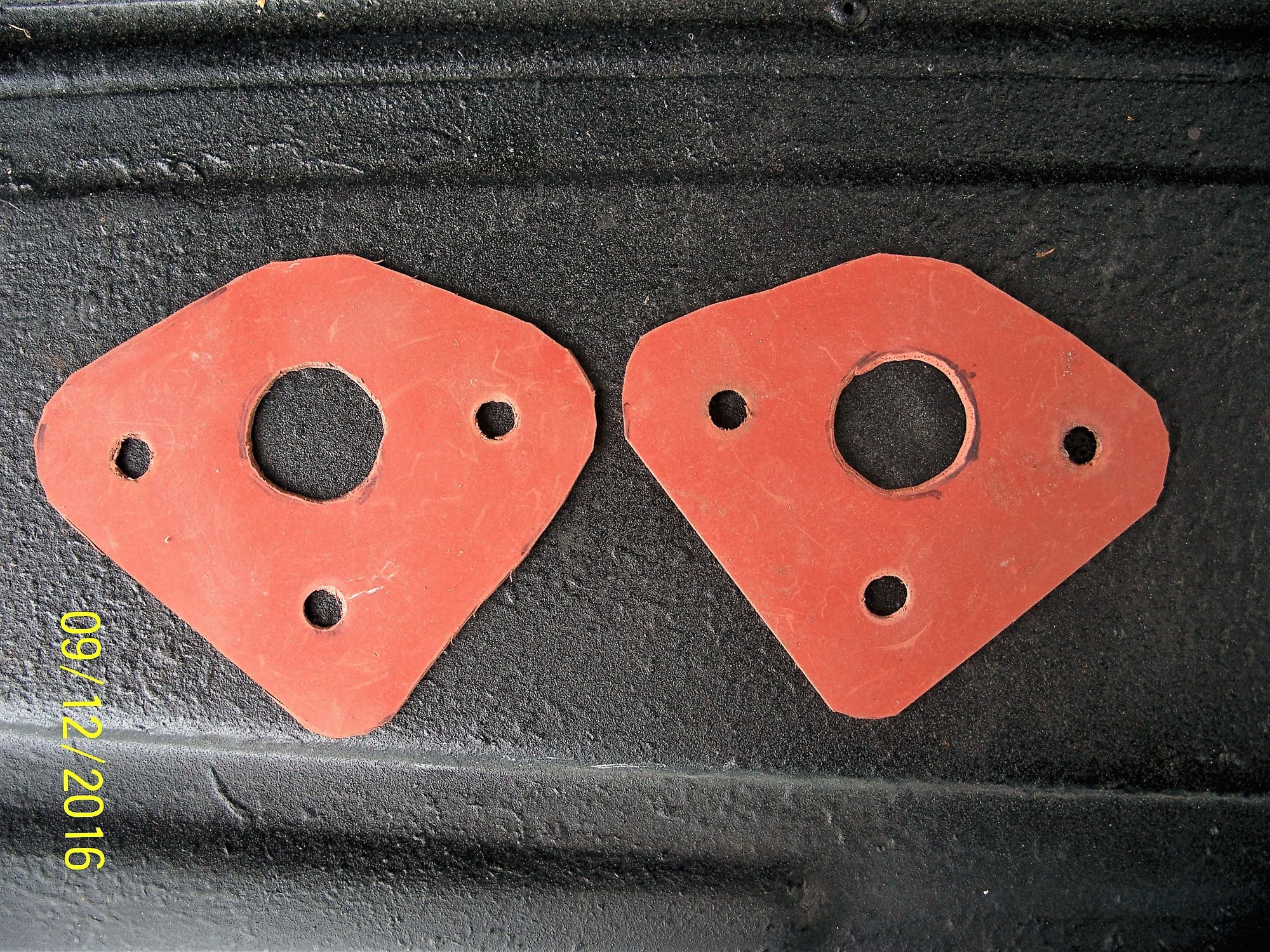

Carpet at least sucked up the leaking rain that came in a few places.
This is places they leak
1. windshield wiper pivot inside flange gaskets
2. windshield seal gasket the Stainless Steel trim was worse as the sun really dried it out.
3. wind wing vent gaskets leaked,
4. heater core leaking.
The rubber floor mats were the worse for keeping it wet where as carpeting would dry out faster but if it keeps getting wet all winter long yr after yr it has to rust.
It would have been better with out anything on the floor as it would have been seen may be taken care of long ago.
My leak was the wiper pivot flange below gasket old & my rubber replacement
Old gasket
replacement

Before
After
